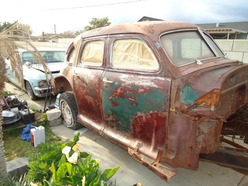

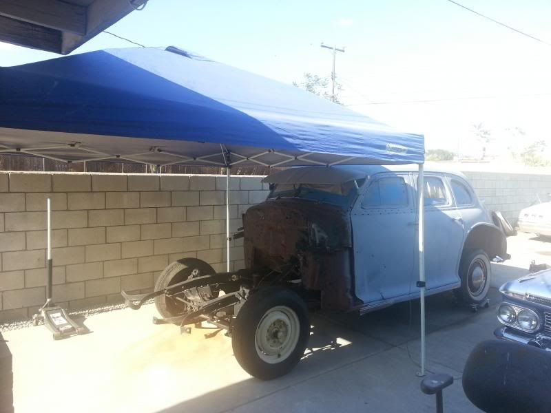

    Finally finishing up my other projects and finishing up my fleetmaster. had it for about 4 years but when I got my other cars I always threw this one in the back and left it for last. finally getting around to finishing it and its very close now. bought it back 4 years ago, went to Pomona looking for parts for my 65 one sunday to look for the rocker panels for my 65 impala. only had that car at the time. wasn't looking for another car but saw this one for only $2600. thought hey i have that to play with so i called the number on the tag but the guy never answered
    so i said fuck it and kept on walking. then i saw this one, only $800 and was like fuck yea ill take it for that
    so i called my dad to bring me a trailer. when i was walking out to the gate to meet up with him, saw this one for $4500
    when i saw that one i thought no, i want a fat fender bomb like that one but not that one itself it was in bad shape. so i went home and bought an auto trader and found this one the one i bought

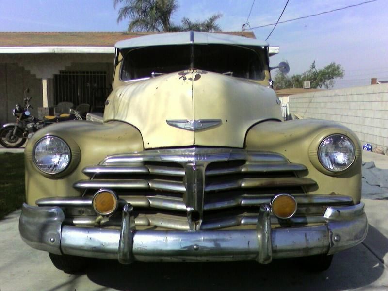

    these are pictures I took when I first went to go see it after I saw it in auto trader. got it for $4800 cash
    here it is when i got it home

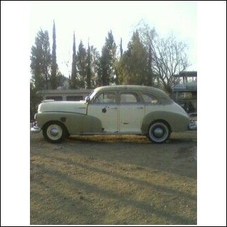

    got it a visor, was the first accessory i got for it from Pomona

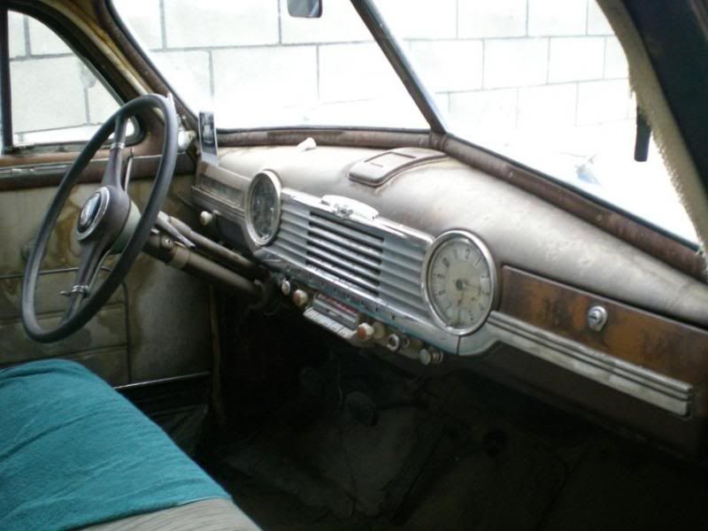

    after i started tearing down the interior it was original so looked like shit

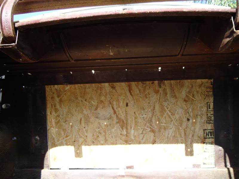

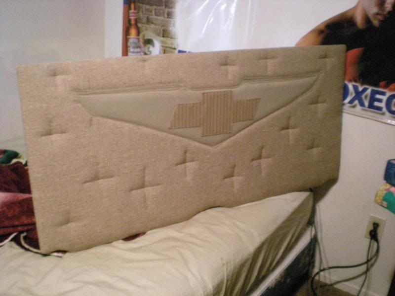

    the trunk, its the back panel. used the stars off this
    and the hood emblem for 48
    and came up with the back panel for the trunk

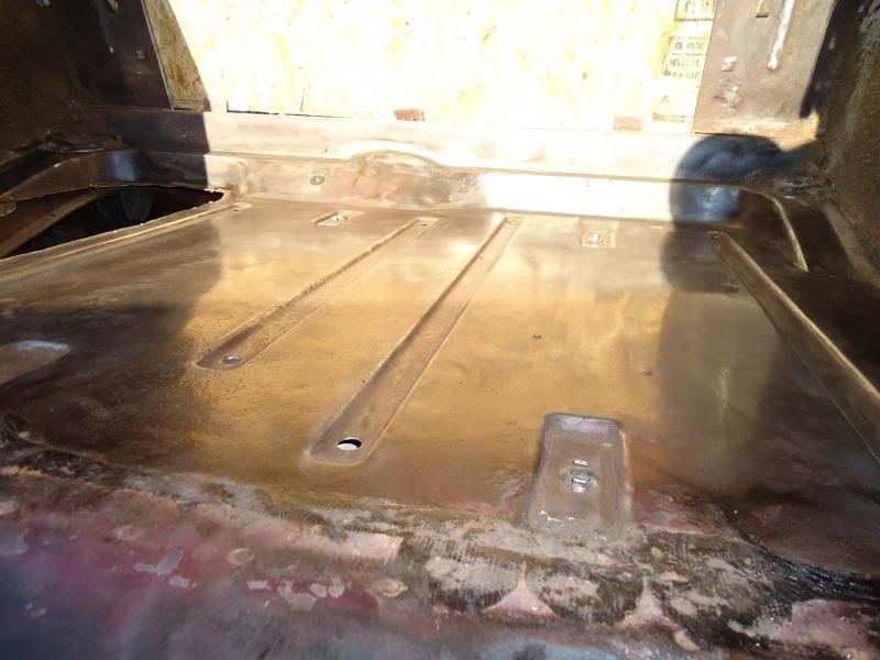

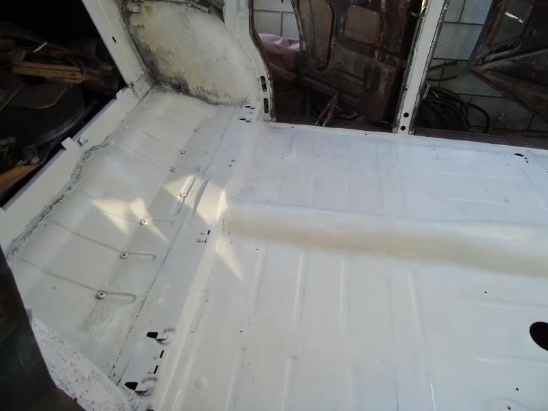

    now that the interior is out, floorwork. this is from home depot, same stuff i used on my 59. you get it at lowes, works like dynamat for heat and sound but also works perfect to seal any pinholes in the metal

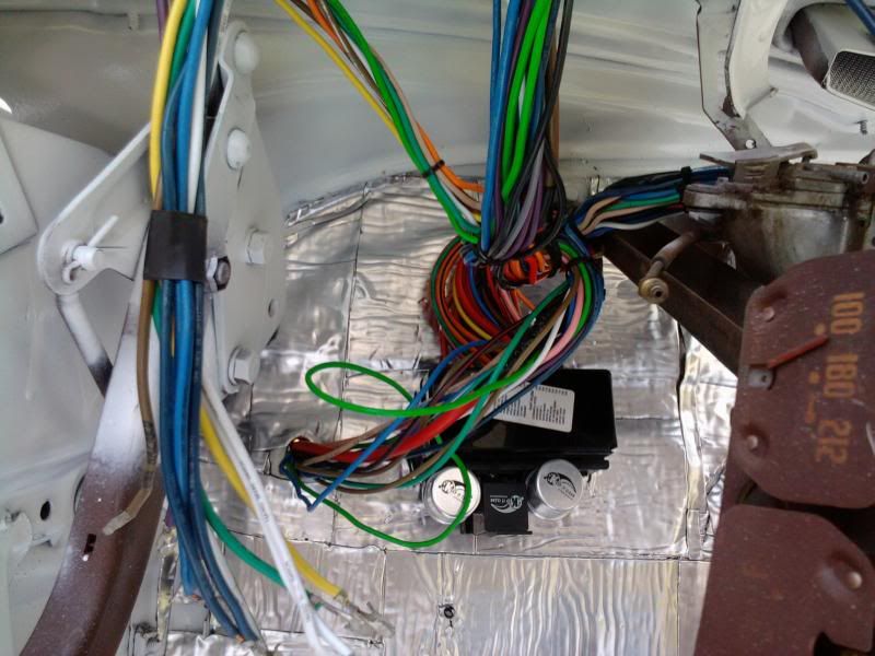

    now rewire. car had original 6 volt cloth wire, no good if you run a 12 volt battery it will catch fire. so put new fuse box and wiring
    cut out the wheel well it was bad but they sell replacement tub cheap. the rest of the trunk was perfect, metal was like new. right now as it sits its the red primer and rust sealer. the only reason there is a plywood there is to keep the overspray from going into the inside of the car

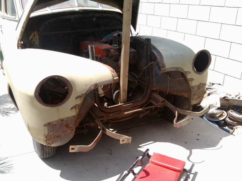

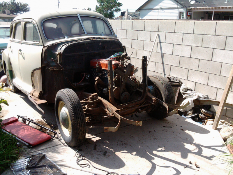

    now pull the motor and rip the front end off to get all the shit that's hiding in between the fenders and cowl then take down the car to original paint. turns out it was tan and gray, then green, then the original color the maroon red metallic
    cleaned up the frame

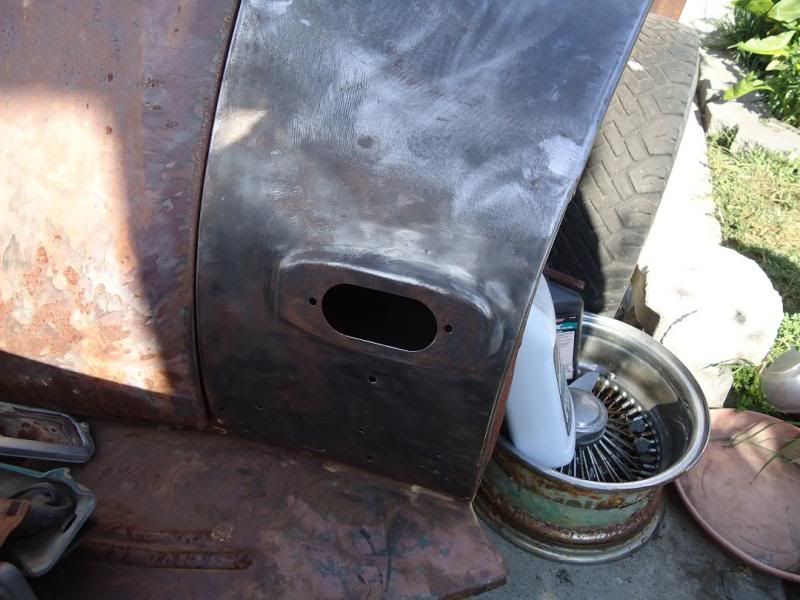

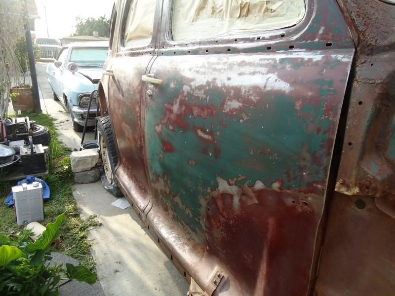

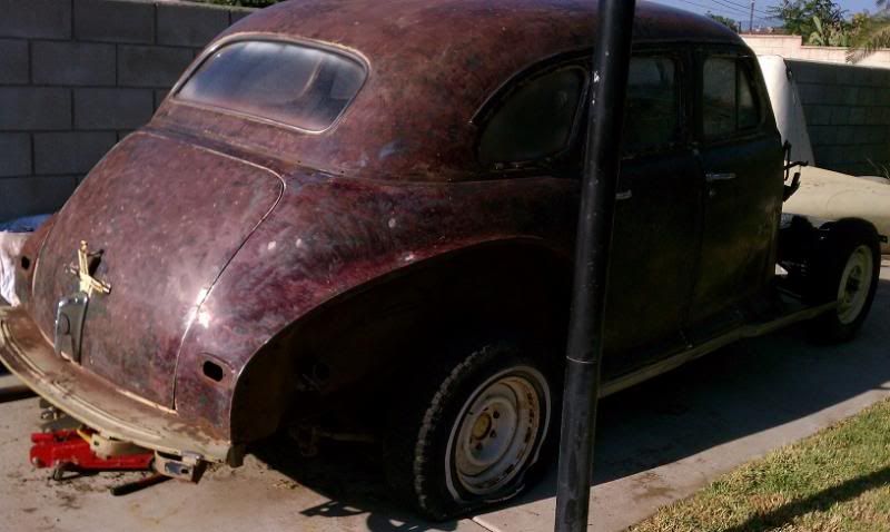

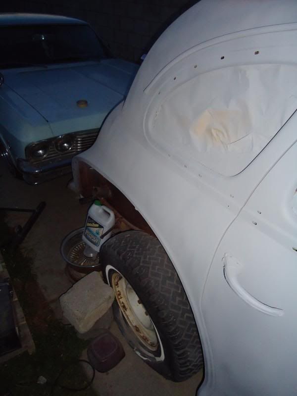

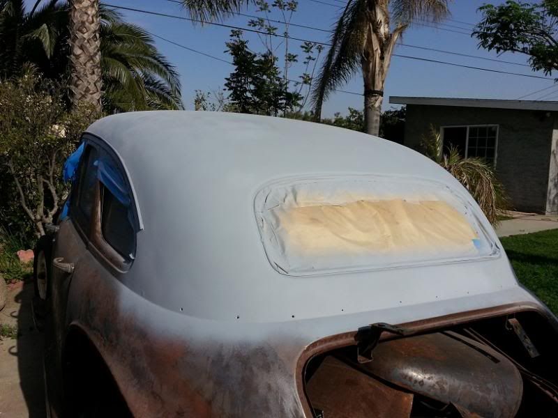

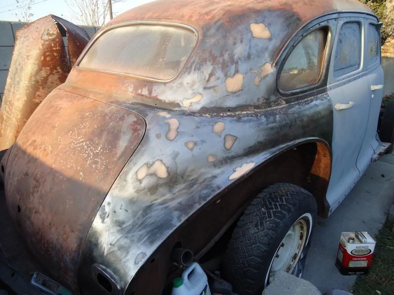

    now we start on the doors. sand, block then primer. metal is really really good on this car, i scored
    this area is usually rusted, but I got lucky the metal is good on it
    very little bondo, just skim coats

    again little bondo, thin coats not one huge layer I sculpted

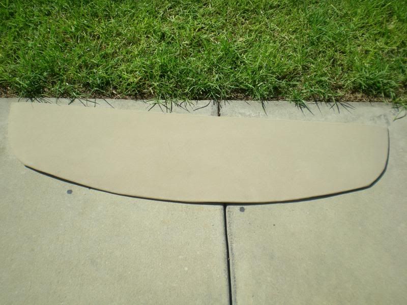

    where it looks blotchy is because I sprayed the primer extra thick to seal up some sanding scratches

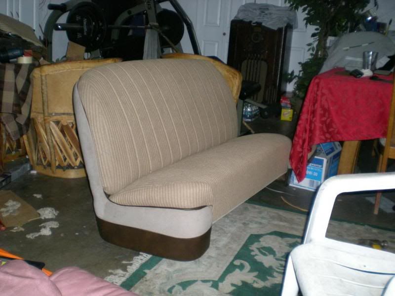

    new carpet

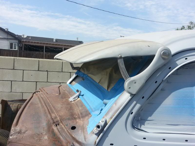

    mocked up the visor today before I sand it and block it and respray the primer on it

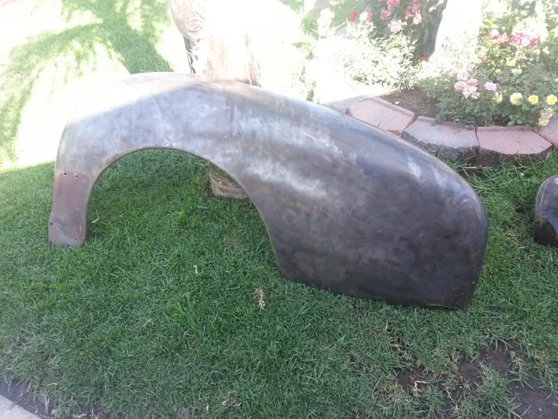

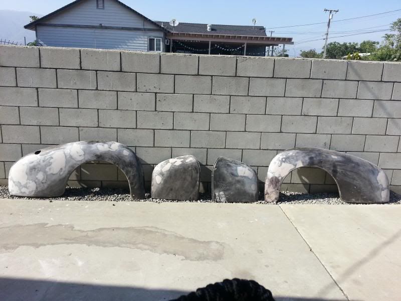

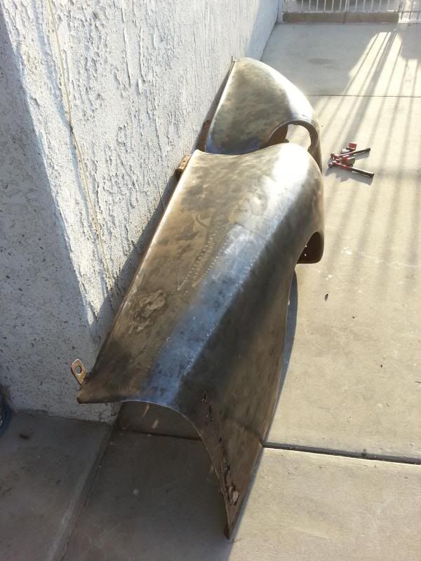

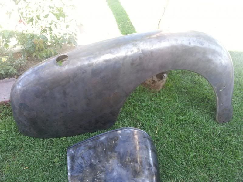

    fenders blocked and ready to primer

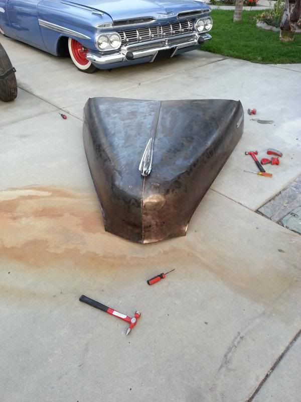

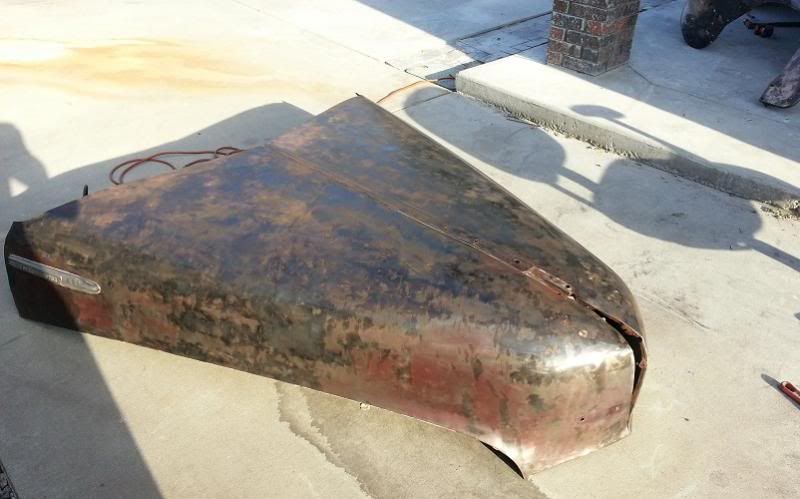

    hood was bad, and the nose was bent bad I think they used it as a step to get on the roof at some point. I thought I needed a new hood. was also worried about all the rust
    turns out it was just surface rust and was actually pretty straight

    polished this off finally, going to get the new plastic for it
    was told by 2 different guys I was going to need a new hood. few hours banging it out with body hammers, is fine now
    popped out the old rivets and used new bolts and nuts to hold it together

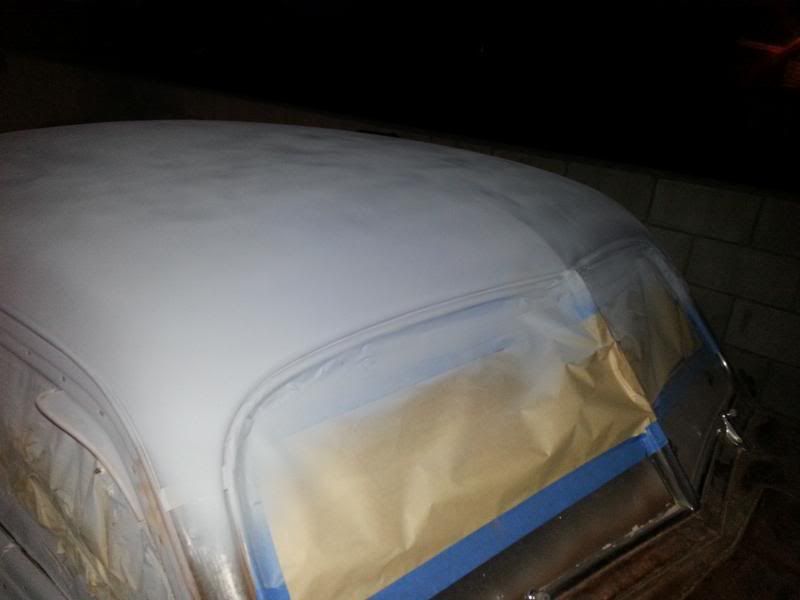

    so I decided im going flat. but good paint flat that will last years not shitty paint that will flake and get ashy or dull
    BLACK AND DARK TAN

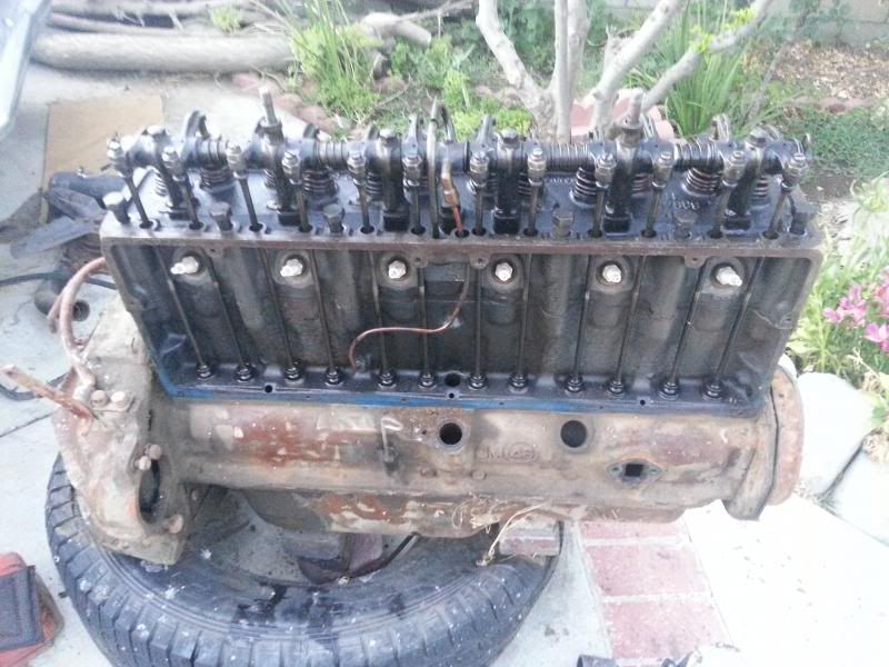

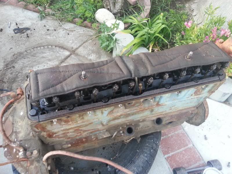

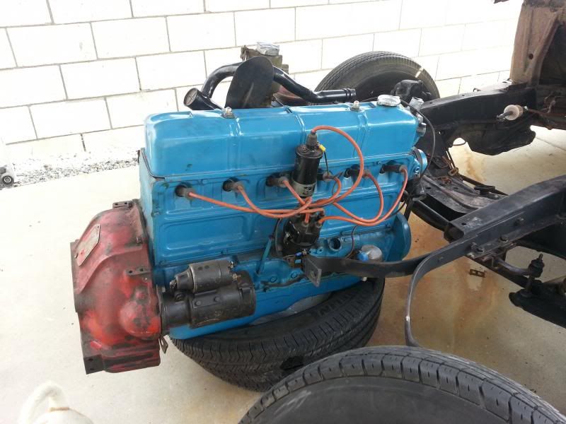

    this is what the top end on my new motor looks like
    and this is what the old motor looked like, like I said only 2 or 3 sockets tears this whole motor apart. the old motor had some kind of baffle or filter pad
    im going to have a good set of heads, block, water pump, fuel pump, generator and coil for sale if anyone needs something off it
    only other thing youd need is a cherry picker if your motor was out. what im showing is a home build not a shop build. the flat paint is in transit I get it Wednesday.

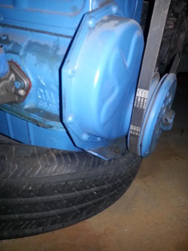

    ran into a problem today. the motor I bought if off a truck, casting number 383574
    which is correct for 52 chevy 216. but again its off a truck so I have to take the motor mount plate off my old motor that has the dual motor mounts on the sides
    to replace the truck one that has the motor mount in the center
    so I guess I have to take off the timing chain cover and everything there to swap out the plate. pain in the ass but have to do it.

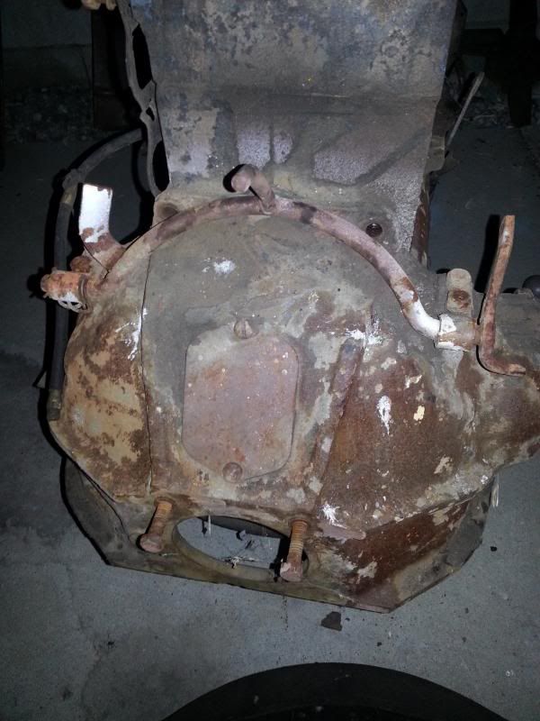

    second problem. the motor I bought had a bell housing for a 53 truck. so the transmission I have doesn't line up on the mounting bolts. heres mine
    and heres the one I have on the new motor, casting number 3835201
    the bolts are wider and farther, and has some lever on the side that my old one doesn't have
    so it looks like I have some work to do tomorrow. the guy I got the motor from had the tranny that fits this motor for 200, does anyone know what tranny that is that goes in that bell housing? is It better and will it line up to my linkages and mounts? asking to see if I should swap it or just use that one. he paid to get the whole internal bell housing redone but will it take MY bell housing? mine is og 216 3 on tree for 48 chevy car
    im just glad the motor itself is a 216 and the internals and side components are good and ready to go, its just the front and rear I have to work on but the motor itself is good

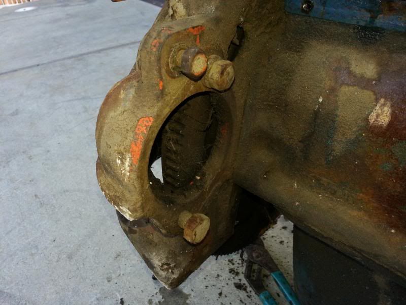

    ok so now im not worried about the front motor mounts I can just drill out new holes, but am missing the rear mounts. well one of them. I have the one for one side
    but missing the other side that mounts with the starter
    and now, the bell housing. have problems again. to take the bell housing off theres two bolts on the top, and 4 bolts on the inside behind the flywheel. well my old motor is seized. wont turn. I thought I was turning it but it was just the fan and water pump. I left the motor out the car a few months when it rained and the cover came off and got water into the cylinders. well its seized now. I have a new motor so I don't care, but now I cant get the motor to turn so I can get to the last 2 bolts holding on the clutch to the flywheel. and if the clutch cant come off, the flywheel cant come off, so the bell housing cant come off. and its too tight to get a wrench or socket in there
    I sprayed this in all the holes, let it sit overnight. but don't think its going to work its too stiff
    anyone know what I can do?
    and my other issue, doesn't seem as big but I cant get the bolts off the flywheel on the new motor I have. theyre tight! and when I try to ratchet them out the motor turns as well so I cant get them to come off
    I got frustrated so im done for the day. ill get back in it tomorrow. more worried about how im getting the bell housing off the old motor I feel I might have to take a torch to it or try to cut out the middle of the clutch
