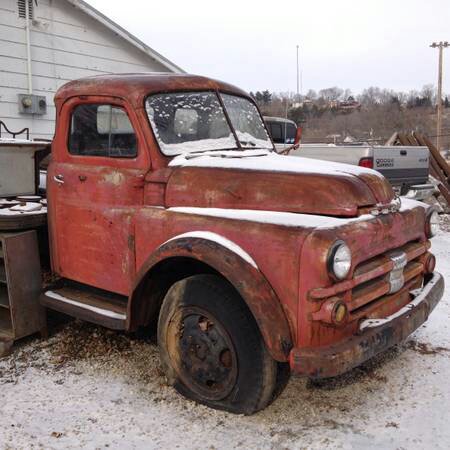

    I just picked up this 51 yesterday.anyone know how much of a difference there is in the front fenders on the big trucks compared to the 1/2 tons. The fenders seem to have huge openings.

    The fenders are huge , there is a guy in Calgary that moved the front fenders in and added to the rear 1/2ton box fender and put it all on a 1/2 ton Dakota frame it looked sweet , I will try to find pictures ,I think he removed 1.5" out of the front fenders ?

    Thanks Fargo52 I've been watching your progress. I'm going to try and splice the Dakota frame to the front of a 58 frame I have laying around.

    Check your dakota frame there is an area where the Dakota transitions from the front boxed area to the rear C frame it's a perfect area to marry up the old and new frame , using the old rear portion of the frame you won't have to modify the truck box bed area .the only issue is ride height if you want to slam it to the ground you can't unless you make more mods to the rear axle area of the frame , my 52 pickup is lowered 3" by removing some of the springs and it never bottoms out.
