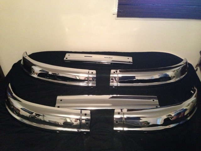

    Also picked the bumpers up from Custom Metal Finishing this weekend. They did a great job, couldn't be happier.
    mgtstumpy and Sauli like this.

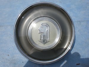

    It's always like Christmas when you come home to boxes on the doorstep. Got my steering wheel from brigrat today.
    Pictured with my re chromed horn ring and nos horn button.
    For those that don't know, Pontiac stuff is hard to find. I had two wheels already, one with the plastic center hub (death trap) and one with about 15 cracks in the stainless bangos.
