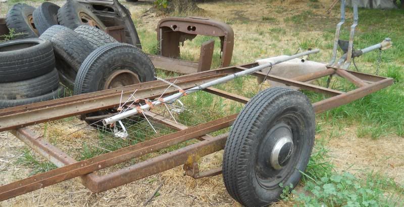

  6. Can't see it very well in this shot, but the tongue is round tube, approx 2", I can measure it when I get home, and the rest of it is channell. This is an original frame. I am pretty sure they are all like this, the whole frame is not made from round tube, just the front.
    Here is a link to the build thread of mine.
    http://www.jalopyjournal.com/forum/showthread.php?t=602690
    Good luck
  7. Kits did not use round tube for their frames. They were channel and angle iron
  8. As others have already posted, the tongues were made from round tube stock and the frames were fabricated from angle/channel iron (ala the frame in flt-blk's pic).

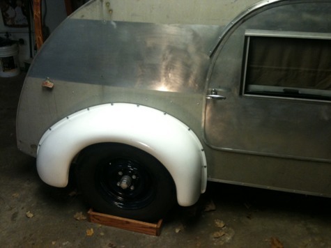

    Also my fenders have the fiberglass flare going up, is the for a specific year?

  14. This is a new fender from the original 47 mold
    I was told early 46 didn't have fenders (like mine)
    Late 46 had flat top sheet metal type fender
    57 had the fiberglass fenders
  15. NOS fenders from George at teardrop Fix-It-Shop
