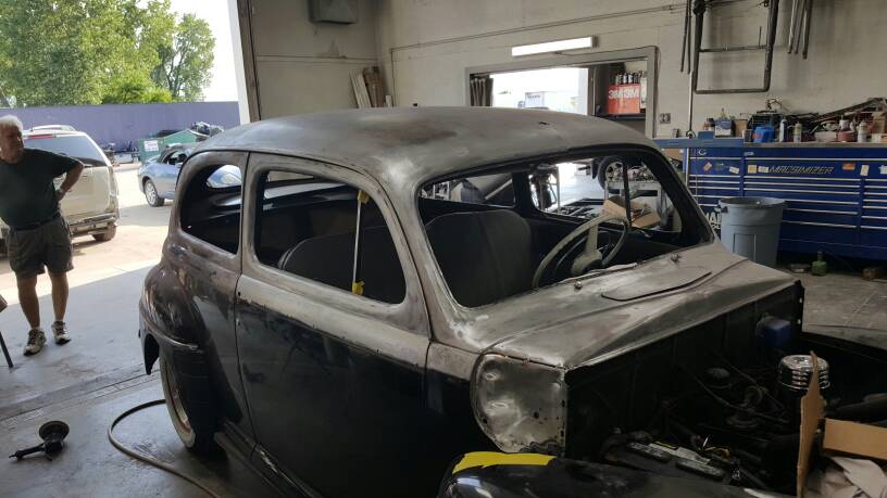

    It's been a while so probably time for an update.
    Had a lady ask me a bunch of questions when we were at a cruise in a while back. Long story short she was a writer for a local weekly periodical. That lead to the chairman of the des moines concours calling me and asking about having my car in the post war collectibles class at their upcoming invite only show. I told him it was rough and probably not what he was looking for but he came and checked it out anyway. And it wasn't what he wanted like I predicted. But I told him about our 1919 Oakland we have that would be good for a preservation class and we got invited to take that, but that's another story. Anyway that all got me thinking I wanted to do something about the paint peeling all over the roof and having bare me take exposed all over. So I got quotes from a few shops around town and ended up having the roof (trunk to cowl between the drip rails) and hood painted. Which morphed into stripping the portions mentioned as well as smoothing up the rest of the quarters and the tops of the doors from the trim up. It took about 4 weeks and looks great. Not too showy but it blends well with what wasn't painted and looks great. Even said when he stripped the roof there was absolutly no dents or bondo in it at all just perfect tin.
    Part of the deal was he would take out what he needed to of the trim and Windows etc and I would reinstall. Personally I'd rather reinstall that stuff myself as I wanted to take my time do it right ad fix an issue with the rear smokers windows before reinstalling them. While it's was back home and in our shop I got a call from Nostalgia sids that my axle was ready and he needed my spindles so he could drop the steering arms, fit new kingpins, and send it all back to me. So now I have the front suspension all torn apart so it's ready for the new axle. And I'll keep reassembling the trim things while I wait for the axle to come back.
    Fun times.
    Pics to follow.

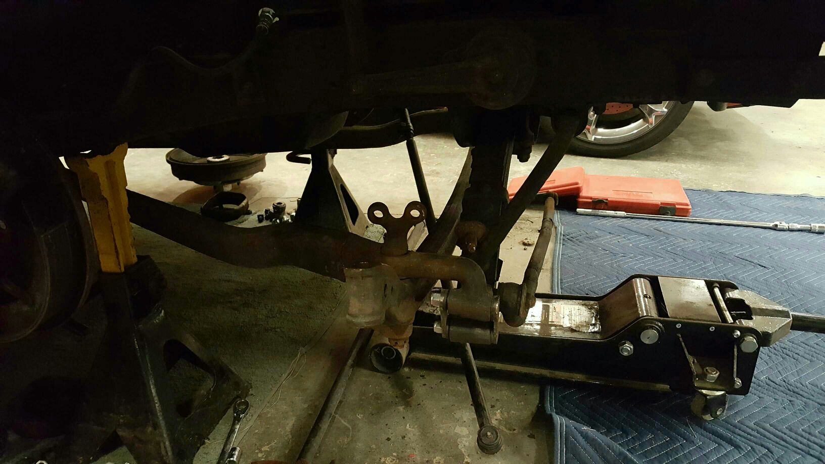

    I came out to the shop tonight to finish taking the axle and wishbone or so I can get ready for the new axle and so far all I've done is update my hamb thread...oops... time to get to work I guess.

    Any tips for getting the perch bolts out of the front end so I can separate the axle and wishbone. Does anyone make these perch bolts with the 2 hokes for shock and sway bar links on the top? Or do I need to save them?
  12. 1-SHOT
    Joined: Sep 23, 2014
    Posts: 2,691
    1-SHOT
    from Denton
    Have you tried Acetone and ATF mix and it it soak. I don't know if there replacements available, check with Mac or one of the outer restoration suppliers. Some times you can use a large gear puller to push out the perch out why applying a little heat to the axle to expand it. The trick is heat the axle not the perch bolt to expand the axle while pushing it out with the puller. That's my 2ct worth. Frank
    redzula likes this.
  13. Tim
    Joined: Mar 2, 2001
    Posts: 17,040
    Tim
    from KCMO
    I've always had to fight them, and no one makes them.
    I'd get it out of the car, turn it upside down with the nut on the end so when you get the axle hot and wack it you don't mushroom the pin.
    Maybe try an air hammer?
    redzula likes this.

    Well it was going too easy. I messed up one of the perch bolts trying to get it out. Can't buy new ones sok I'm going to have to hunt them down. There's a guy in town with an axle I can take apart myself (and risk messing it up again) and he suggested calling a guy out in Nevada which I tried but wasn't able to get ahold of yet. If anyone knows of some NOS or used ones in good shape that still have the tabs for sway bar and shock links on the top let me know. I'll be making a wanted add for them too

    Got one side out just fine by using heat on the axle and then an air hammer with a rivet tool bit. The other side was not as easy to break free. And I tried the same thing but it wasn't working s I grabbed a 2# hammer to try and get it started moving, bad idea, first hit mushroomed out the end.

    A local guy has a stock wishbone and axle he said I could have the bolts out of if I got them out. So this time I'm going to try head and an actual press. And if that doesn't work I have a NOS bolt I found from a guy out in NV but he wants $125 + shipping for it so I'm going to try luck with the local guys axle first.

    Got them out. Tried a press but that didn't work. I ended up cutting the axle up (it already had the ends cut off when I got it so no good axles were harmed during the process) which helped get some heat in it the an air hammer used more wisely this time and then slid out. I picked the 2 best bolts and nuts of the three usable ones I had and cleaned up the threads. I threw the bolts in the freezer for a few hours and then put the new axle together. Freezing them made the bolts nice and easy to put in.
    Then I worked on getting the shock and sway bar links out. They were all easy except the ends in the end of the sway bar but I got them eventually. New links in and should have the brakes and wheels on tonight or tomorrow depending on when I get out to the shop.

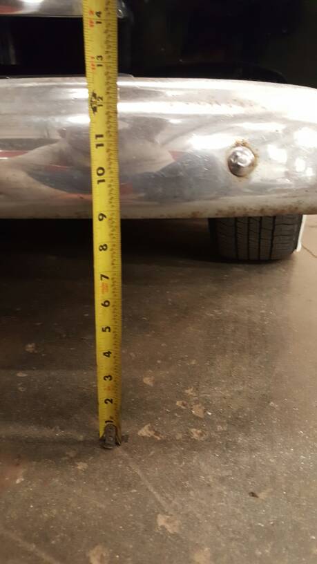

    Before the axle shot forgot to take the measurements from before but it hadn't settled too much from the spring install before I started on the axle.
    Edit: just went back and checked. The measurements are almost exactly the same as when I first bought it and like the stance then... now it's without all the suspension noise though like when I first got it... much better.
    48fordnut and Tim like this.
