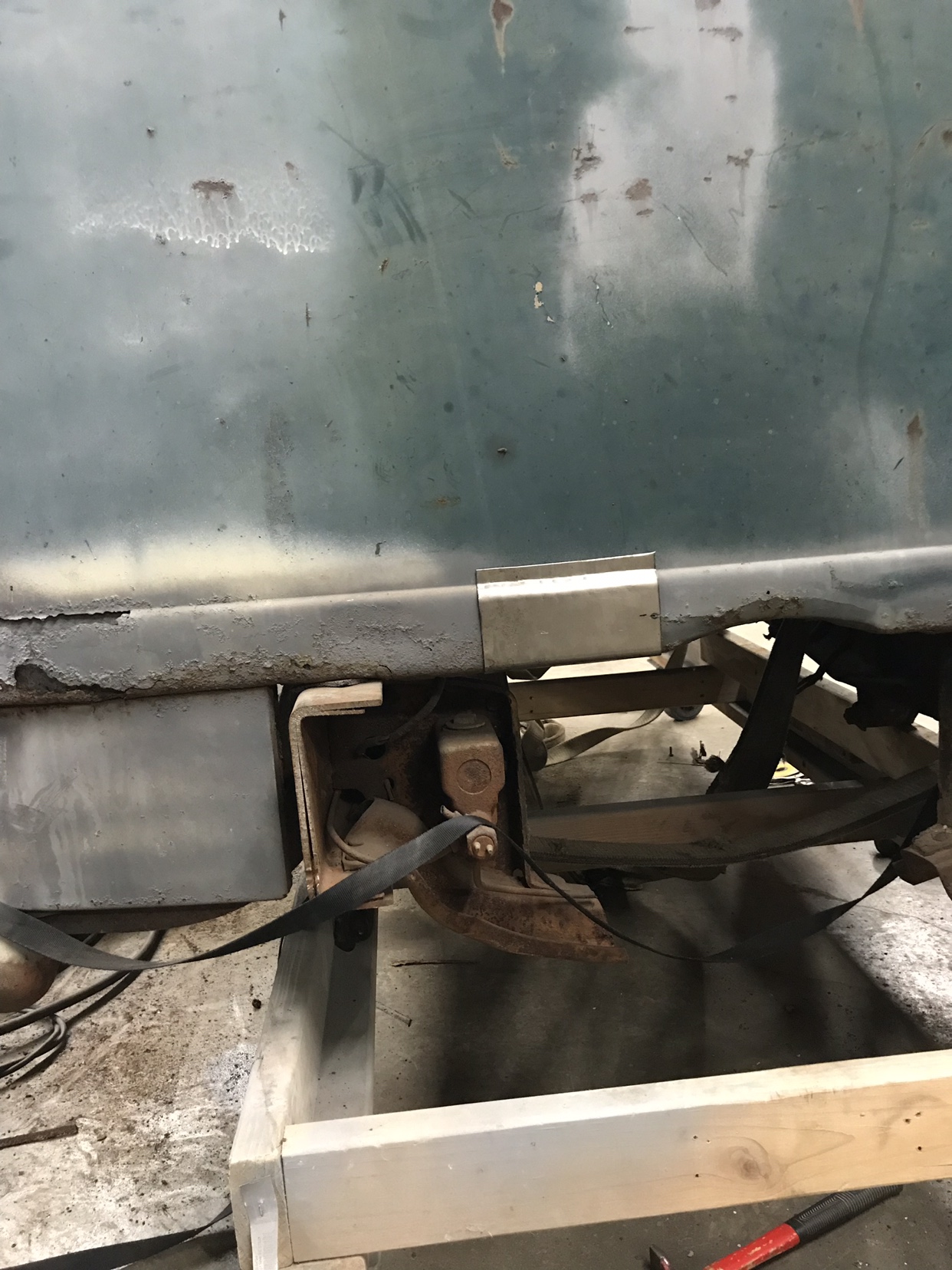

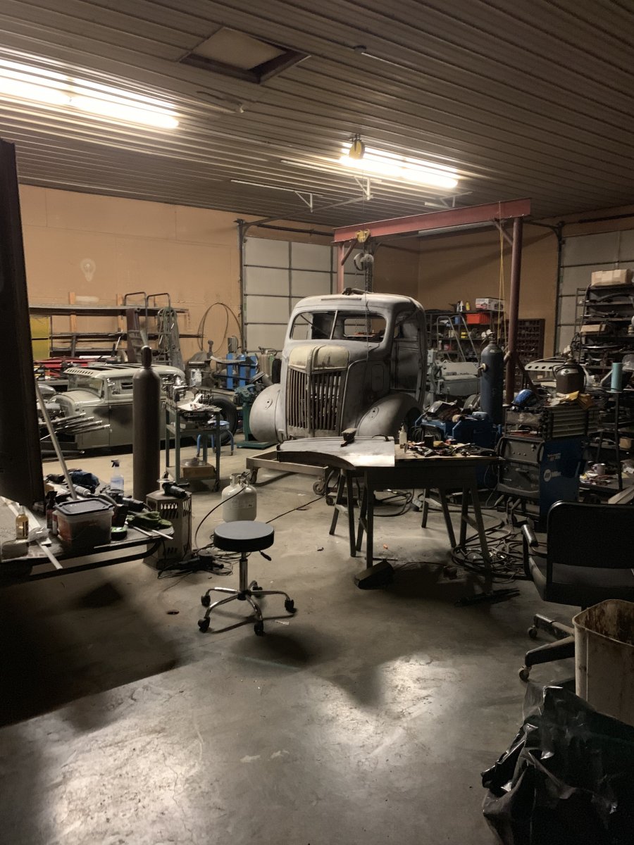

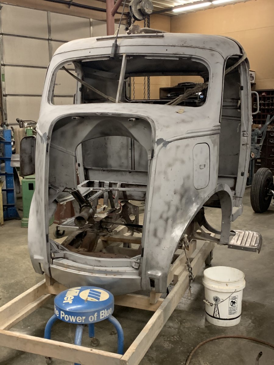

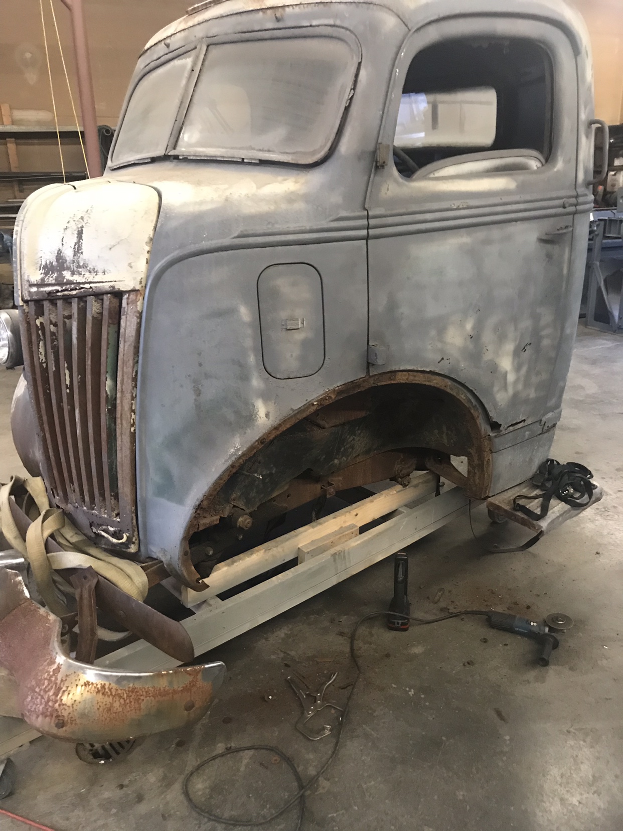

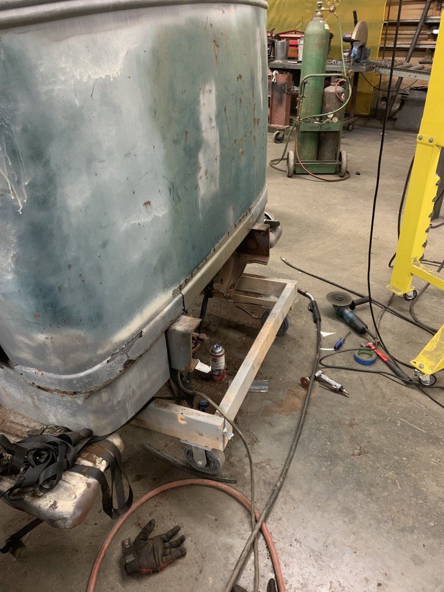

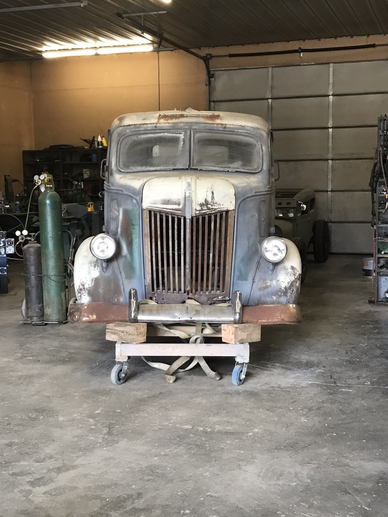

    So, I recently finished a 1930 Ford Model A coupe and had every intention of building a 1930 Roadster, but something else nudged that project out of the way. The encroachment of a 1947 Ford COE happened upon me and now takes precedent over other personal projects.
    It’s in remarkably good shape give it’s age and life as a work truck.
    First step was to pull off the fenders and straighten them up. That required a lot of hammer and dolly work coupled with welding up several years in the metal.
    Once those were relatively smooth, they each went into planishing hammer for further smoothing. They then were set aside.

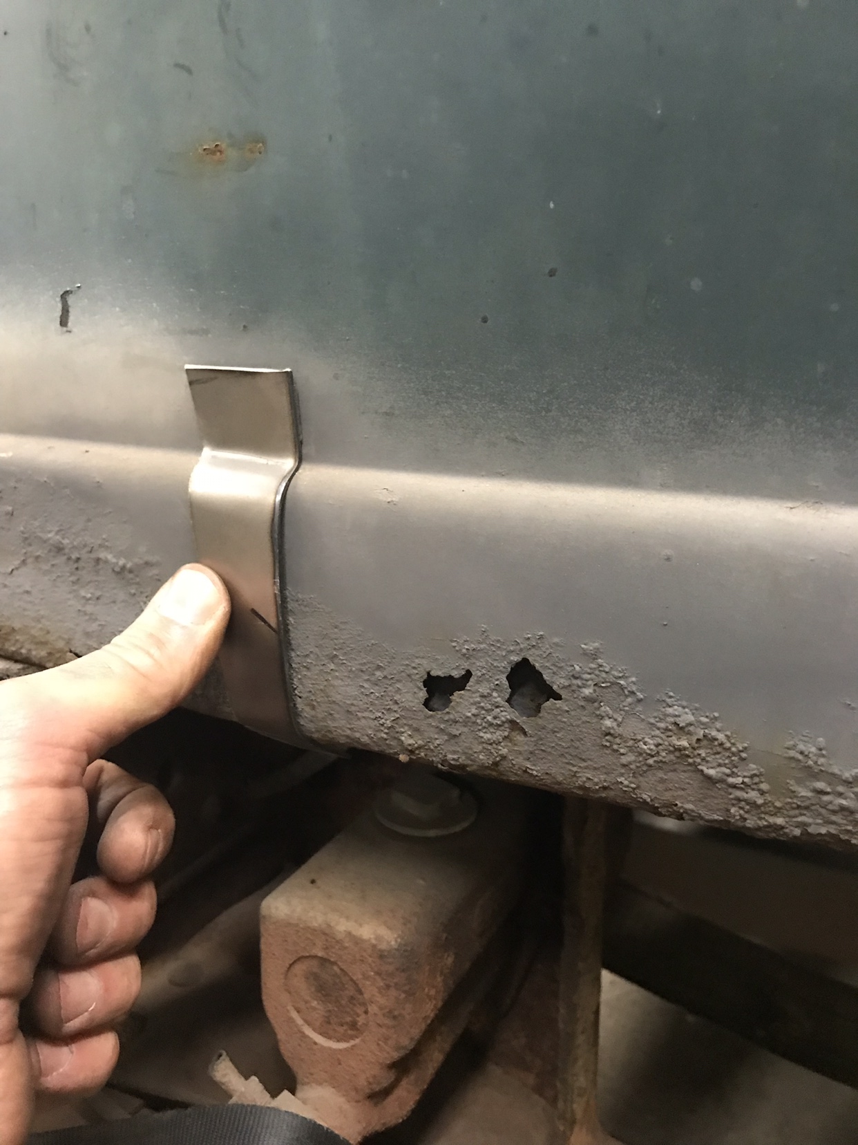

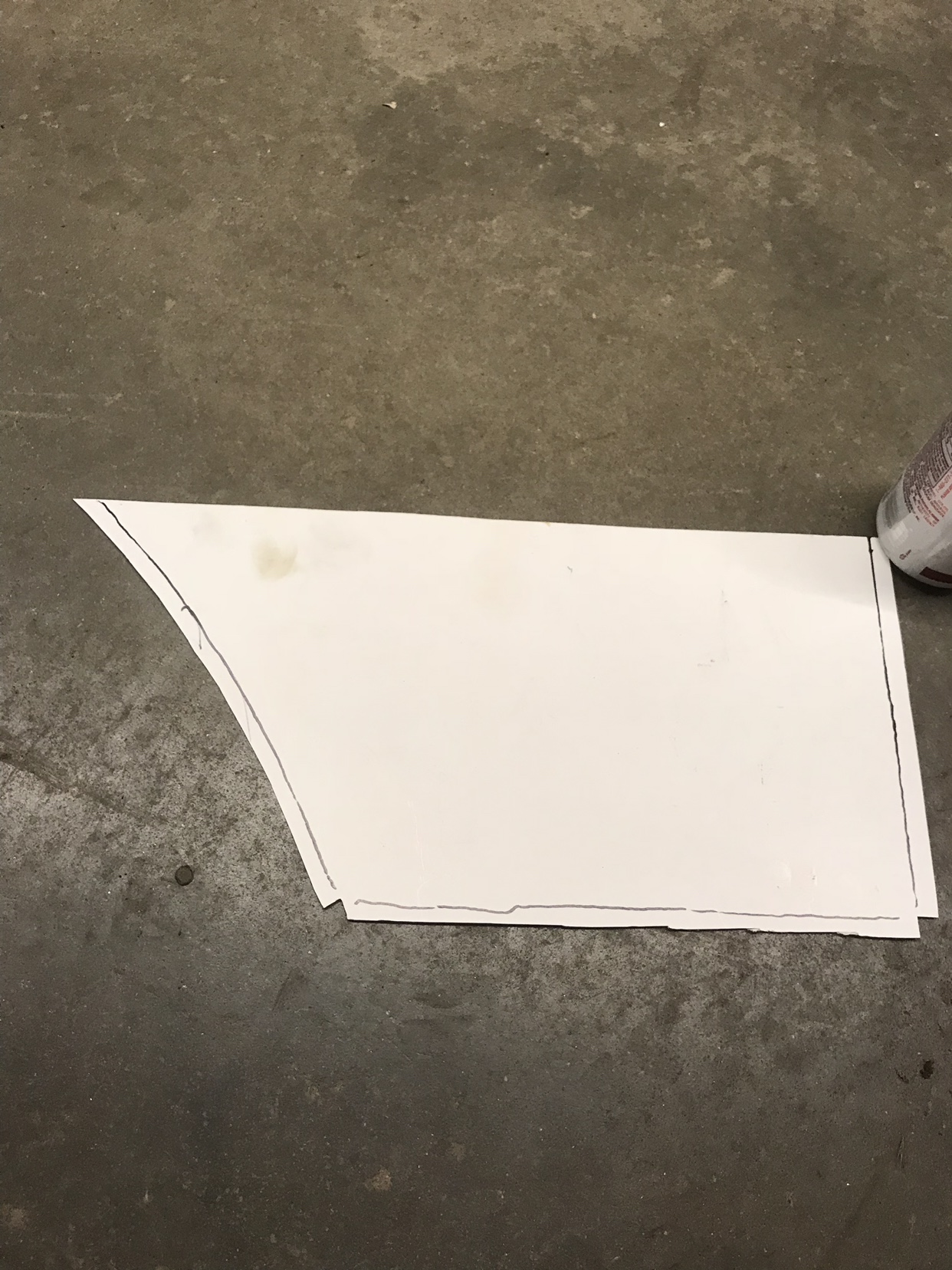

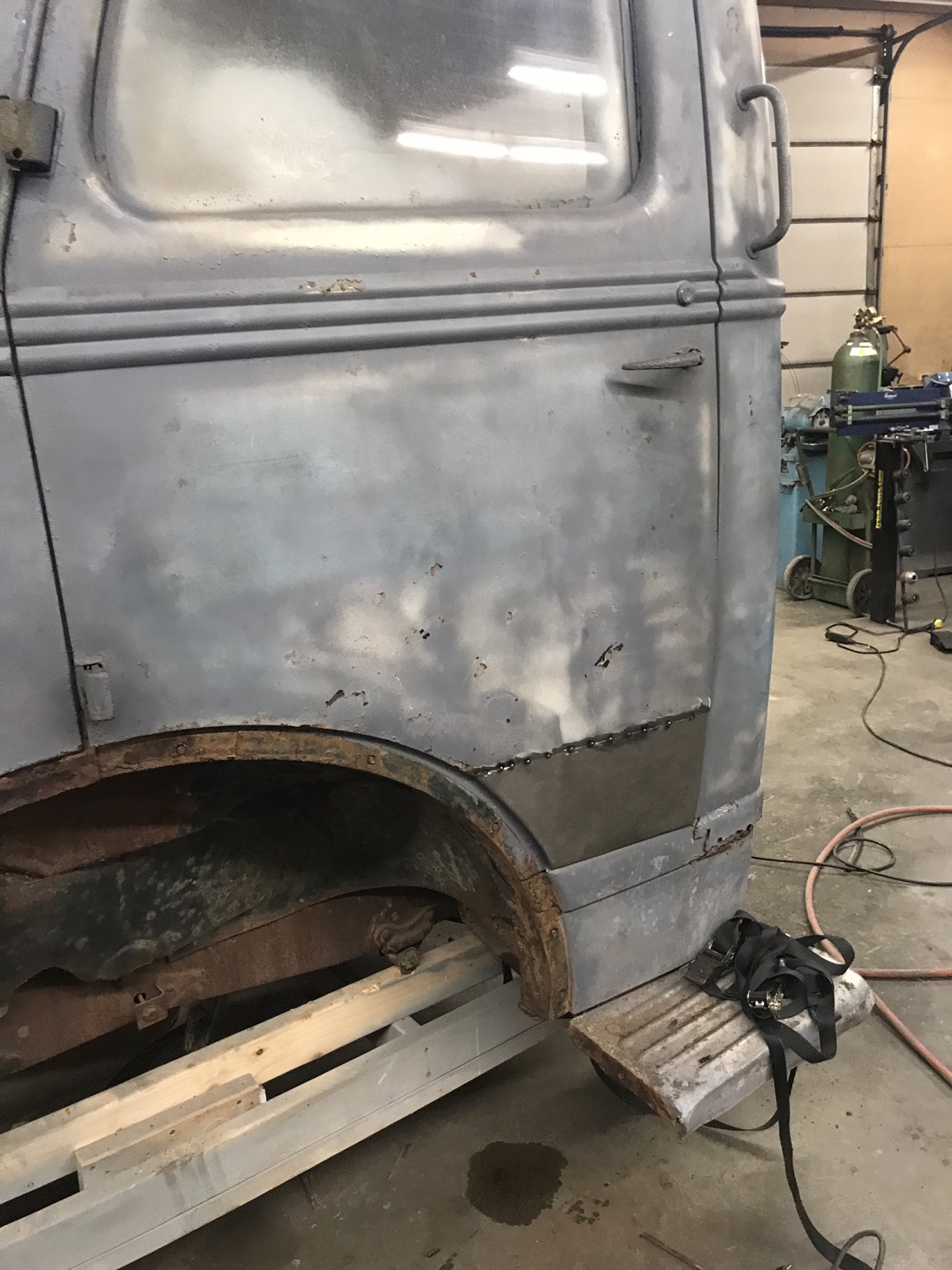

    Next was the lower door patches. Started with a paper template slightly oversized so that I could throw it in the brake and bend it to wrap around door frame. Once I had the General shape they went into a shrinker stretcher to get the correct contour and bend of the original door.
    Cut the old out and as to be expected the internal structure was gone so I had to make that first. So, I made that and then put the new panel in place. Did this for both sides. Just tacked the panels in place. At this time I also realized that the original door gaps from factory were an afterthought at best. Body stampings at the door seam are curved and not even side to side. I will correct that later.

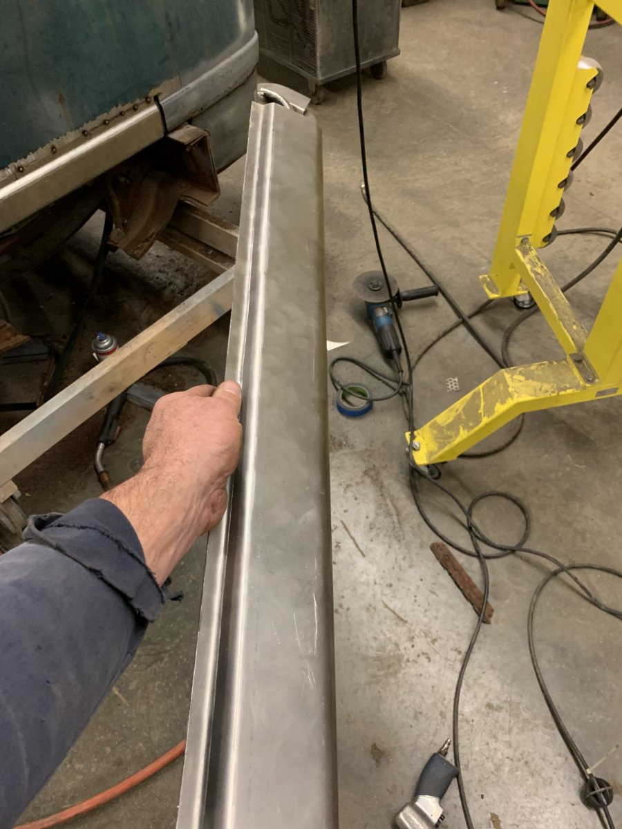

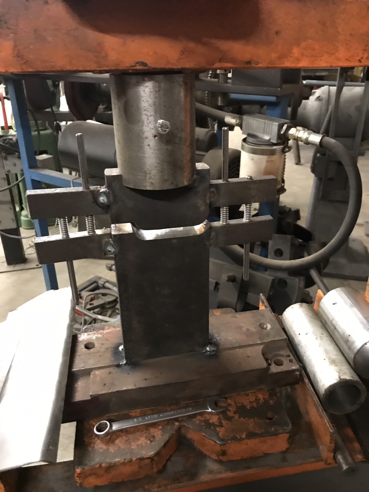

    The latest progress is the lower perimeter bead. I am a bit stumped over this but reached out to Matt at Iron Trap Garage for ideas. Simple answer is there are no easy ways to make this piece.

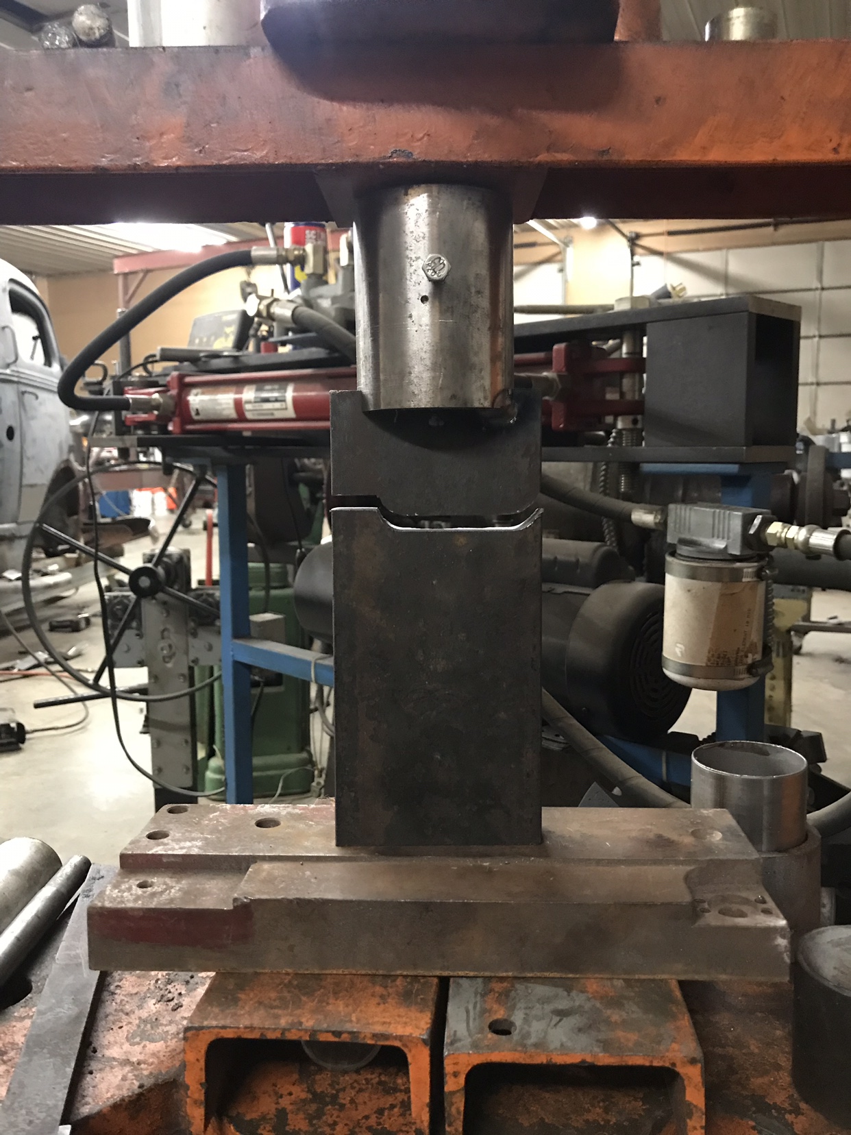

    I machined a die to use in a hydraulic press to form the bead profile which works but over such a long span it deviates from straight. So, it looks like I will machine some dies for the bead roller to start the profile and the. Run it through the die press and then again through the bead roller.
    For the corners it looks like I will machine a big thick piece of plate with the bead profile and bend it like the corners. I’ll use this plate as a buck to form.
    Fingers crossed. [​IMG][​IMG][​IMG][​IMG][​IMG][​IMG][​IMG][​IMG][​IMG][​IMG]

    I had a little time this evening and got up to the shop. I made a set of dies for the bead roller. By making a bead first, it allows the piece to seat easier and straighter in the die. Getting there. [​IMG][​IMG][​IMG]

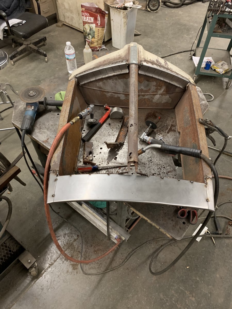

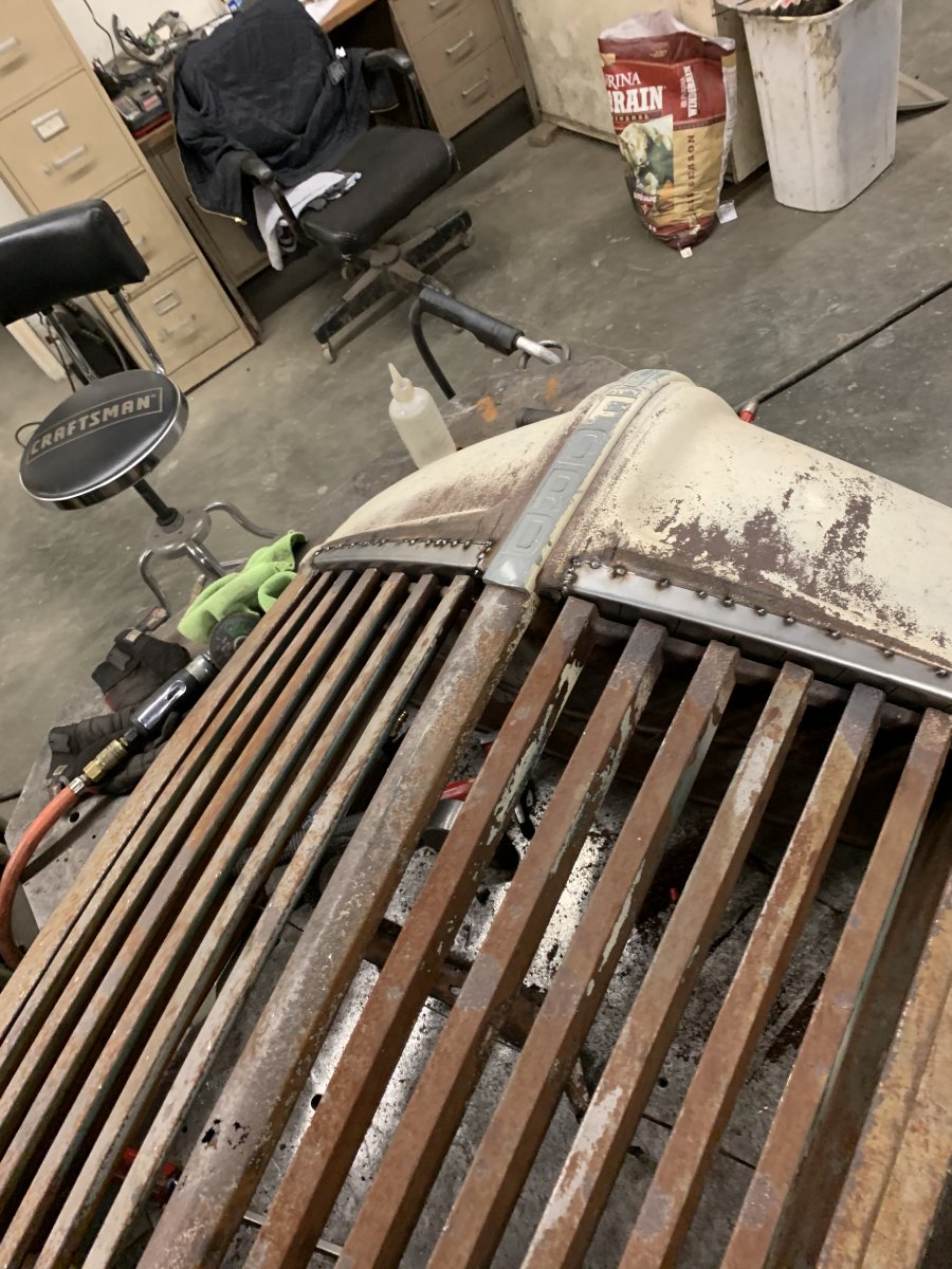

    Only had a few hours to mess with it today so I went after the grill. [​IMG]

    Had a couple hours. First bead rolled the lower piece to the correct profile. Then tacked it in place. Then it was on the the center spine. I had to remake it because something was a hair off.
    Gettin’ there.

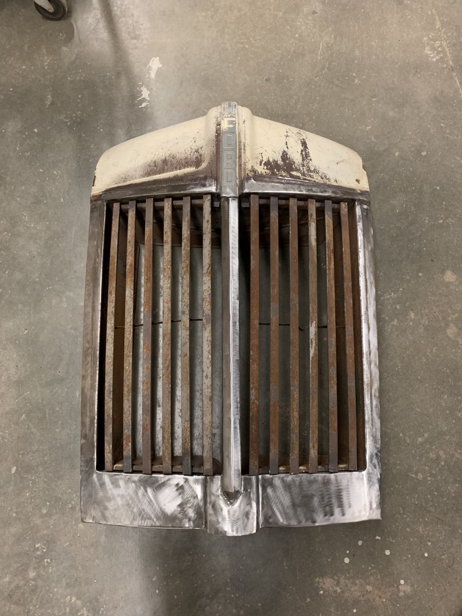

    Had about 3 hrs to play this evening. Welded up the grill, hammered some high spots and low spots and set it in place. Then got started on lower bead along entire lower cab.

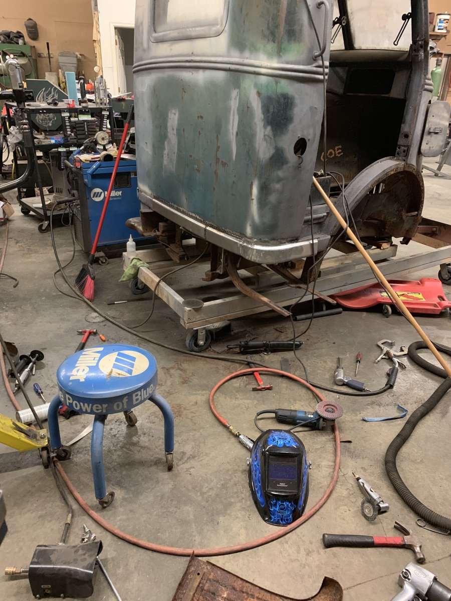

    I got a few more hours in at the shop. Hoping to have all the body sheet metal repaired and/or replaced by next weekend.

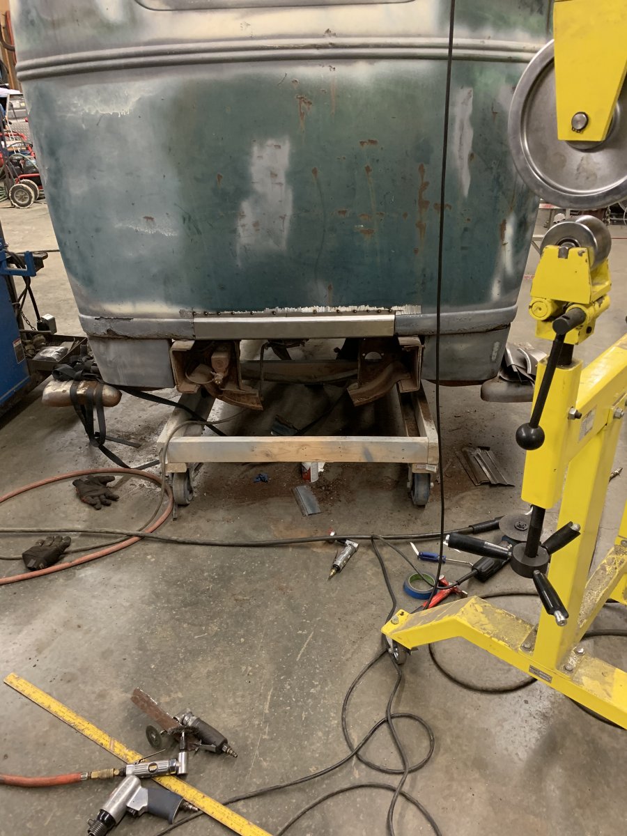

    A little more time to peck away at it. Straightening the step on driver side. Also got the remaining lower bead all the around to driver side as well. The nice thing about these big trucks is they were built with thick metal and higher quality metal it seems. Yes there is some rust in spots but the good metal is a mother to cut through compared to the newer steel these days.

    Lower bead is complete. Gas filler hole closed and started lower door jambs. Have work tomorrow but should. E back at it and finished with body sheet metal by Friday.

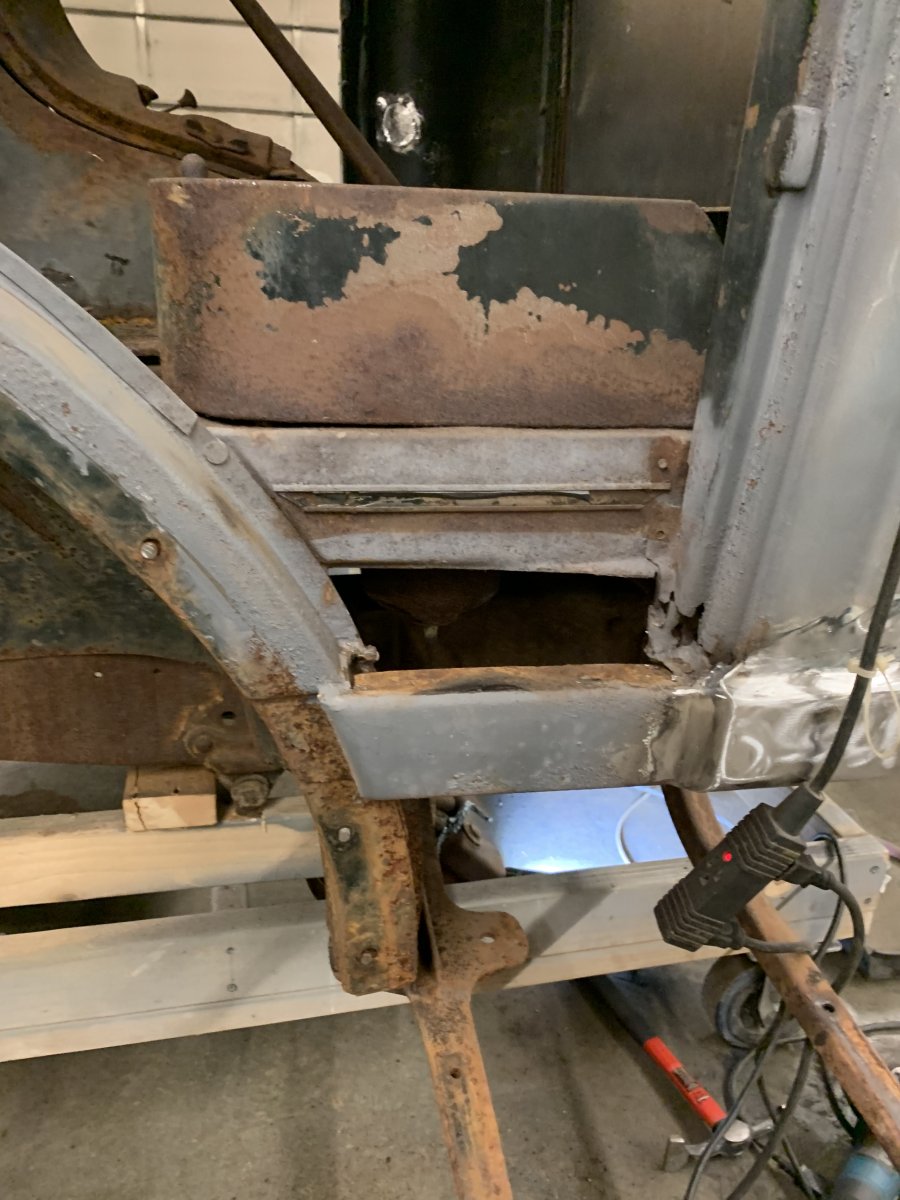

    Fixed the rot. Found a couple other spots I will tackle next time.
