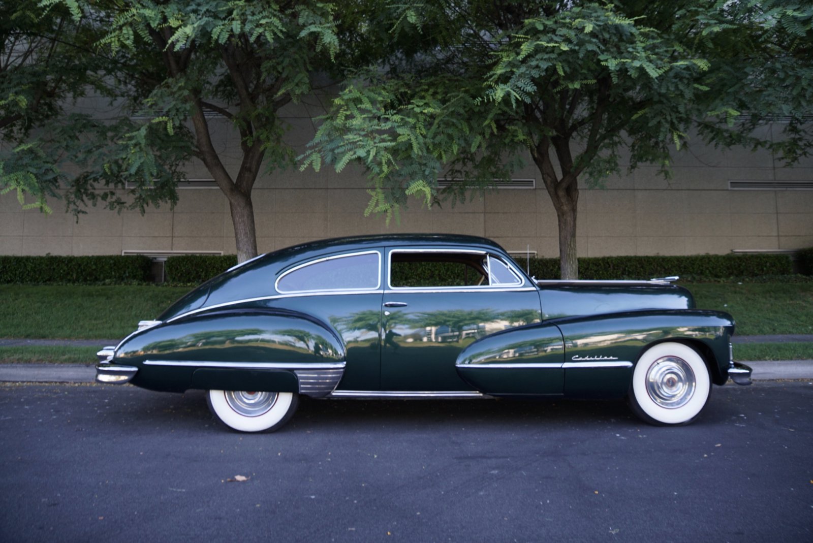

    A buddy of mine has a decent 47 Caddy long wheelbase coupe like this nice green one, but in primer. No engine or trans. A long term project. Needs a ton of work.
    My question is how much engine can you put in without twisting that frame, and how much can the stock rear end take? Probably best to go with a GM 9 or 10 bolt, LSD.

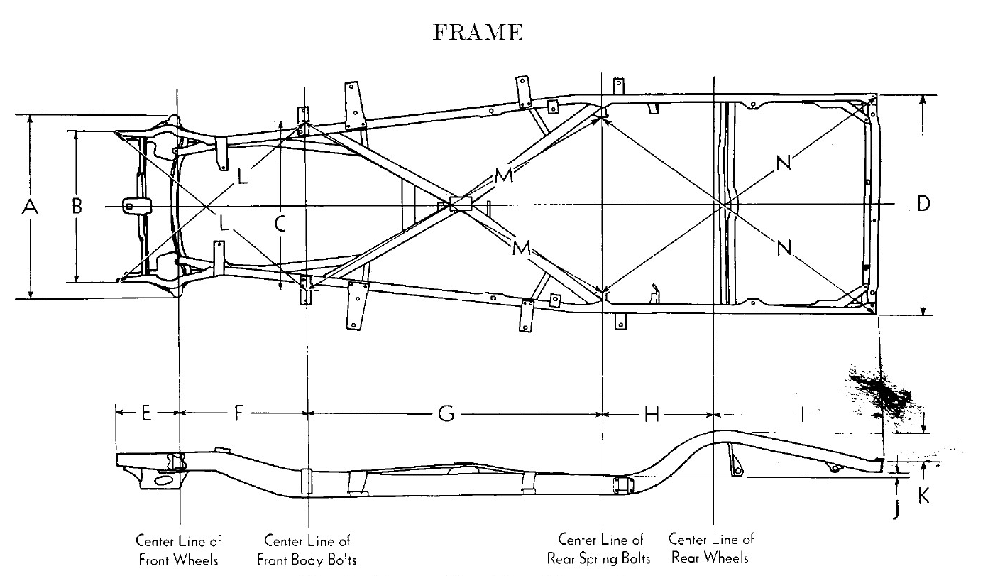

    Appears to be large 'C' body, series 60/62, with pontoon door caps. It's plenty strong with large central 'X' member and deep rails on 129" WB.
    A Cadillac in a Cadillac would be nice. If you use a later Caddy Mill it'll come with a T400 otherwise you'd need to adapt a 700R4 hoping that it handles the torque.
    IMHO, the OEM rear axle would most likely be OK if driven sedately with an earlier engine however a later torque monster, 472/500, would push the strength boundaries so a later (Stronger) rear axle would be better suited as they're designed to be behind those engines. Other axle housing are easily adapted to your leaf springs with new saddles.
    I've seen later OT frame clips with disc brakes & PS used however I'd look at improving braking and steering only when necessary.
    Engine mounts and a transmission X-member are easily fabricated for use with OEM frame.

    I'm assuming this chassis is the same as on Buicks. I would box the outer frame rails to stiffen it up a bit. From there, you can install the rear end of your choice with a 4 link and coilovers at the rear. See my Buick thread for ideas on how to do that.
