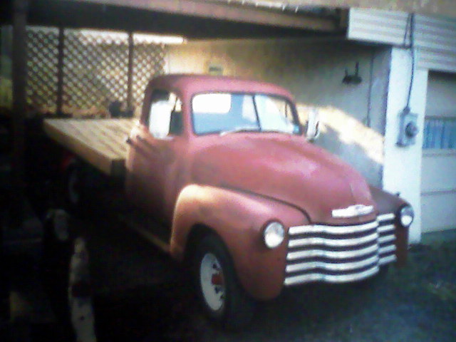

    there are AD trucks all over this board, Im building one right now but im putting it on an s10 frame

    That is a nice truck! Does it run? What model of S10 frame are you going to use on it? I might have to go that route myself. Let me know if you decide to discard any parts from your truck.

    It ran about a year and a half ago but has been parked in my dad's carport and not touched since then. Im using a 2000 reg cab shortbed s10 frame, ideally i should have gotten a reg cab longbed frame (to correctly match the shortbed AD's 115" wheelbase) but i stretched the frame that was available to me. The reasons i decided to swap frames was to ditch the 3/4 ton stuff, availability and convenience of s10 suspension components and have power steering and power disc brakes since the gf will be driving it.
    im still looking for a drivers side back fender and a set of running boards as well.

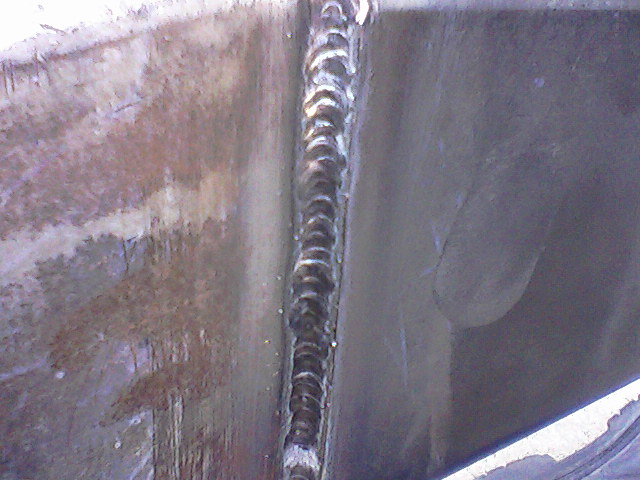

    here are a few pictures of what i did with the frame, it had to be stretched 7" total using a 1/4" thick piece of 6" channel i got from work, it fit perfectly over the stock frame. i used a die grinder and a 4.5" hand grinder to do all of the cutting and cleaning and a 110V flux core wire MIG to do the welding, i also bolted everything just in case a weld did happen to break.
