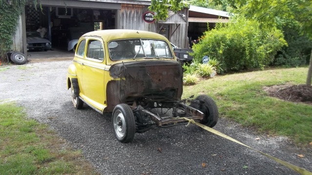

    Hey Jergen, thought I'd send a couple of pic's of my 46. Keep up the hotroddin. John
  2. Hi John
    nice tudor.
    what are your plans with it ?
  3. 1955merc
    Joined: Jul 13, 2010
    Posts: 15
    1955merc
    from TN
    I'm going to put a 390 FE ford motor and cruisematic in it that I got out of a burned 64 Galaxie that had been restored. I'm using a Jag front end, MB brake setup, camero rear, GM column, Jag wiper setup. Why re-invent the wheel. You are making this easy for me. I bought the car to resell as is but the wife deceided she like the car, so....
    Keep up the good work. John

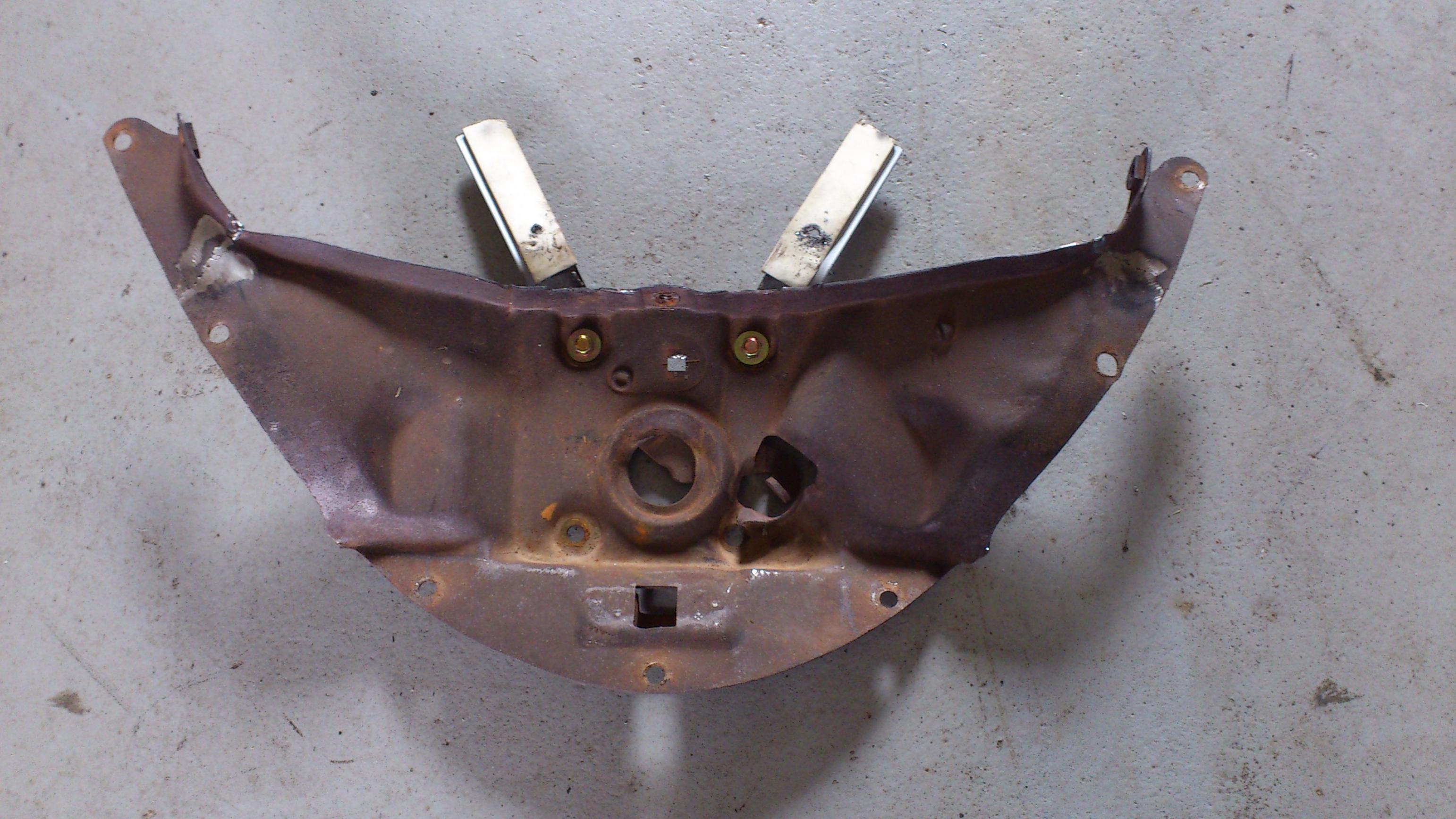

  7. made a new hood latch mechanism last week. (volkswagen)
    from left to right
    OLD,HANDMADE PARTS,NEW LOOK
    I think it looks nice and smooth.

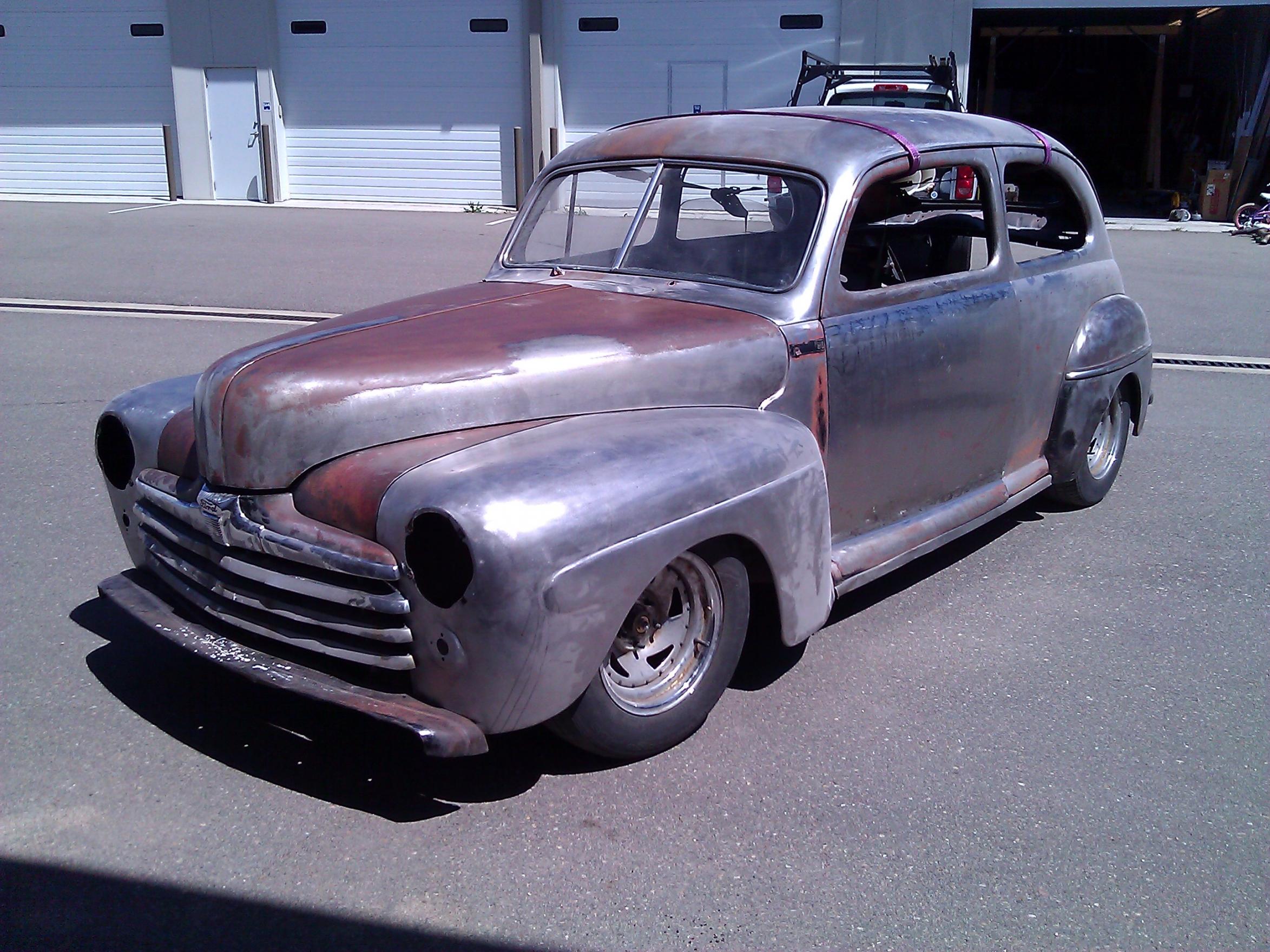

  11. Now this is the perfect stance! That black one is too low IMO. It def nice but it makes me think of those 'mintrucks'.

    I like the hood latch set up, what kind of VW supplied the parts? Also whats the rad originally from?
  14. thanks for the compliments.
    the latch is supplied by a 1989 volkswagen rabbit (they call them golf in europe).
    a jetta is the same.
    the radiator is sponsored by a 1995 toyota landcruiser 4.2 litre diesel.
    it's a 4 row radiator that fits nice. (I moved the radiator 3-4 inch to the front).
    even the hose diameter is the same.
    I must move it up a little because it sits to low in the body for now.
    Jurgen
  15. The legs on the original part are kinda under-engineered... if the legs themselves don't bend, they rip through the bolt holes.:mad: Good job, I've got a Volvo latch for mine, close to the same design only smaller.

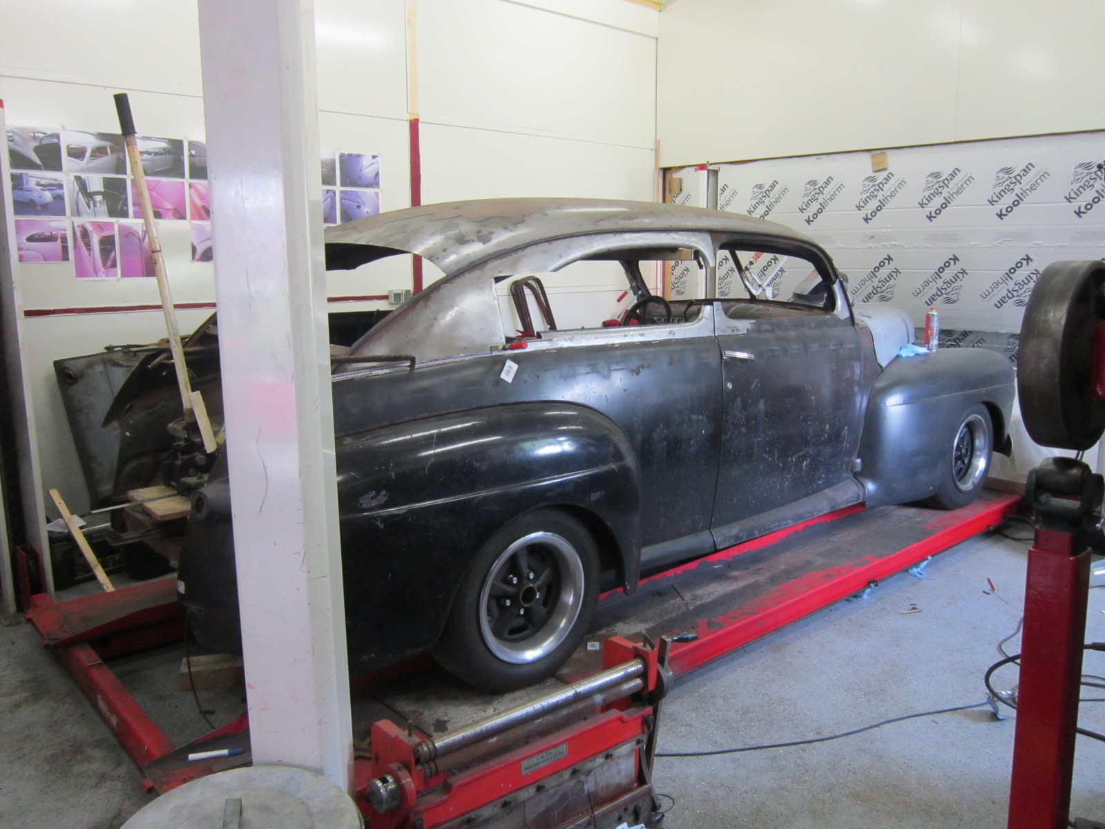

  22. at this moment we are busy with the topchop.
    but first I'm going on hollyday.
    sneak preview::D

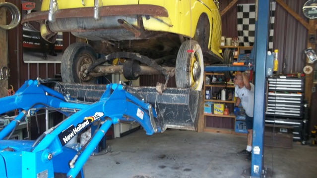

    2 things----How did the car wind up on it's side in your garage? Are my eyes going wacky or is the stater on the LEFT side of the car? Nice build by the way! BILL RINALDI
  24. look at the bottom of page 3 of my topic.
    there went something wrong with my carlift.
    the engine is a '74 Pontiac engine.
    they have the starter on the drivers side.

  27. I know...
    I did want to make a seperate topic of it when the chop was completly done.
    but the hollyday made it last longer as suspected.
    the chop is in progress I will post it this week.
    for now watch the pic's on a dutch forum.
    following this link page 12: http://www.pre66.com/site/viewtopic.php?f=10&t=872&start=165
