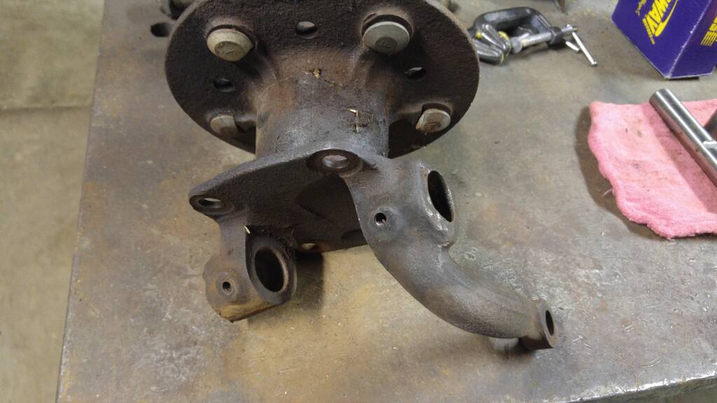

  1. I am wanting to adapt Ford '46 spindles to my Model A axle. I have a '42-'48 Ford kingpin set from Speedway motors. The issue I'm having is that the new bushings are to small for the stock spindles. What to do? I was thinking of installing the old bushings back into the spindles, reaming them to fit the new bushings to take up the gap, press in the new bushings, then ream the new bushings to fit the kingpins. What are your thoughts?

    My thought is you have a wrong combination of parts somehow.
    what you are doing is super common and nobody has the problem you are having.
    A picture or two of the spindles would be a great help!

  4. Post up pictures, because at least one of your parts isn't what you think it is.
  5. Are you sure that you don't have F-1 spindles ?
  6. I will get some pics.
  7. Pictures

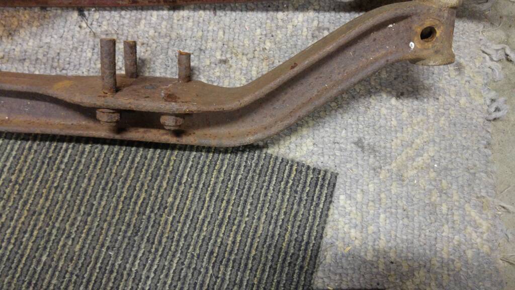

  8. For starters, not a model A axle. Looks like your spindle has been drilled wider where the bushings go, or?

    i'm gonna guess F-1

    Are there any forged numbers on the spindles? That will tell the original application. Passenger spindles from that era didn't have a king pin without a top like you show in that pic.

    Can't see the axle being F1...because there are no shock eyes out near the king pins. It seems this axle used a shock plate to hold the springs.
    Also, the spindles can't be F1 as F1 takes the same diameter king pin as all early Fords.
    Now its potentially possible that F1 uses a thicker king pin bushing...I have no idea on that...but regardless, those original pins are obviously thicker anyway.
    Also, F1 uses a bolt thru left steering arm to allow for drag link steering.
    These spindles use an extra right eye on the steering arm to allow for cross steering and NO bolt thru steering arm on the left.
    They do look like 48 style spindles, so we really do need those numbers Alchemy mentioned.
    Could you measure the pin diameters as well? (new and old) That could help narrow things down a bit!

  12. It was set up as a cross steer on the frame I got it off of. The numbers on the frame came back to a 1946 f-100. The new kingpin is .80 and the old pin is .87 if I remember correctly. I will get the numbers off the spindles.

  14. .87 kingpin, Lincoln spindles maybe?

    No shock mount holes in axle.

  18. The OD of the bushings that came out of the spindles are 1.04. I'm using a stock model A axle.

    Will you post a pic or two of that full axle please.
    Everyone is thinking thats the axle you intend to use, but now it seems its the spindle donor axle...and if it is, its a big part of the issue you are having!
    Give us some stuff to go on here.
    Your pics simply don't mesh with what you say you have in parts!
    This is an easy swap IF you have the right parts...but you just keep giving us a tiny bit of info here and there and the parts dont seem to be anything close to what you say you have!

  23. Looking at all your pictures; the oversize kingpins are probably an old repair job. Those five lug hubs will not fit on a larger truck spindle. Unless you are a machinist (or have a good buddy who is) and have the means to make custom bushing; I think you would be better off just getting another pair of spindles. Square backs are pretty cheap anyway.

    I find it odd that someone would go thru the trouble to oversize the bushings but it certainly is possible. However...oversizing the pins like the ones he shows would mean oversizing the axle kingpin bores as well. That seems pretty extreme! But then again...you never know!!! LoL
    Regardless...a set of unmodified car spindles is definately the way to go.
