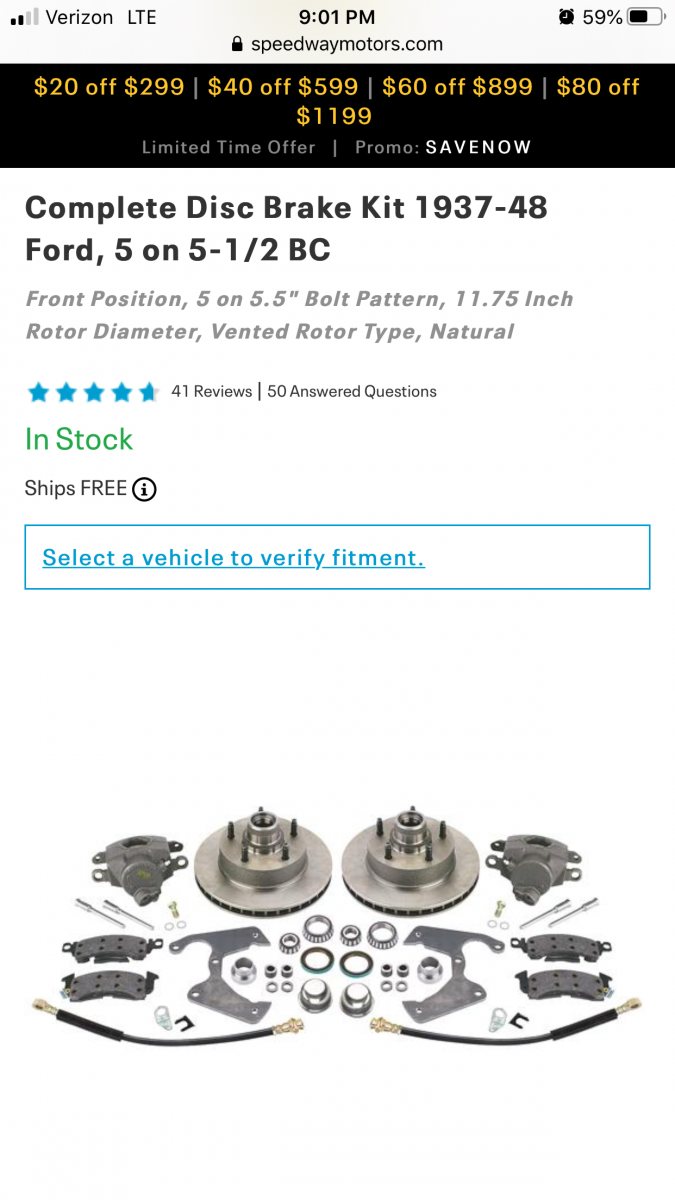

    Hey guys couple of quick questions. I have a fairly stock 46 ford that I am doing some chassis up grades and drive train upgrades to.
    I am thinking about switching the front to disc brakes and was looking at the speedway kit. It says it may not work with stock wheels. My question is have any of you guys done this kit with stock wheels on a 46-48 ford? Or any other option?
    also I’m not trying to start a debate on drums vs disc. I’m just looking for facts on if guys have used this kit with stock wheels or if someone can point me in the right direction on something else.
    2A336BBB-BE77-494D-9D5E-D2F7AA8B3DBE.jpeg 2FD833C2-CFB2-4E32-993E-50F09580C83E.png

    That's the kit I put on my 41. I had 16" stock wheels and it fit fine. I think the 15" stock wheels won't fit. You'll need to get some different wheels if you have 15" right now.

    Old Yankee sells a kit available through Millworks Hot Rod. It will work with either 15" or 16" stock rims.

    I used the kit, it spreads the wheel width 3/4 inch on each side. Had to chnage wheels on my forty to be able to steer it. I'd do the Ford truck brakes instead. Use a firewall mounted MC/pedal assembly.

  11. The kits we used (one Speedway and one ECI) with the F-150 rotors and 5 on 5-1/2" bolt pattern did not increase the tread width; in fact it is slightly narrower. We used them with two different brands of aftermarket 15" early Ford style wheels; one set cleared right off and the other required slight grinding on the caliper.
    The spindle flange to the WMS is 3-1/4" with early Ford hubs and ends up at 3-1/16" on the F-150 rotors.

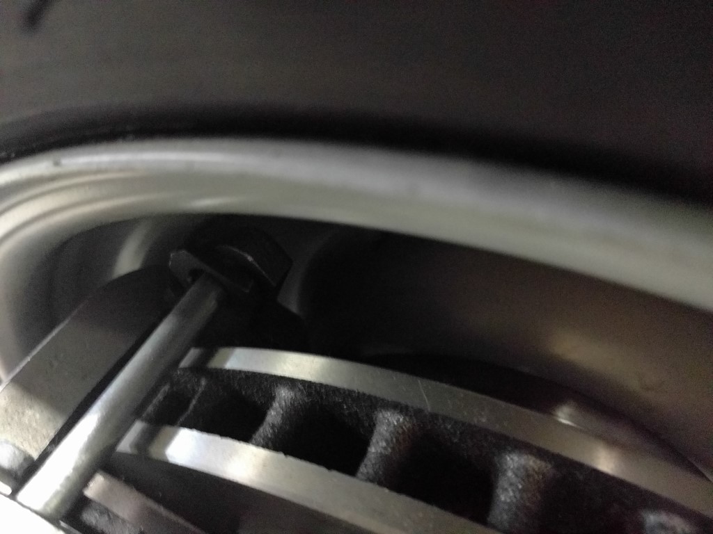

  15. I think it needs to be a disc brake hoop, I check out a kit for my '47. I have stock 16x4.5, I went to the parts place an borrowed a F-150 rotor, put it inside of my spare wheel and to me there's no room for a caliper. I would have been stuck using wheel spacer.
  16. Both kits use the same components and are pretty much the same. The two measurements are from the back of the disc to spindle flange and from the wms to the back of the disc.
    Total up to 3" or so, the '48 hub at 3-1/4" is in comparison. Much better than the extra inch or so the common small bolt pattern kits add to each side.
    We tried a repop 16" wheel on these and it fit too.
