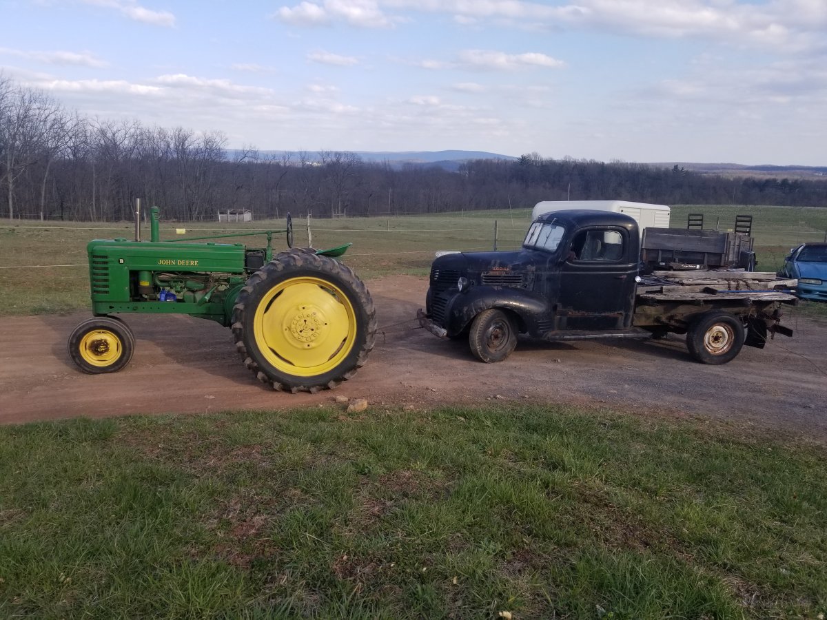

    I picked up this 46 Dodge about 5 years ago for cheap. It has sat waiting for me to find the time and money to build a hot rod out of it. I was looking at it last weekend and thought it almost looks like it would run. Then i thought at least if it ran i could drive it until i got around to building it into a hot rod. So i got the tractor and pulled it into the garage.

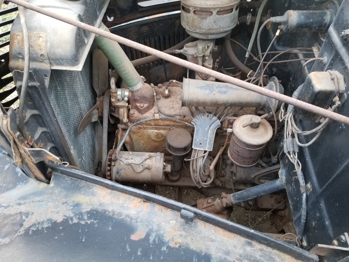

    It has a 218 6 cylinder. The last owner said it ran back in the late 90's. Everything is there and its not locked up. I figure there is not much to lose by trying to get it running again.
    The body is a little rough but i have fixed worse. Some one welded the fenders to the grille for some reason. The doors still work and latch. First thing it trying the starter and see if it cranks.
    My goal for now is get it running and take a road trip. 20180408_072610.jpg 20180408_074249.jpg 20180408_074154.jpg 20180410_174952.jpg

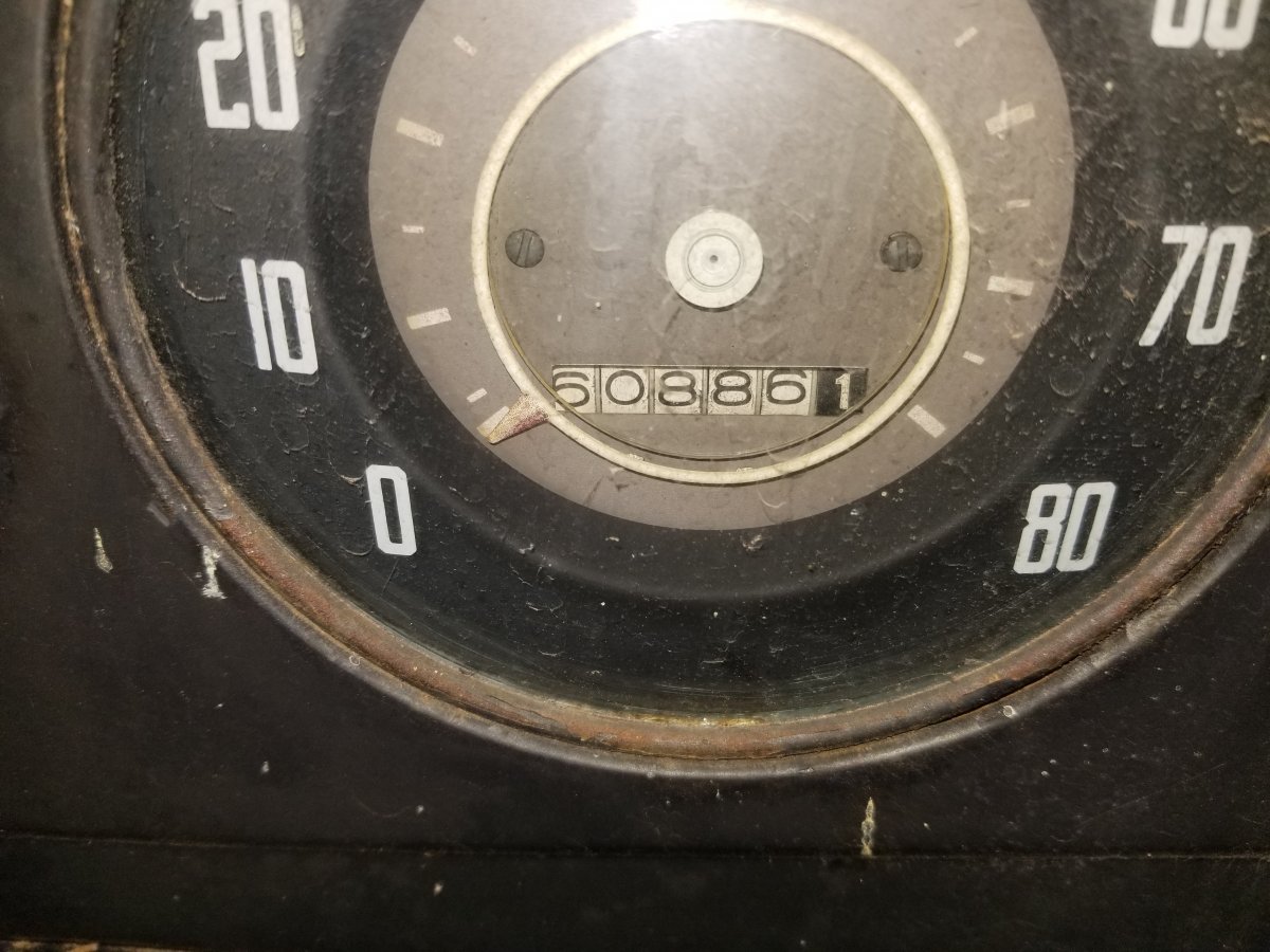

    I got it up on jack stands and looked it over. The odometer has just over 60,000 on it. I dont know how many miles these old flat heads would normally run. I pulled the 6v battery out of my old john deere and put it in the truck. I tried the starter and it didnt work. So i pulled the starter off and tore it apart. It was mostly dirt and a little rust. I cleaned everything up and put it back together. I bolted it back in the truck and it worked great the first try!

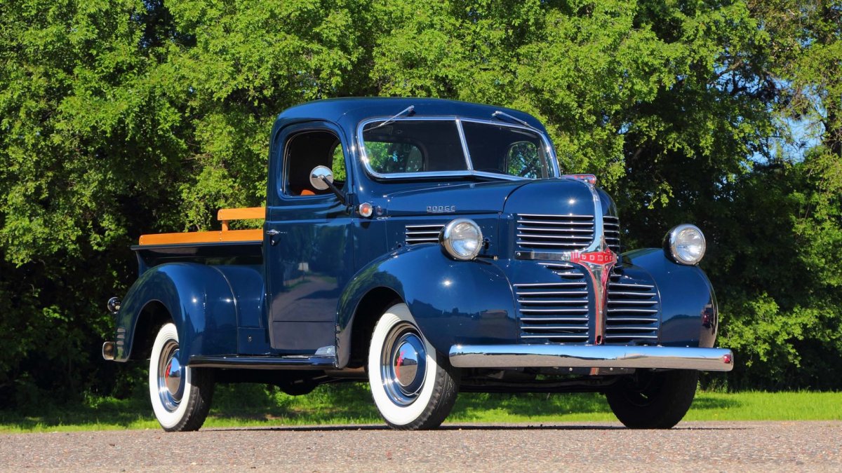

  8. ...I like those, we call em "frog-eye" Dodges,...yours looks to have non-stock headlites, to me anyway,...I like the 39-40's as the headlites sit down in the fender valley instead of on the crown...but all are cool, good luck with it.

  12. Yep....the headlamps should sit down into the depressions on the front fenders like this one.... 1946 Dodge pickup.jpg

  13. ^^^ but on the 39-40's the lights sit closer to the center of the truck, in the valley of the fenders....like this...

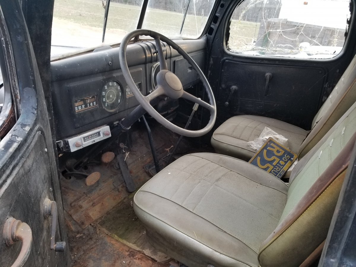

    It appears it has the very rare optional radio there on the lower left of the dash?

    I was wondering about the radio. I dont know if it is original but it looks like it has been there forever. There is also a speaker in the center of the dash. 20180412_235914.jpg

  16. No, the radio and speaker are not original to the truck.

    The speaker is out ofilot House series Dodge truck,49-53? The radio must bea 6v if that what the battery is. Pos or neg ground?

    Yes the radio would be 6v positive ground. I like the looks of it. I have not tried it to see if it works yet. Even if it dosent i may look into rebuilding it.

    I think a radio was an option in the 48 model year, and the speaker certainly looks like the early production unit. Wouldn't have been a big deal to add the radio to a two year old truck at the time.

    trying to get it running. It still has the original 218. I have spark at all 6 plugs. I dumped a little gas down the carb but cant get it to do anything. Its been sitting for many years. The carb has not been messed with yet. But i figured it would atleast start and run for a few seconds. Is dumping a little gas in the carb something that dont work as well on flatheads?
    I just did a compression check. Only getting 20psi some cylinders getting no pressure at all.

    valves get gummed up from sitting. Basically you pull the head, I use 50/50 mix of atf/wd40 and lube up the valves.
    Then tap them closed with a plastic hammer, crank the engine over and repeat the lube and tapping the valves closed.
    Until you can crank the engine over and the valves open and close on their own.
    Also lube up the rings while you are in there.
    The old engine oil gets sticky, you physically need to get in there and clean the valve stems with the fresh lube and push the valves closed.
    I started with 5 stuck valves, 2 freed up with just taping them down one time, 3 were more stubborn. Mine sat for 40 years.

    I pulled the head off. One valve was a little more stuck than the rest. I used some marvel mystery oil and wd40 and they all work free now. Now to clean it up and put it back together and check compression again.
  29. Make sure the valves are ungummed completely or you'll run the risk of them getting stuck again.
    You should also soak the cylinders with MM or 50/50 acetone & ATF to free up the rings. They might be stuck too.
