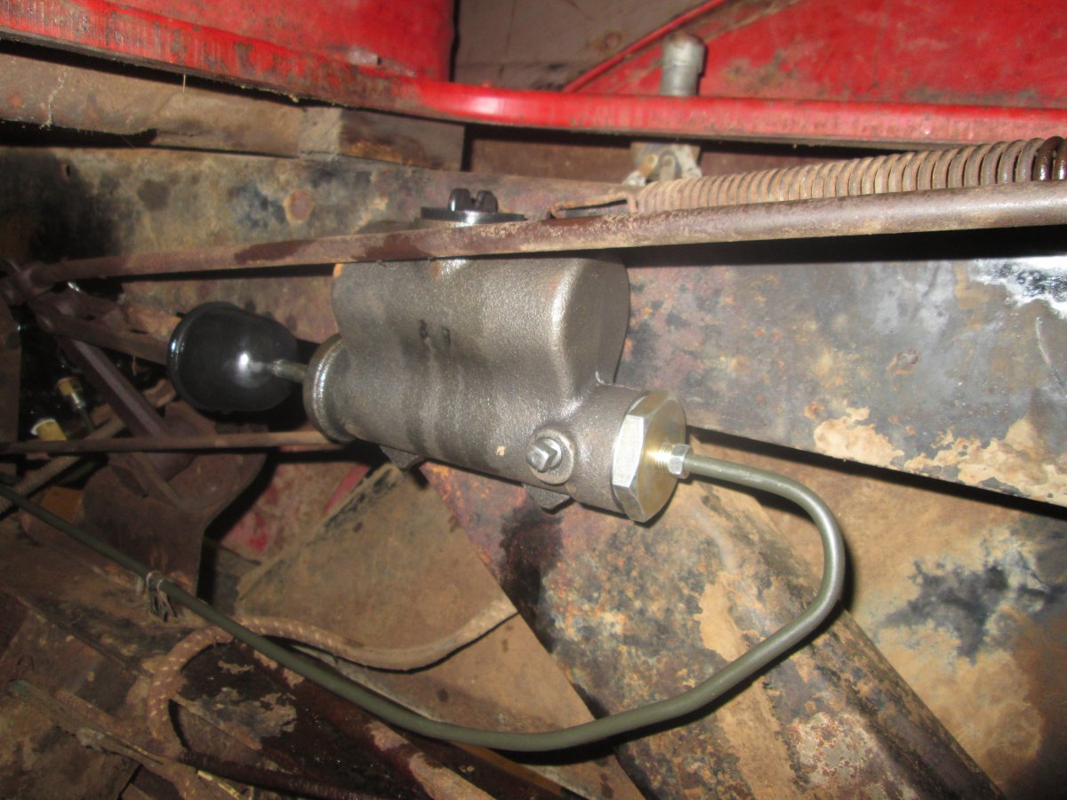

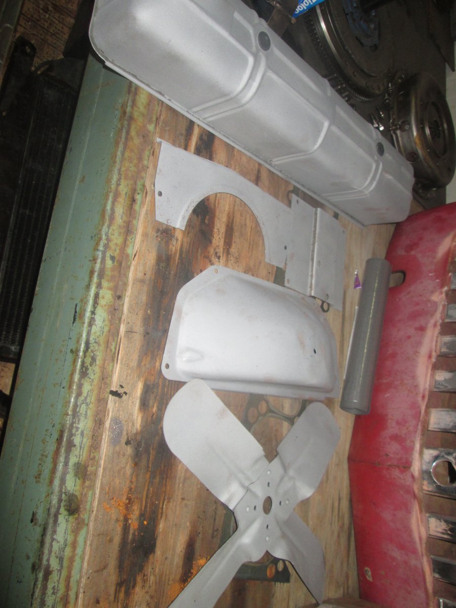

    Pressure washed the chassis and just have to scrape the big grease chunks off. Also got the brake assemblies cleaned. Ready to paint.
    Sending out the Hydro Brake booster to Karps in Inland CA for rebuild.
    Welded the neck of the water pump and cleaned it.
    Also rebuilt the rear brake cylinders with kits.
    Finished the manifold grinding and used steel epoxy to get it smooth before paint.
    And got back some small parts from blasting.
    Been working on other customer cars inbetween. Non HAMB friendly but pay the bills.
    This 46 is close to going back together. Radiator will go out to get boiled clean and checked for leaks. But yeah its going. Still having fun with this one.
    Oh! His original head came back from machine shop with the #3 exhaust valve fixed. It had 235 valves put into it years ago to be able to get valves easily. Its back on the motor. IMG_1514.JPG IMG_1507.JPG IMG_1508.JPG IMG_1509.JPG IMG_1510.JPG IMG_1511.JPG IMG_1512.JPG

    Got the truck back on its tires. Brakes are complete and bled them today. No leaks. Ready for the painted motor to go back in. Only had to make 1 line connecting the master and booster. New front hoses though. Have the valve lash set cold +.005. Hydrovac booster rebuild looks great. And the pressure washing of the truck makes the wood underneath the top boards look awesome. It just needs new tops. Last pic is my new toy. 47 ford 2n tractor for the pasture mowing. Runs perfect and put new rear tires on it. Never knew they went so fast in 3rd gear! IMG_1525 (2).JPG IMG_1520.JPG IMG_1521.JPG IMG_1522.JPG IMG_1523.JPG IMG_1524.JPG IMG_1526.JPG IMG_1527.JPG IMG_1528.JPG

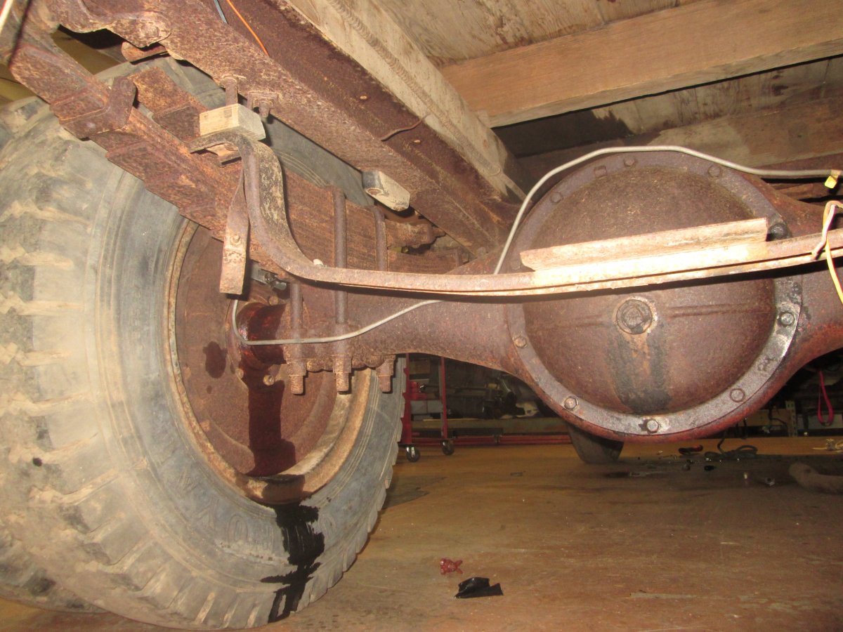

    IMG_1533.JPG IMG_1532.JPG Got the old wood off of the bed to prep it for the new wood. And just finished installing new glass with rubber and felt channels. Not easy to get the windshield right because it had alot of rust in the lower middle of the window frame. But it came out nice enough.
    Carb came back from shop and they said they flow tested it and it was good and clean. Thought it was the governor not working so he adjusted it full open. Said it should not have any problems now. We hope because i will shoot someone if it has the same problem.
    Turns out the accelerator pump was a brass ended one with no problems too. So tonight i will get the radiator back on and fill it with fluids for the test. If its good then axles and some yard driving tmrw! Woohoo. Time to get paid.
