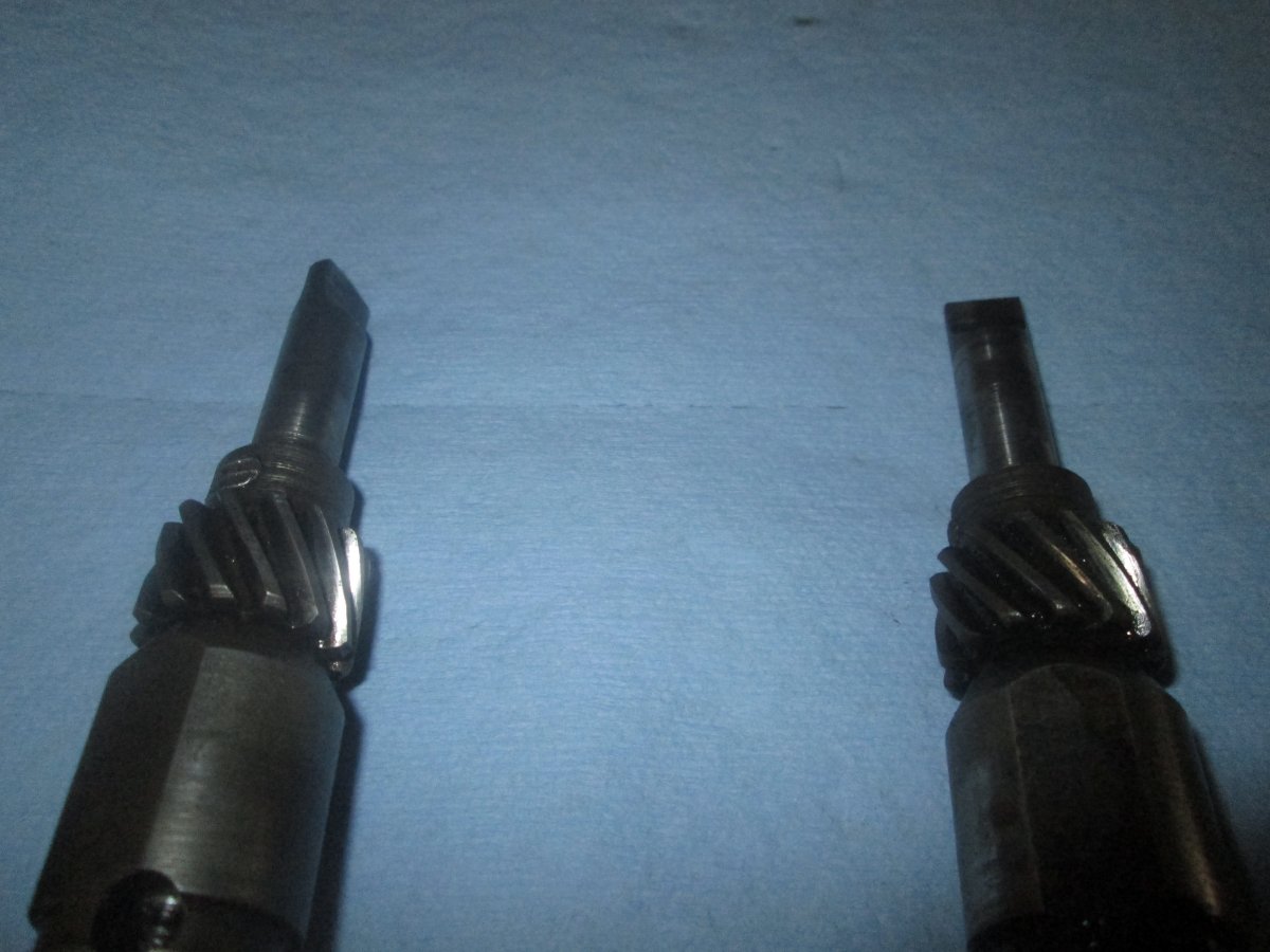

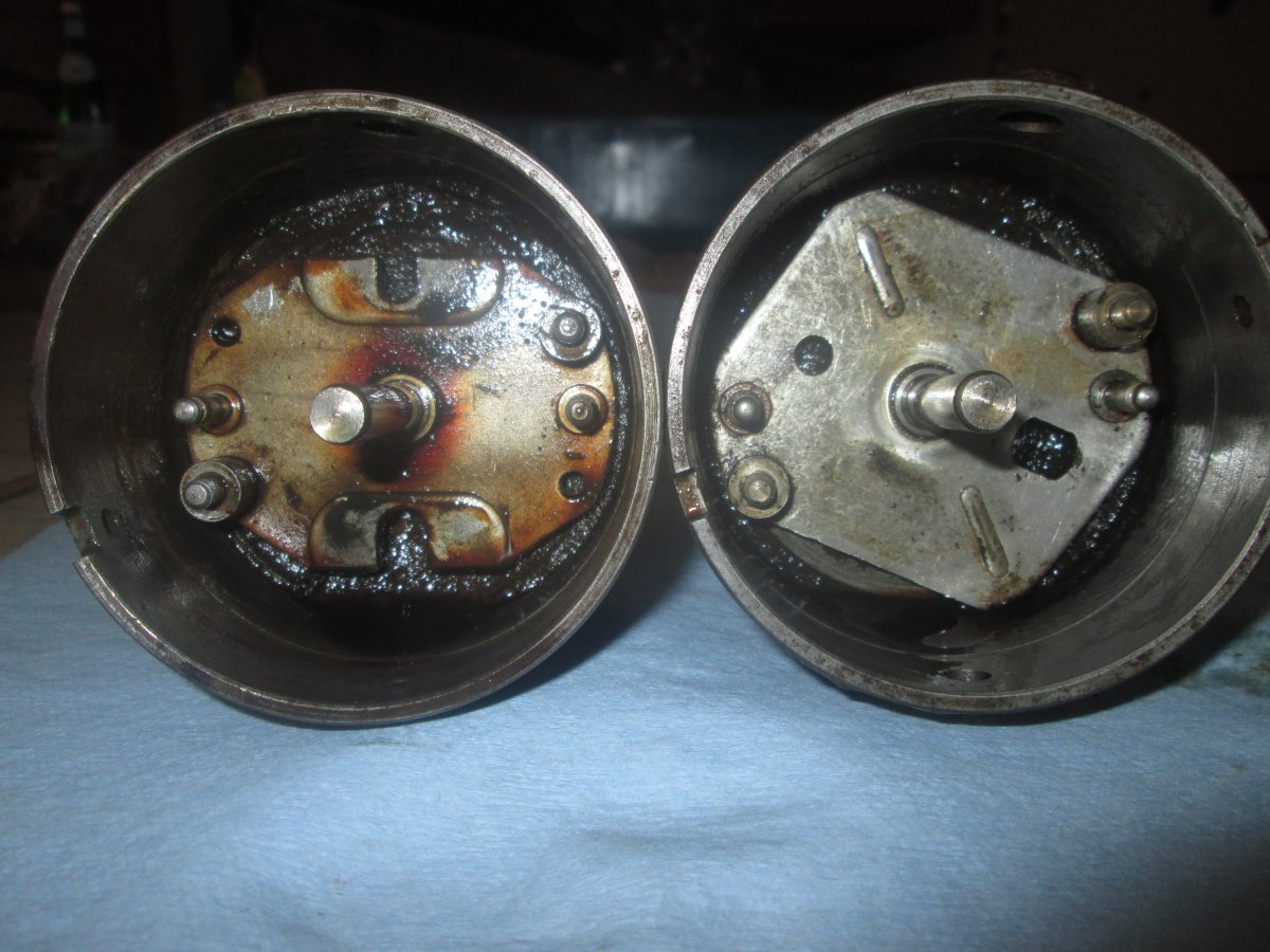

    So today I tried to put the distributor from the new motor in the old motor and i couldnt get it to line up to a terminal for spark plug #1. Kinda wierd but i guess each motor has its own distributor. I just wanted to see if the new one would make it run better. Feels tighter.
    But side by side i found them to be clocked different! When all is equal and the notch for the rotor points up the new distributor shaft end is clocked to 11-5 (if you will) and the old one is clocked to 2-8 oclock. Have pics.
    No matter how i twisted the distributor when it was loose it wouldnt let me set the points to just open at 5 degrees before tdc (just before the peak on the lobe) AND be pointing to spark plug #1. It only points inbetween any spark plug terminals. Twist to get it on a terminal and the points would be way off inbetween lobe peaks. (old distributor sets up perfect. points just open before being on the lobe peak tdc and pointing towards #1 spark plug terminal)
    So i am really cleaning them both and putting them together greased to perfection. The weights are the same for the mechanical advance. Probably have the same springs but i can't check that. Both are stamped 31.
    Best guess is that the car 216 and the truck 216 were different. may have read that somewhere. Think the truck 216 was different to get a bit more hp or torque than the car 216. Only worry is if the bellhousing bolt pattern is different from truck bellhousings to car. I would be stuck. IMG_1481.JPG IMG_1480.JPG IMG_1482.JPG IMG_1483.JPG
    You can see in the pics the difference in how they are setup (clocked).

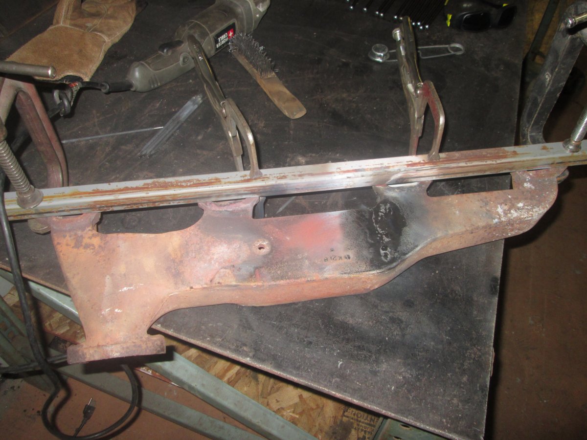

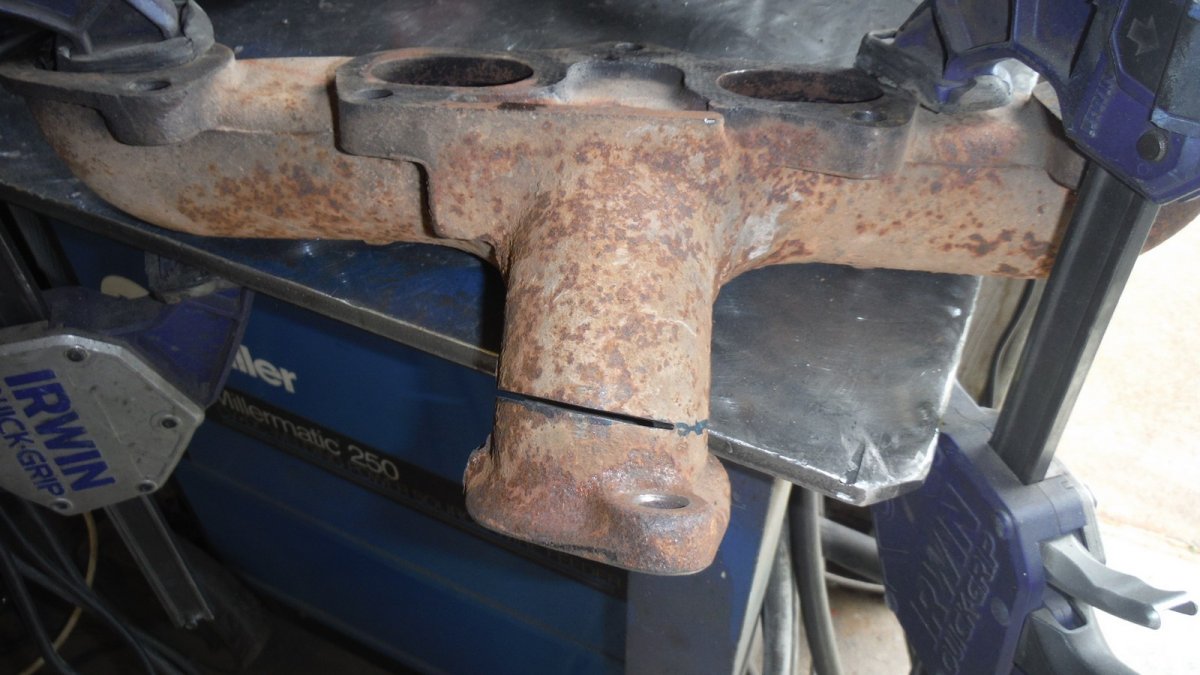

    Massive crack in the exhaust manifold that could not be seen from the outside. Going to try to weld it. Not easy.

    Anybody have any success at welding cast iron manifolds?
    I am getting some Castron rods that i read are the best for that weld and i will follow all the rules for preheating and slowly coolong down. Also they say to ping the welds every inch or so to relieve stress as you go. Should work out ok. Problem though is that its still cold here and i wish it weren't.
    Oh well. Here we go. I do love to gas weld with oxy/a.
  16. Just in case you do not know, once you do get it welded, you will have to bolt it and the intake together and have it machined as a unit to get them flat again. Best way to do it is a large belt grinder, it is tough to machine them on a mill.
    When I first got my truck in my avatar in HS, I took them apart to clean everything up and when it wouldn't go back together and clamp flat on the head is when Dad told me. Of course I didn't ask before I took it apart either.....

    You might have better luck brazing it than welding it. When cast iron is hot for alot of time (as a exhaust manifold or wood stove) the silicon and carbon in the metal gets oxidized, making it unweldable. Some cast irons aren't even weldable when brand new, and you really don't know before you try.

    Cool. Good to know. I am going to try to find out what kind of cast iron it is and then make my decision. Been watching videos of manifolds being welded and NO ONE is saying they failed. I think only the successful attempts are being filmed and the botched jobs are being deleted. Haha.

    I am thinking of drilling holes in some steel plate to bolt it to and weld it bolted to that. May have enough room to weld. May not since it is on the inside mostly. Will see.

  20. I welded some cast iron manifolds recently.
    Cast iron Mig wire, no preheat welded excellet.
    Downside is 80$ per 2lb spool..
    Other people had success with tegulr weldng wire.

    Brazing worked for me. To get some clearance between 331 HEMI and the R&P steering shaft, I cut the flange off the left-hand manifold at an angle that was pretty much guessed at. Then, re-positioned the flange by rotating it to get the ears in a better location and brazed it back together. Spotted it in a couple places, checked fit & clearance, then finished the brazing.
    Threw it in a tub of Oil-Dry to gradually cool off. Fit up nicely.

    Nice welding work. I am going with Nickel 99 rod. 16 bucks for 2 rods. Ouch. I will put it in my weber grill to cool down slow.

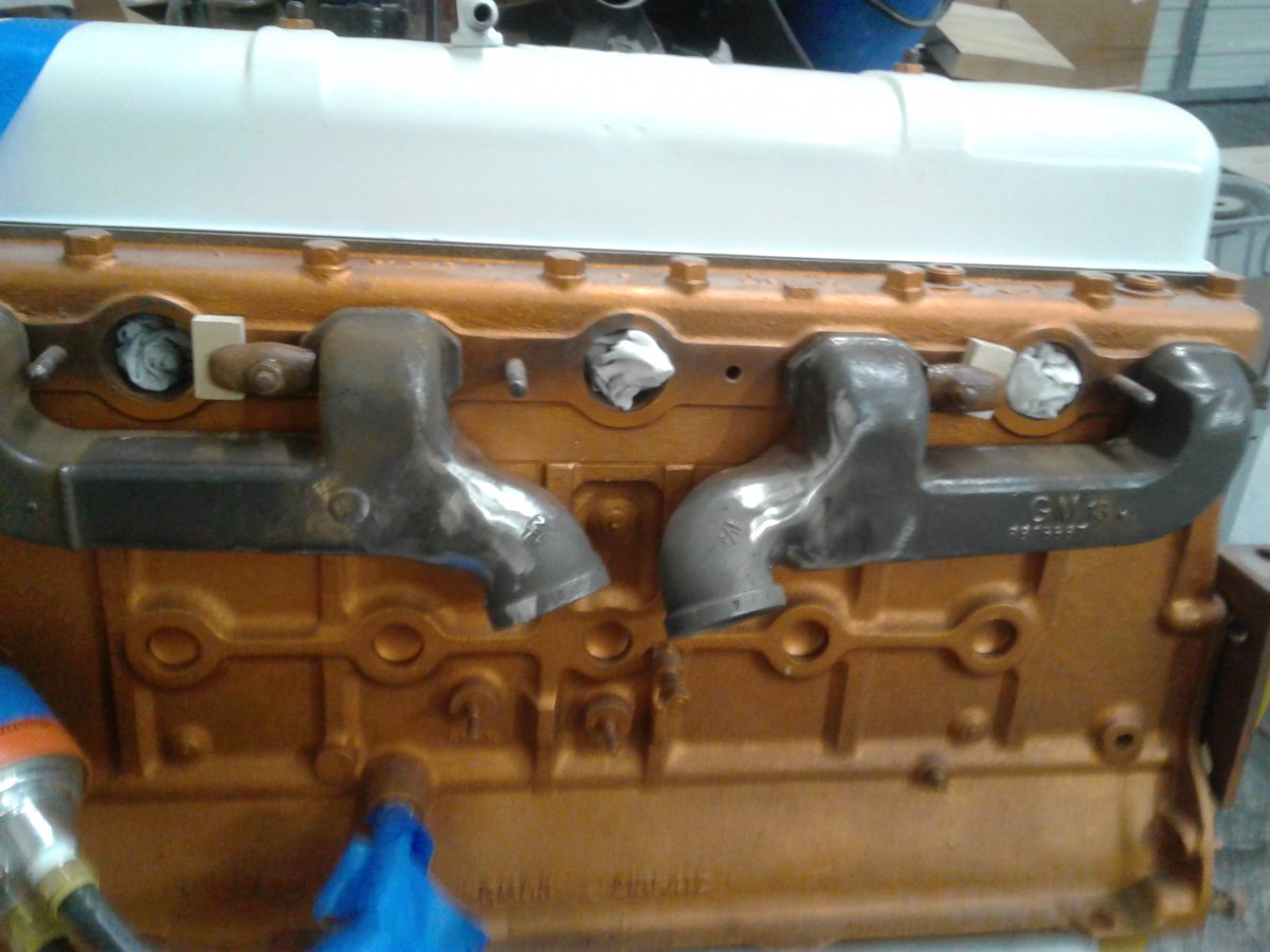

    Got the intake and exhaust manifolds apart and cleaned up. Ready to weld but they are in the fire getting cleaned.

    Welding worked out great with a #2 tip and gas set at 5 ox and 5 ac. Ground smooth after and looks ok. I think i will use high heat epoxy over top to get it perfectly smooth. IMG_1504.JPG

    You gotta tell me what kind of cast iron wire you used. I want to try it. Can't find any.
  26. Crown alloys,royal 44-30
