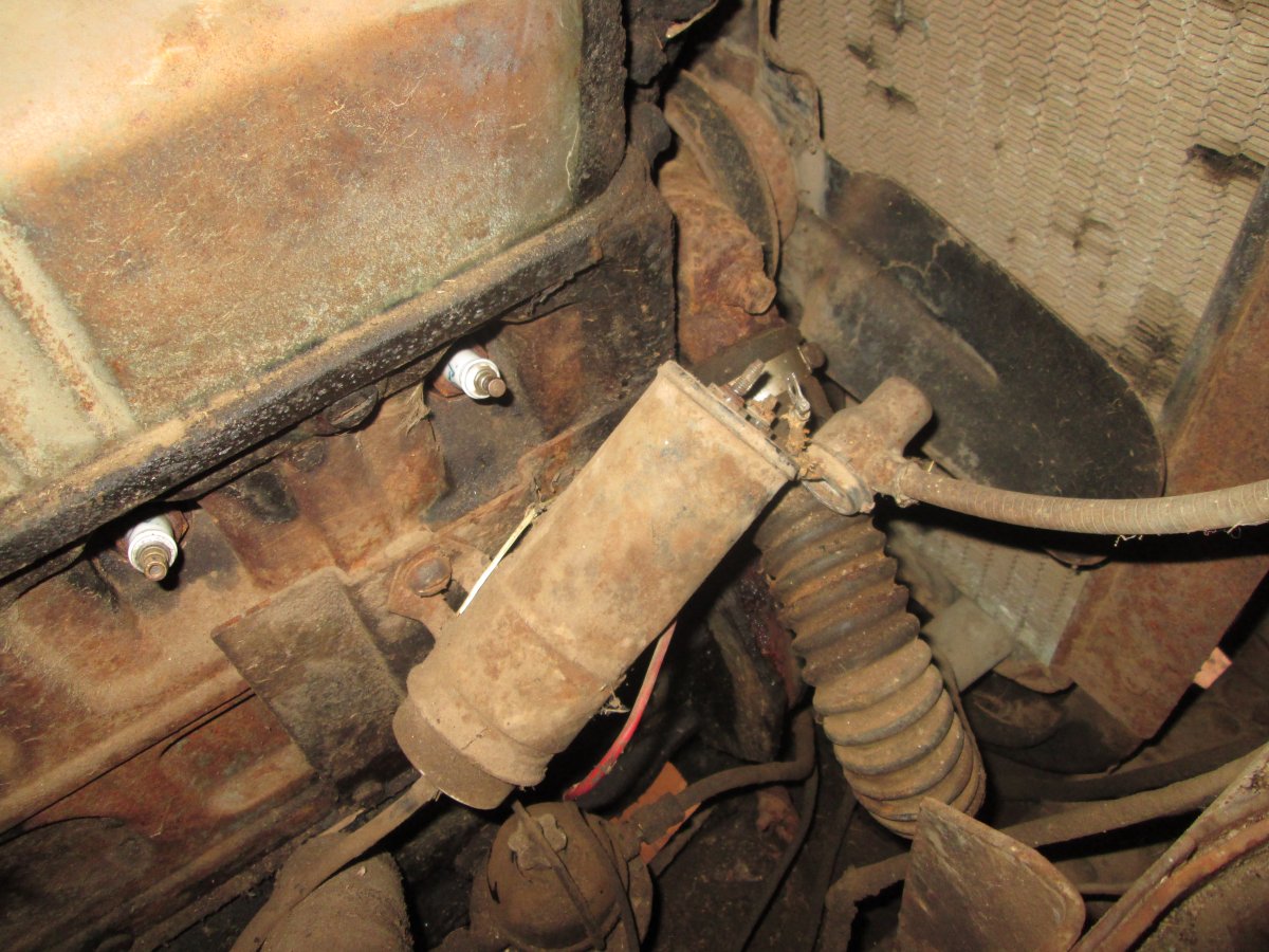

    I will take a picture of the electrolock dash toggle and the coil with two positive terminals at rear and a ground at front next to the distributer wire boot. But WAIT, it has no boot! It goes right into the coil and does not unplug! Super wierd.
    So i have power at the primary and secondary coil pos wires at the rear of coil. Good ground on front. Cleaned points contact surface and now get a weak spark at points and even got a weak spark at the plug i borrowed from my 327 with its plug wire. Looks like a good tune-up with new coil will do the trick! I found a coil online that has the electrolock end on it but cant find one like this truck has on it with 2 pos terminals 1 neg without a boot (removable) distributer lead. So i am going to get a 6v coil from napa and hook it up like regular from the ignition pos or just jump it from the battery until the other gets here.
    Getting plugs, plug wires, coil, rotor and points. No cap available. Not throwing everything in at one time. Going to start with the plugs and wires first. Then condensor and then points and finally the coil. See what happens.
    My question would be if it has a primary and secondary pos wire... when i hook up the regular 6v coil do i just use the keyed ignition possitive to it and a distributor ground? Regular right? Don't worry about the primary, secondary wires right? Fyi the second wire to the original coil goes from the back of the coil to the top of the starter! Right smack in the middle of the starter. And not from the big starter connections. Extra weird. Gotta find a diagram of this truck man. Pics late tonight so someone can help me out with this crazy setup.

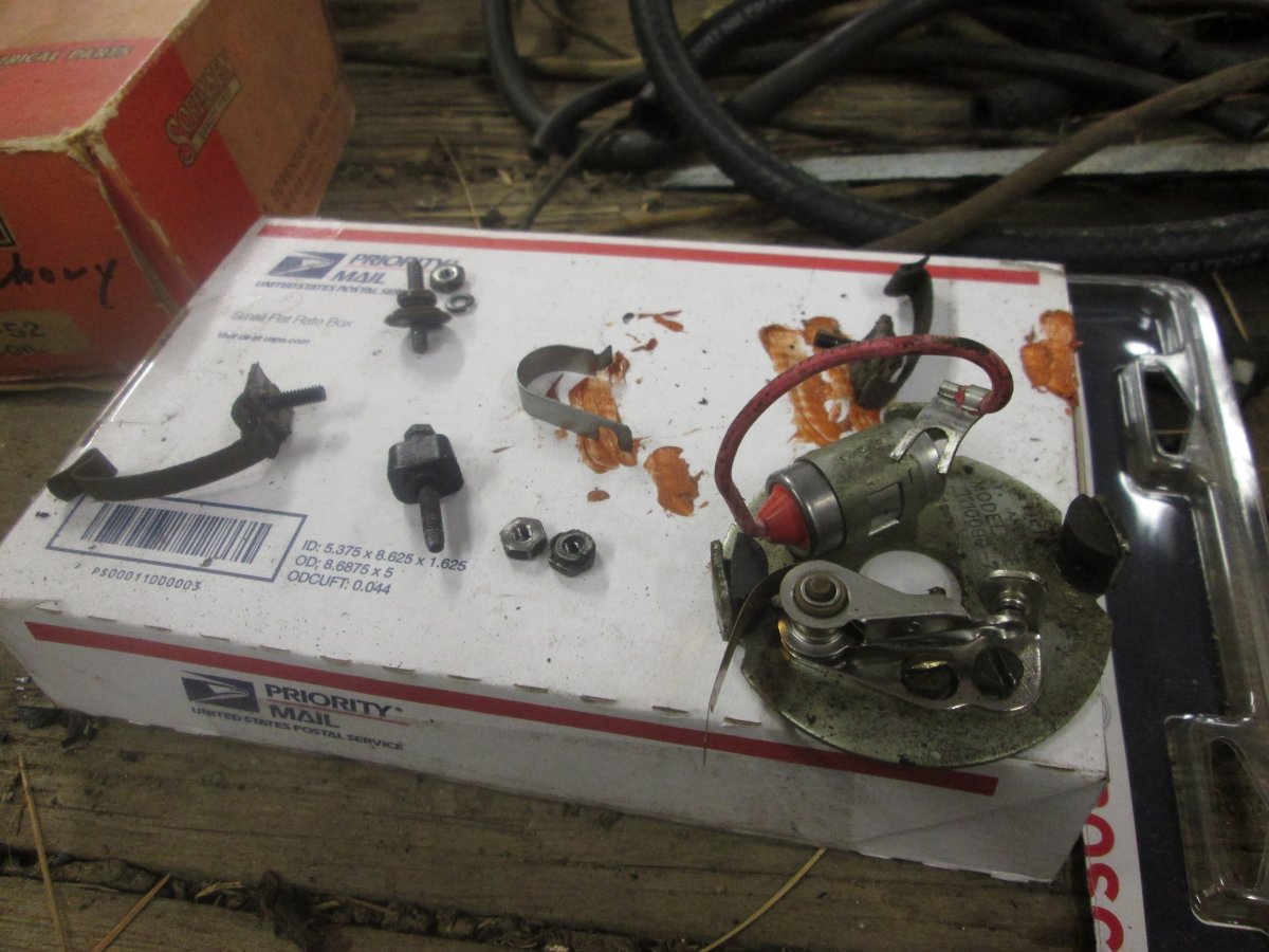

    Got the wires from a chevy 250 and cap, rotor, coil on it. Will put the condensor and points on tonight.
    Check out the old coil. It is oil filled.
