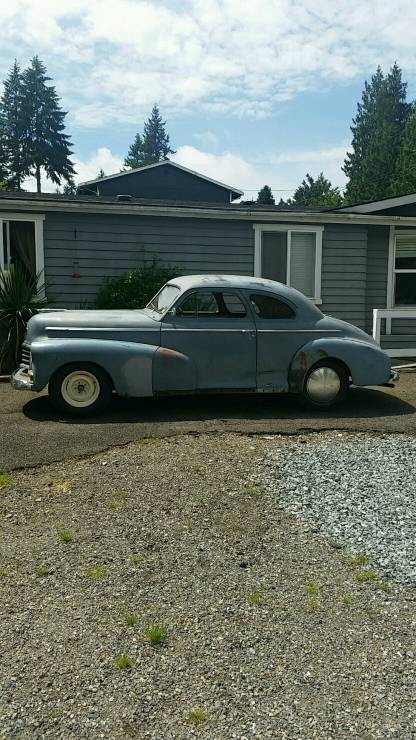

    Well haven't been on here in quite awhile. Thought I would post some info on my latest projects. This is my 1946 Chev business coupe. Here is when I brought it home. Original 216 with 3 on tree. 20160918_122105.jpg

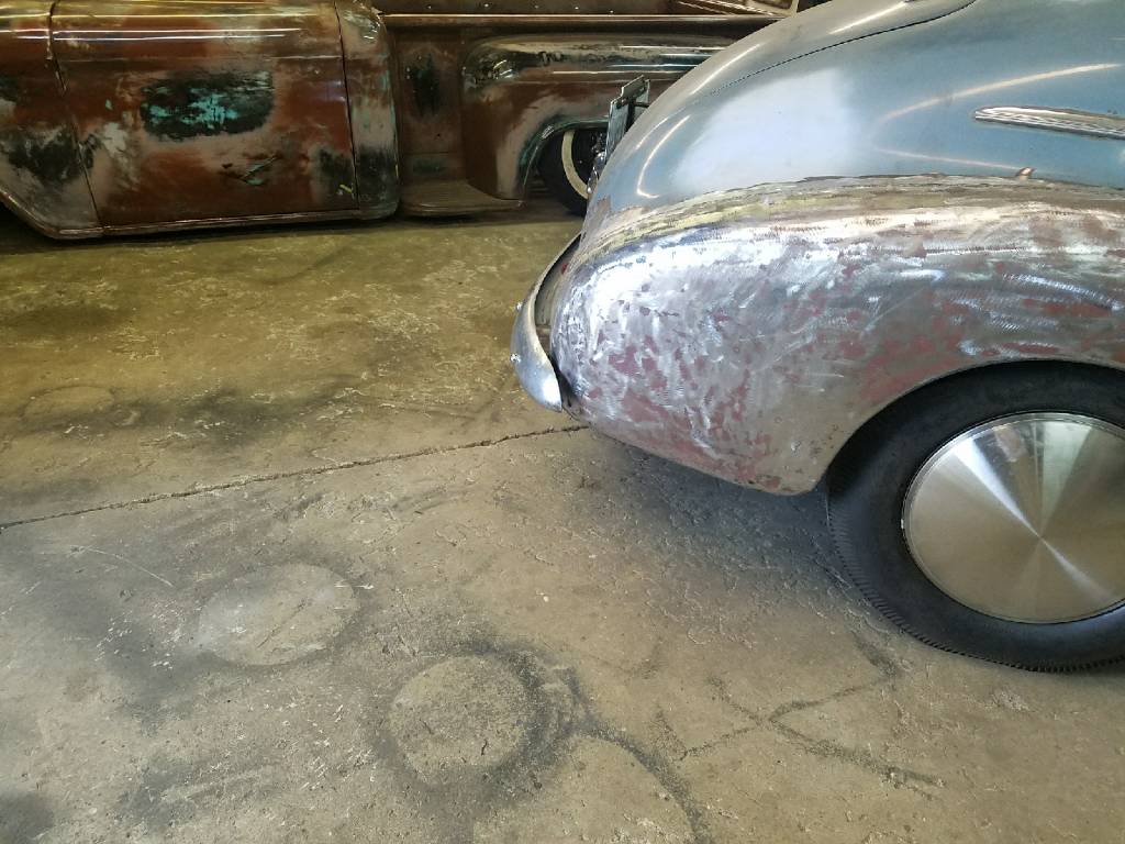

    CGkidd

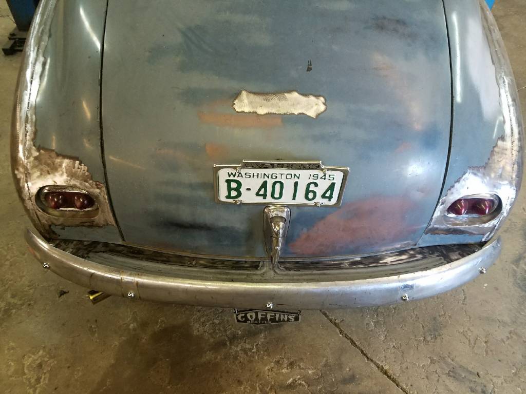

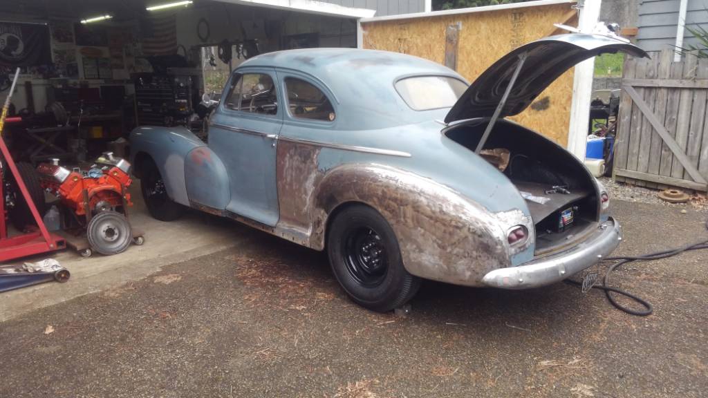

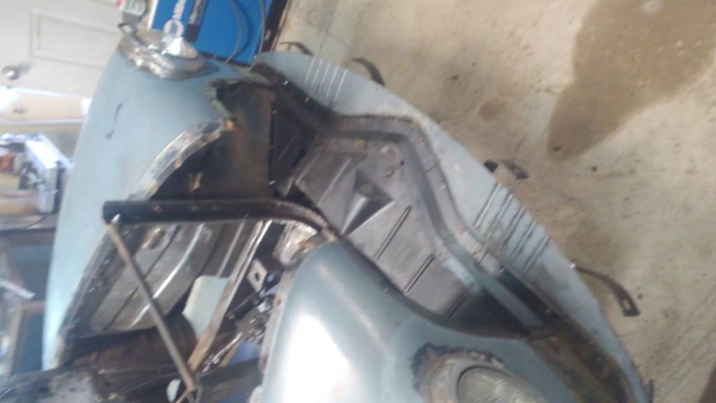

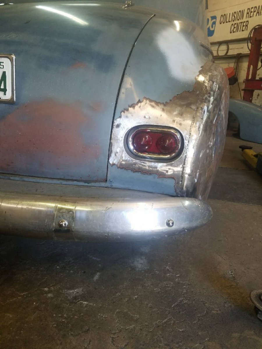

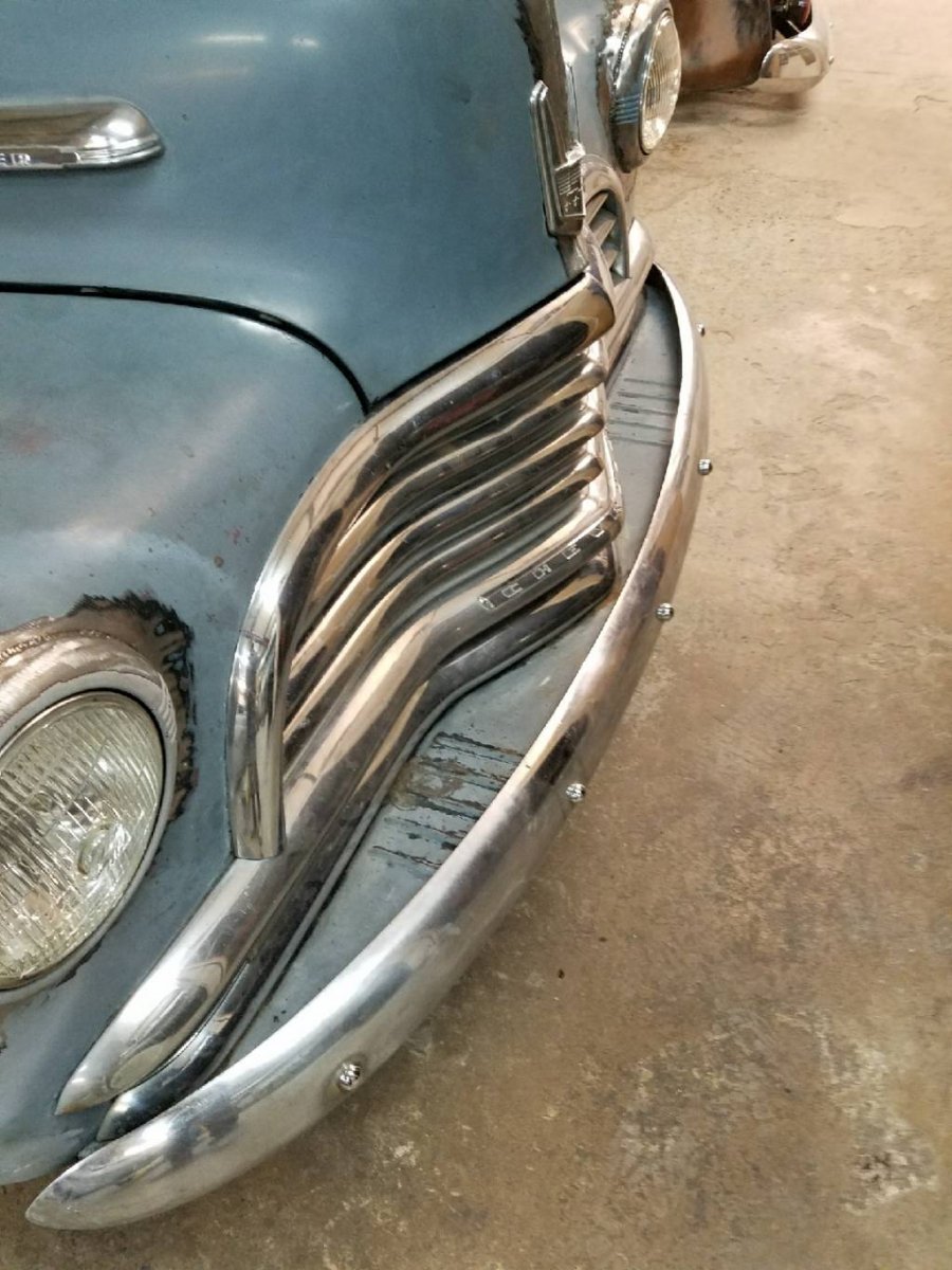

    Then last year had a buddy at JS Customs here in Wa help with repairs to the body. Welded rear fenders in place, frenched in 50 Buick taillights, frenched headlights, nosed the hood, fixed where someone leaded the gas filler hole, pulled front and rear bumper closer to body. Had just a little rust in rear. 11018.jpeg 15765.jpeg 6732.jpeg 8563.jpeg 11022.jpeg

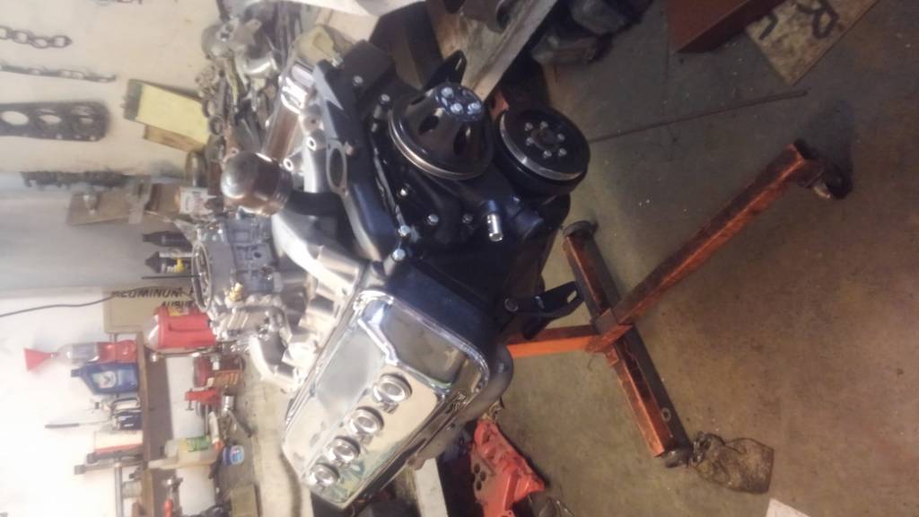

    New engine is ready to go in. 1956 354 hemi mounted to a 56 Packard manual trans with overdrive converted to floor shift. I have Hurst motor mounts and Hurst frame mounts for the front. KIMG0416.JPG KIMG0415.JPG

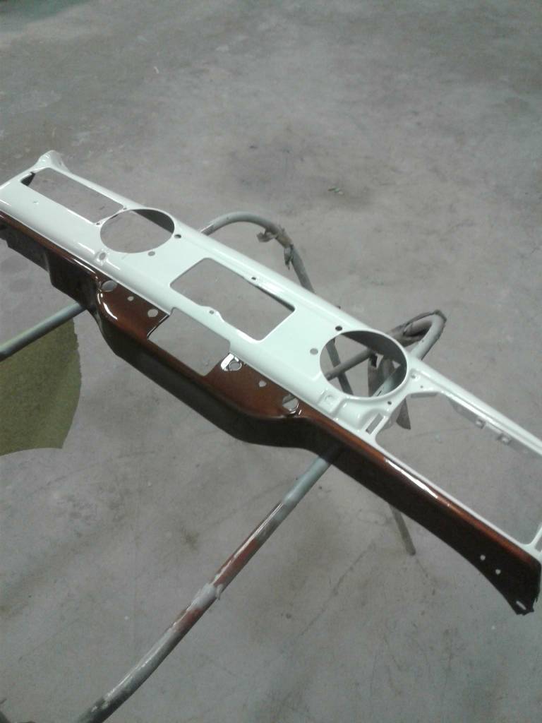

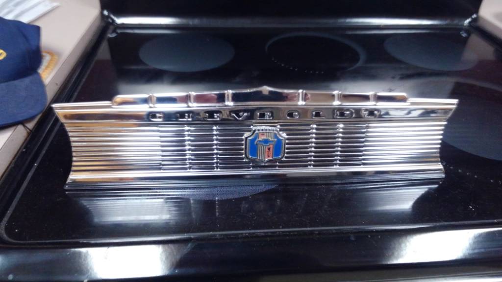

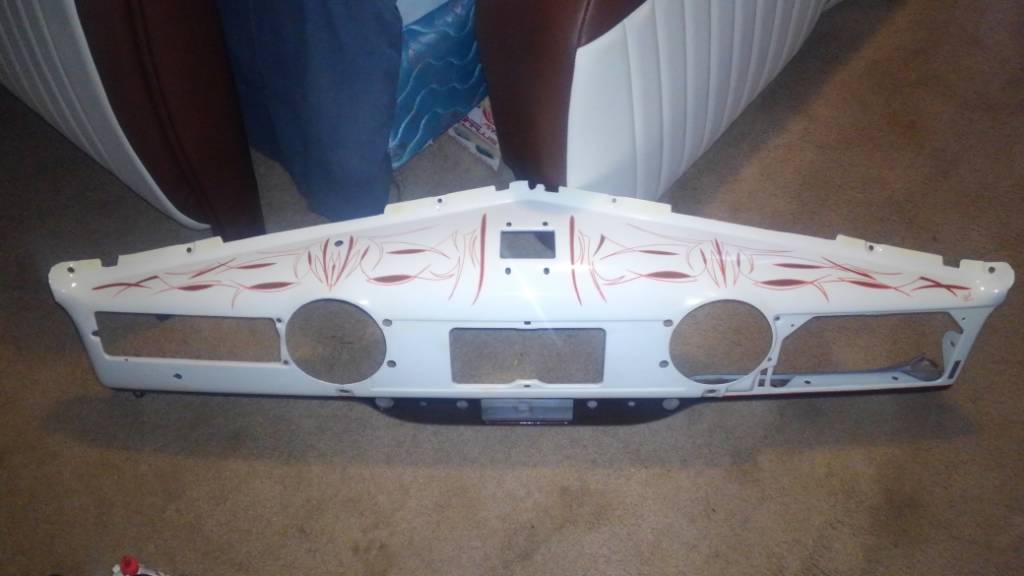

    Dash is already real nice but went and had glove box door and Ash tray delete chromed. KIMG0263.JPG

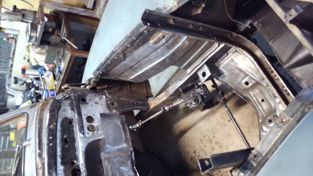

    Battery has already been relocated. If my measurements are correct it all should fit very tightly. Might have to clearance the firewall for distributor.

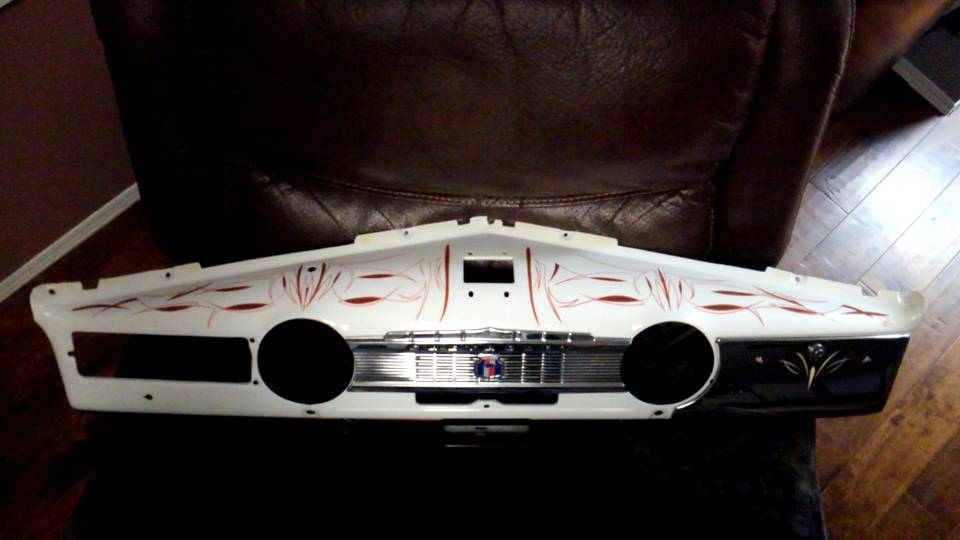

    Hi. Nice work there. I have a question for you on your 4 gauge instrument panel. Did you make it or where did you purchase it? I have seen similar on Speedway & Chevs of the 40's but they are very blah looking. Guess I could get one of the blah looking ones and have it faced. Also my original panel looks like it is stainless that has been painted over. Thinking about pulling the stock panel and taking off the paint and see if the gauge slots are short enough where I can knock out the round holes in it. At least that way everything on the dash would match all the way across. I am in the thinking about it stage right now as I am waiting on the insurance adjuster to come by as I got rear ended last Thursday. I have no clue whether they are going to come up with repair money or total it.
    I am even tinkering with the idea of making it into one of the Double Duty Coupes of the day and instead on new trunk lid slid in a small step side bed in the style of the 30's - 40's. I think I can do that change for no more money that replacing all the bad sheet metal on the rear.
    Jimmie
  14. CGkidd
    Joined: Mar 2, 2002
    Posts: 2,910
    CGkidd
    The panel was one of the ones from eBay, basically same as speedway, I took a stab at engine turning it came out ok. Sorry to hear about your car saw the post. That's the one thing I worry most about is other drivers not paying attention.

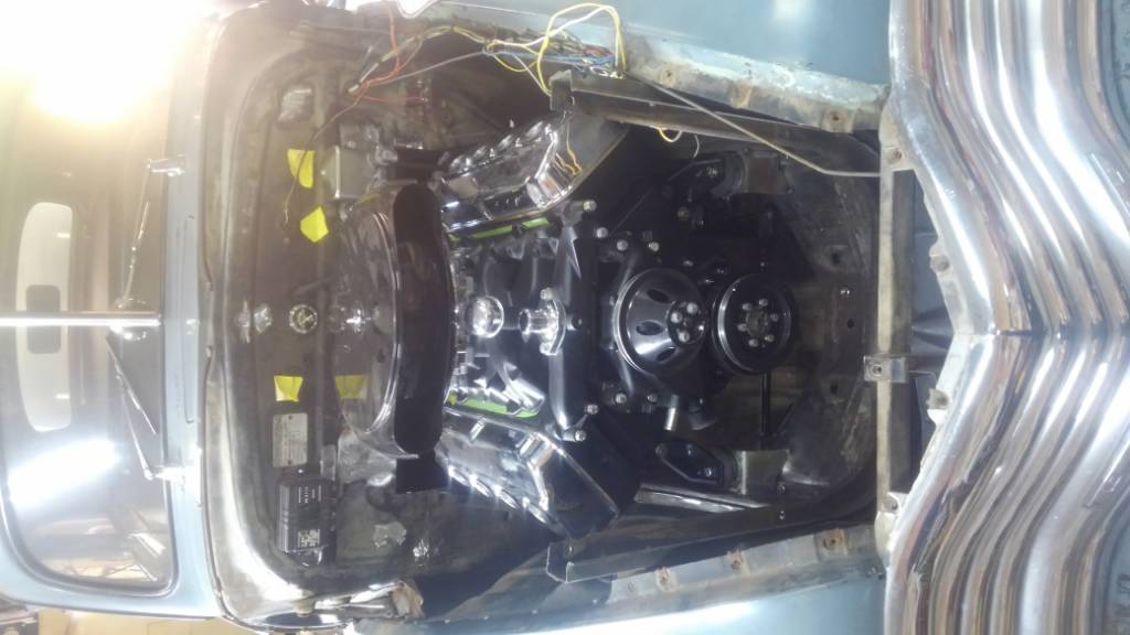

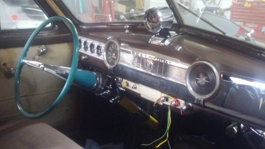

    Hemi sat in place in it's mounts. Steering column mocked in place and 61 olds steering wheel. KIMG0565.jpeg KIMG0573.jpeg

  17. CGkidd
    Joined: Mar 2, 2002
    Posts: 2,910
    CGkidd

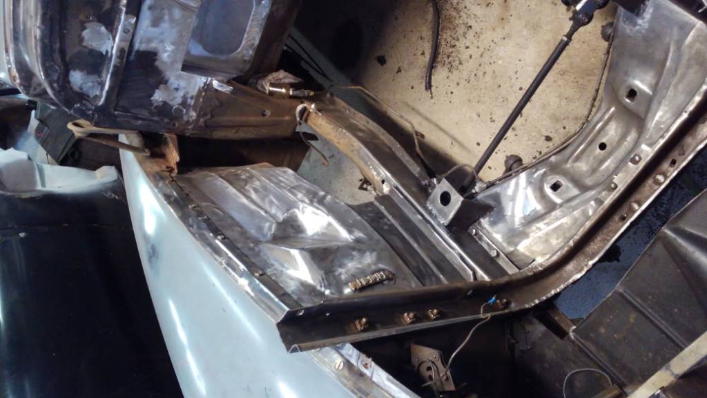

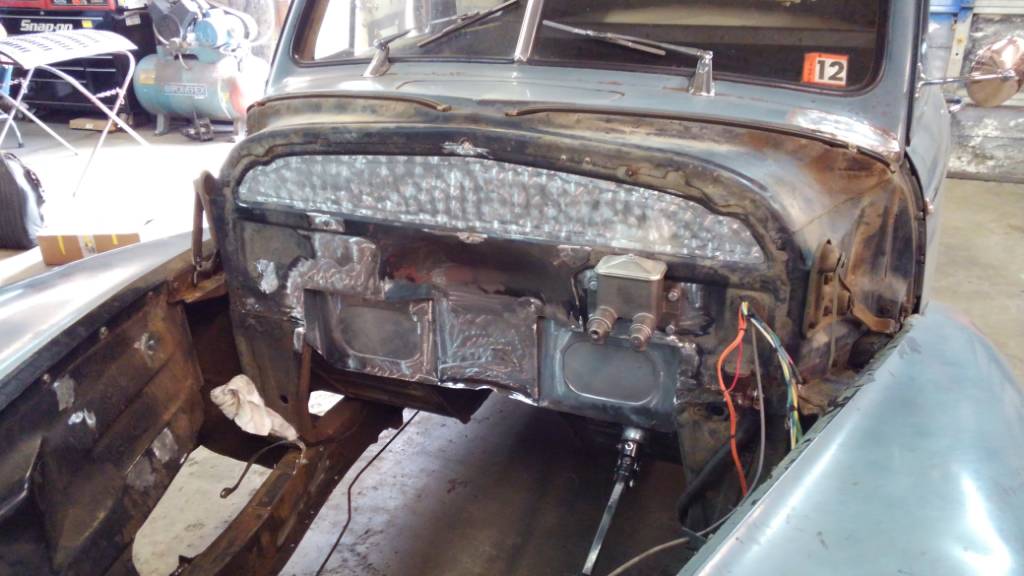

    Got the clearance issues fixed. Getting ready for body work and paint. KIMG0017.jpeg KIMG0037.jpeg KIMG0021.jpeg KIMG0020.jpeg

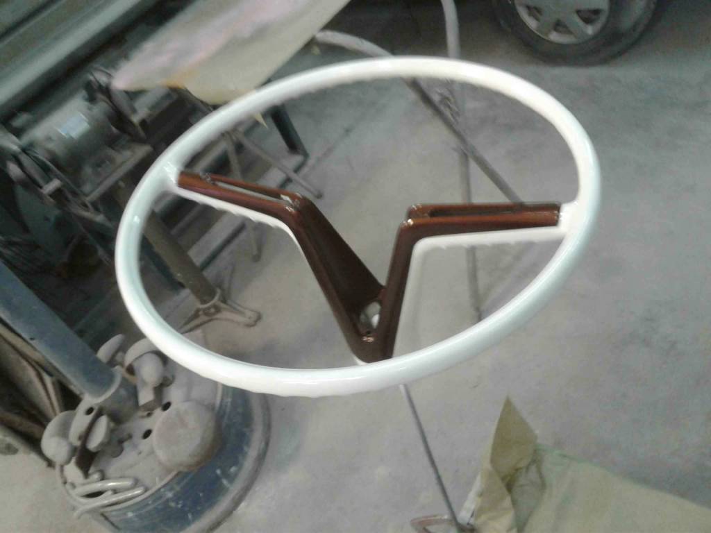

  21. CGkidd
    Joined: Mar 2, 2002
    Posts: 2,910
    CGkidd
    mgtstumpy and tb33anda3rd like this.
  22. CGkidd
    Joined: Mar 2, 2002
    Posts: 2,910
    CGkidd
  23. I painted my steering wheel white once.........Looks good fresh, not so good after 2800 miles. I would recommend switching the colors around. Otherwise rock on.

    Looking good. How did the package tray etc end up working out?

    Came out good. I will try to get some pics later. The car is stripped down to get ready to blast.

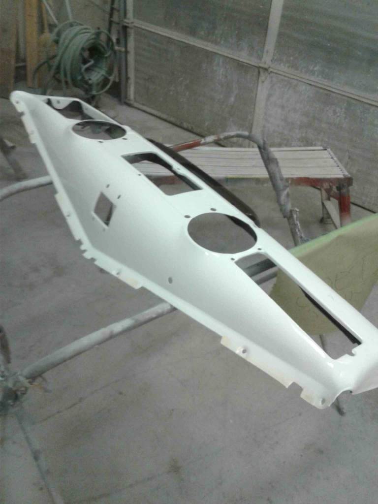

  29. CGkidd
    Joined: Mar 2, 2002
    Posts: 2,910
    CGkidd
