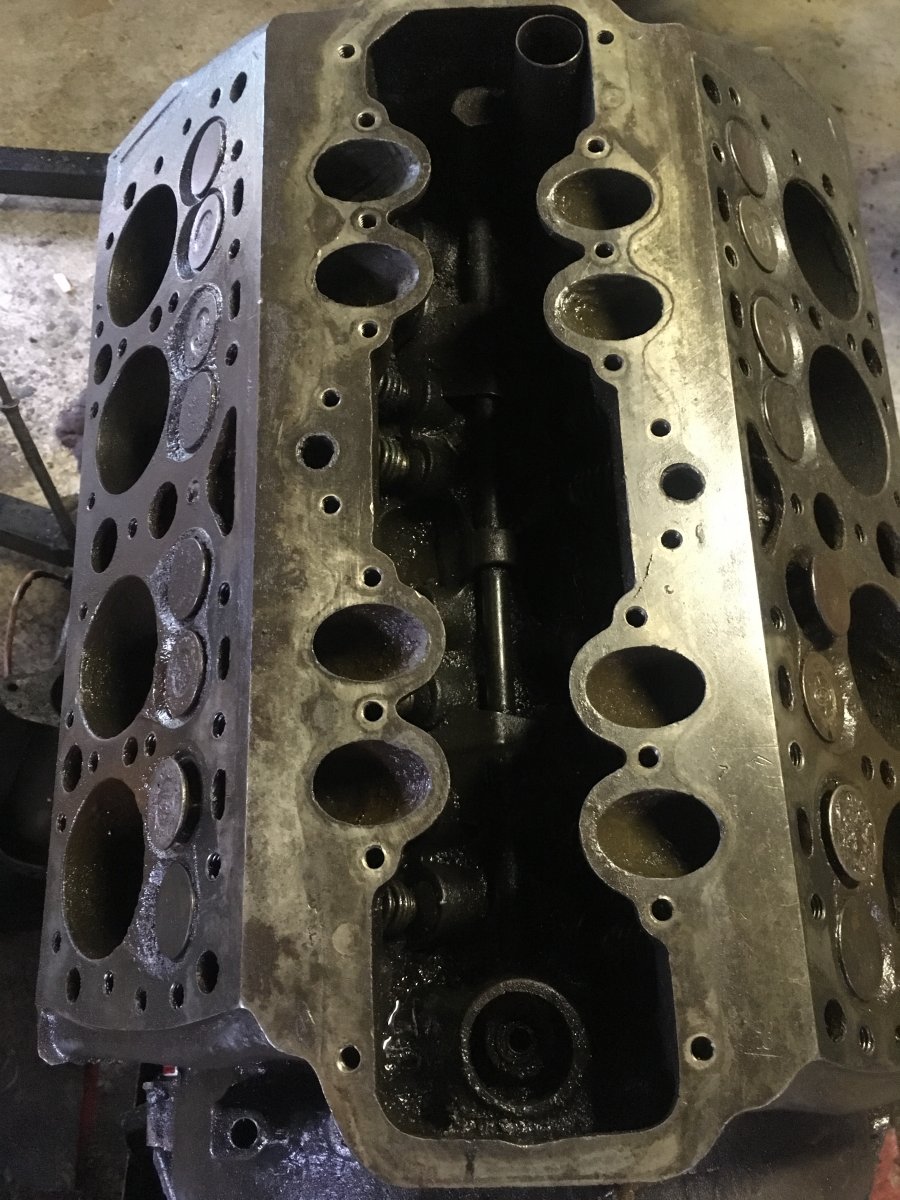

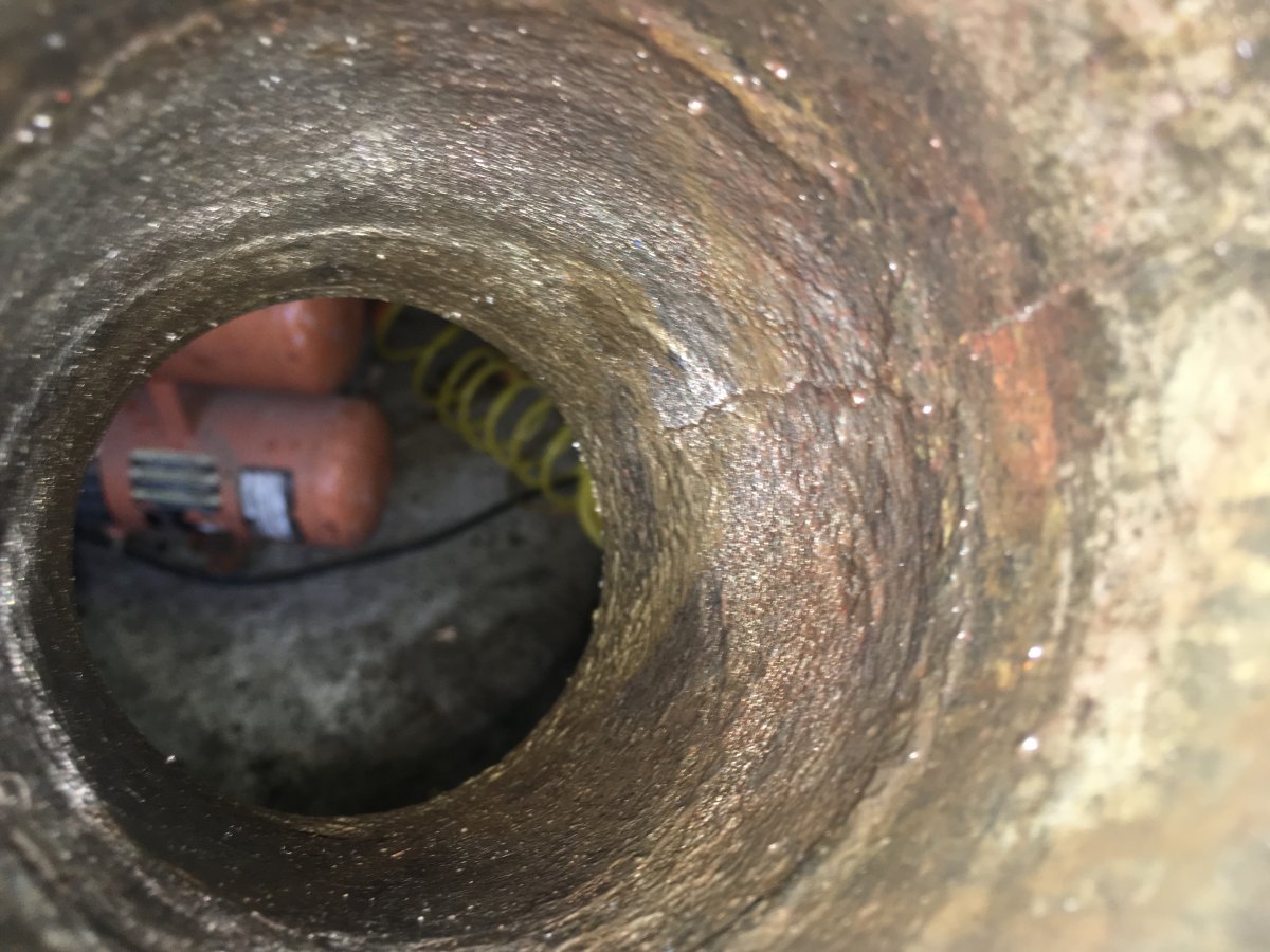

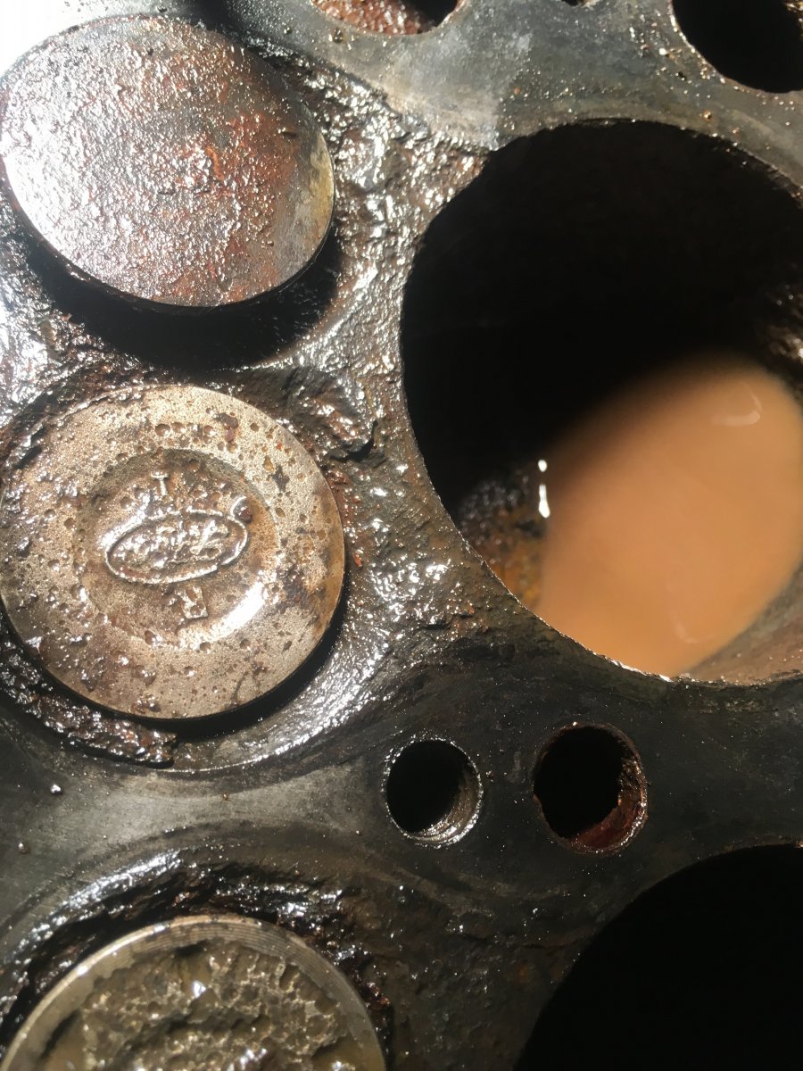

    All intact, all original, couldn't pass it up. showing 96,000 miles. Been in Colorado I believe since 1976 due to some stickers I found in truck. I knew it had been sitting for 10 years where I found it. What is going on in these cylinders? IMG_1485-1.jpeg
    IMG_1510.jpeg believe original head gasket
    Some cylinders look better than others. Can I get some initial thoughts. Can a machine shop save her?
    hot tank/sonic clean, Pressure test, sonic sound the walls, put some sleeves in her?
    Does not appear to have been bored previously.
    Pitting so far seems the worst between valves and piston chamber. As long as the valves can seat should be fine? slightly lower compression
    Or make a coffee table out of her and search for a better block?
    I thought she would be in better shape in there. Doors and windows work fine :)
    New to flatheads.
    I believe truck is a 1946 1.5 ton, model 69U, with 59AB
    Any thoughts are appreciated

    Good project. Pull it out and clean it up so you can see an obvious cracks , defects or.... then decide...Drop it off at your local machine shop and let them give it a look over before proceeding with any machine work .

    I hope you are ready to spend lots of money ! Everything about Flatheads is expensive, and finding a machine shop capable of doing the valve work correctly is getting rare these days. That truck would be a great candidate to purchase some adapters, and drop a 283 in it.

    Considering it's 3/4 century old it looks pretty darn good to me. As said taking motor to a good machine shop they can tell if can be rebuilt.

    Good news and bad news today. Popped off the intake today. I ordered one of those fabricated plates that bolts to intake; it's suppose to be here Tuesday so I should get to inspect bottom end of motor and do some cleaning next weekend. Good news was I found some oil (more like varnish but better than rust) under the intake. I cannot believe the accumulation of metal in air inlet chambers. Might need minor porting... lol The material is metal as I took a magnet to it out of curiosity. Going to wait until engine is upside down or upright to clean further.

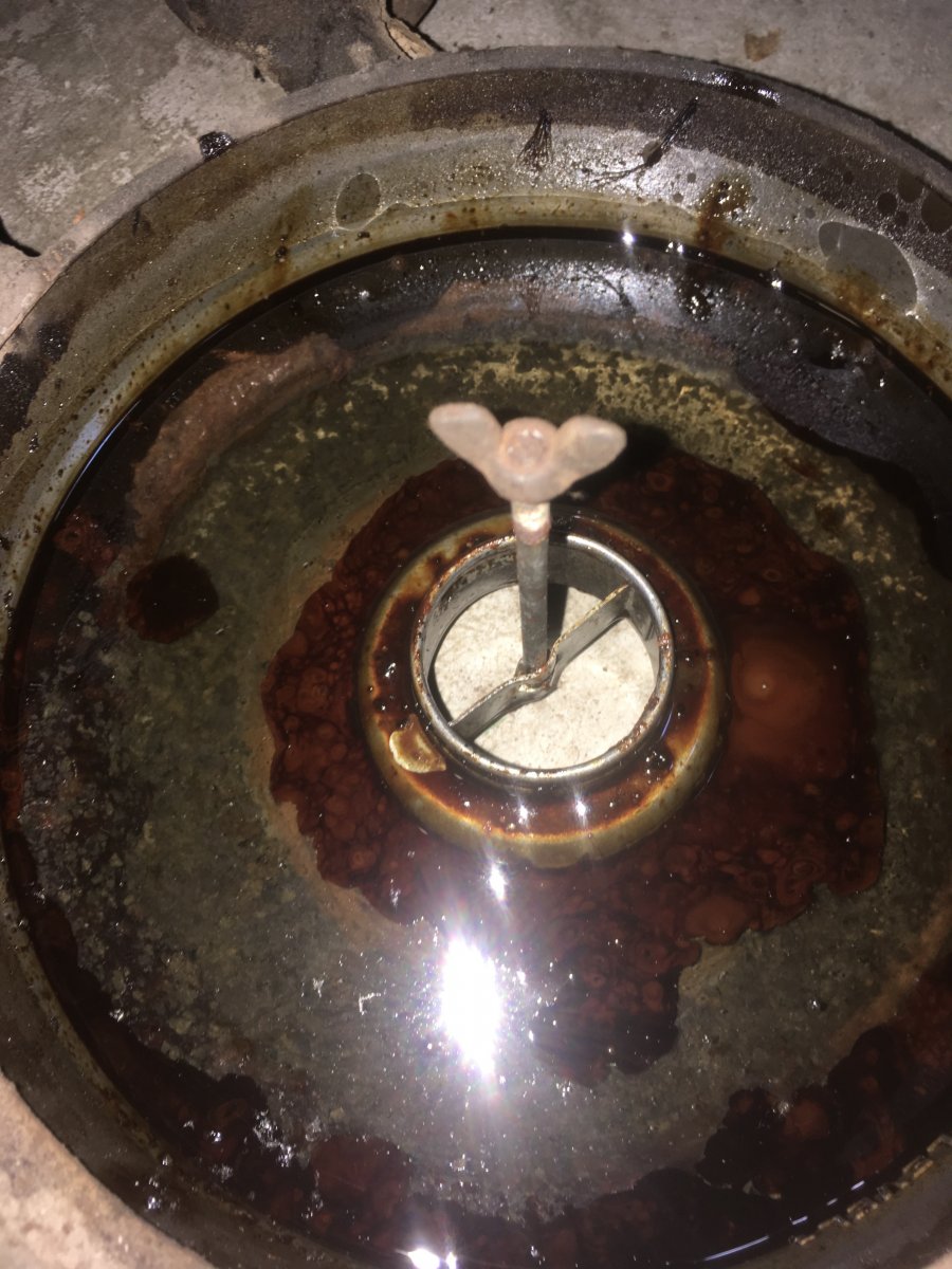

    IMG_1603.JPG Another thing. Here is a pic of inside of oil bath. Why so much water? from being neglected while it was last driven? moisture accumulated from driving in rain? condensation? Tablespoon of oil. Cup of water??
  26. 67L36Driver
    Joined: Jun 1, 2020
    Posts: 77
    67L36Driver
    Hood open or no hood at all plus many, many thunderstorms has funneled water into that engine.

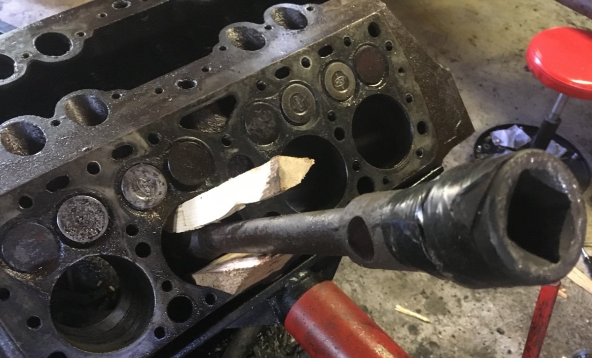

    Yesterday I got pistons and crank out.
    Piston removal tool. I was using 100 plus year old rough sawn true 2x4 blocks.
    2 pistons wouldn't budge
    The truck came with an old wheel wrench so I poked a 3/4 " x 1" adapter in it wrapped a little electrical tape around it (didn't want to damage the tool) and hit them with sledge. wood wedges holding apparatus in place. They both popped out.

    Most cylinders look good. Two look kind of scary. The one I've been most concerned about since I've popped the heads off I believe is cracked. Time will tell if it can be bored to clean up/repaired with a little weld and sleeve. It doesn't appear to make it to entire length of cylinder wall. No other visible cracks to my eye.

    hard parts done! get a long screwdriver and scrape the shit out of the water jackets. vacuum, blow, scrape, repeat. you will get a pile like this from each side IMG_1182.JPG
