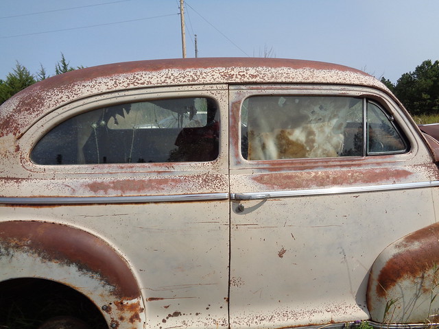

    The good, Bad, and Ugly of the body;
    Damage to the drivers rear quarter

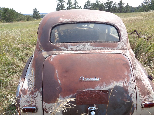

    Trunk/Rear Deck
    [​IMG]DSC00265

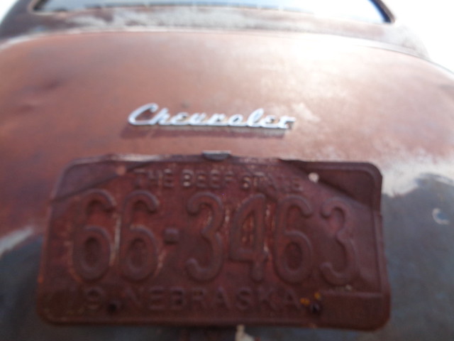

    Still has the last plate. This is a blessing as I'll have to get a bonded title for this car, and this makes it simplier.
    [​IMG]DSC00266
    [​IMG]DSC00267

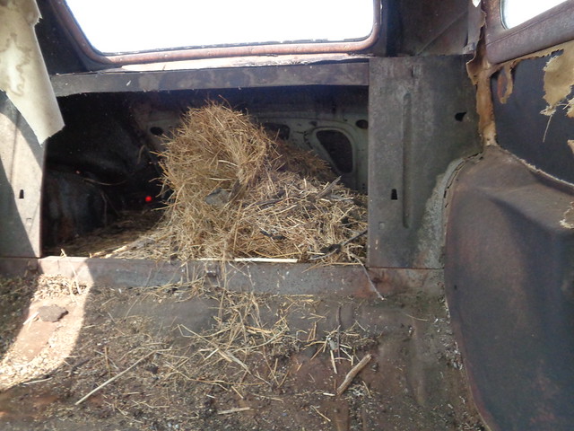

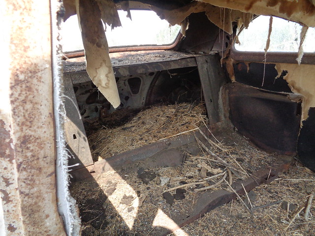

    Is that a bale of hay in the trunk?
    [​IMG]DSC00271

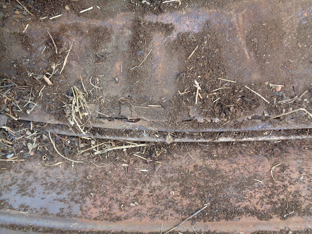

    The only real damage on the floor pan, lots of pin holes
    [​IMG]DSC00274

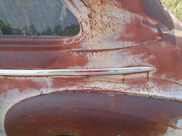

    Rear quarter near the trunk
    [​IMG]DSC00278
    [​IMG]DSC00279
    [​IMG]DSC00283
    [​IMG]DSC00285

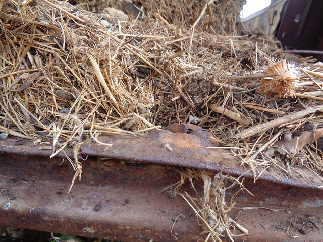

    Oh look, here is where the spare goes. It was full of 'stuff'. Has a decent hole rotted through. I will more than likely cut this out and patch it flat
    [​IMG]DSC00281

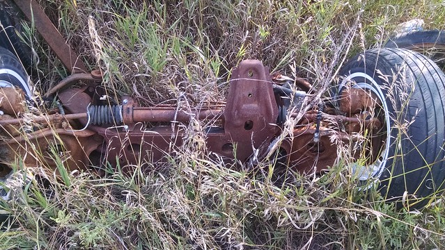

    Pacer front suspension, I can have it for free... hum...
    [​IMG]IMG_20160901_165600085
    The racks are very expensive and so are some of the other parts, but free is nice.

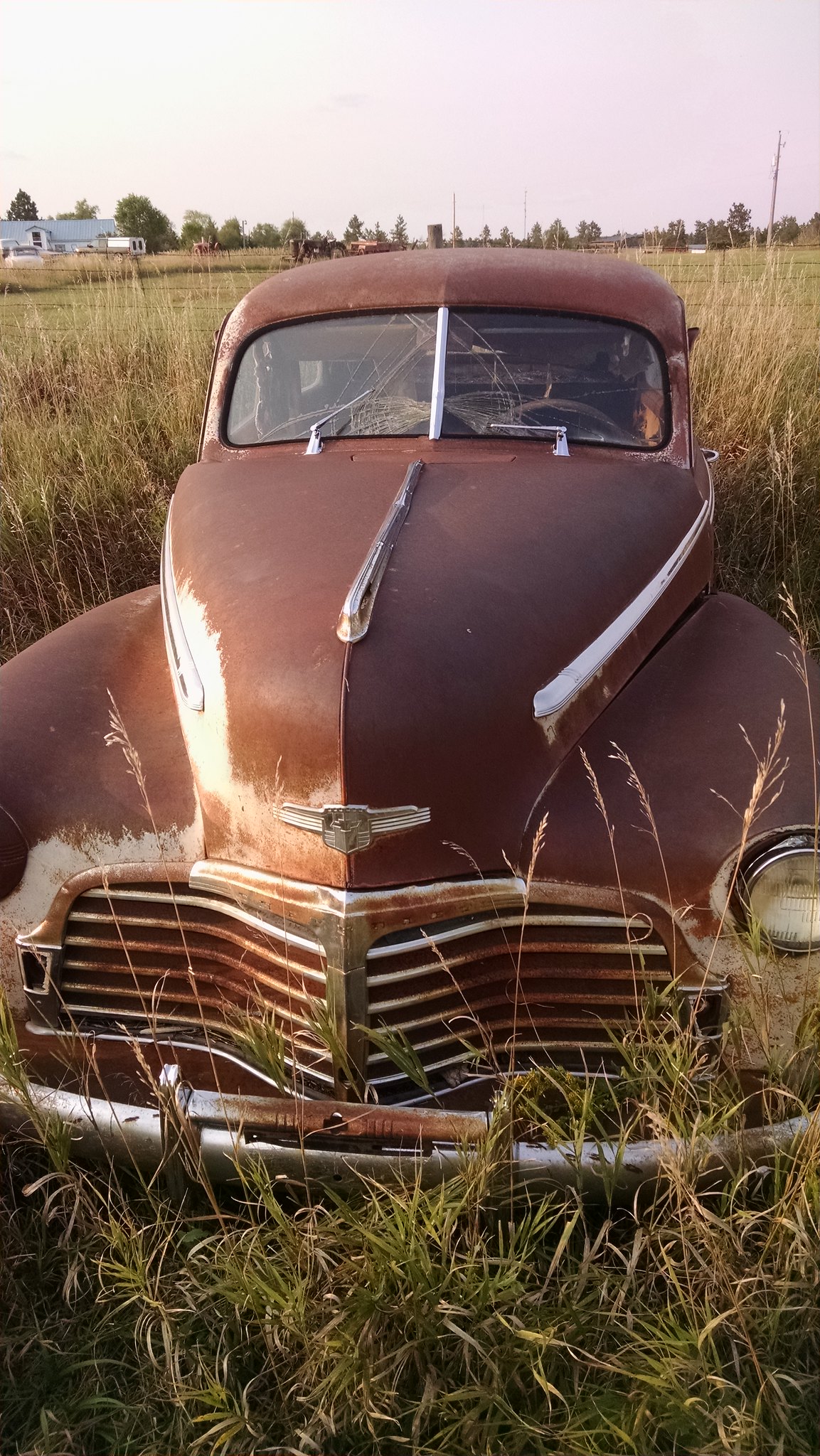

    By now you've probably figured out you have a '42 Stylemaster, not a '40 Special Deluxe.
  3. No, I've been going off it being a 40.I just picked it up yesterday. No data plate on the inside, haven't got the hood open yet. That's what I get for being a Ford guy.
    I see it now. The headlights. Dang...
  4. You basically have a pretty solid old Chevy. GM products of that vintage around here (northwest GA and NE Alabama) were famous for the floors and trunk floor rusting out, so what you have is better than most we find around here. I would consider it a pretty solid old car. The Pacer front end is a good design, but it may be too wide for your Chevy, just have to measure and see. Lots of people put them under '50s Ford and Chevy pickups when they were plentiful in the junkyards. Probably been 20 years since I saw a Pacer on the road or in the junkyard around here.
  5. Thanks, I bought it on a whim, now trying to get it all figured out. Got the hood open, Style Number is 42-1211; which a 1942. 302 GMC has good eyes.
  6. 40 Chevy
    Any 42 car is super rare. The war stopped all civilian production. The fact that yours has chrome means it's pretty early in the production year.
  7. I'll be very interested to find out the history on the car when I do the title research to get my bonded title. The plate on the car is between 1956 and 1965 "the beef state" series, so it got parked somewhere in that period. I'm hoping to find the last owner and get a duplicate title instead of a bonded one also.

    Yes, you have a 42 Chevy. Those taillights were first used in 1941 and last used in 1948. 1940 Chevy has taillights with round ends and mounted vertical. Chev of the 40s carry lots of parts for your car and the majority of the parts are the same from 42-48. The only major difference between the years is the grill. Check out these sites. One is a 42 service manual and the other site is about 47-48 Chevys, which plenty of parts will interchange and great for reference. Oh and welcome to Chevy Heaven. The angels are singing.
