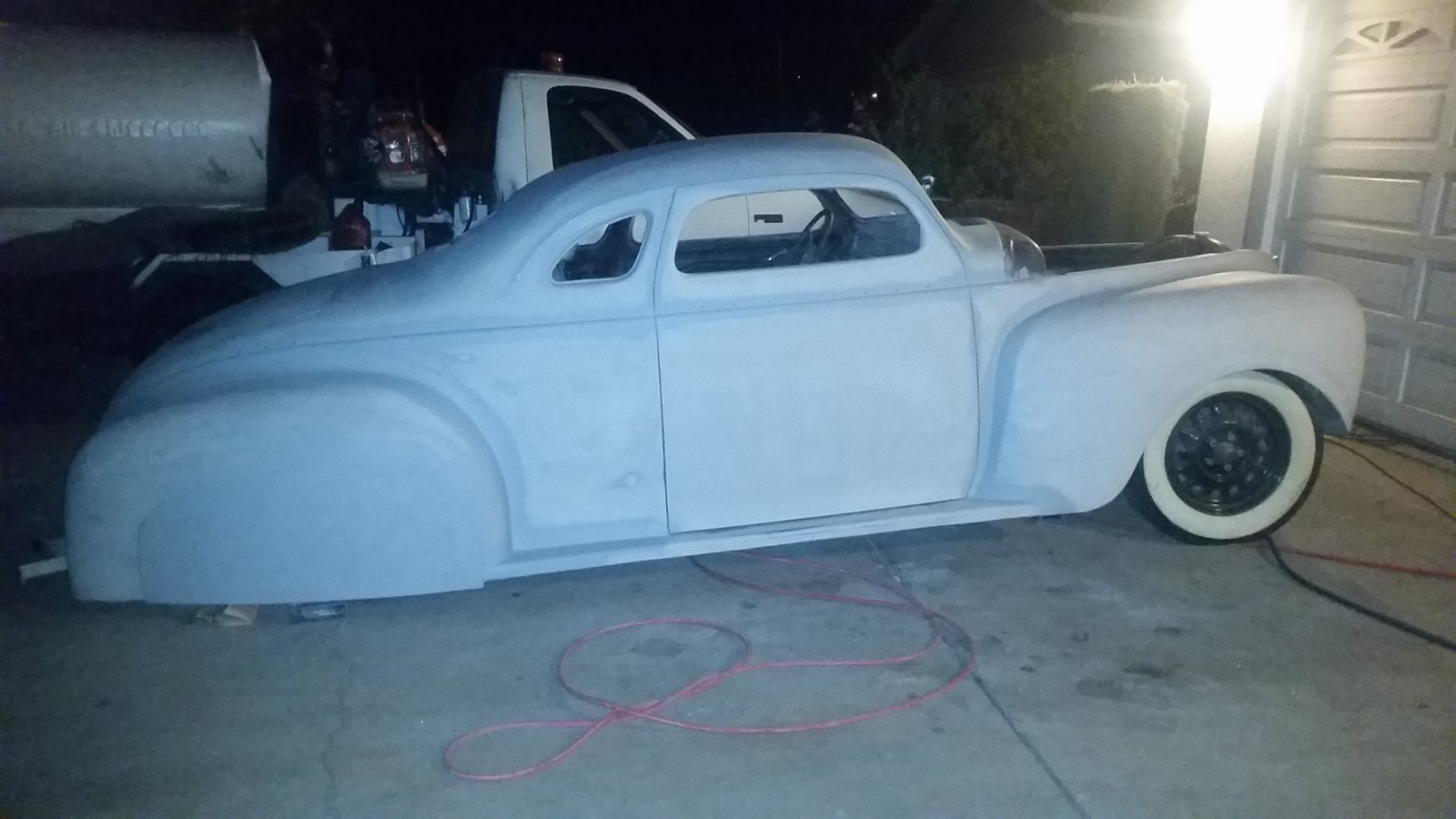

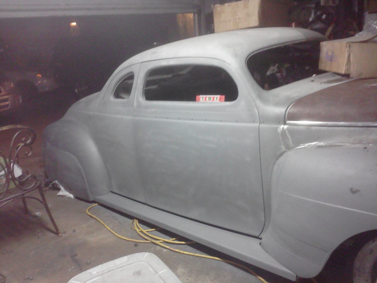

    back to work on the 41 didnt think i was going to do this but with the black cherry candy paint job i want to do it would look better ,molded fenders and removed all plymouth fender trim

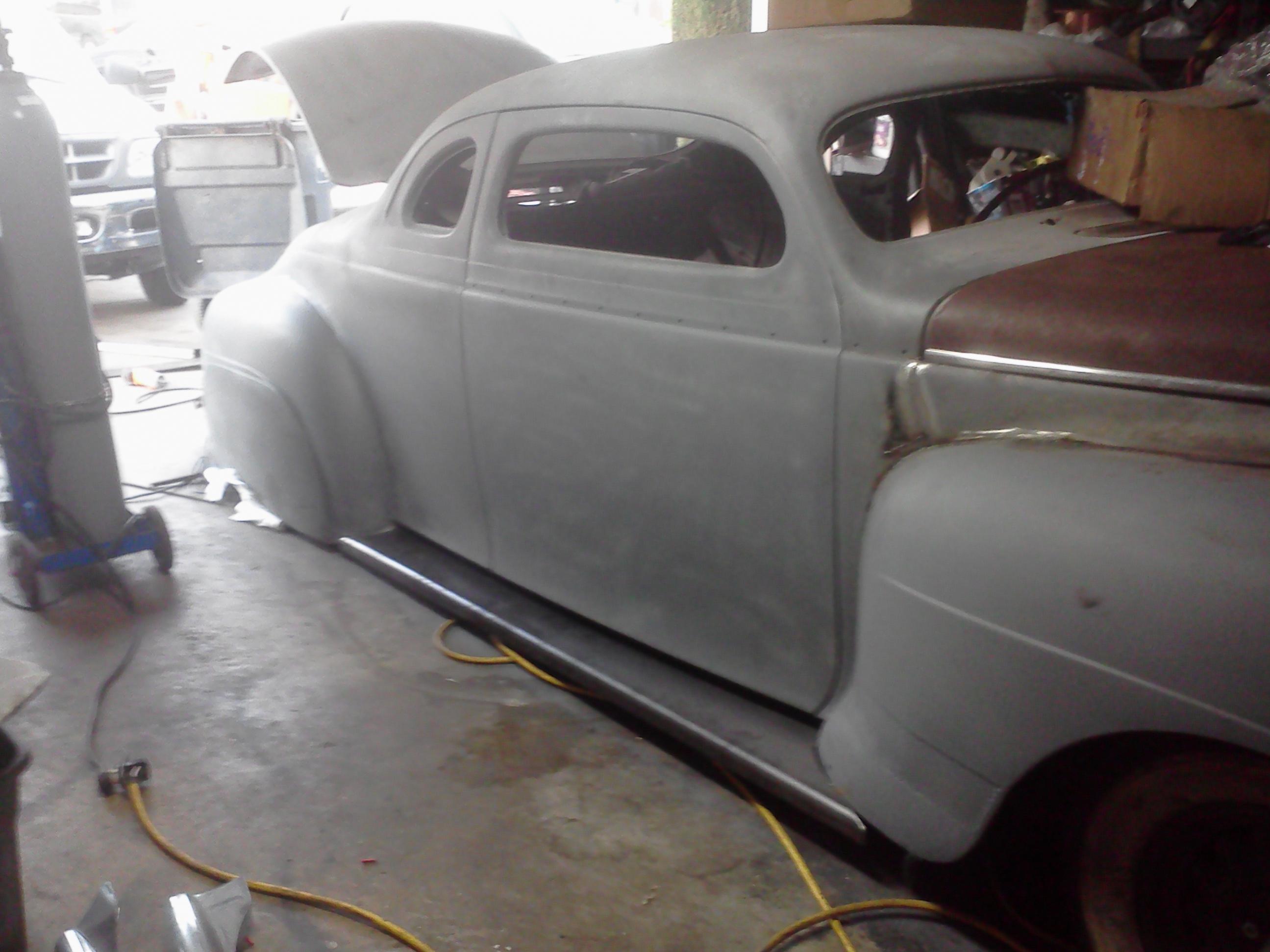

    Bodywork goin good

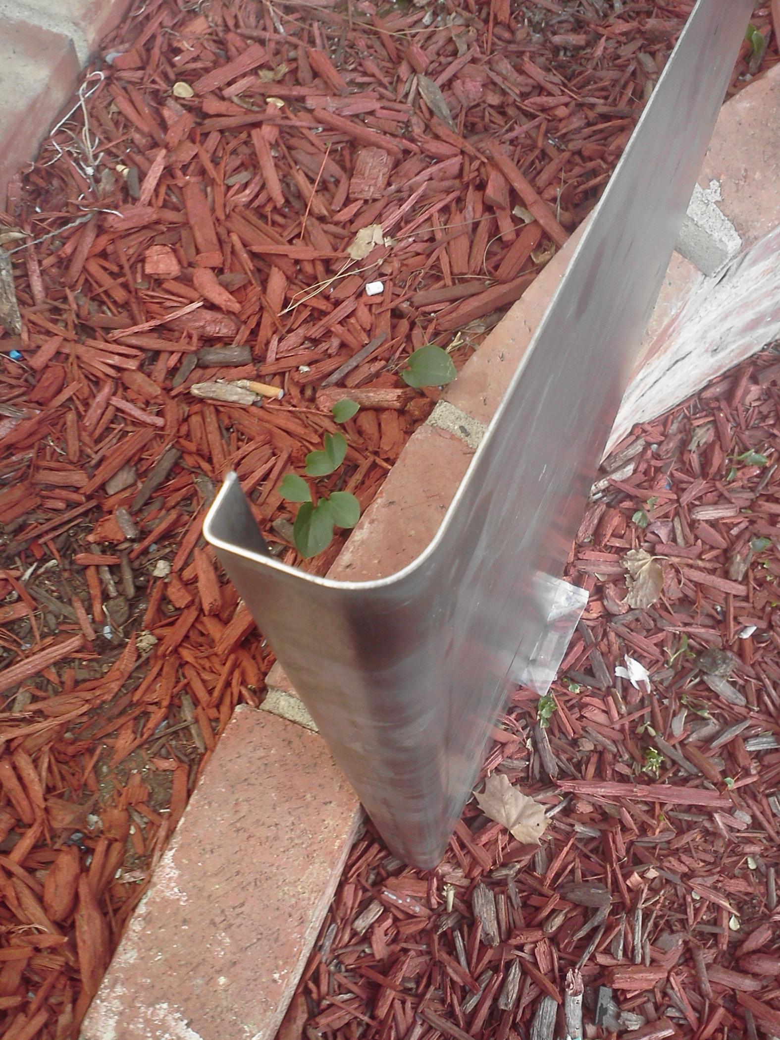

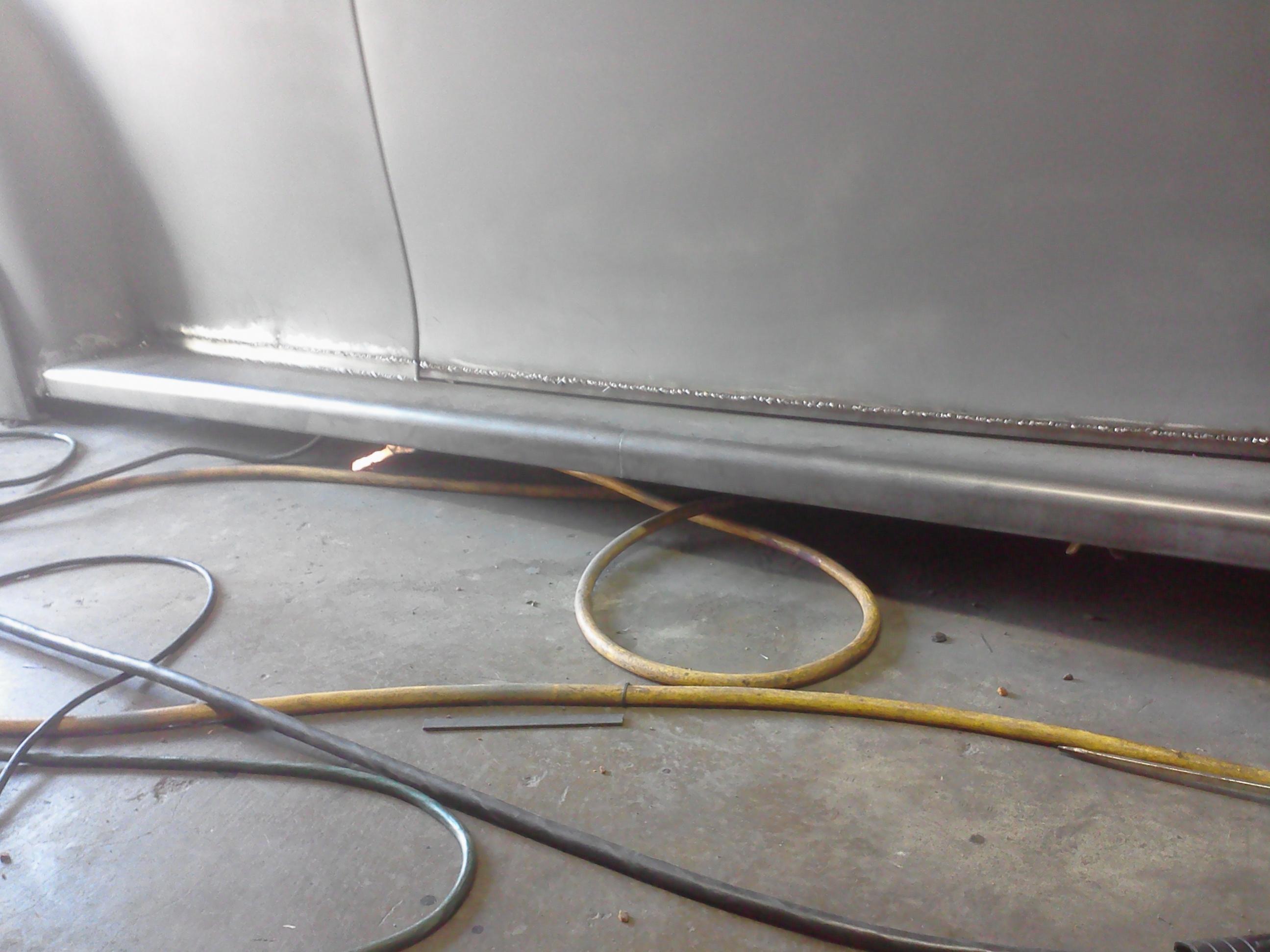

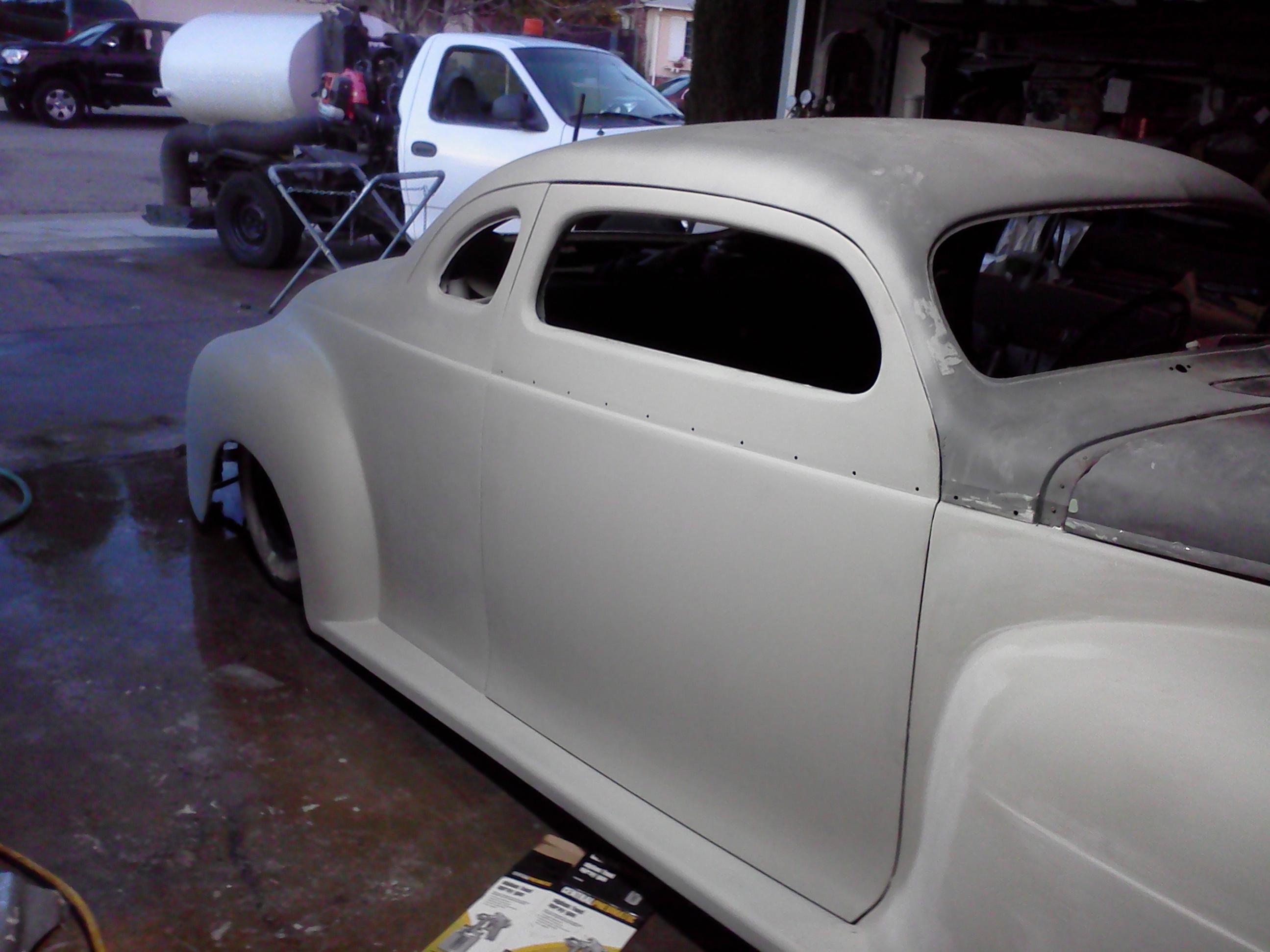

    hand made running boards made a cardboard template bent a piece of 16 guage sheetmetal cut and welded

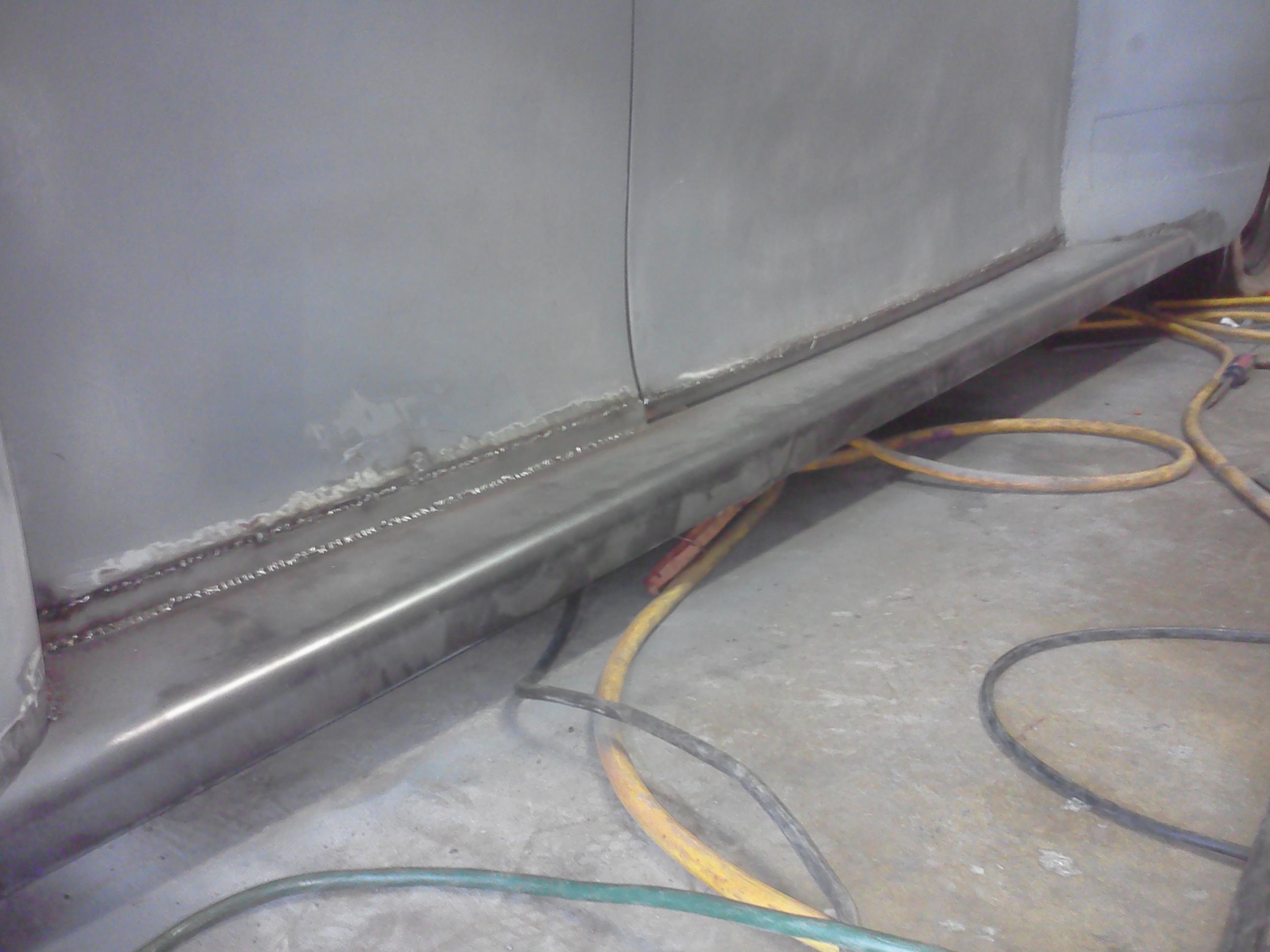

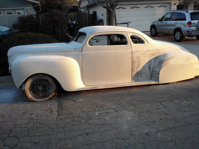

    extended quarter panels and door 3/4 inch to fill gap and mold everything together

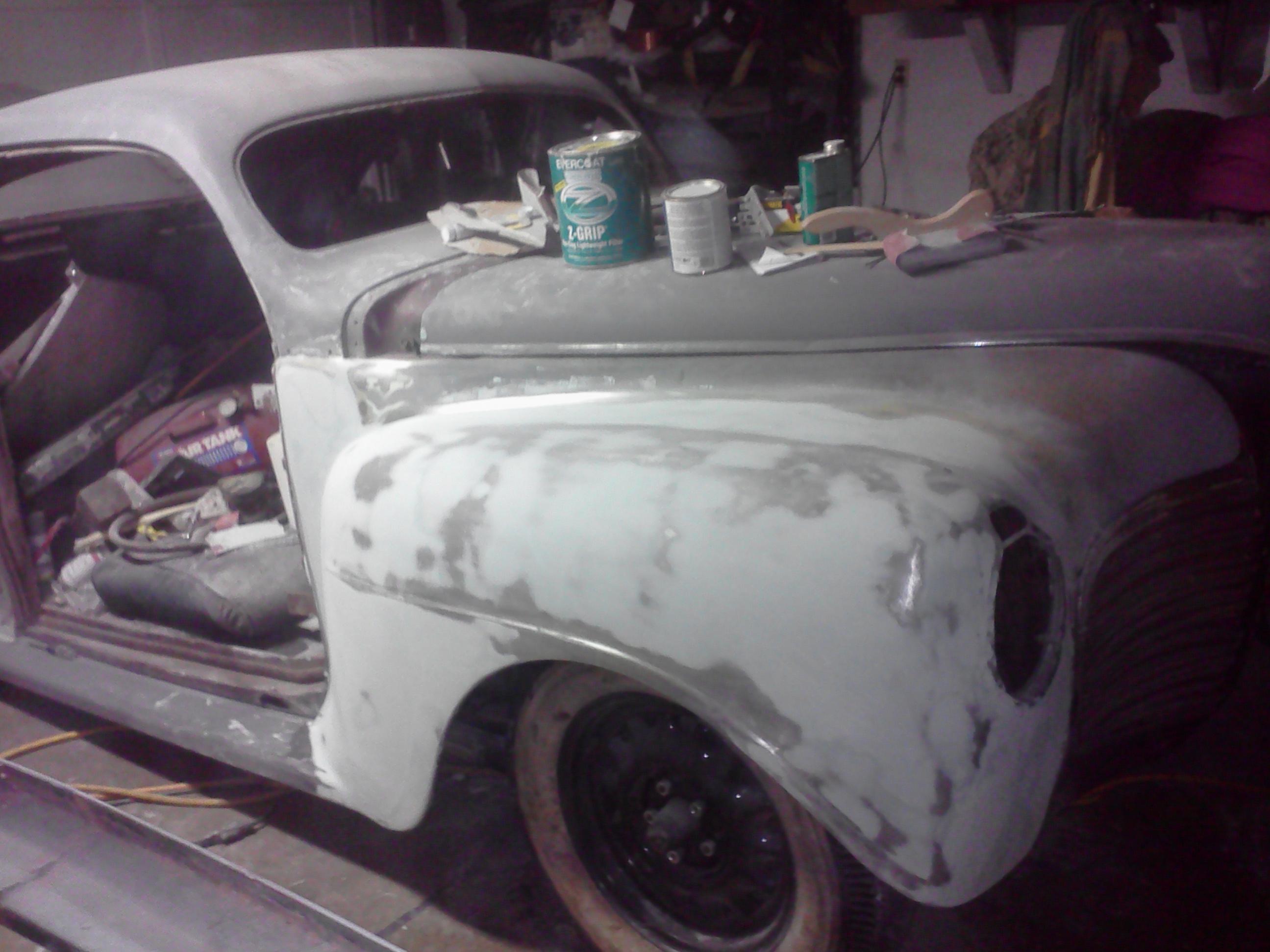

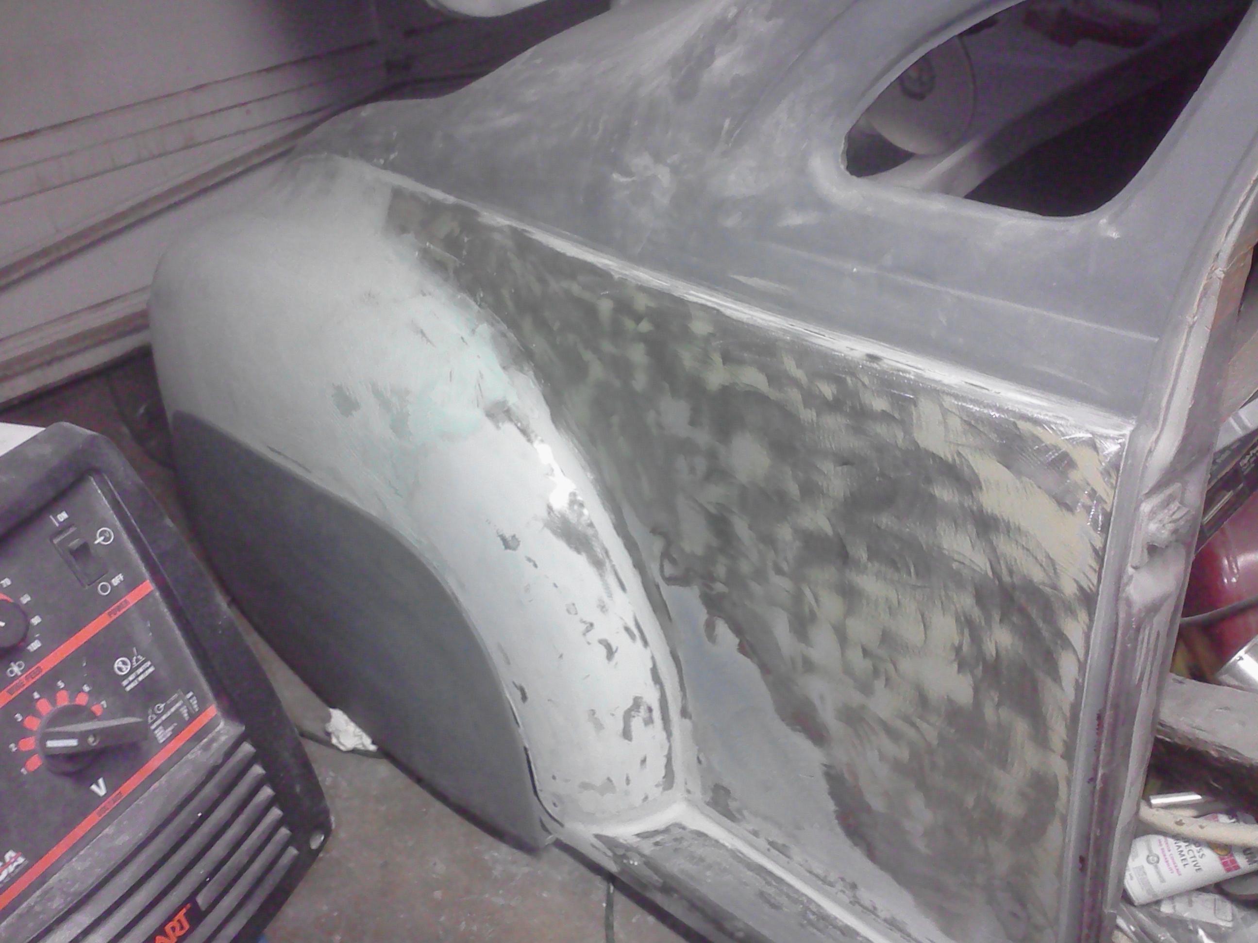

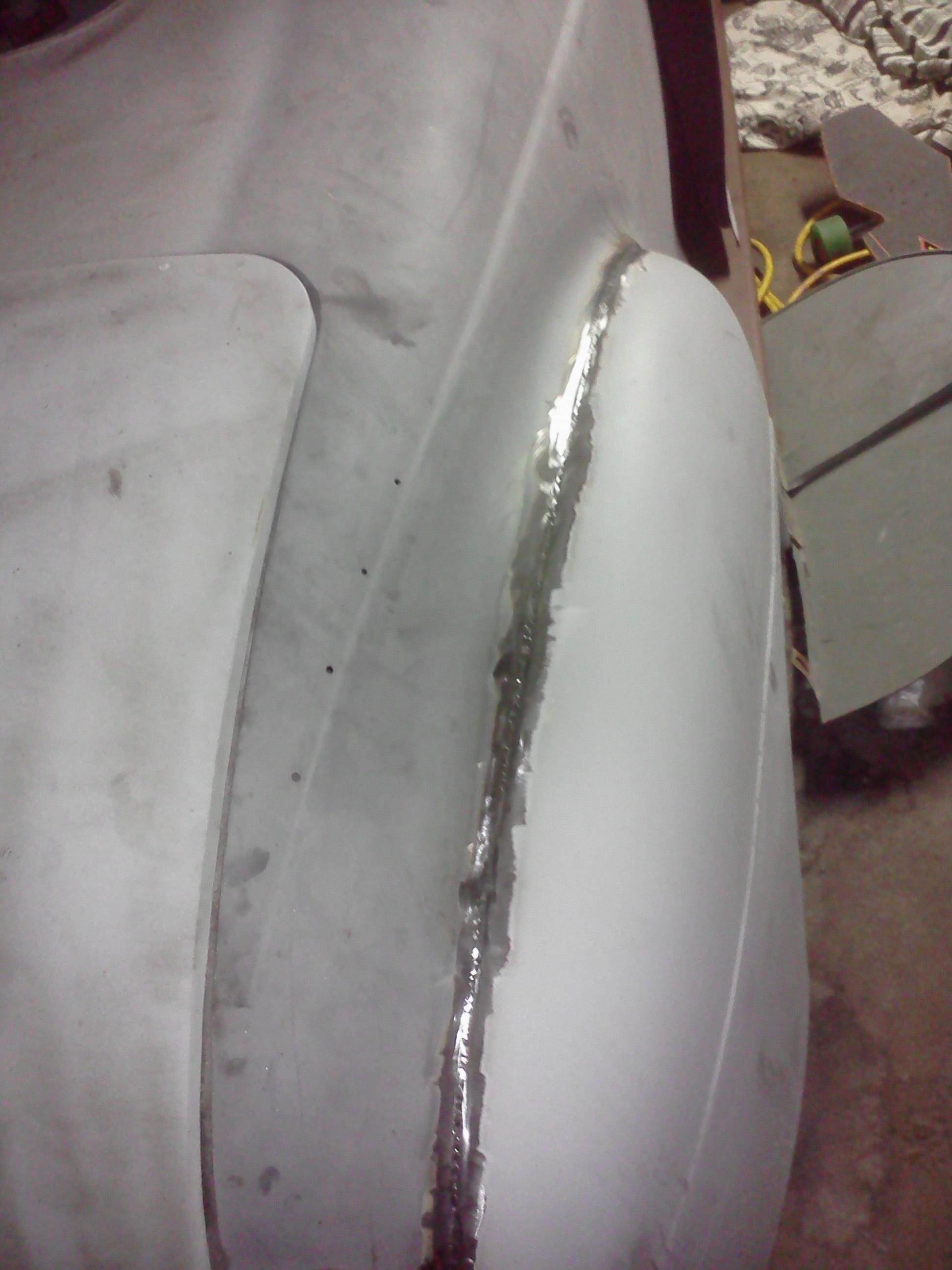

    molded fenders molded off fender ribs started body work and primer

    my respect for body-men it is by far the hardest messiest most labor part of build i am trying to get it as nice as i can primer block ,primer block, primer block my garage is a mess bondo dust everywhere neighbors hate me

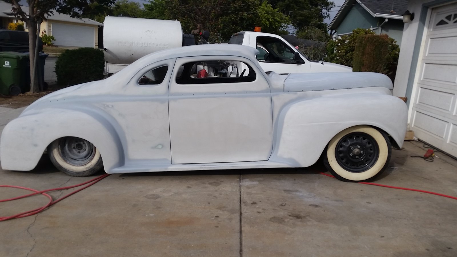

    Body work almost done

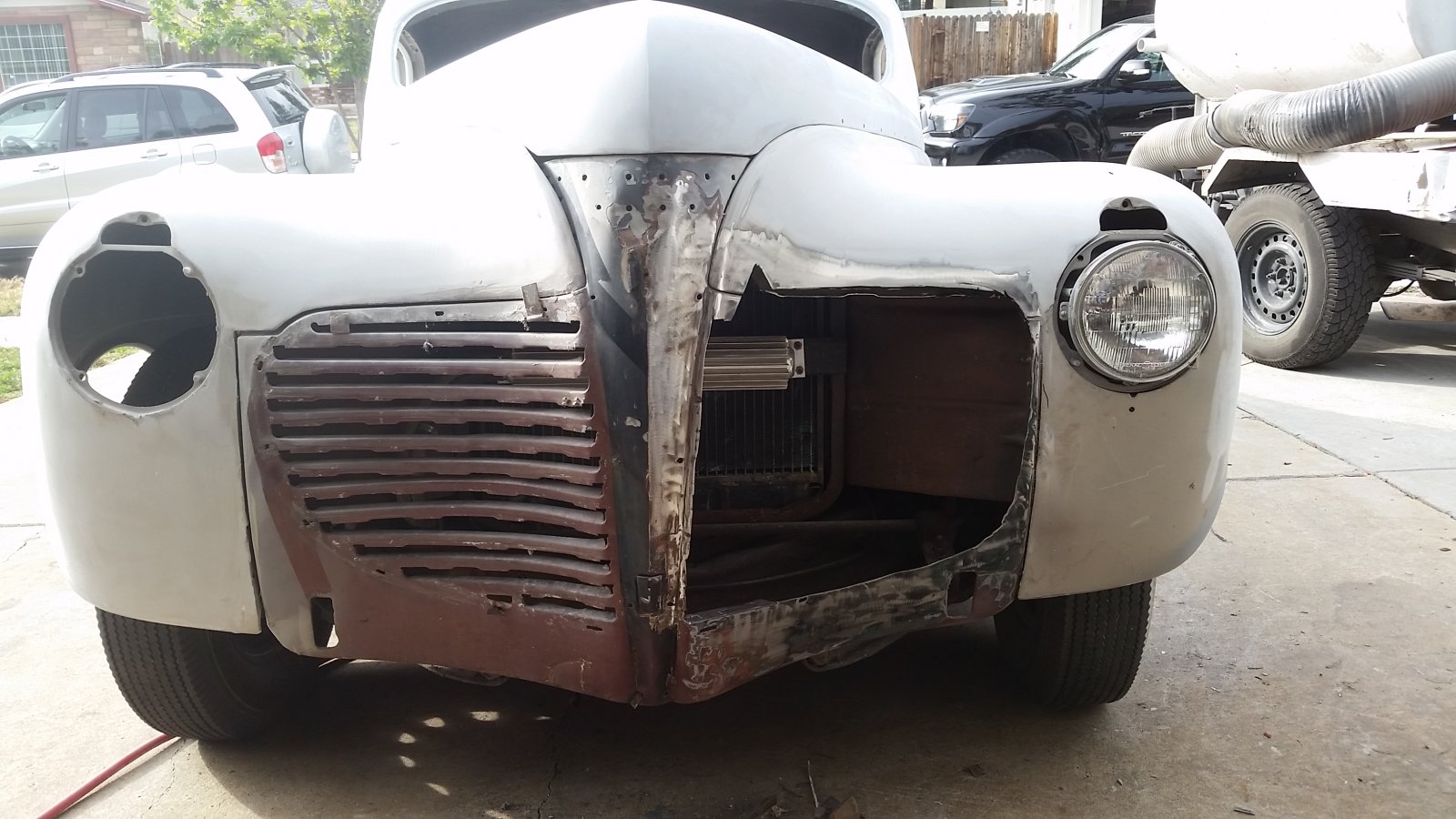

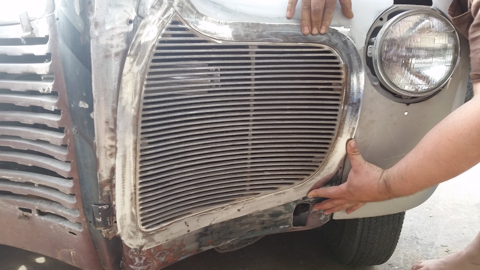

    1940 desoto grill 20150603_180029.jpg 20150603_180235.jpg 20150603_180200.jpg

    Great work. Love the built.
    The Desoto grill would give it a LOT of extra class.
