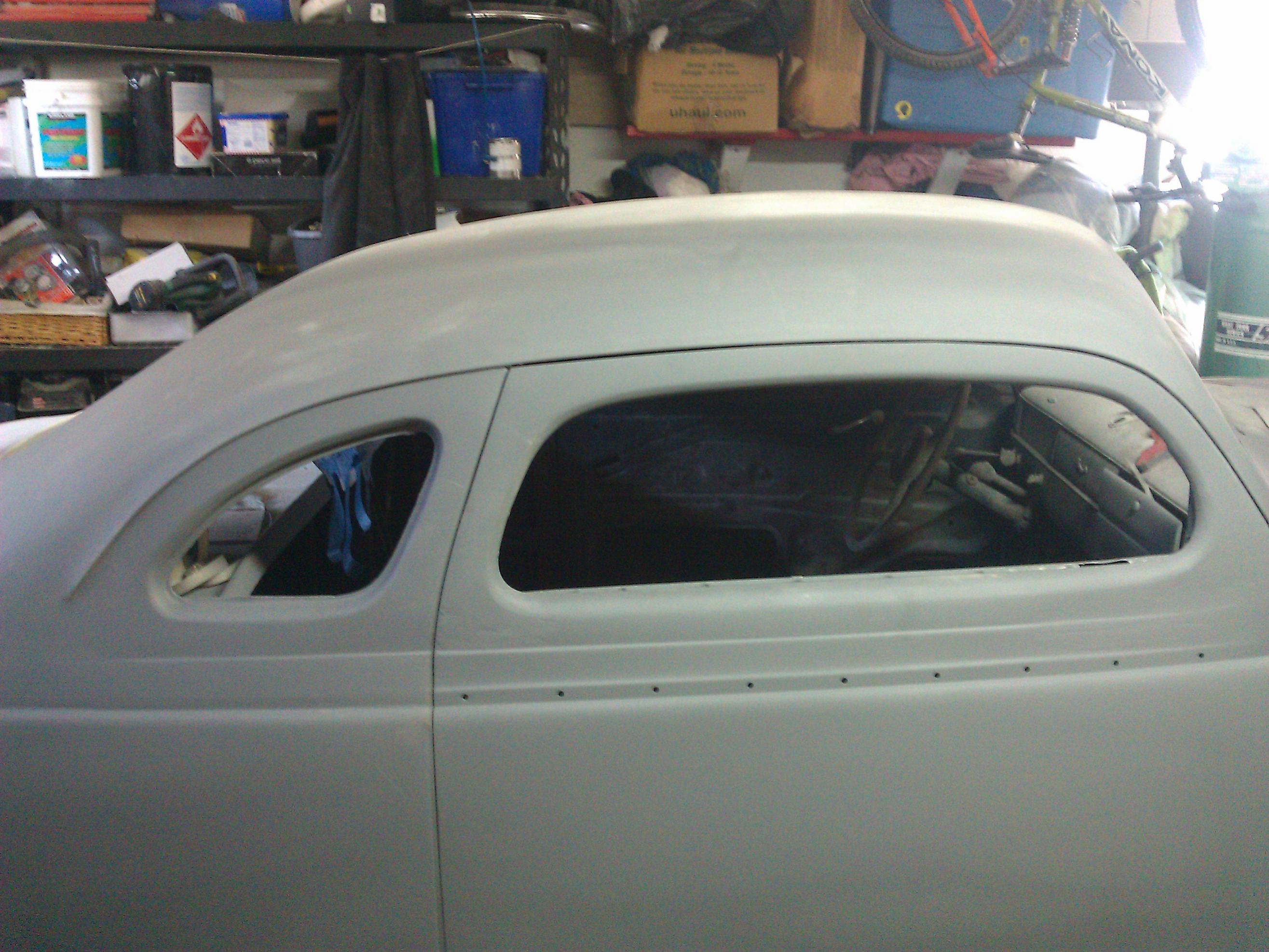

    I know that everybody today leaves the rain gutter in, but in a traditional way, the got to go. Look at Riksters website. All the Kustoms from back in the day removed them. You spend so much time on that bitchin chop and smooth lines with the rear window. Round corners on the doors and no gutters in my book. But no matter what, your car is awesome and 100 ways to build it. Just my opinion..

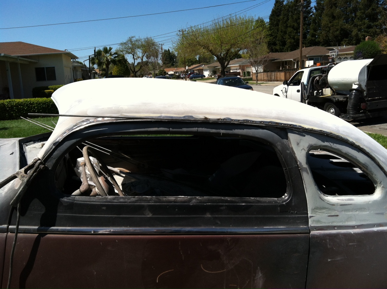

    1/4 round rod drip rail hate to do it but the rain gutters were in realy bad shape

    I must agree with you on this greasemachine, these cars look better without the drip rail imho.

    I am happy how the drip rails turned out did not want to do it but glad I did

    cut off vertical lip on original drip rail shaped and formed round rod in original drip rail tack welded as i moved along then after it was all tacked in cut out original rail gutter from underneath and welded in

    I understand what you r saying about cutting out the rain gutters but on this car I still want it to have some of that factory look my other car car was a totally smoothed out decromed chopped molded custom ,this car car is chopped but I want it still to look like a prewar factory look thats why I am not molding fenders running a antenna ,painting it a solid color lacquer paint almost to give a stock look I regret removing door handles they were nice

    I think you made a good choice.

    I like the custom drip rails you built. Nice work. You could always put the handles back on. Your choice, either way looks killer.

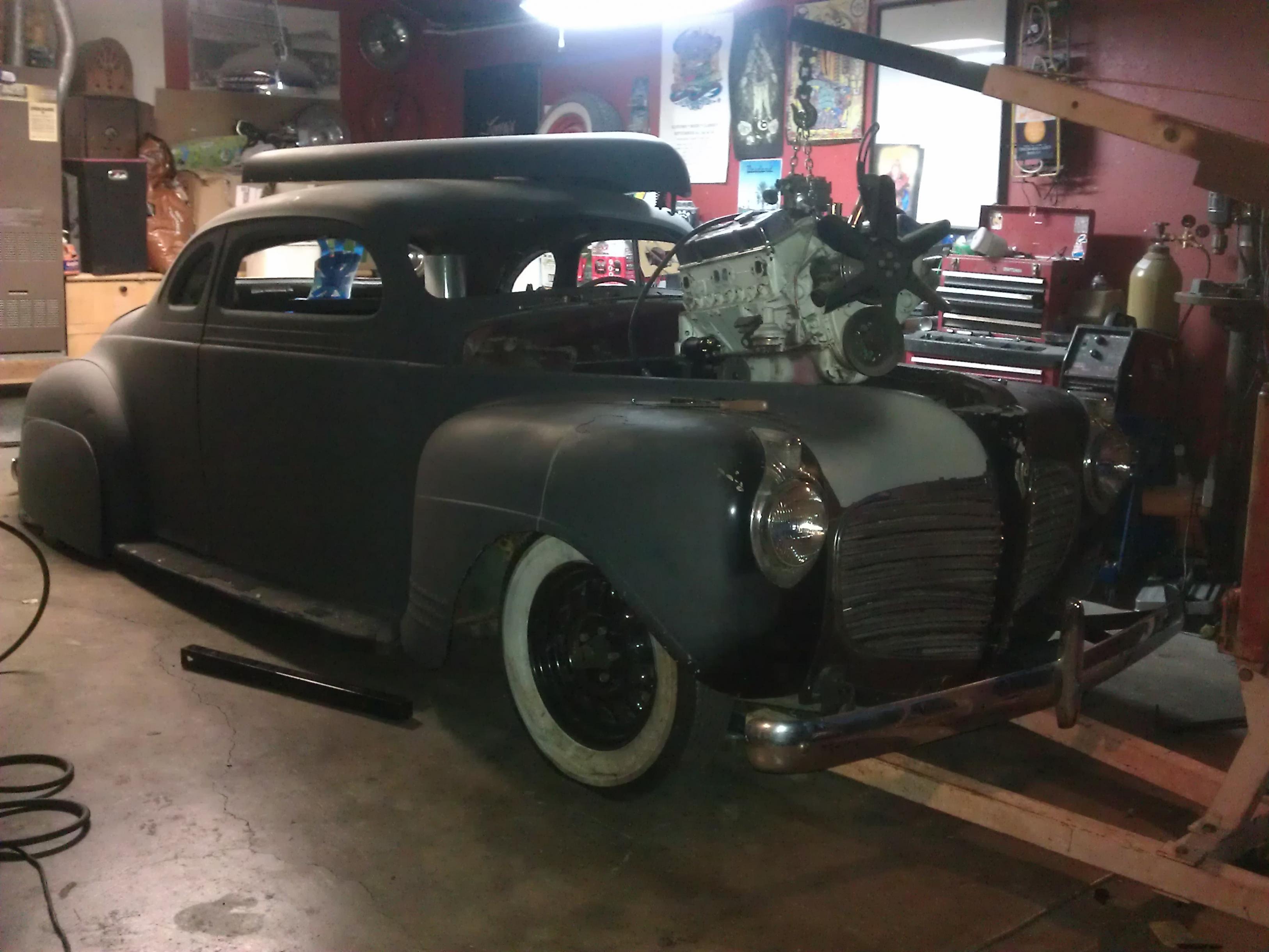

    heart transplant

    Looking good! Any more pics of the transplant?

    The drip rails look awesome. They make the chop look factory instead of an after thought. Good work.

    Looking better every time I see this thread! I would also like to see some pics of the engine transplant! I really like what you'r doing with the stock appearing custom!

    put some 1990 ford Aero star front springs cut a coil and a half fits perfectly

    Looking sick bro, mine gets color next week. Wish I would have known aerostars worked, just got eaton 2"drop. Did the f1 shock mount, actually raised my front end when shocks were put on?....
