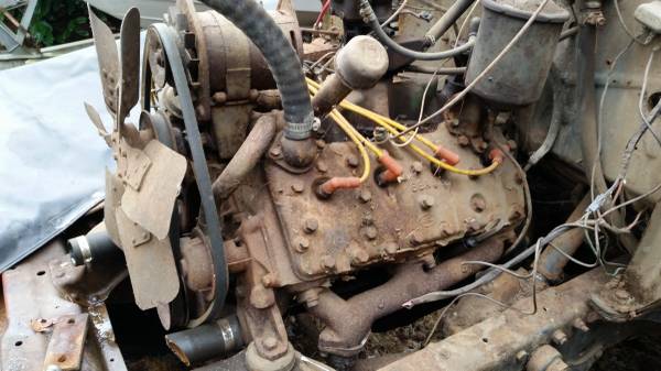

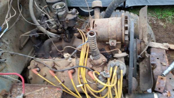

    Even got this idea to put this 1950 8ba in it. Go back to a flathead.
    Bought this ye 8ba.jpg 8ba1.jpg 8ba2.jpg sterday for 500 and it runs every year he said. From a f5 truck. Came with the pto trans and i will sell that. Carb moves freely and the oil is clean. Turns and can feel compression. Will check to see what points look like. He did say last year it started right up but smokes.

    Fired up the 8ba today and it runs great! No smoke! Idles good but carb needs a rebuild. No leaks from fuel pump. I took off the speed governor and it had a vacuum leak at the carb so i jb welded the broken fitting on. Also found that the distributor ground wire was dirty and rusty at the dizzy so after i cleaned that the spark was great. New plugs. Fired right up and ran clean and strong. Need a new carburetor or a rebuild. Think i got really lucky on this one. Will post a video when i get the carb done.
