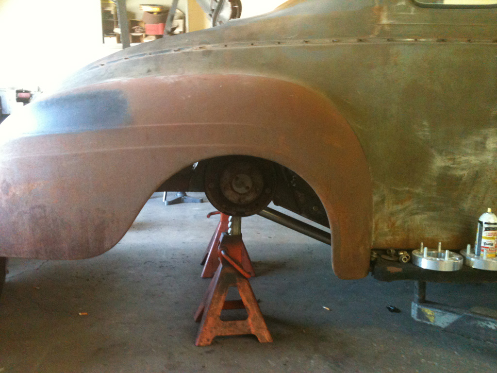

    Ill take some pics with the wheels on and let you know. If you are talking about the top of the wheel wells, there is hardly any room at all. On the frame, the wheel wells are filled up. The only way to get any more out of it would be to go with a smaller profile tire and 14" wheel combo. Im running 15" wheels with a G78 and a 3.25" WWW.

    Maybe it's better to go with 15's with a smaller profile, rather than 14's.....they may look a little funny on a relatively big car. I have about 1 inch of clearance to the top of the fender, when the car is completely laying down. Measure and measure again is what I did. Good luck and can't wait to see some new pics!

    Im right where I want to be with my tires right now. Laying frame with room to spare, but I am also running the stock frame height, which sits a little bit below the running boards.

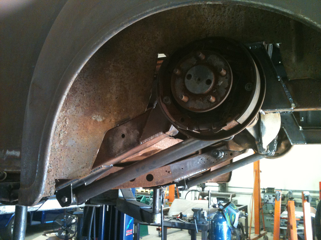

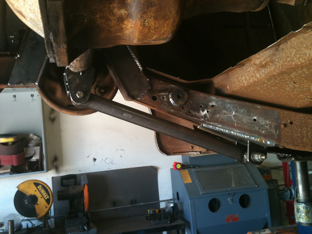

    We got the new rear cleaned up and the 4 link tacked in place. Pinion only changes 2 degrees from fully up to fully down with smooth movement. We started on the bag perches and will have functioning air movement probably tomorrow night. Once everything works as it should, everything comes back apart for paint and plumbing!! :D

    That is looking really good! When the rear is at ride height, are the lower and upper bars more or less horizontal? I would also make sure that the lower brackets which are connected to the frame, are boxed/strengthened as this is where most of the force is exerted. Keep up the great work.

    Yessir, horizontal. Geometry is way better than I expected it to be. Everything just fit right with the 4-link. Everything is boxed and is structurally sound for sure. Kept it simple this time, learned a lot my first time, but learned BETTER this time. Keepin on keepin on!! :)
