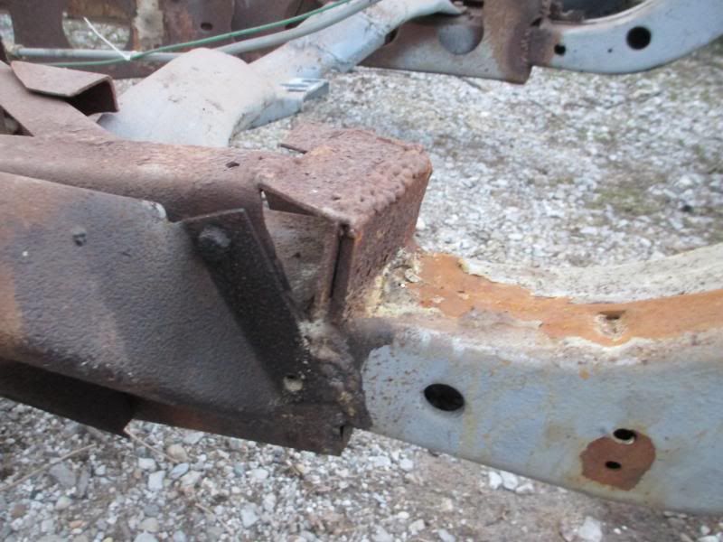

    This thing was pretty Mickey Mouse... now you can see why I decided to work with this other frame....

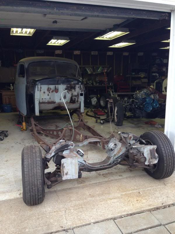

    Here is the frame installation...
    This is where we ended tonight:
    And with the frame in place I bolted it up and jammed the engine and tranny in there to sit for a bit... I have to pull the engine and tranny again and cut the motor mounts down and then fix the tranny cross member... then the whole frame comes out AGAIN for me to be able to paint it and install brake lines, etc.
    Finally I will slide the painted, nice looking frame in, put on the leaf springs while under the car and then the rear end... Then she rolls again!

  4. Previous owner needs to have his welder taken away! :rolleyes:

    Man, that was some real hillbilly fabrication on that old frame clip. :p

    Haha, yeah, I can't believe how bad that was.. good ratrod material. :eek:

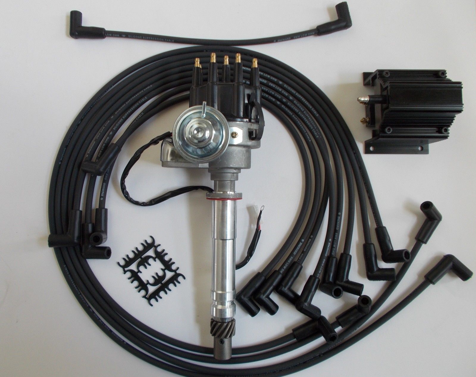

    Dave,
    is this the distributor that you were talking about with the small distributor cap and separate HEI coil?

    Yes, that will gain you about an inch or so, of much needed space in front.

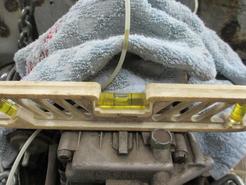

    Well, I got the motor mounts trimmed up and pretty close to where they need to be. Here are some shots:
    Its pretty much level as well.. I will tweak it and fix that:
    The tranny and oil pan are protected by the frame, so it seems like it is in the right spot.

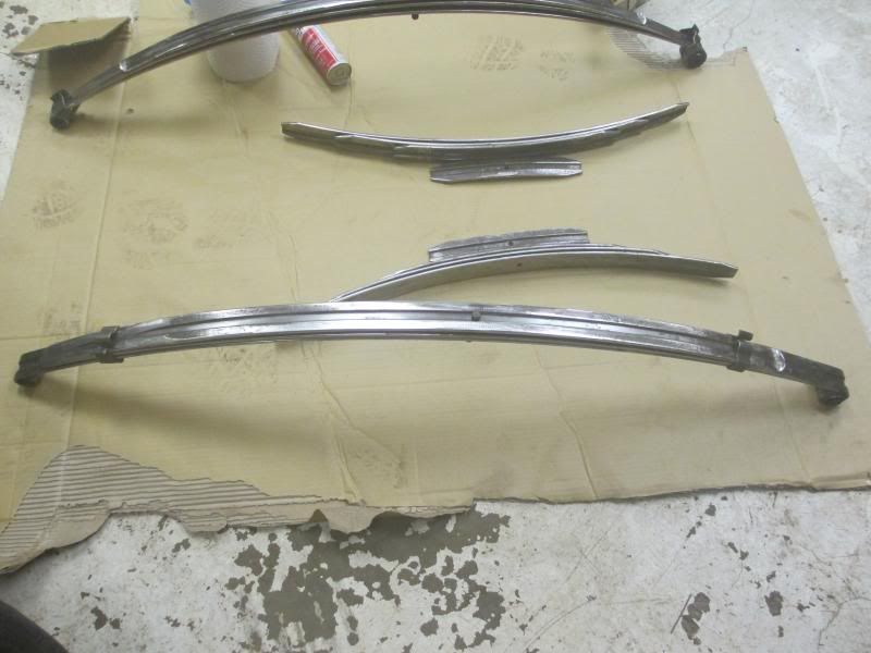

    Last night I moved the motor mounts back another 1/4 of an inch and will wait to do further work on it until I get my radiator core support in the mail. So I can put everything where it needs to be. I also degreased my leaf springs... man what a chore.
    I started to clean up the leaf springs today with my flap sander that goes on my big grinder.. I will need to stop by the store and pick up another wire wheel to finish it, but I will get these finished up this weekend and hopefully assembled by next weekend after they cure from paint. I will need to work on getting some of the pits smoothed out, but that won't take too long.

  25. 1959apache
    Joined: Nov 22, 2009
    Posts: 2,635
    1959apache

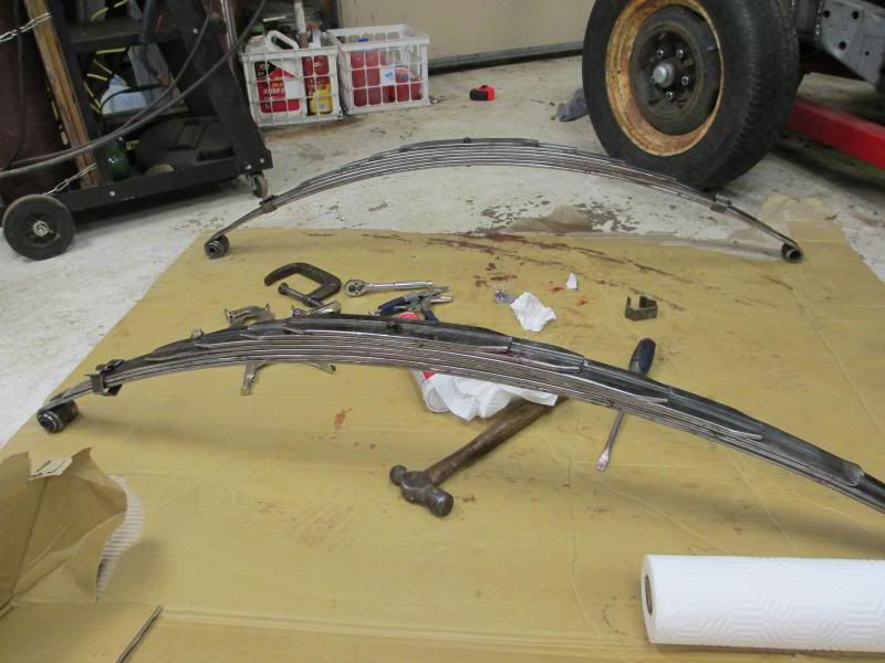

    Well I got the leaf springs cleaned up the rest of the way... I will grease them up assemble them then paint. That shouldn't take more than another couple hours worth of work to make sure everything is ready to go.
    Here are some pictures:
  26. fstfish66
    Joined: May 28, 2005
    Posts: 376
    fstfish66
    from eastern pa
    nice and shinny,,,

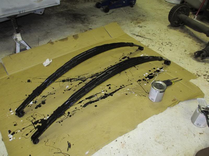

    Well I got some Kwik clips for the leaf springs and assembled everything, lubed it up, and got most of it in primer. Tomorrow I will flip it over and get the back side in primer, then into some paint. My radiator core support should be arriving tomorrow too! That should get me back on track to getting this whole frame finished.

    Well I have been busy lately working on the coupe and cleaning up the garage. I have the leaf springs in black paint, but need to flip them over to finish them up. I also received my core support from powhatan42 here off the HAMB. He had what I was looking for and got it to me pretty quickly. Thanks Glenn!
