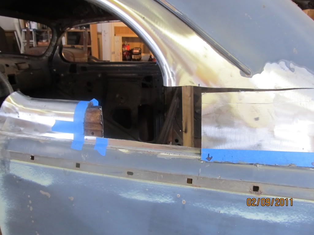

    I laid out some lines where I figured best to cut. I'm taking an inch and a half out of the front post, angling the C post and taking as little out of the leading edge of the C posts to make it all work. I figured the roof would end up moving forward less than an inch by my measurements and it ended up being about 3/4 and about 1/2" off the leading edge of the C nothing off the rear of it.
    here are a bunch of pictures, I tried to capture each step but missed a couple during the action and did the "oops shouldn't snapped that pic! oh well" some of them a a bit rough as I just grabbed my phone to keep things moving along, especially in the beginning.
    so here is the a post with the first piece missing.

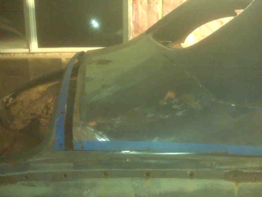

    then the "centre"section removed. b pillar and door posts. you can see the other side still in place, it's coming out next.
    here she is with both sides removed and resting on the stubs. You may have noticed that the front posts and front of the door are cut at different spots. I did this because I use the section cut out that matches best in width and shape to reassemble. this helps keep the flow going and less cutting and filling. It also is sitting about an inch lower than the final result will be here.

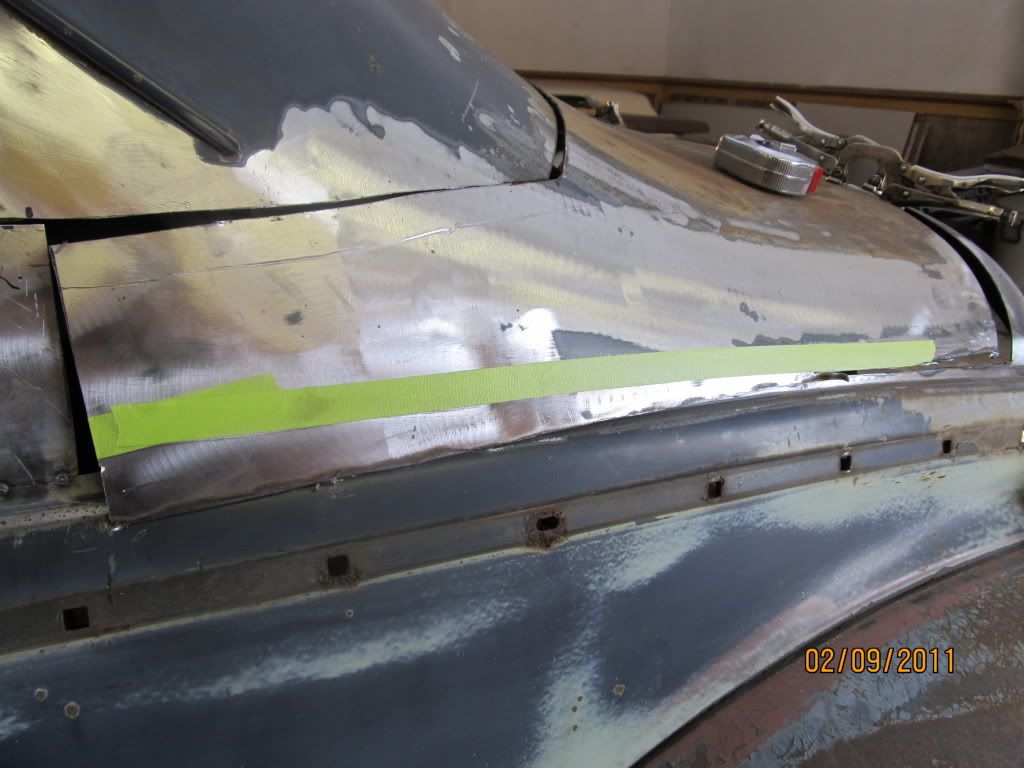

    Next I cut along the C pillar about a 1/2" above the body line on the flattest portion of the quarter then straight across the back just in front of the trunk lid also the flattest and strongest area and least likely to warp when I work her back together. Underneath I needed to cut a couple of package tray braces and also split the trunklid mounts that run underneath. They will need to be extended the same amount that the roof moved forward too. (that'll come later)
    here's a couple snapshots that explain it clearer than I probably just did.
    you may have also noticed that I scribed three "locating" lines on the rear. This is so I'm sure I maintain my center as I slide it forward. Note: this "missing" section isn't missing that's how much it moved forward as I lined up the front post again and then tacked them in place.

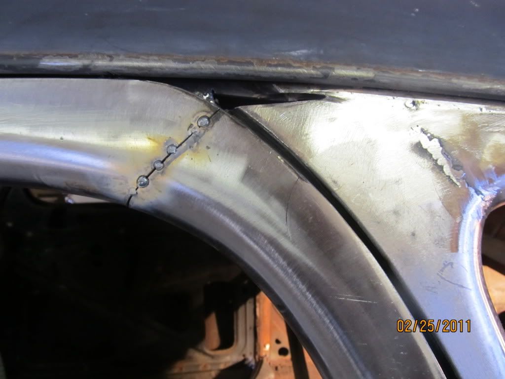

    A few filler strips to be added to the angle sections but that's boring so let's look at the B Pillar. I wanted to wok the post to match and flow so I didnt just want to shorten it (which would have been nice and easy). Here's what it looks like to start. Lots of adjustment need here!
    So I tacked the lower part in place after lining up the bottom of the window. then I cut the upper portion in relation to where I wanted the top of the window to stop and also line up with the flowing edge of the frame.
    This left me a nice section missing on the top, I had a piece removed earlier but it didn't fit right (close but not close enough) so I bent up this one on the brake and got it in place.
    so now I'm left with this misalignment. Time to cut and paste. Turns out they were right, everything I needed to know about life I did learn in kindergarden!

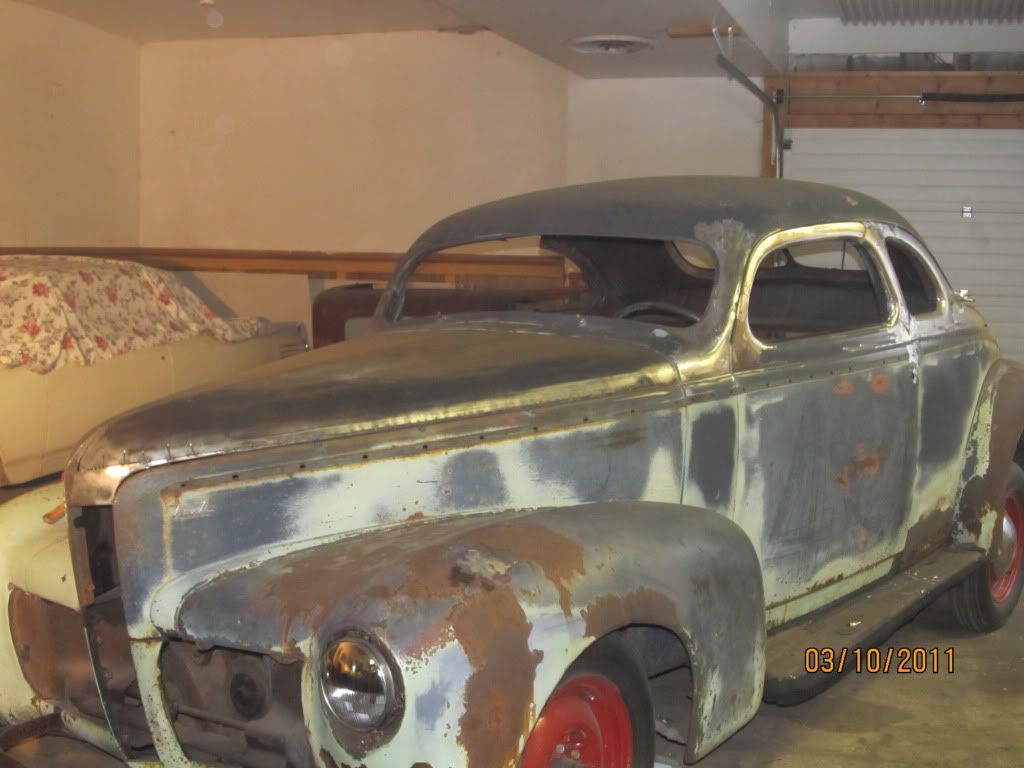

    Man, no doubt, my oldest is 15 in May and she's been reminding me weekly that she'll be driving soon.
    Hellvis, I'll be sure to find a profile pic for ya. Here's a before to hold you over though.

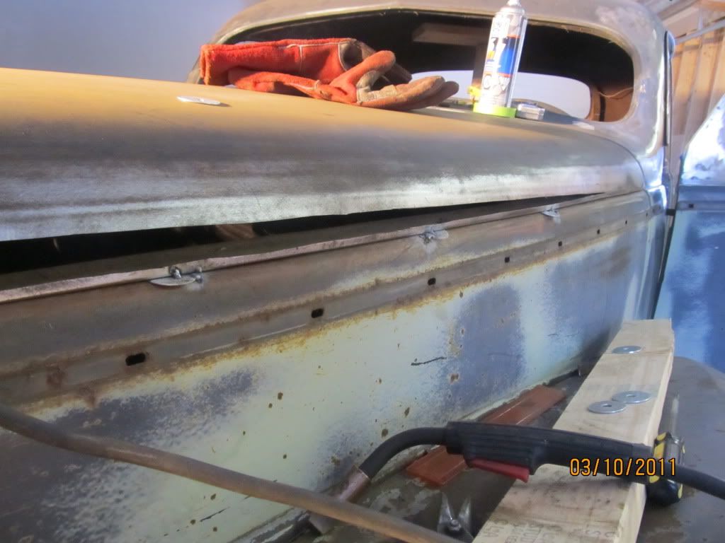

    Alright, so next I wanted to make sure my door frame would line up ok before I moved to filling in all those pesky gaps. So first I trimmed the front of the door frame I had previously removed, a bit at a time so I wouldn't remove too much. keeping all gaps and alignment in and out in mind.
    then where the back edge stopped I transposed that to the b post so I can start trimming the back of the frame to line up and install. You can also notice the top of the frame hangs over abit, I'll be dealing with that soon enough too
    trimmed the back of the door frame a bit at a time, sneeking up on it!
    then tacked it in place and ran a rough tape line on the new shape.
    somemore trimming and here we go. Getting closer each day. So this is where I am as of today. The gaps are real nice (even though in these pics they look a little uneven, they aren't). Next step is to work on where the back of the door frame meets the door and then a couple small filler pieces. I have the other side braced in place at the same height and I wanted to get this side done so I can make a pattern for both window openings to make sure they are perfectly matching on both sides after all the angles were dealt with. Should have another update on Thursday. Thanks for looking.

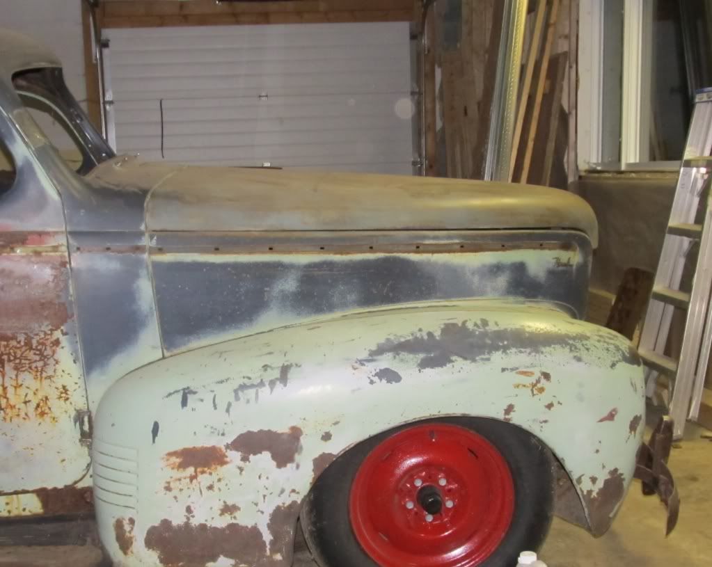

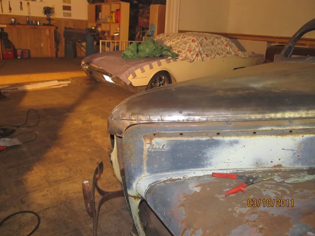

    So I was a bit bored today, I may have adult automotive ADD cause I didn't feel like working on the chop today but wanted to keep things moving along so I decided to shift gears a bit and fix something that bugs me about these cars. That hood that seems to walk around with it's nose in the air.
    Time to pancake the hood. Here's a shot of the nose in question.

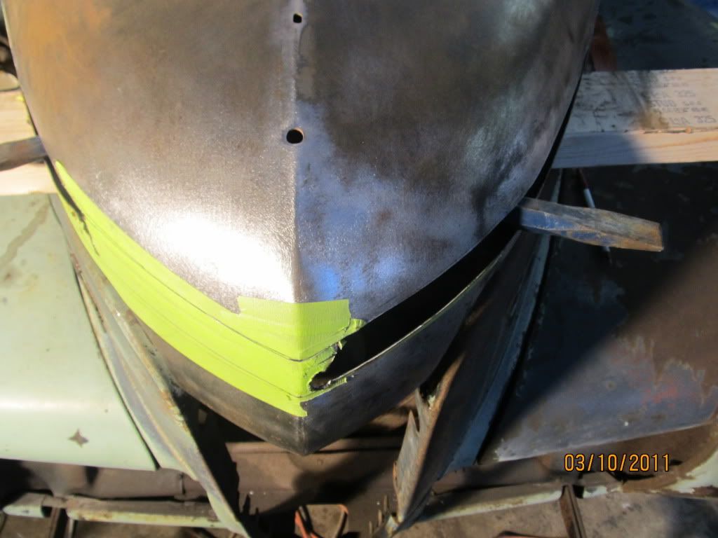

    So I started by stripping the paint off the areas I'm going to be working. Then ran a couple tape lines, the top of the tape was an important one because it marked a body line.
    I wanted to stay as close to the bottom edge and angle it back. So I marked the bottom line, 1/4" up from the bottom of the hood and ran it across the front trying to stay as close to the flattest portion possible.
    I then marked up 1" at the leading edge of the section to be removed then needed to calculate the increments of the cut line bacl. Basically I divided the height 1" by the length of the cut. This told me how much of a rise every inch the top cut line would be. I multiplied this by 8 then marked every eight inches up from my bottom line the progression then joined the lines with my flexible ruler. Sounds more complicated then it was but good lesson for the kids at our dinner table. Stay in school, you need math!
    Ok, so I drilled a starter hole at the front of the hood then cut back on the bottom line on one side. then I cut out the top portion. Moving to the other side I left a big section in place at the front to keep it from falling onto itself while making the long cuts.
    Then removed the remaining section at the front. I put in a couple of chisels in place to support it while doing this.

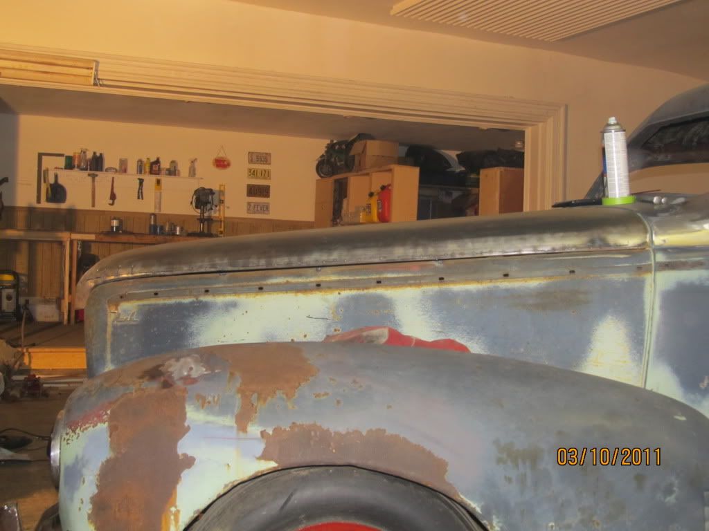

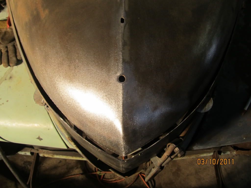

    Now at this point I need to get things buttoned back together but I was concerned that if any of the cut lines were uneven (even though they looked pretty good) that it would pull the bottom edge of the hood up creating an uneven gap so I tacked some spacers to the hood sides and the bottom portion of the hood to lock it in place, then brought the top of the hood down to meet. tack along the edge until you reach the "overbite".
    Obviously can'l live with that. So a few releif cuts will help, I sort of feel my way along to see what area's are under tension and make a mark to run a line. I cut along each side of the peak at the front nose to really loosen this part up so I could work it into place. A couple extra relief cuts were needed to get things moved into place.
    A bit of steady, EASY persuasion and everything comes together. Need to run some welds obviously but this is what she looks like all tacked together.
    And this is how she looks after todays work.
