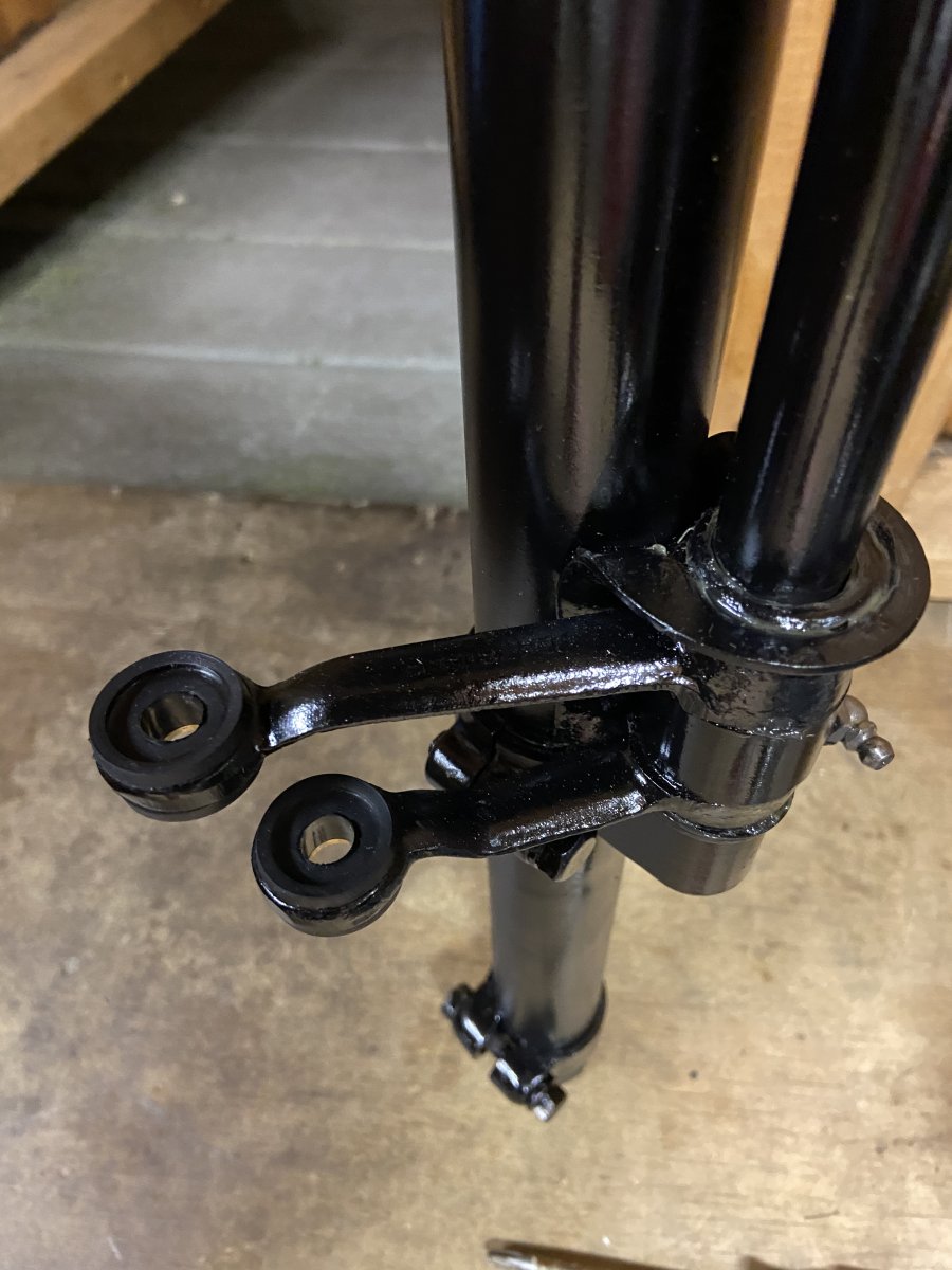

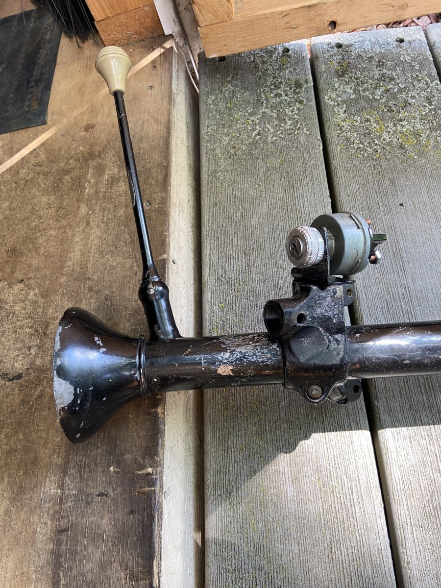

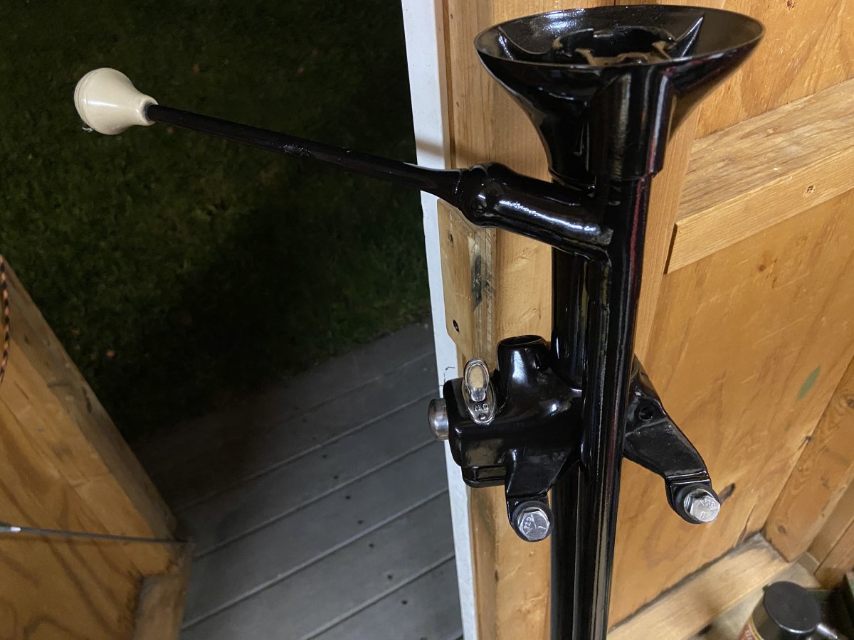

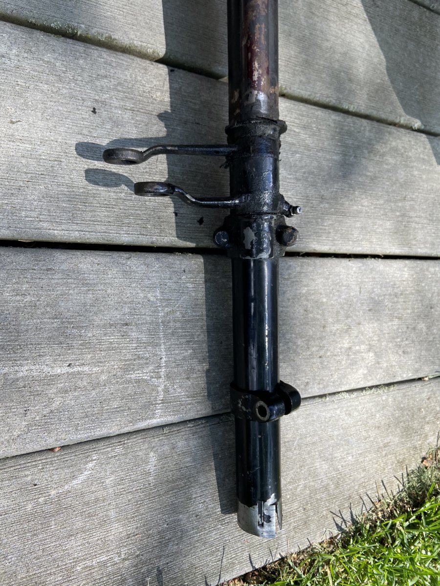

    Ok, I loosened two bolts that hold the column drop to the dash, loosened the clamp at the gearbox and slid off with a little jiggling.
    I took out the pinch bolt with an ez out, and amazingly it came out pretty easy. Took the whole column apart, cleaned it and gave it a new coat of paint. I’m waiting on a. New upper column bushing and a new ignition cylinder to come in and then I’ll put it all back together. Problem is, the new column assembly looks so good, now the dash looks like it needs a new coat of paint...lol.
    I ground out the cracks in the steering wheel and plan to pick up some PC-7 tomorrow.
    Does anyone know how difficult it is to remove the dash? I think it’s the only way to do a proper refinish job. Do I need to remove the front glass or are the bolts just hidden under the garnish molding?
    Thanks for everyone’s help...some before and after pics of where I’m at so far:

  5. I might have put some flattening agent in the paint on the column tube so it didn't shine so much. Maybe save from moving on to the dash.

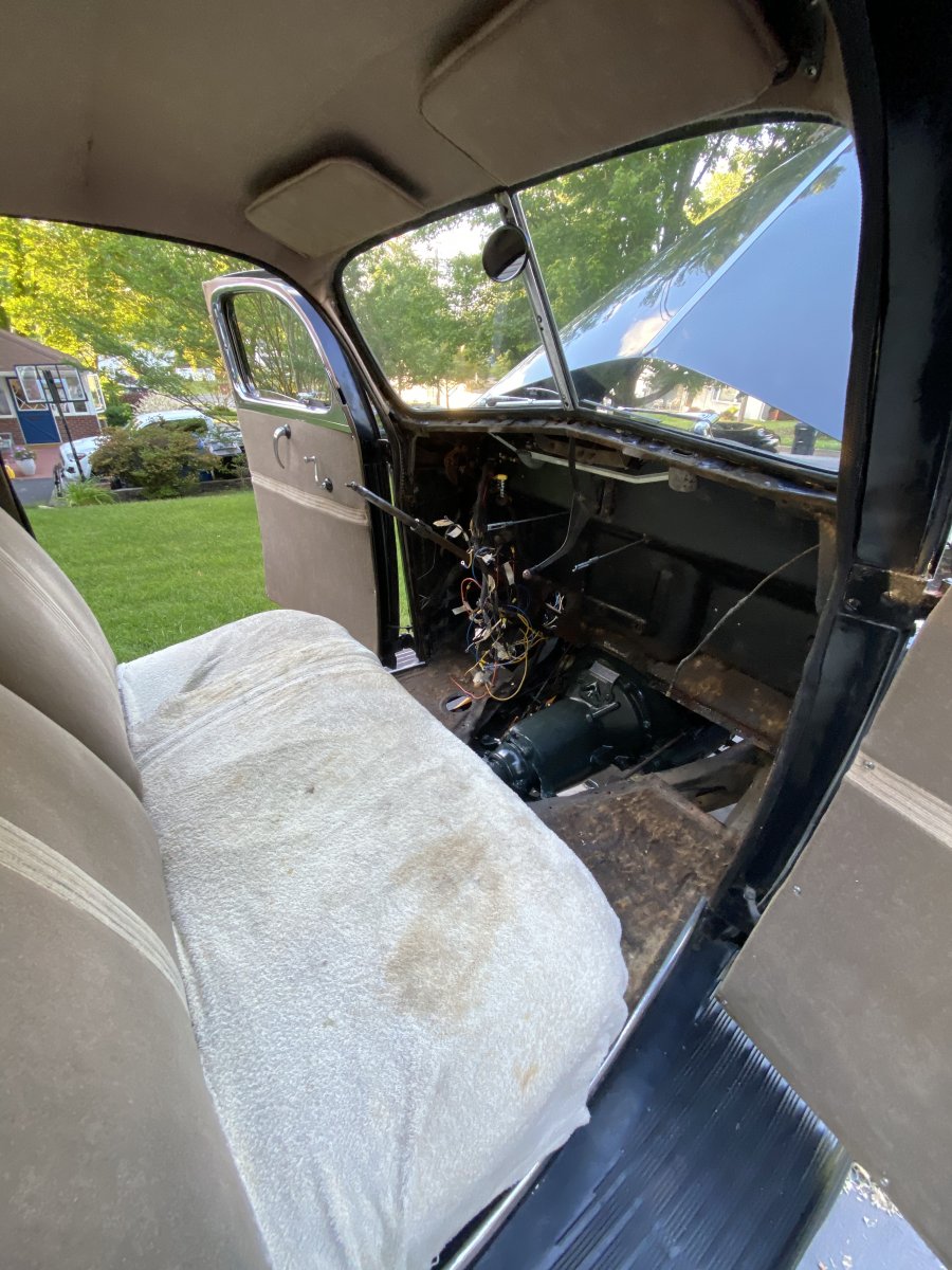

    Pistnbroke: disregard on the photo. I pulled the dash out today.
  8. Claws
    Joined: May 2, 2020
    Posts: 28
    Claws
    from New Jersey
    Also, wiring is a mess, half dry rotted original harness and half botched modern. I’ll be putting in a new dash harness, and probably a headlight and body harness as well.
