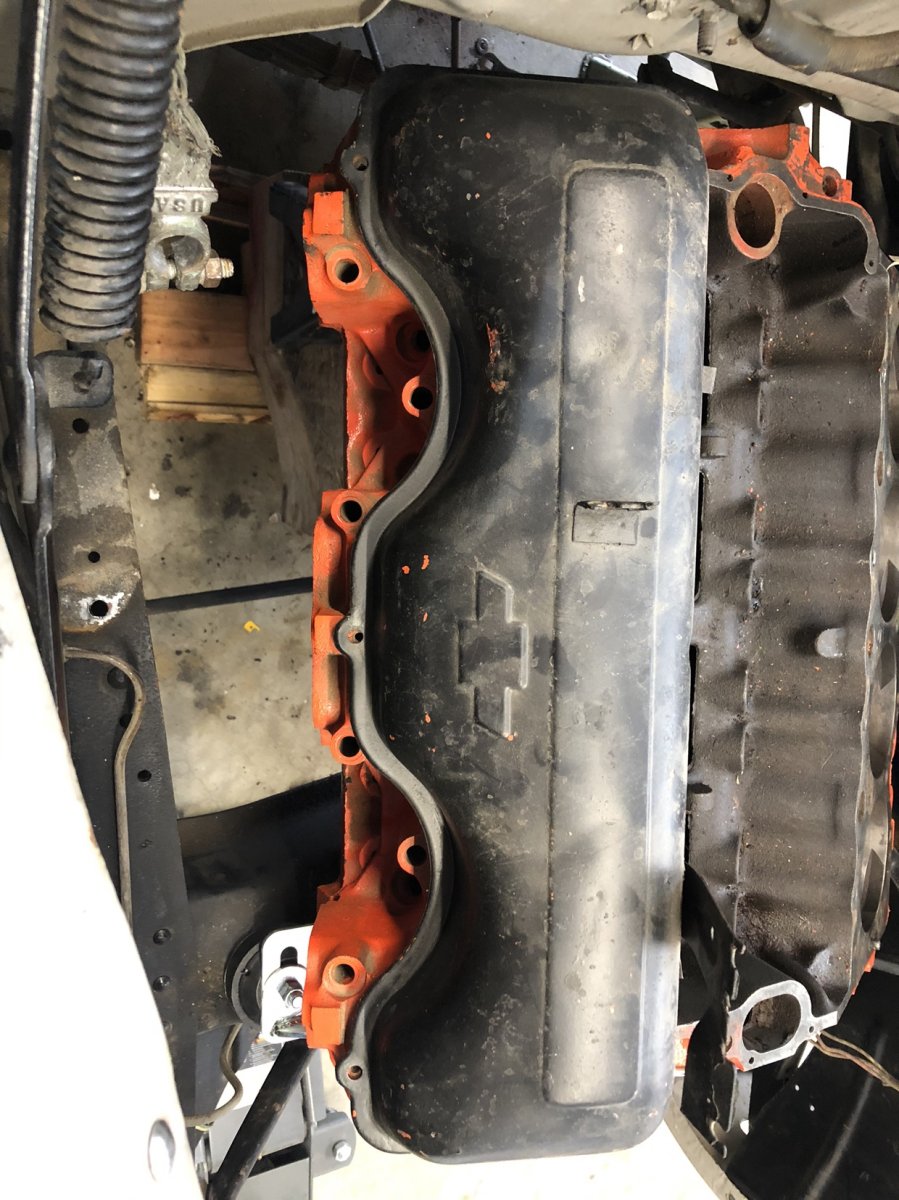

    Question: This will have all the weight on the front of the engine and rear at the trans mount.
    Anyone use a mid plate between the engine and trans to strengthen that? Any recommendations?

    Excellent! At the rate your going, this is gonna be a driver way before mine! After reading some stuff on here about front motor mount and rear tail mount, I had some mid mounts made by Marco when he was fitting it all for me.
