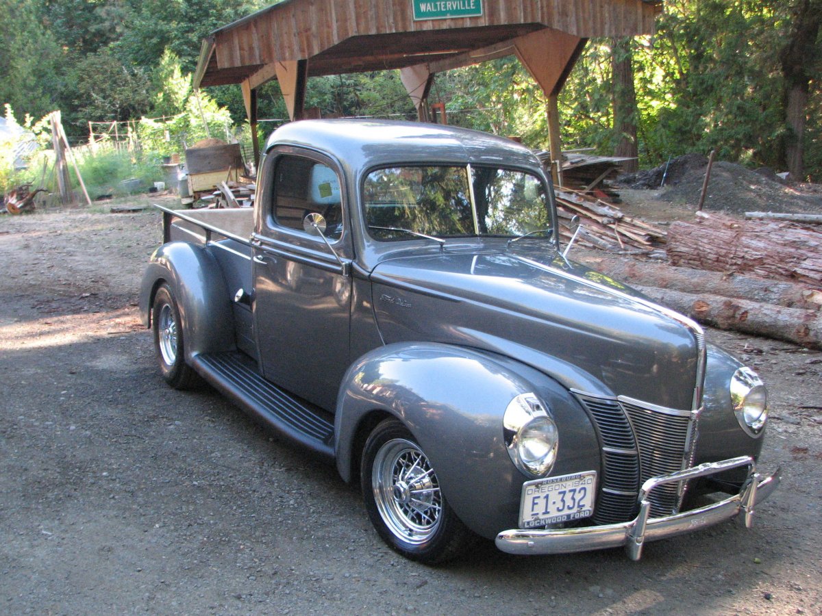

    1. 1940 Ford
    Lou would you elaborate some on your post? Is the truck cowl wider? :confused:
