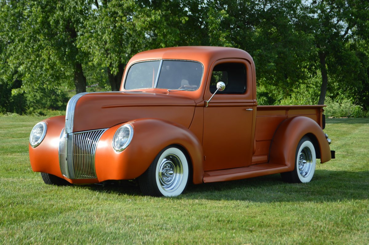

    All, I'm looking for suggestions and alternatives and what other people have done.
    I have a 1940 Ford Pickup. The build thread is around here somewhere....
    The front has a 4" stock width dropped width axle and Posies spring with reverse eye (about 2-2.5" more drop, for about 4-4.5" total). Wheels are 16x4" originals with 550X16 firestone wide white bias tires.
    The ride height is perfect. It's low, but has enough ground clearance to get in my driveway, on/off trailer, etc. Perfect rake with the rear. No problems.
    The problem is in steering. I don't have the stops and box fully adjusted, but I have almost no range of motion in the steering before interference with the fender on the front side of the tire. Back side does not get contacted before the front. Travel doesn't seem to be a problem nor does inner fender clearance. I know these tires are tall at about 27". I'm using a GM 525 steering box.
    Going to a narrower/shorter tire (450X16 which are 26" tall) gets me probably a .5" of additional clearance. I'm not sure that's enough.
    I could go to a 15" wheel and even shorter tire. A 550-15 is about 26" tall. That'd be about the same as a 450-16 though.
    Or, I could get a posie or other spring with a standard eyelet and pick up about 2" of ride height.
    I have to do some measuring to see just how much I need. I want to get as low as possible but have decent steering obviously.
    What are others running? How did you make it work? THANKS!

    Swapping axles is what it really needs I'd have to agree, not the easy of inexpensive fix but looking at several photos of other 40 trucks with the same wheels it looks like the wheels set in more. For some reason the whitewalls make those tires look cartoon big on that truck though. That may be because there is no center cap and that is a lot of red wheel showing.

    Yeah, not going through that hassle at this point! But probably true. Do you have to split the wishbone with the narrower axle? Also, CE doesn't make them anymore, right? Who does?
    If math works, you pick up an extra 3/4" or so of clearance that route. I'm thinking picking it up just a bit and going to a 450-16 might do the same thing while keeping it low overall.
    It will have caps and rings for the cartoon fans. Just haven't got that far!

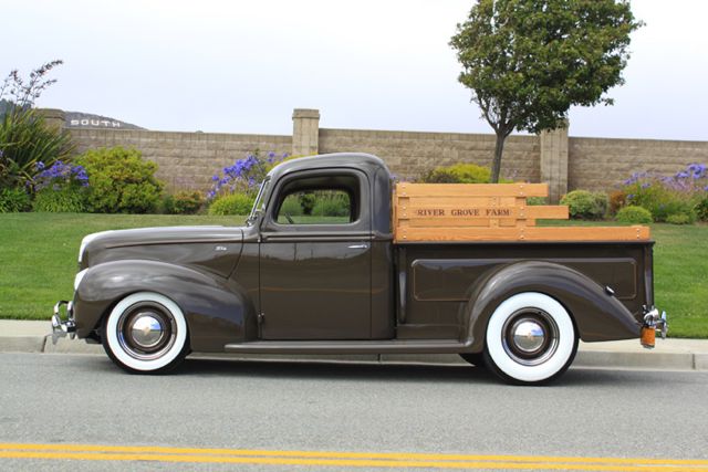

    from Maryland
    DSC_0453.JPG Not as low as you, but 15" out back and 14" up front. Nice stance no rubbing. Plus the whites are the same size.

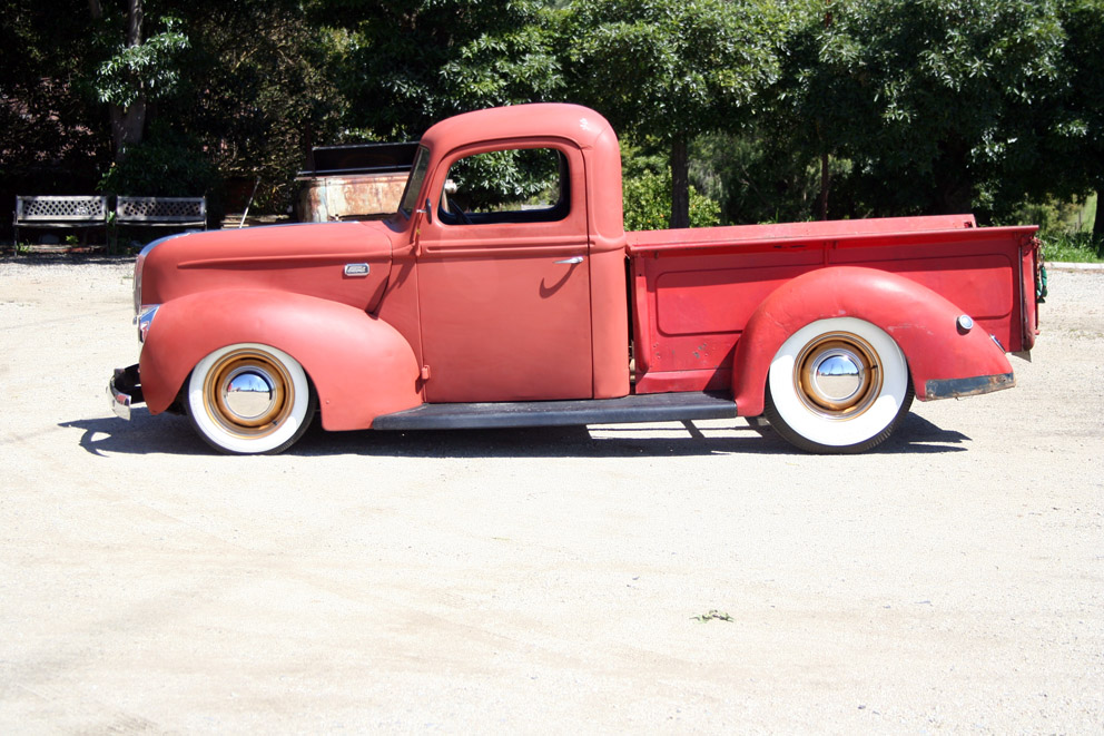

    Caps and rings will look completely different....
    Low....
    Lower...

    I see what you mean. I think it actually needs to come up for looks purposes itself. It seems to sit too low on the whites now that I compare to others.

    See, now that top one is about what I think it'll look like an inch or so up. And that looks really balanced, still low, and some rake. Thanks!

    Beautiful! Mine seems to sit lower on the tires, but yours looks like it sits lower overall to the ground. I know the matching whites is ideal for some, but I don't think it's necessary. Looks sweet on your truck though.
