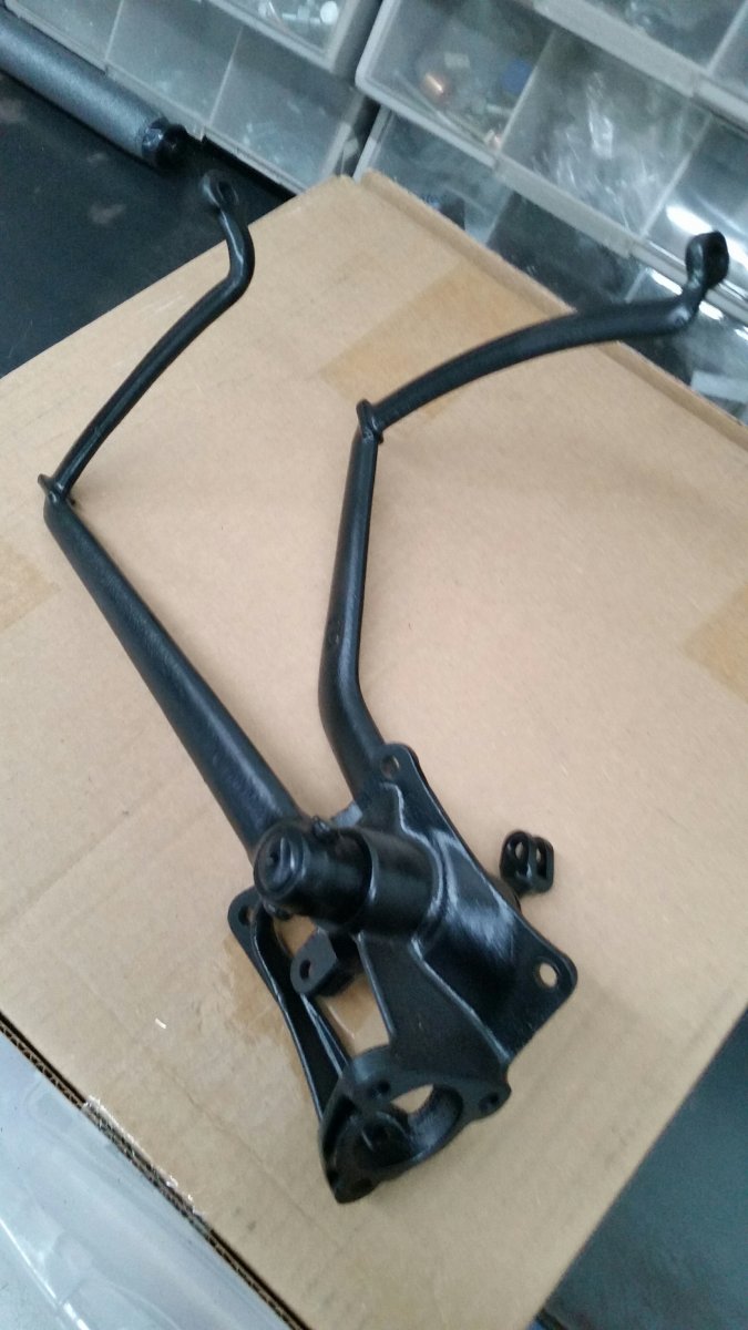

  6. It's going to be easier to modify off the truck where I'm going to be working on it. I might try to find some '40/'41 pedals and some '39 pedals and see where I'm at. The curves are different of each pedal and it comfortable where they're at now.
    1939 pedals:
