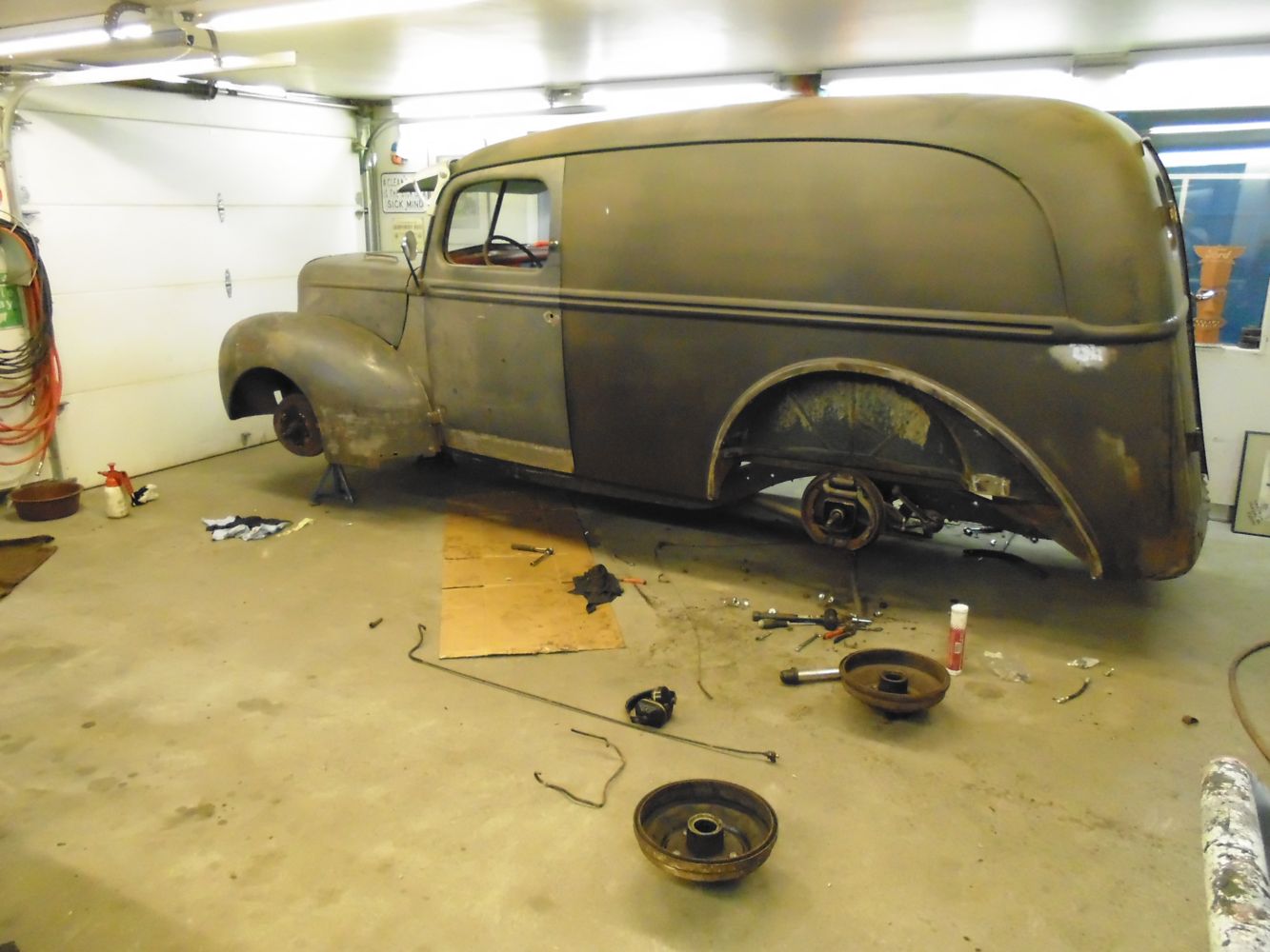

    Finally I have time to continue Panel Project.

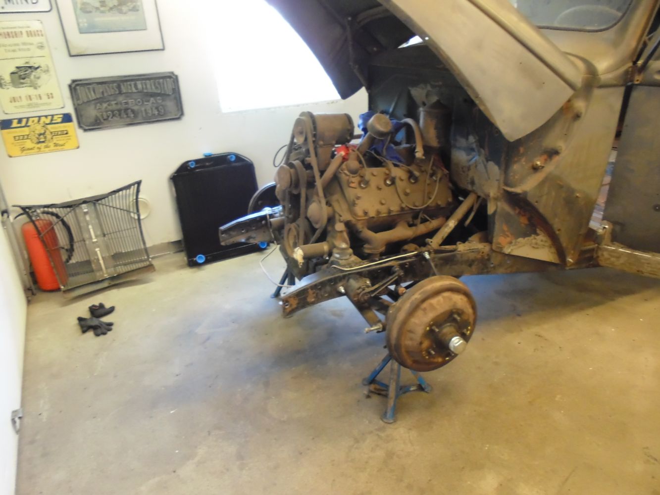

    I just changed some wheel bearings, all wheel seals, brake hoses and some of brakelines.
    Fuel tank is cleaned and bolted on. New Walker radiator fits good.
    Next need to pull out engine and tranny.
    volvobrynk likes this.

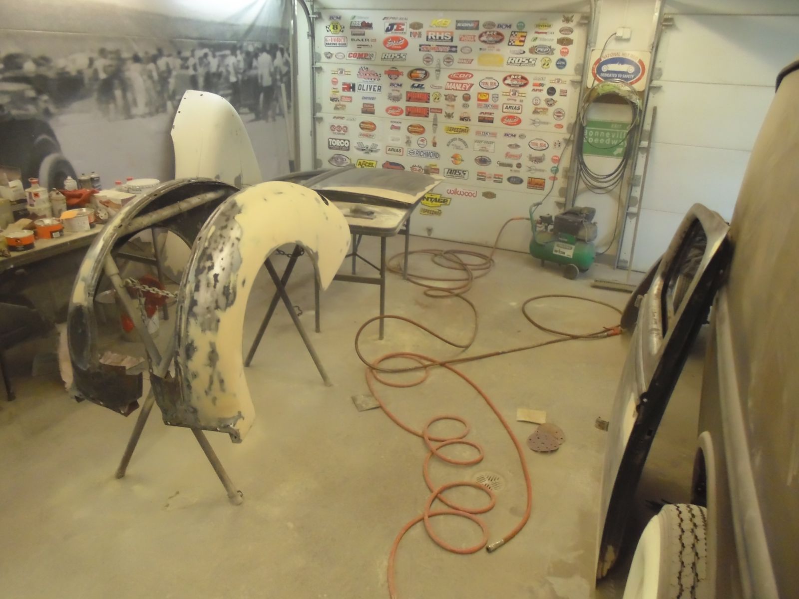

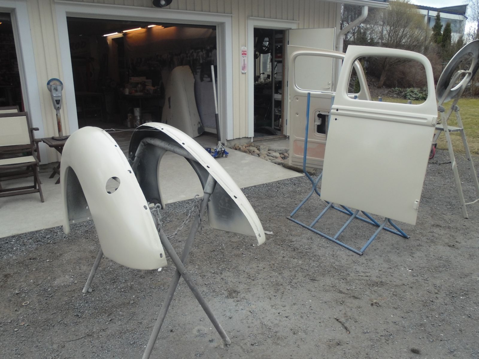

    Project continue. Next week I paint all Fenders, Front doors, Hood.
    I need to use my friends carpaint Company. He has very good paint room etc.
    500-1000usd all costs to paint car (materials,...) but need to do all myself,...
    Its so expensive now a days if Company is doing all (3000-7000usd).
    AULIS
