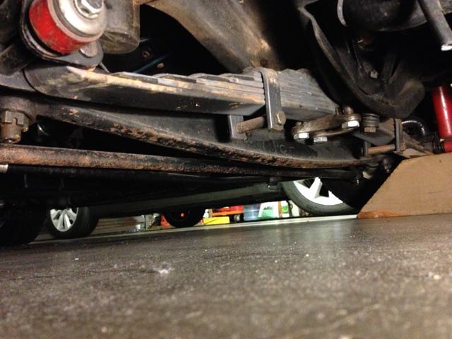

    The shackles are at 45 degrees. The shackles are triangles that include the shock mounts. I have never seen this before. I am wondering about this whole front end kit.

    Andy, Leaves are .240" and there are 9. Length from center to center at the shackle bolts is 35 3/4". This (Posie) spring replaced a similar spring (labelled FS - 3540 E?) with 7 leaves that measure .275". Both are way too stiff compared to my stock '40. It is hard to measure the stock '40 spring because the leaf on top of the main wraps over it. The end of that second leaf measures .185" (roughly). The '40 spring measures 41 1/2" in length. I'm very interested in what you think because I am hoping to improve the ride on this car without changing the axle.

    That mount looks like it is a TCI (also available from speedway) I have that in My 40 and had the CE with the tie rod ends pointing up. If the shocks and mounts are CE there is an instruction as to the location of the upper mount based on the amount of space between the frame rail and axle

    the wishbone mt is as geoford41 stated-the CE go straight up. as to wishbone to trans pan something is odd-I have used that setup on quite a few 40's and just cked mine-wishbone is at least 3/8 and maybe 1/2 from pan on pass side--do you have some sort of short rear trans mt ???? I have never used the lower shock mt that goes on the spring shackle but have seen a few--I think Pete and Jake sell them and I'm sure there are others as well.

    The spring with 9 .240 thick leaves should be about 225 #/in per side
    The one with 7 .275 leaves should be about 260#/in per side
    Stock is about 122 #/in per side

    Contacted Central Coast Springs in Santa Maria, CA. Here's the plan: They will make a new un-reversed main leaf which we will use with the other leaves from a stock spring recently removed from a '40 coupe. New main will be arched to match the other leaves. Will have to shorten a leaf or two on each side to fit the new main leaf. Book calls for 10 leaves on a stock '40, so we will start there. This and the removal of the current spacers should permit the use of the original castle nuts with cotter keys. I'll report the results.

    Stock '40 spring with shortened main and safety leaves has been installed. Ride is much improved. Maybe not yet as good as a stock '40, but I didn't expect it would be with narrow spring. The choppiness and bone-jarring jolts are gone and the car handles potholes and pavement changes on the freeway quite well. I might be able to fool around with air pressure and make it even better. I'm running 30 lbs stone cold in all four tires. Also, the increased arch in the '40 spring raised the car about 2" which is OK. Still has a nice stance and it will now clear parking lot barriers without denting the grille chin. I can also get my low-boy floor jack under the car without driving up on boards first. Finally, the original Ford castle nuts with cotter keys have been installed on the U-bolts. Thanks to all who responded for the guidance.
