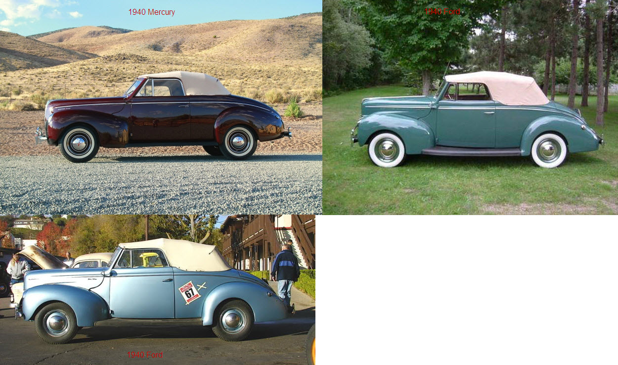

  1. As some of you know I have this 1940 Ford convertible I picked up at LARS last year, only thing is its missing almost all of the convertible top irons and structure.
    I've recently found a lead on a 40 Mercury convertible top close to where I live in Australia and I thought I'd ask the question:
    Is a 1940 Ford and a 1940 Mercury convertible top interchangeable?
    Comparing photos of the two look similar, the merc top doesn't seem as angular around the rear window and looks a little different across the top of the windscreen.
    Any advice?

    Just by looking at the pictures, I would say no. They have different shapes to them and the side windows are a bit different.

    I recently bought a 40 Merc convt parts car with LOTS of spare parts. And so I connected with my buddy who has a finished 40 Merc convt street rod. In the process of learning about my car, I was surprised to learn that the Merc is not the same size car at all. The wheel base is different, the body is both wider and longer too. Even the frames will not interchange, as I understand it.

    The frame on merc's are longer. To my knowledge, the body is the same from the fire wall back . On my 47 merc the only difference i see is that the fenders are longer all the rest looks like Ford :mad: but mine is a sedan,i wouldn't think old cheep Henry would waste the money on separate tooling for the bows:D great score good luck........jack

    Thanks for the info. I've never had a good look at a real life Mercury convertible.
    Damn, thought I might get lucky with the similarities between the two. If I could get hold of this Mercury top I don't think I could bring myself to cut it up and make it fit, I imagine that they are as hard to find as the Ford tops.
    Like you Lump, I didn't realise that they were that different]Thanks for the help.

    I'm afraid you will find that the '40 Ford convertible top is very different from the '40 merc. The green book will not list the top pieces, what you need is the body parts book that ford had for the '40 models--it contains all part numbers for both the '40 Ford and '40 merc cars, including the convertibles. These books are available in a reprint. Check with Mac's or Bob Drake for a copy.

    Having owned both a `40 Ford and `40 Merc coupe ... I know that just about all their dimensions are substantially different. I'm assuming the same is true for convertible bodies, and don't think convertible top bows/irons would be interchangeable without mucho modifications.
    Not saying it can't be made to work -- just expressing the strongly-held belief that you're not talking about a bolt-on swap.

    the tops are definitely different on the merc...longer...wider...the windshield is sloped more....the latches on the winshield header are the same,i believe,but that is about it

    The 39-40 Mercury cars have a longer wheelbase than the same year Fords. The extra length is in the center of the body.
    The 41-48 Mercury cars have a longer wheelbase than the same year Fords. The extra length is in the hood, front fenders forward of the firewall. The Bodies are the same as Fords.

    The reality is very few things interchange between the two cars …. Almost nothing with the body

    I joined the forum this week, so late with a response: My '40 Merc convertible coupe has a 4 inch longer wheel base and is six inches wider at the cowl compared to the '40 Ford. Therefore not interchangeable. Good luck.

    a 40 merc is about 8 inches wider in the middle than a 40 ford. However, they both used the same head light doors. That's it.
