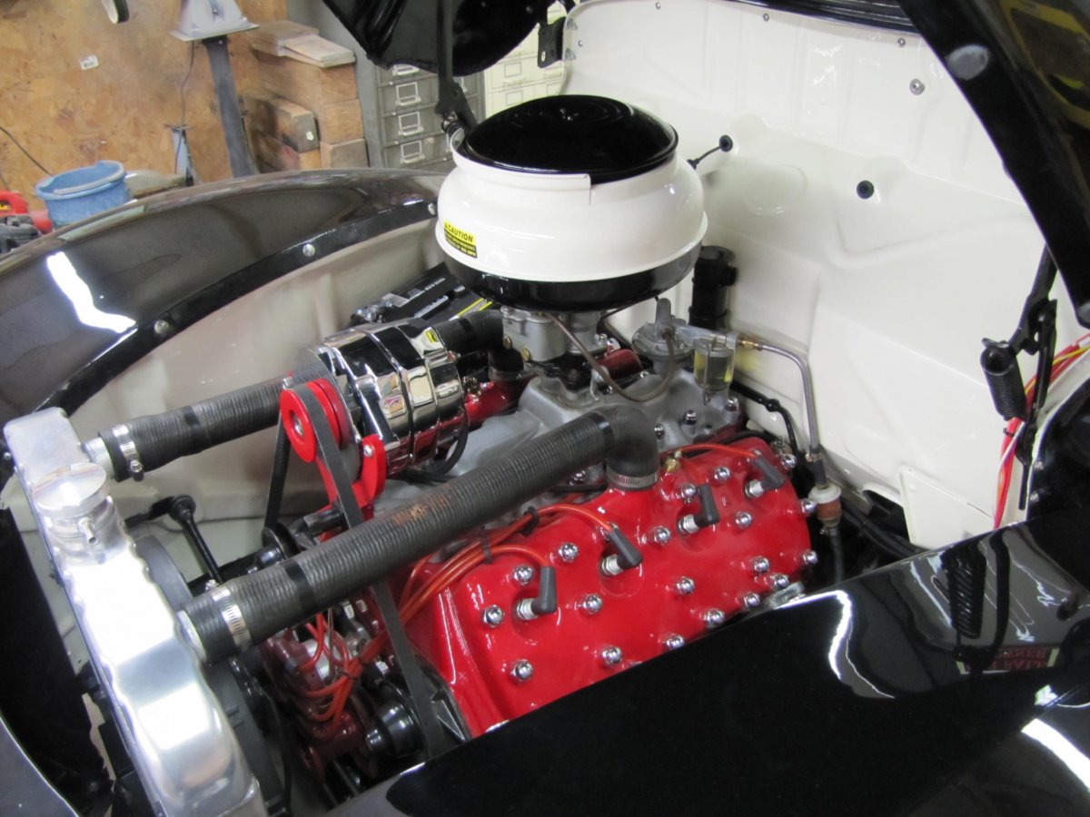

  9. My '40 pickup still has the original flathead in it. I redid everything including the motor 20 years ago and it is still running fine. I have the usual bolt on goodies which picked up the horsepower from 85 to about 125. That doesn't seem like much but it accelerates very well and has no trouble staying with traffic. I won't win any drag races but I don't drive like that any more.

    I love a 40 with a flathead but you ever see one with a ohv Caddy or Olds rocket? Bitchin.

    ^^^that's perty. Now I have to paint the inside of the inner fenders on my truck Wimbledon to match the firewall.
