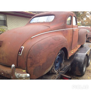

    F4CBDF11-875B-4411-A34E-32EB1E29A358.jpeg Technically I guess I have started this project so I figured I would go ahead and start a thread on it.
    This one is a 40 Desoto coupe that a found a few years ago. Mostly complete with a little tornado damage on the roof. Wish I would have found it before that happened. A tree blew over and made a glancing blow on the side of the car and wrinkled the roof and wiped out a hard to find piece of quarter trim.

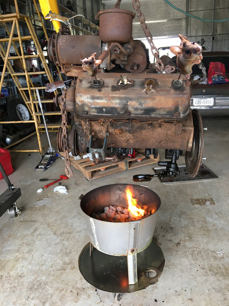

    Shortly after buying the car I spotted a 56 Desoto 330 hemi at a swap meet. Couldn’t pass that up so I bought it and have been collecting some missing parts for it. Just recently found a flywheel for it. I didn’t realize how hard those are to find. Up until putting the flywheel on I couldn’t get the motor to spin. So this weekend I put that on and started trying to get some movement. Still wouldn’t budge. It’s had MMO soaking in the cylinders for quite awhile. So my backup plan went into action. I did a thanksgiving hemi roast. As soon as the block started warming up it broke loose and spins fairly easily. MMO does amazing things on warm motors. Next step is to find a starter and a carb and get this thing to run. Stay tuned!

    I don't care who you are! That right there is funny! Hemi Roast indeed.

    What ever works.

    That will unfreeze it for sure. Lol. Cool project .

    Hilarious...and genius. I'm gonna remember that one.
    "MMO does amazing things for a WARM engine."
    Couldn't figure out what the f you were doing...lol.

    Brilliant!
    Rod nuts roasting on an open fire.
    Crankshaft dripping at the throws..
    Bet that smelled tasty.
