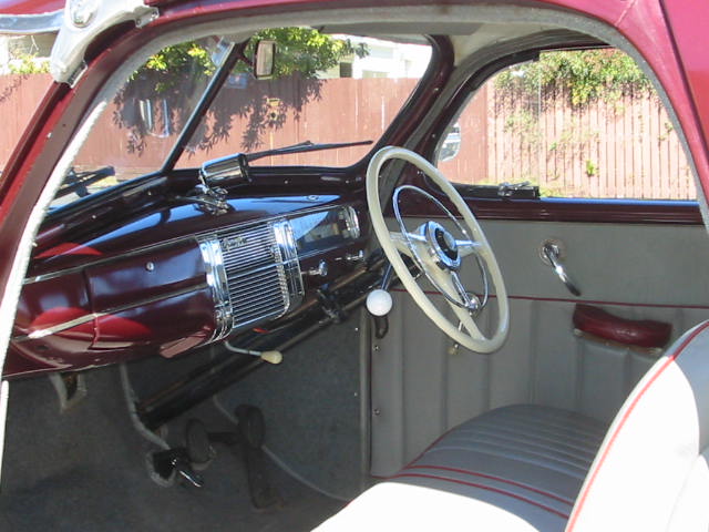

    This a 40 Plymouth with the same body style.

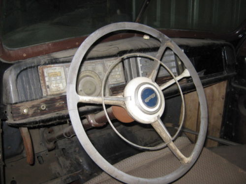

  12. My Oz RHD Dodge uses the same dash pieces and gauges as the LHD cars except where the RHD pieces would have to be different, ie, the areas in the dash moldings where the switches etc fit including for the original starter button that RHD cars had on the dash alsothe dash brace from the firewall was in a different spot which meant that the large box that the US radios came in would not fit resulting in a radio that had a separate box against the firewall with cables going to it and not a push button type of radio..........and yet the factory RHD, Sth African assembled 1941 Plymouth Coupe I had 2007 to 2013 had enough space to have a 602/802 radio (can't remember which) installed by me in the RHD dash as that dash brace from the firewall was in a different place to the Oz RHD Dodge....the Plymouth also had some pieces which would have been the same as the LHD parts such as the instrument cluster but again the various dash moldings would have been RHD specific.......the glove box lid on the Dodge was the same as the LHD whereas the Plymouth glove box lid was RHD specific..........andyd

    HI Andy, the trims I am missing are the ones on the cowl, I have the bonnet, door and rear 1/4 mouldings but just the short piece is the only bit missing.
    As for the dash the main thing I would like to integrate into the work done is the gauge cluster as per original, the rest I can work around. I had a lead on a dead 39 Chrysler Royal but someone had already raided the bits I wanted.

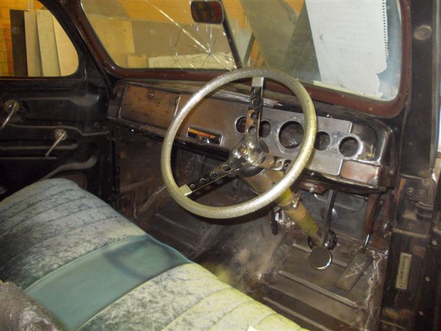

    My car was a LHD car that has had the conversion done at a Hot Rod shop here in Australia only a few years ago (prior to my purchase) sadly the original dash, cluster and wheel were thrown away in the process and an aftermarket billet surround was put in. The shape is basically the stock dash shape but all filled in aside from the glovebox and holes drilled for aftermarket gauges.
    The front suspension is front a HG Holden (Australian GM product built in 1970).

    I have been a little slack on this but finally made some time to work on the Chrysler in recent weeks. I got rid of the ugly orange LED indicators and found something I feel will fit in with the style of the build and only required a small modification to the recess already fabricated. There is still a fair bit of minor bodywork to be done and a few modifications like relocating the fuel filler and fabricate a new fuel tank which will hopefully happen soon. I rolled it out of the garage and popped on a set of hubcaps to get an idea on the look, I will get the final wheel and tyre combo sorted out and then adjust the suspension to suit. The rest of the primer has been removed and the body itself is in good condition which is a plus.
    I've managed to source a 41 Chrysler Instrument cluster in near perfect condition so I will modify the dash to suit and chase down a surround for it.

    If your car has an Ididit column, the original steering wheel wouldn't work anyway, the original column was hollow and had the horn wire running up through it. The top of the column where the steering wheel bolted on is entirely different then anything modern.
    Fortunately, there are several companies that make original style wheels that fit on the modern columns, but they are a bit pricey. Gene

    Did a mockup today with the 41 cluster, I will make a new panel for the finished product, decided to use the one there as a rough template. Will source or make a surround to neaten it all up too.
