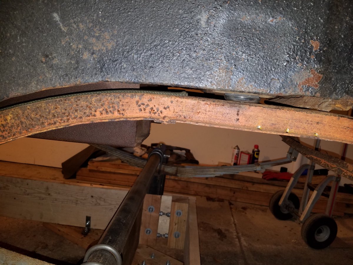

    I've been a little light on progress lately. I finally got the new body to frame webbing and this material looks to be dimensionally identical to the originally installed stuff. While it doesn't look or feel like tar paper, I'm okay with that. This webbing came from Mac's and they unfortunately don't specify any of the material properties, it looks like it should hold up. Hopefully it doesn't retain moisture. I also have a variety of rubber mounts and cupped washers. So, with a little bit of hardware purchasing, hole drilling, and some lifting, I can finally begin mounting my body to the frame.

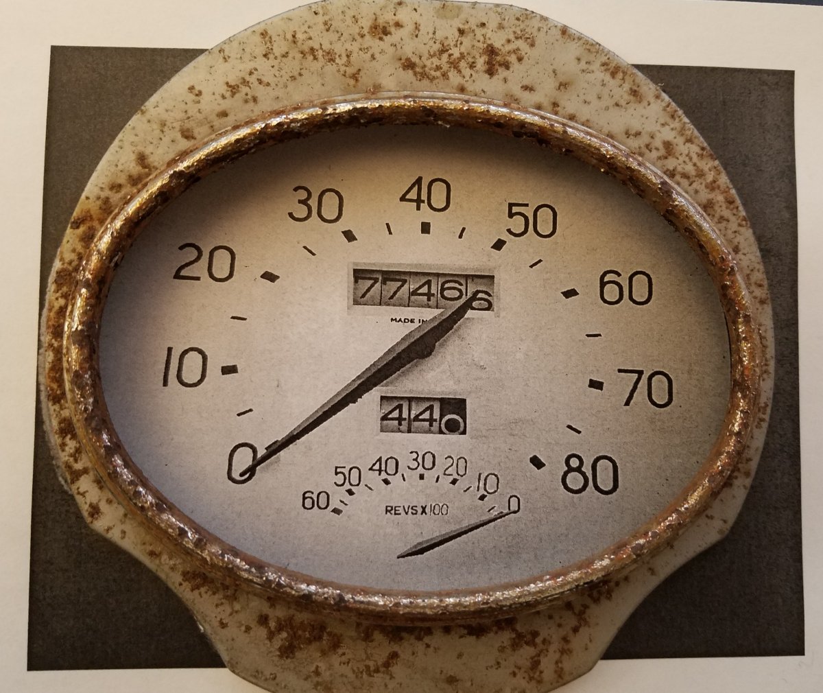

    In other news, I've been working on getting my gauges together for the car. While I had shown you some photos of a speedometer with a trip odometer and a gauge cluster with four gauges, I have put those projects on the back burner. In the mean time, I have built a really nice set of 1940 style gauges. In the future, I may consider begin taking the steps to restore/build new gauges for this car, but there are a few other places where my energy will be better spent at the moment.
    Here is a teaser of the speedometer. More photos to come!

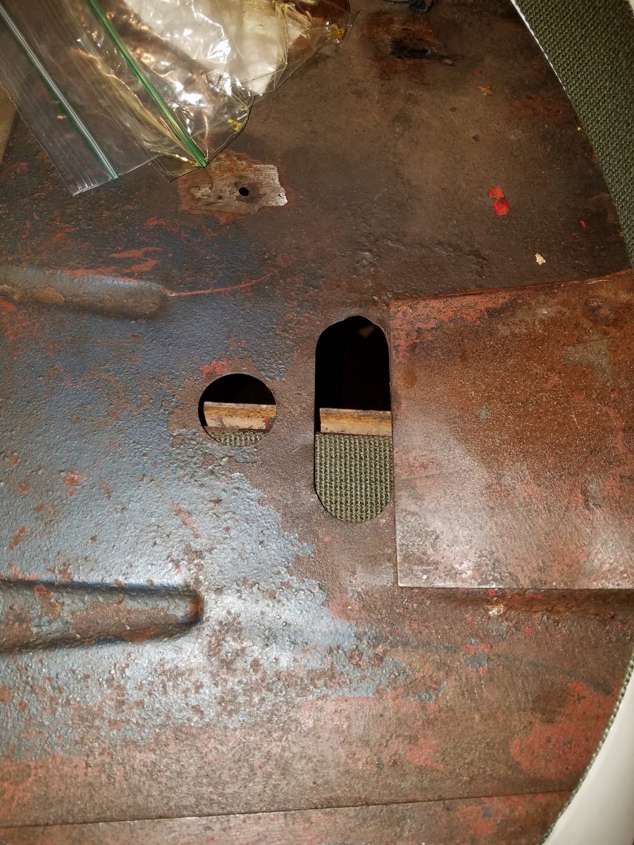

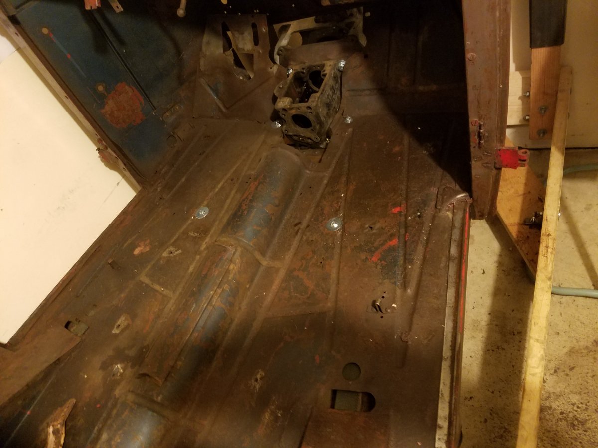

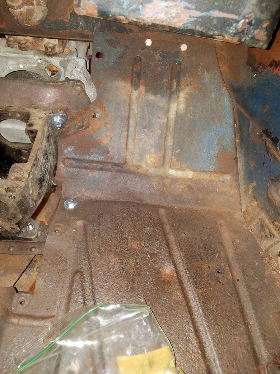

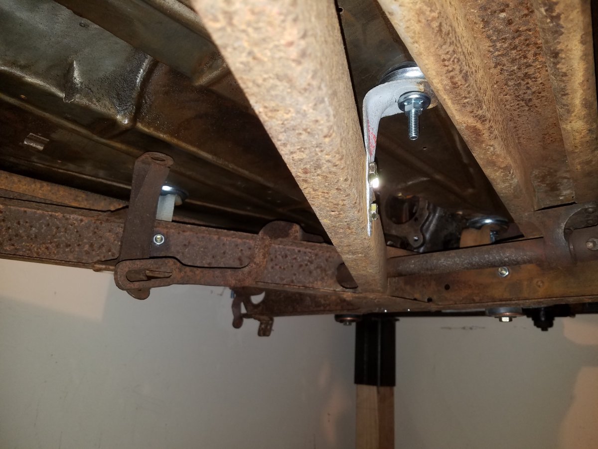

    On a more exciting note, at least to me, I have finalized the body mounts and have the body mostly bolted down to the chassis. If you go to page 6 of this thread, you can see photos of original mounts on a very original 1940 coupe and a weathered 1940 frame. It seems that quite a few restored cars have not been treated to the proper mounts, so finding the resources to assemble all of the mounts was a bit of a chore. If I recall correctly, I documented most of my hunt for mount parts a while ago. So, as you know it took a while to find all of the pieces to appropriately mimic the originals, and then to confirm that no more accurate pieces were available. The body is now mostly bolted down and onto the frame with the exception of the two central floor mounts and the driver's side rocker mount. To get those three in place, I will need to drill some holes in the current floors and temporarily repair the rotted rocker.
    Overall, I'm very happy with the way these mounts have come out, but one thing strikes me as odd. The Authenticity Manual states that there are two pieces of tar paper between the frame rails and floor pan. I have a sample of the original material used on a 1938 Bantam, and it was a soft pliable sort of tar/asphalt impregnated cloth/paper. Looking closely at it, you could tell it had spent the last 70 years pinched between a body and a frame. While I am fairly certain that the description in the manual means that there were two pieces of this insulation, with one on each rail, I'm not too sure how it is supposed to work on a car with 1940 style mounts. 'What is the problem?' you may be thinking. The problem is that after buying a nice webbing material which is identical to the dimension of the sample I had, it doesn't come in contact with the floors.
    It appears that my body has about a quarter of an inch between the frame and the floors. The factory added two additional central floor mounts in 1940 which may have been added with knowledge that the body wasn't actually sitting directly on the frame. Below, there is a pair of photos of the underside of an originalish 1940 Hollywood where you can see the cupped washers and bushing under the rear wooden support panel. I've also included a photo of the underside of an original American Austin for comparison. While I'm fairly confident that I'm heading in the right direction, I want to be certain. This also makes me wonder if 1940 models had a different front sheet metal support bracket with holes mounted about 1/4" higher to ensure alignment with the rest of the raised body.

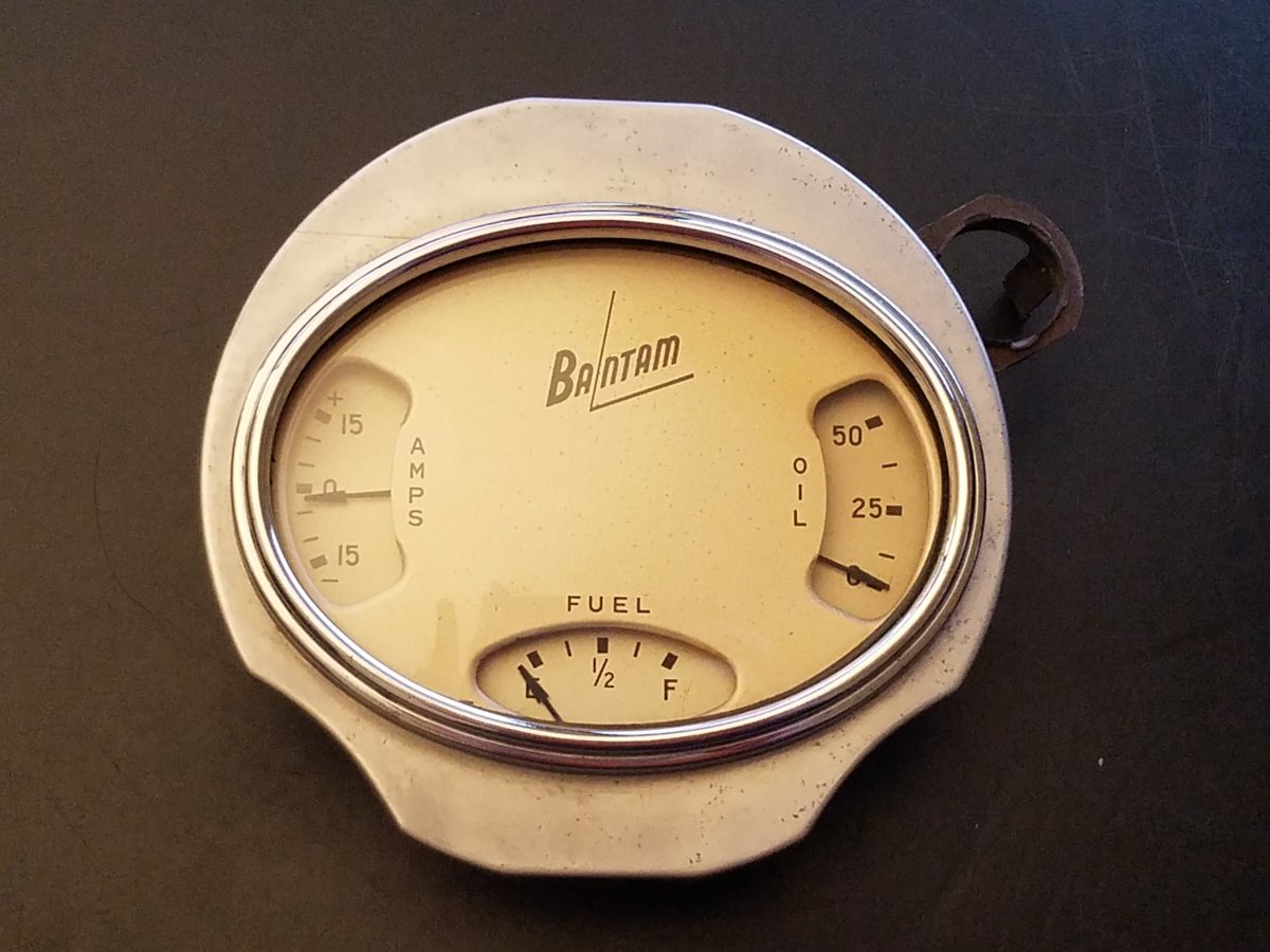

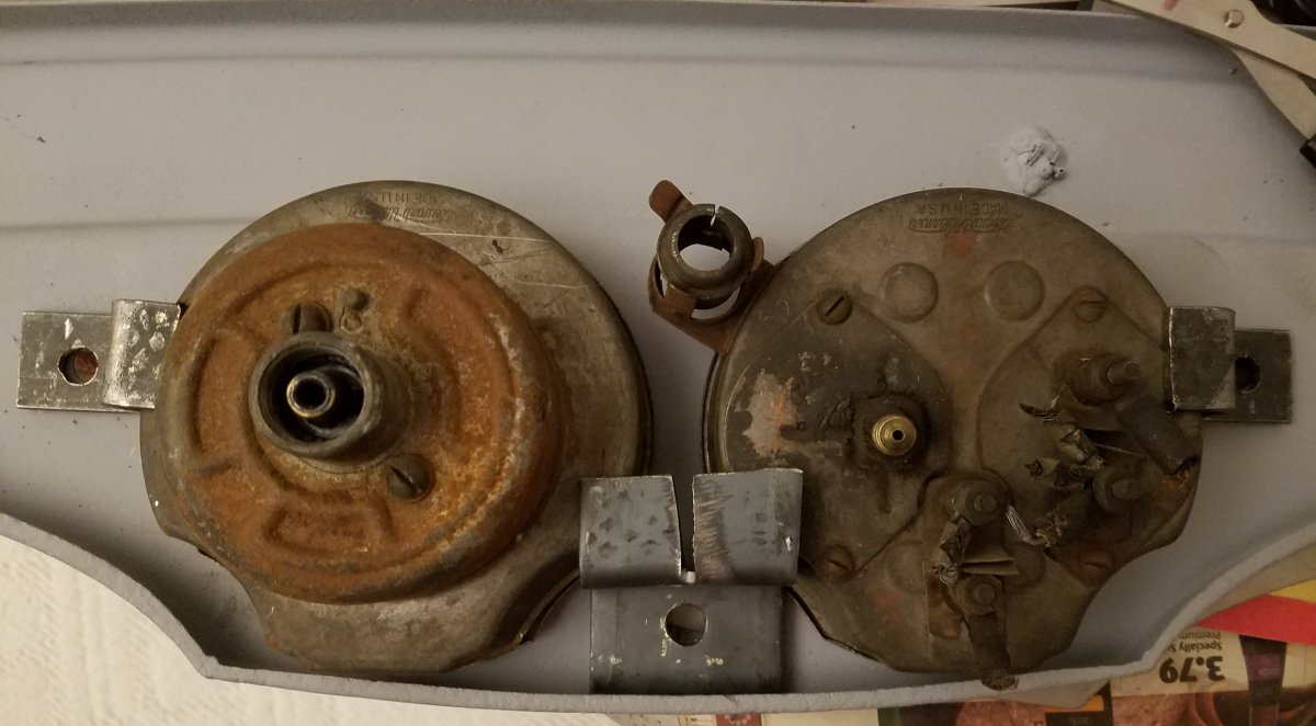

    Here are a few photos of my gauges. I built the best I could from the parts gauges I have been buying. Interestingly, I tried to find the best companion face for the triple gauge by matching the few I had with my speedometer. Later this week, I will hopefully redo the speedometer with the face that will perfectly match the triple gauge as I mentioned in the above post.

    Here we go! I cracked open the triple gauge's long time friend and after cleaning the face, realized it was noticeably scratched. So, slightly mismatched cream colored faces are perfect for me. Here is the pair which will likely be going into the Sportsman.
    I began roughing out gauge clamps to make sure these gauges won't fall out when I hit a bump. Judging from photos of a nicely restored 38 pickup, a single wide clamp supported by the ignition switch should retain both gauges. The photo appeared to show a small slit in the center which would allow for each gauge to be supported somewhat independently. I need to fiddle with the center piece and clean it up, but it's nice having two years of thought actually become something tangible.

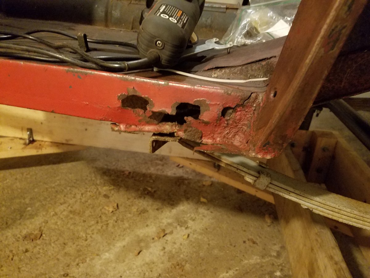

    Speaking of tangible things, I finally took a cut off wheel to the body. On the driver's side, one of the body mounts was rotted off and the area appeared to have been cobbled together at some point. Cutting off as little as possible, I removed anything that would interfere with the angle iron which I am planning to use to ensure that the car is properly supported at each body mount.
    I am planning to drill a series of holes in the angle iron and clean the rocker to bare metal so I can plug weld the pieces together. I have never fired up the welder I have here, so to say I'm apprehensive would be an understatement. Thankfully these welds don't need to look good, they just need to be strong.

    As you can see, a few posts up, I put together a nice set of original 1940 gauges. They are correct for a 1940 from the pearlescent silver faces to the convex lenses. Don't get me wrong, I am very happy with those gauges and think they will look great in the a; however I have been thinking about doing something special for the gauges in this car. Actually, I have been giving this thought since before I considered including a supercharger and overdrive into this car. For more info on my earlier thoughts, see post #85.
    As I have probably mentioned, Bantam seems to have offered at least two varieties of quad cluster gauges in Bantam civilian show cars, with one style going on to be used in the BRC's. These instrument clusters included a temperature gauge and a slightly different arrangement of the smaller gauges. Besides the difficulty of swapping a Hupmobile's temperature gauge and oil pressure gauge from left to right, this is a fairly simple gauge to build as it is basically a copy of an original.
    Earlier, I had been considering using a 1935 Hupmobile speedometer mechanism which includes a trip odometer, yet I was trying to figure out where on the dash I would want to include a tachometer if I went that route. I have gone back and forth on whether a tach would even be necessary or appropriate in the car, but I think I have made my decision after a fellow hamber said the other day, a hot rod should have a tachometer.
    I have generally considered one of two options. The first being an auxiliary tach mounted on the dash to either the left or right of the main gauges which would need possibly need to be balanced out with a clock on the opposite side. The second being a speedometer with a printed face with additional information correlating the anticipated engine RPM's with the vehicle speed, similar to a Smiths Chronometric speedometer (photo below). While the Smiths gauge looks great, in my opinion, there is just too much going on to make the face graphics look simple or elegant.
    After looking for something else, I came across a third option, the inclusion of a tachometer in the same housing as the speedometer (photo below). I really don't want to have too many gauges on my dashboard as it would make the small dash look even smaller and may give the car a more cluttered feeling, so this may be the best option. Although I would like a clock in the car, I have been planning on using a Phinney Walker rear view mirror clock, just to keep it off of the dash.
    I took a few minutes this morning to generate a draft speedometer face including both a tachometer and a trip odometer. The face is a bit more cluttered, but I think I like it. If you're wondering why I have the tachometer sweeping from right to left, it is to prevent any possible interference. While I don't want the large needle to ever go beyond 80, I'd hate for something to malfunction and cause the two needles to meet.
    What do you think? Is the simpler face better? Is the tachometer unnecessary?
    If I go down this avenue, my plan will be to use a mechanical tachometer, likely driven from the crank as some flathead Ford units were, so long as I have adequate room. If not, I may see what other rotating parts I may be able to drive it from. (See: https://www.jalopyjournal.com/forum...athead-ford-v8-and-nos-sw-1940s-tach.1023481/ https://www.jalopyjournal.com/forum...ng-up-a-mechanical-tach-on-a-flathead.707169/). However, that is something to think about later.

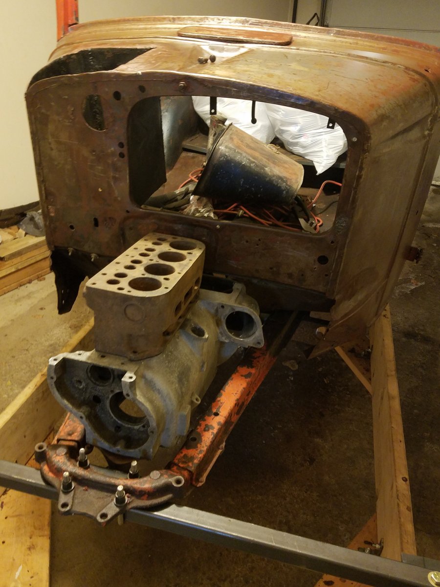

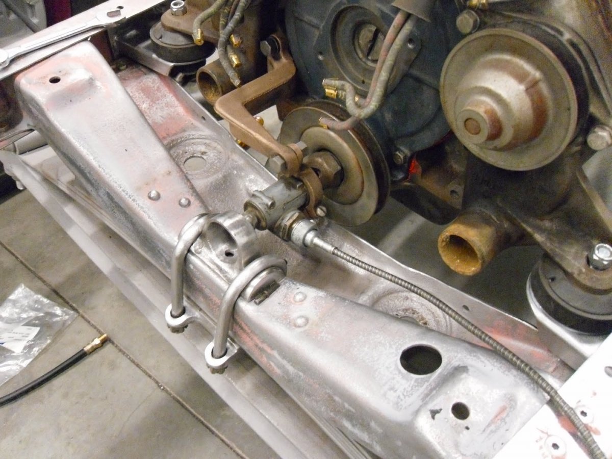

    If you look at earlier photos in this thread where the engine is mounted to the chassis and is surrounded by sheet metal and a radiator, you'll notice that the firewall is actually only attached to about 6 inches of metal. That assembly was removed from a Bantam coupe which was getting hot rodded in 2016. After talking with the Judson expert, I realized that I never actually mounted a three main bearing engine properly to the chassis with the full body installed.

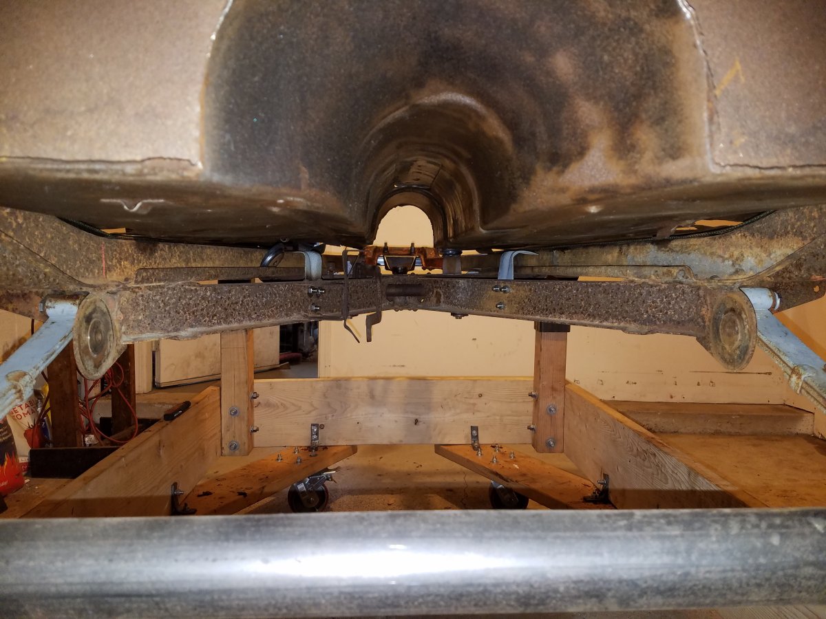

    You may be wondering why it may be so important to test fit the engine with the actual body attached. The primary answer goes back to something I had mentioned earlier regarding 1940 Bantam firewalls. Unlike all other cars, they were recessed about 3/4" to 1" in comparison with all other Austins and Bantams. I have heard about people installing their engines after finishing a beautiful paint job to find there is a bit of interference between the block and firewall. If you were curious, the answer is that there is definitely an interference problem. The firewall actually rests against the block and the gas tank would rub against the head. In the photos below, the block is actually a late 1939 two main unit which has a shorter deck height than a three main block. While I don't remember the difference in height, I am sure that the 1940 unit wouldn't fit more comfortably.
    I had initially assumed that these issues were caused by the engine being mounted back farther on the frame, closer to the cowl. Having a few crank cases on a shelf let me compare a two main with this engine. Although I didn't take any photos (I could have used an extra set of hands) I noticed that the earlier two main engines actually mount about 1/2" further back. After scratching my head for a few minutes, I realized that I had to bend a bit of the driver's side floor in order to mount the engine as it was hitting the transmission.
    Peering under the car, it finally came to me. The transmission is mounted a good deal higher in 3 MB equipped cars compared with 2 MB units. If you look in the 5th to last photo, you can see me holding a two main bearing radius rod support / transmission mount in place. That mount would have accommodated rubber discs between the mount and the transmission flange, but that is all. The three main set up seems as though it elevates the engine by at least 1/2" in the rear and possibly a bit more in the front. I will need to get some better photos of the white Hollywood to see what I may need to do.
    Test fitting the engine will serve a few purposes:
    1) I can determine whether I really will need to modify the cowl by shortening it to recess the firewall.
    2) I can fit the metal forming the engine compartment so I can see how feasible it will be to install the Judson and can determine the best place to do so.
    3) I can determine how a mechanical tach take off can be attached to the front end of the engine. I may need to consider driving it from the rear of the generator, however the later Brennan which will get the blower will likely be driving the water pump from the rear of the generator. I'm considering mounting it at the crank or the front of the cam.
    One last thought, which came to me, is that some of the interference between the block and firewall may be owed in part to the flexing of the cowl forward. While I can't align the cowl relative to the engine, it may give me something to watch while I am straightening the body.
    Loose Ctrl likes this.

    This is looking good, I think just some dimpling of the firewall to fit the head would be needed.
    Why do you want a mechanical tach vs electric one? And how do you get the dial to sweep backwards like you have shown?
    Would the guts from a tractor tach work?
    rg171352 likes this.

    I thought a mechanical tach may be more period correct and a bit more interesting to build. For the reverse sweep, it seems that some marine tachs are oriented that way. I picked up a Stewart Warner piece which was built for Detroit Diesels, which I'm hoping to use in making the above cluster a reality.
    A tractor tach could work, I'm honestly very open, so long as it can be converted. I'll get some photos of the Detroit unit on here so you can see what I'm thinking about modifying.

    Make sure the tach drive doesn’t interfere with other things at front of motor - fan, hoses, frame, etc. Electric drive seems easier but yes Mech is more period-correct.

    I finally got up the nerve to try my 110v welder. With the one rotted rocker, I couldn't completely mount the body onto the frame. The weld job isn't the best, but by some miracle everything seems to be held together well. While I'll add some better words in a future edit, I wanted to share some photos of the body completely mounted and the rocker temporarily patched.

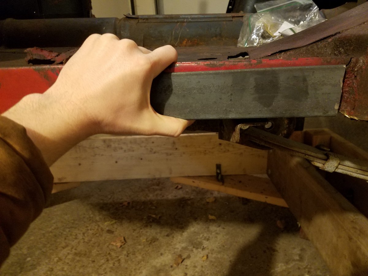

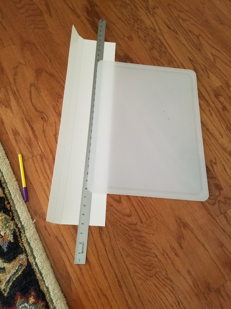

    I have some heavy paper, thin plywood, a sample piece of 2"x1"x.125" rectangular tubing. I was going to go for the 3/8" wall tubing, but the original thickness of the rockers with reinforcing cast steel was .25". I should be good with this cross-sectional size and it will allow for larger cast iron inserts for the A and B pillar reinforcements. Photos to come.
  21. Peanut 1959
    Joined: Oct 11, 2008
    Posts: 2,105
    Peanut 1959
    Why not just fabricate new structure from a combination of square and rectangular tubing? It is a common practice when rodding wood-framed early cars. I can't imagine that casting new pieces would be cheaper or easier. But, if the shape is too complex, can you post a couple of pics to remind us what it looks like?

    I had brought the piece to a local steel works which is usually very helpful. I figured that if anyone could do it, it would be them. Unfortunately, they said that casting would be the best avenue. Interestingly, it's the same method Bantam used.

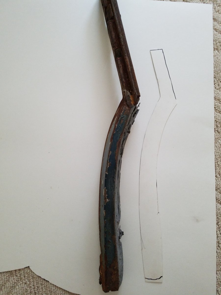

    I took my 1940 Hollywood out for a drive last weekend. Actually, one of my first longer drives in it since getting it. The tires are a bit square, so there it constantly seems as though I'm driving on a rough road. On the driver side, there is relatively no motion between the B pillar and door. On the passenger side, the gap deformed with every judder of the car and the door popped open a few times. While an adjustment of the door latch catch should help, the movement of the B pillar is what I really want to avoid in the finished sportsman. Somehow, I need to keep the door frame rigid.
    Attached is a photo showing the original Bantam unit next to the sheet metal it was welded inside of and a template which I am planning to use for constructing the pair of patterns.
    I could probably reuse the old piece in this build, but I'm not sure if merely weldong this onto the rectangular tube will be strong enough or if modifying the bottom of the cast piece to fit within the rectangular tube would more beneficial. Part of me thinks that reusing the original parts would be marginally acceptable, but faster. The rest of me wants to reinvent the wheel, partially for the sake of doing it, but mostly to strengthen a car which will be losing most of its sheet metal support structure.

    I was going to hold off on posting photos and information regarding my recent efforts in the event that it doesn't work out. However, that line of reasoning is foolish. A large point of this thread is to get your opinions and feedback along the way. Another point is to show you everything I am doing along the way, even it if is a mistake; this way other people may learn from my errors.

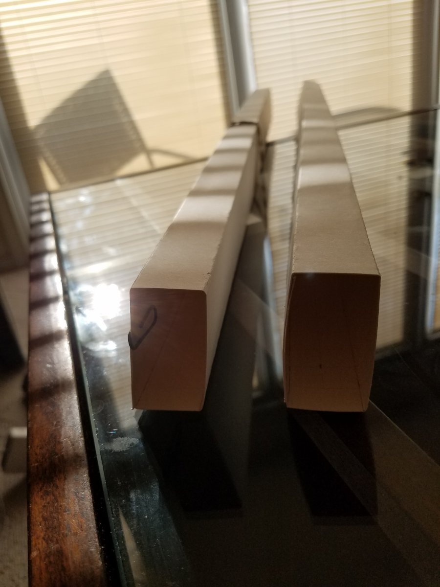

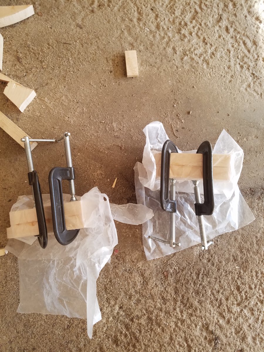

    In any event, I have been devoting all of my time on the project on designing the door frame superstructure so that I can hopefully get to working on rebuilding the body. I can't start replacing the floors or building anything else until this part of the body has been taken care of. Since I don't want to take apart the body until I have braced it and worked on the cowl; I have been working almost exclusively from pieces pulled from the rusty donor convertible body which was introduced in an earlier post.
    After the local steel place said they were unable to work on these pieces and suggested finding a foundry, that's what I did. I am planning to utilize cast A and B pillar units which weld into the body and into a tubular rocker panel. I am planning to use cast iron and have been basing my patterns on approximately 1% material shrinkage.
    I have decided that the rocker panel is going to be replaced with 2x1x1/8" rectangular tubing which will fit around the cast A and B pillar units. This will replace the stamped c-channel with cast c-channel insert which was approximately 2.25 x 1 1/16 x 1/4" in total with .25" of height being attributable to a bump at the front edge of the channel. I would have liked to use 2.25 tubing it's not a standard size and the next size up (2.5"x 1.5") may be a bit too large. However, the existing rocker does have a 1/4" extension on the bottom edge in the area where it mounts to the chassis. For now, I am considering 2 x 1 x 3/16" tubing, but the local supply company does not carry it. My indecisiveness on the wall thickness and tubing size will be put to rest when I am up to adapting the A and B pillar patters to the tubing. While I like the idea of the extra wall thickness, I am not fond of removing material from the cast iron portion of the A and B pillar castings which will fit inside of the tubing. I partially also like the idea of the 2.5 x 1.5" tubing, but it would extend below the bottom of the cowl and would also be higher than the current position of the floor pan. I could mount the floor pan flush with the raised rocker, but that will cause other issues.

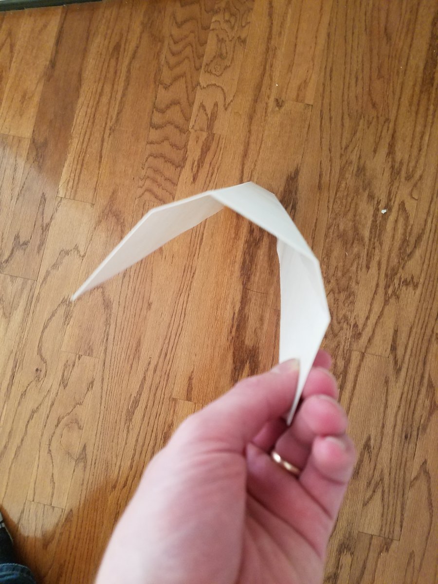

    The photos here are primarily of my work on patterns of the A pillar casting pattern. As you may be able to see from the photos, the original unit aligned with the cast C-channel style piece which was fitted inside of the rocker panel, then flared outward to follow the bottom edge of the cowl, where the bottom of it tapered up again following the bottom edge of the cowl, until it met the front body mount.
    The piece I devised in my mind will be a bit clunky, but it will hopefully offer improved rigidity for the body. The cast piece will taper to follow the bottom edge of the cowl, it will extend into the upright C-channel which forms the trailing edge of the cowl, it will have an upright support which will meet the vertical edge of the front body mount, it will extend under the dead pedal portion of the floor to provided a bit of added rigidity, and it will include an approximately 2"x 1" (or whatever nests within the tubing I choose) extension on the trailing edge to fit inside of the steel tubing.
    In the next post, I'll show you the B-pillar patterns I have been working on. In the mean time, what do you think? Is clunkly good? Should I go for the thinner walled small tubing or the thicker walled larger tubing? Feel free to chime in.

    Strong is good but you don’t want one piece to be much more rigid than another, because then it just transfers the stress elsewhere and other things tend to break. (That was the problem they had with the original Sopwith Camel biplane in 1917-1918.). A car should flex roughy the same amount when bent in various ways, as driving in a city might do.
    Second thought is to try to build those new pieces out of 3x4 (roughly) steel 1/8 thick, cut and bend into shape and weld together. Seems much more forgiving and adjustable - you can take it somewhere for final welding if you want.
    If you do decide to get it cast, make sure they use decent steel for the pour, so you can weld in the future if needed.
    Maybe try mocking up framerails at this point, probably made from metal wall studs, and then trying to transfer that to thick steel. I find patterns that I can mess with easily kelp my thinking.

    Without a decent work surface to align everything, I picked up some wood to build a table which would fit over my saw horses and which I could use to brace the door properly. Now, I just need a bit of time to start stabilizing the door and establish the appropriate relationships all the way around.
    With regard to the mechanical aspects of the car the overdrive unit is in very capable hands currently working on building a Bantam compatible unit. I'm eager to see how that goes.
    Beyond that, I've created a few reproduction parts for these cars that will hopefully help others out. I'll post more on that later.

    Body:
    No tangible progress, merely plans for how to finalize the wood patterns for the inner support structure of the rocker panels. This is the element that has this bit of progress at a standstill.

    I have sourced enough parts to build a complete original style shock absorber set, so I'm not sure if I will go for an authentic set or one utilizing the Johnny Joints I wrote about earlier. I am also working on new replacement parts for some of the chassis/suspension consumables.

    I have some new plans for the gauges. I am trying to see if my plan for the speedometer is feasible. If so, it could be something neat.

    No progress on the engine. The transmission is still with the rebuilder and he believes he may have it together by the spring. Once I have the transmission back, I can use it to figure out how the floors need to be built to accommodate the overdrive.
