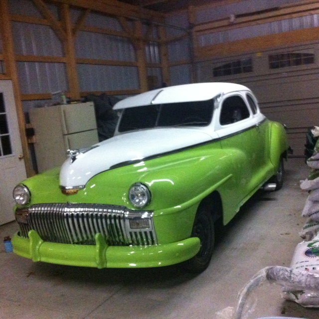

    I like it....
    Lincoln tail lights?
    droppedstepside and chop job like this.
  2. Yeah they look like 49-50 lincoln cosmopolitan.
