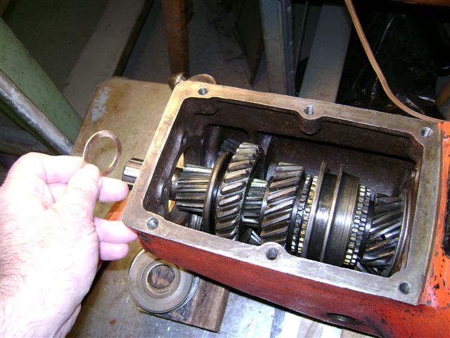

    Do you have this type of syncro drum ? with the fork slot to the rear, that requires the 91A , 3" shift fork .
    Either one of the early ( 2 7/8"), or late ( 3") forks will fit in the 81A shift tower. I ask, because it is possible for the late (3") fork to straddle the early syncro ( with the slot in the center) then it would push the drum too far toward the rear. ( edit) My mistake here, that would push it back too far in second gear, not third. Since third gear is when the drum is pushed forward, not back. sorry.

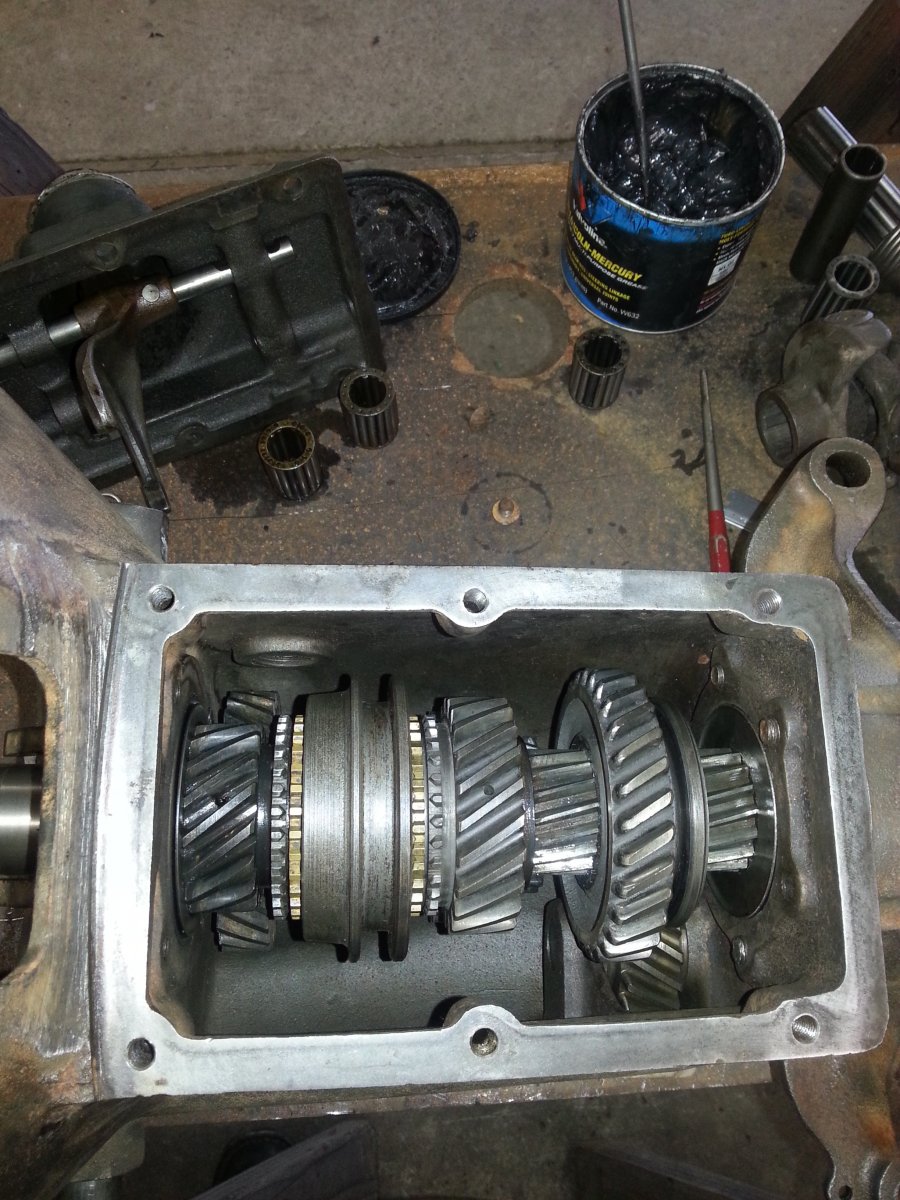

    Here are the photos of my trans. 101_0795.JPG 101_0810.JPG 101_0795.JPG 101_0810.JPG 101_0803.JPG 101_0795.JPG 101_0810.JPG 101_0803.JPG 101_0792.JPG 101_0812.JPG

    Did you say you replaced the main shaft? It looks like it is pretty chewed up. Not say that is the cause of your noise, just wondering.

    Thats the factory cutouts to assist dismantling lock slide.

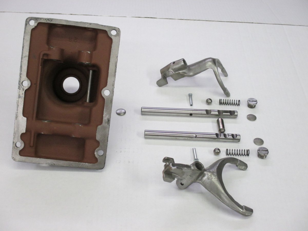

    I think you need to use the 68 shift tower on that synchro sleeve. I believe the sleeve was changed when they went to the 91 tower with the 2-7/8 fork. If you compare the two towers you will see that the fork is farther forward in the 81 top so it is pushing the sleeve too far forward when you shift into high gear. I have a 1938 transmission and the gearset and synchros look exactly like your photos and uses the 68 top.

    Which fork is in your 81A top? It should be the narrow one (2-7/8) to be compatible with your gearset and synchro sleeve. The 3-inch 91A fork is offset further toward the front of the gearcase and would cause the synchro sleeve to move too far forward and potentially contact the front gear on the cluster to get the noise and vibration you feel.
    I suppose that could also be caused by the cluster being too far to the rear in the gear case. Is there an extra shim on the cluster and is it perhaps on the front side? I have seen gearboxes with an extra shim to resolve cluster and play and these should be installed at the rear of the case. You might also try asking on the early V8 section of Fordbarn, I see Mac Van Pelt post there on transmission questions quite often.

    Do you have this type of shoulder bolts that hold on the shift tower ? These are meant to hold the tower in position.
    The other type ( full threads) can allow the tower to move. Maybe you could try to loosen your bolts to move the tower in the direction where it won't make the noise.

    The spare shifter top 40-7222 has smaller 1st fork than 81A top.

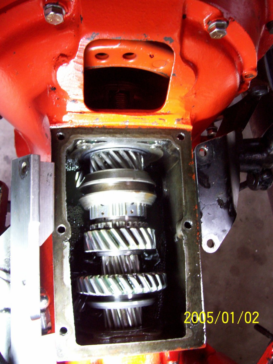

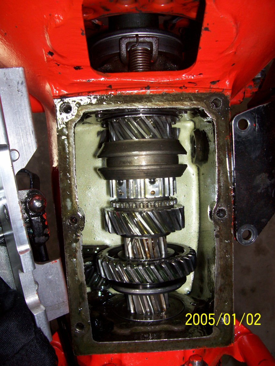

    This information is correct for the late style synchro with the brass blocker rings. However, the early style synchro hub is free to move back and forth on the main shaft in order to engage the friction surfaces on the hub with either the main drive for high gear or the front of the second gear for second. I think your synchro hub should be farther forward when the sleeve is engaged with the main drive for high gear. There may be an obstruction on the main shaft that is keeping the hub from moving forward when you shift; the result is that the balls become partially exposed on the taper of the sleeve and may actually push the sleeve forward due to the taper on the ID of the sleeve.
    As a starting point can you see, or use a mirror to see the front face of the sleeve to see if there are any wear marks that indicate it is running on the cluster gear? Secondly, can you duplicate the condition where the sleeve is fully forward with the balls partially exposed and attempt to pry the hub forward to see if it is hung up on the main shaft? Another indication that it may be hung up is if you are getting grinding upshifting into high gear indicating that the hub is not making contact with the friction surface on the main drive gear. It seems that you have eliminated the shift top as the potential problem if you are getting the same results regardless of which top you have installed.
    I have a 1938 transmission apart right now with the early synchros, so I will reassemble it enough to check how much movement there should be on the synchro hub and will report back. It is definitely more than the 4-8 thousandths that is spec'd for the late synchro assembly where the hub is essentially stationary on the main shaft.
    For the Wizzard and others I am posting a picture of the early style synchro in a 1936 transmission which is the same unit as in Jukenut13's transmission. It could be a 39 transmission but it has the earlier gear set that was used into early 1939
