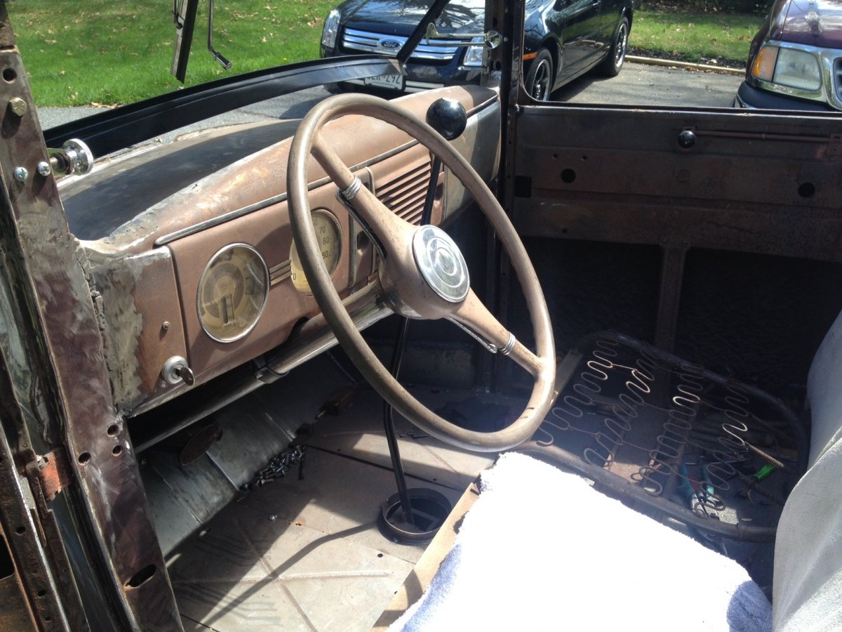

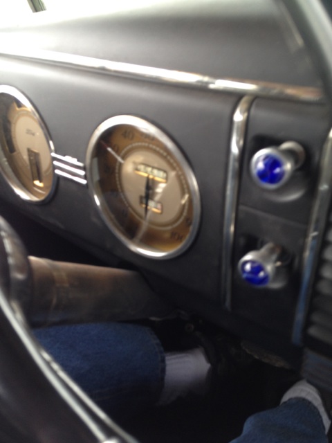

  2. I used a '39 dash in my '30 had to make knobs for the switches.
    What's that about 120 mph?
