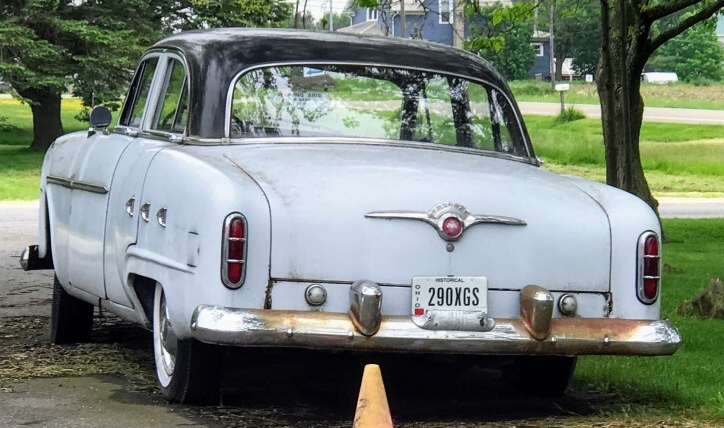

  10. Chrisbcritter
    Joined: Sep 11, 2011
    Posts: 1,970
    Chrisbcritter
    Great solid truck - do you have the history of how it got so little use?
    Not Studebaker; those had three crossbars. The lights you have are 1951-53 junior series Packard:
    (Image from curbsideclassics.com)

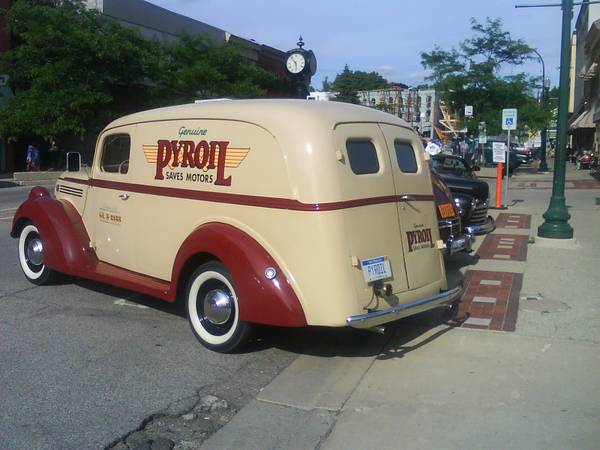

  22. The headlights on it now look like '35-'37 Ford truck. The correct headlights for '38-'39 truck are the same as '35 Ford car. You can see what they look like on my '38. I did use '36 car "bug eye" lenses and rings rather than the flatter lens that is correct for '35 car and '35-'39 truck ( the '36 car bucket is the same except for a shorter mounting stud, so the lenses will interchange). The headlight stands are different for the trucks. The correct headlight stands are the same for '38 and '39 trucks. You can also use the headlight stands from '40-'41 big truck and '40-'47 cabover truck that have the little oval parking lights in them. Those little parking lights are the same as '37-'40 car interior lights except with a glass lens rather than plastic. If you want sealed beams that look factory (because they are), '40-'41 big truck and '40-'47 cabover complete headlight assembly will bolt on to the '38-'39 fenders.

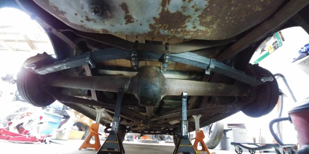

    So today I replaced the busted rear leafspring and shackles with a Posies unit. Let me tell ya, those original shackles and bushings didn't want to come out, but some heat, drill and air hammer worked just fine! 20181124_155659.jpeg
