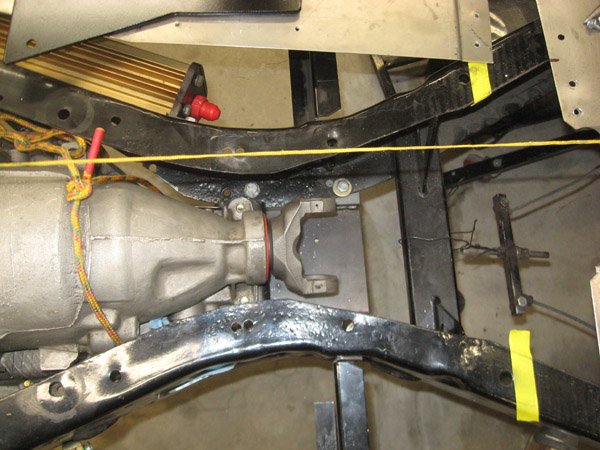

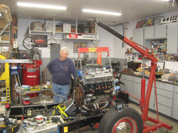

    With the cowl off we decided we better make some modifications to the frame so we would know how to modify the front sections of the floor while they were easy to remove for test fitting and fabrication.At a risk of getting the thread shut down I will show just a few pics of OT pieces of the project. If the moderators don't like this content please just take this post down and no the whole thread.
    It's pretty easy to remove an engine when there is nothing in the way.
    Out with the old and in wit the new 200.
    This brake system had to go.
    The 200 requires some more surgery in order to clear the pan.
    More surgery required for speedo access.
    Getting lighter?

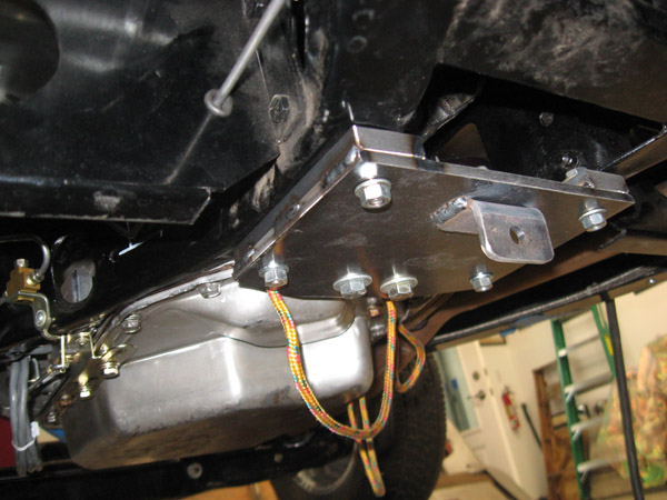

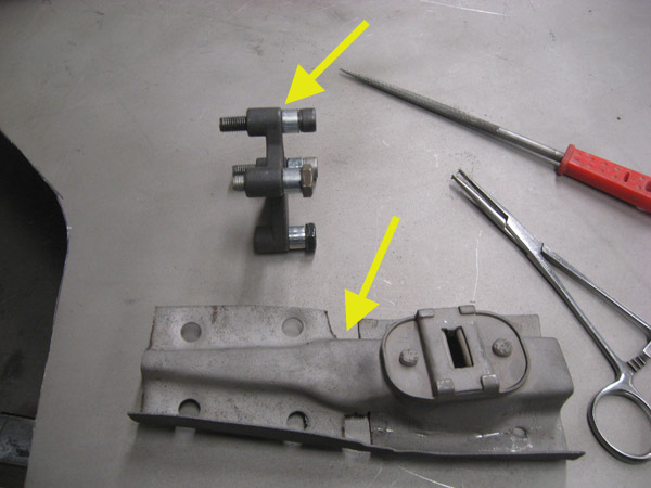

    A new transmission mount was needed.
    Bracket is for the emergency brake.
    Tight but adequate room.
    New mount maintains the same angle as the previous mount.

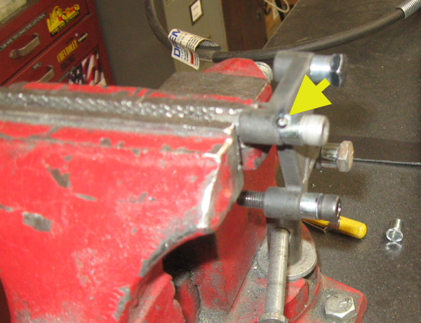

    A genie shifter will go on the transmission. I had to change the shift gate out in this one. IMG_6429R.jpg
    Shift position sending unit purchased long ago for the 350. I had to modify the linkage
    to fit the 200.
    Yellow arrow points to the new longer linkage. Tricky to make but it works :).

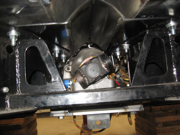

  6. Looks great Sam. Just asking...Is there enough room at the crossmember to slide the trans back and remove it from the bottom? It would be a pain to take the front sheet metal off in order to remove the engine and trans from the top in the event of a trans issue.

    Thanks Tim! We did consider how much room would be required to remove the transmission without pulling the engine and hopefully we have added enough room for doing that. We have had to pull the engine out too many times in my coupe to remove the transmission to not consider that likely scenario.

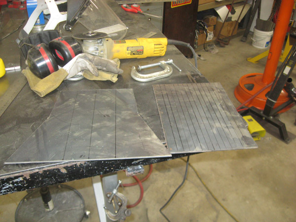

    The PO of this frame evidently didn't think he needed to have a top on the old Ford X
    member box but I did. So using the holes that were already there I fabricated a new top.
    Using some 1/8 plate I laid out a plan. What I really wanted was a nice half round
    center section but I had no luck finding any at the local steel vendor and nothing on hand.
    So I decided to try using multiple bends on the metal break. Well that didn't work to well.
    So I settled for two pieces with one bend each welded in the center. Of course the next
    week when I took my drive line in for some work, there on Drive line Dave's shop floor
    was all sorts of varying diameters of steel tubing I could have used for this project.
    Oh well.... This will work.

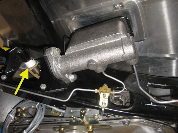

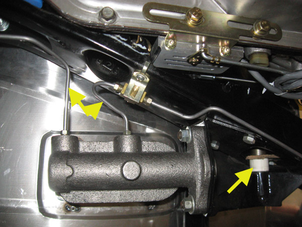

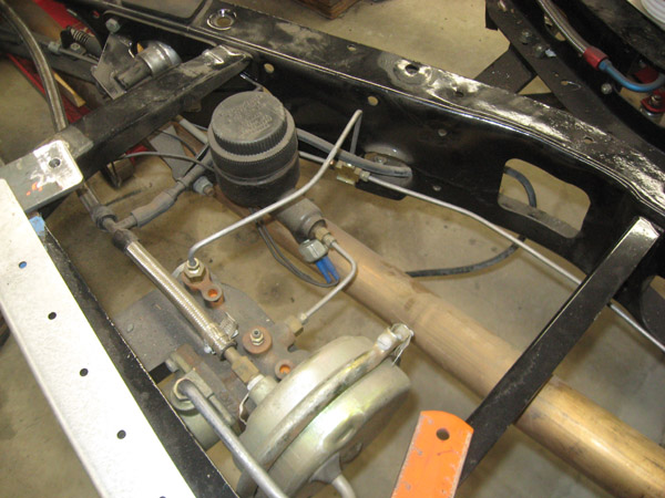

    As I mentioned in an earlier post this single master cylinder and remote power booster
    just wasn't going to beadequate for me so we took it all out.
    I thought I was going to need a a new pedal assembly since I was switching from power

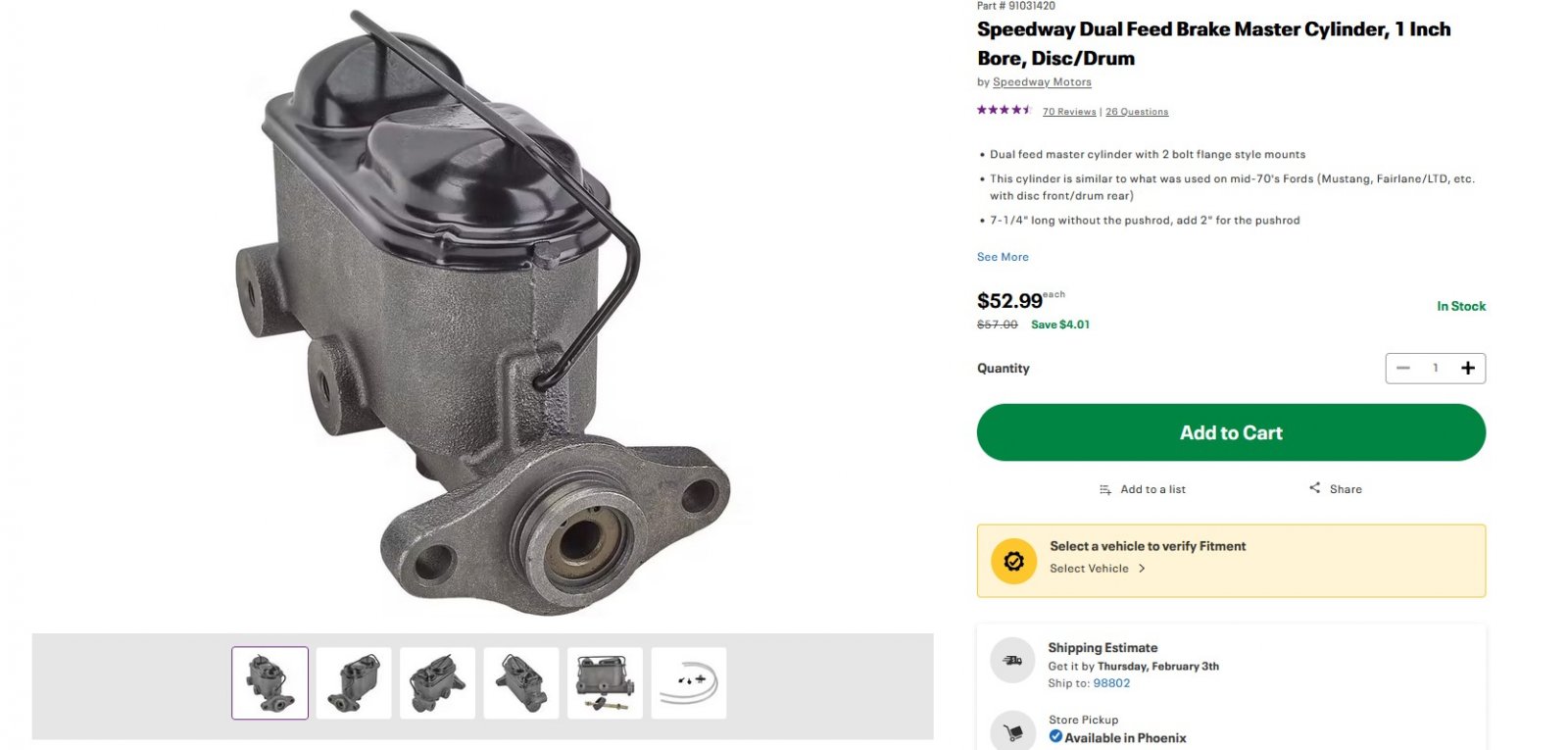

    brakes to manual. So I ordered a kit from Speedway that included a the corvette MC and
    pedal assembly. Turned out that the pedal assembly I had was the same ratio as the new one.
    We double checked the charts for pedal ratio and decided this old one will work just fine.
    Speedway was nice enough to allow me to return the pedal assembly and keep the master cylinder.
    They say this MC is supposed to work with disc disc applications. I have been very happy with this same
    MC in my 40 coupe So I will give it a try. If I don't like it I will convert to the the disc disc version later.
    Don is a wizard at brake lines and was able bend up theses tight radius lines in a couple
    of hours. That arrow is pointing to a PVC pipe spacer I installed along with a cardboard
    template of the pedal so I could determine where to make the hole in the toe board.

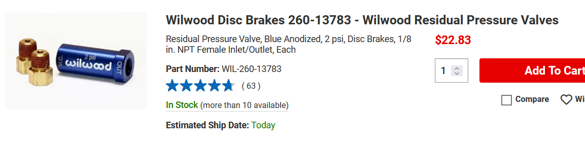

    Don also installed these 2 PSI valves in the lines front and back since we have disc brakes on both. This is a nice kit. I remember when building my coupe the adapters were not included with the valves so I had to order and wait for them. They even put the the thread sealant on them! Sorry I didn't get a picture of them installed.
    We installed all of this stuff so that we could finish installing the the front floor boards.
    We will start covering that in the next post.

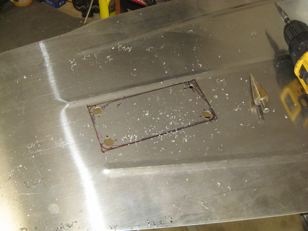

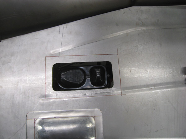

    Now that the master cylinder and shifter are in place we can figure out where to put the holes for them.
    I put the floor panel in place and traced around the MC from underneath . Drilled some
    holes in the corners and then cut the hole out.
    Came out pretty close. When I was done I thought I should have made the hole bigger,
    but I was trying to keep the cover as small as possible because that lump will be under
    my foot. There is plenty of room to get the MC cover keeper off. Then I decided to
    recess the flange in the floor.
    We used the bead roller to make the recess . The dome was fun to make. I used the sand
    bag, several hammers, planishing hammer and English wheel to shape this thing. Looks
    okay considering it will be under dynamat , insulation and carpet.
    I chose to tack some 10-24 nuts under the cover to secure it.

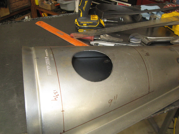

    It's time to modify the transcover before it gets welded in. My previous 40's have all utilized
    the stock transmission cover and wooden toe boards but this time I decided to use the Bitchin
    products kit that is meant to be welded in.

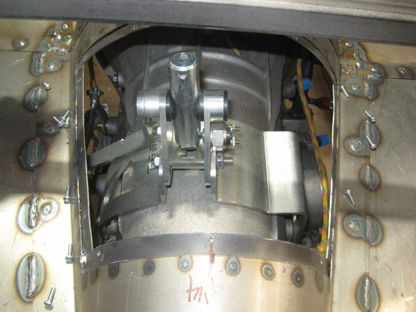

    After installing the Gennie floor shifter It was obvious that we would need access to it
    for adjustments and wiring the neutral safety switch. So I marked out a generous service
    opening.
    I used my dremel tool to cut the cover so as to get the most accurate cut with a small
    gap.
    I decided to try a different method for securing this cover . I welded a perimeter of 14
    gauge plate around the perimeter.
    I used the plug weld technique again to secure it.
    I tapped the flange for a lot of 10/32 screws.
    It takes a lot of them make the panel stay tight to the original shape of the tunnel.
    I will put some shorter screws in later or cut these off a little.
    While we were aligning the floor before welding we discovered we were a little off center.
    After moving the transmission cover over the shift boot hole was no longer in the center.
    That necessitated a little adjustment. I took the the piece I cut out and welded back in to
    make the hole round again.
    A little bit of grinding and sanding later and it's good as new.
    Boot ring fits now.
    The result is good access to the shifter assembly. This shifter will probably have to be
    removed if the transmission has to be removed for service.

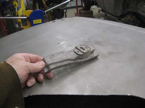

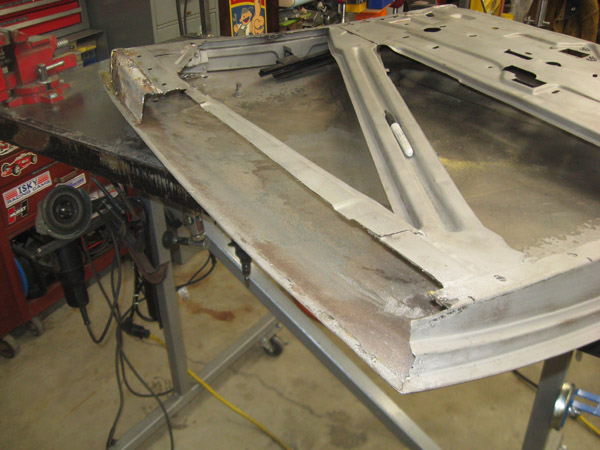

    We dug the hood out of storage to test it's fit with the cowl.
    We had to make a couple of adjustments to the cowl but it fits good now. It was nice actually
    see it on the car.

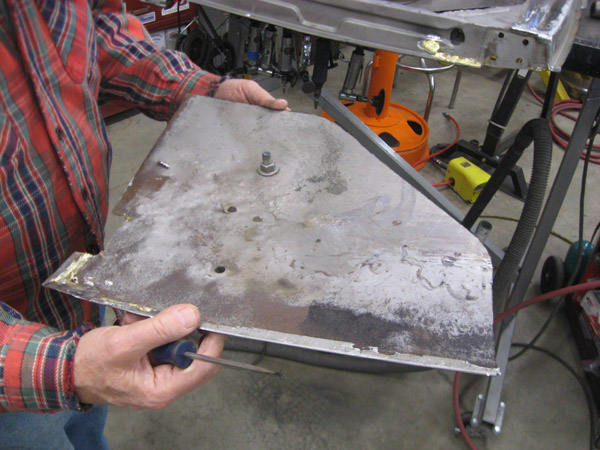

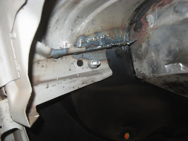

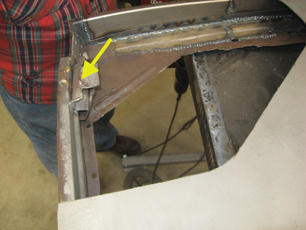

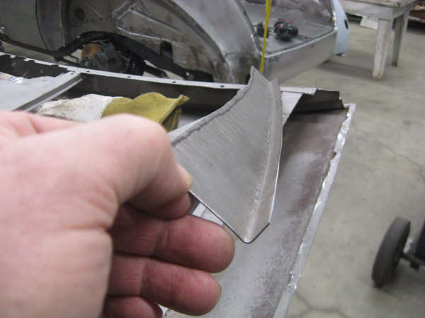

    The top of this bell housing cover needed some adjustments. We ended up with a gap
    at the firewall that had to be filled.
    I used some clear plastic to make a template.

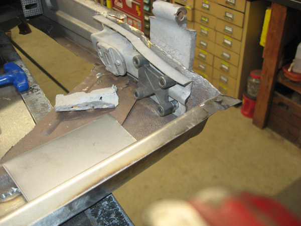

    Lots of spot welds again. Ugly but you can see the blue indicates than thin strip of
    metal was getting hot.
    Some metal finishing to both sides made it look decent and it's ready to weld on.

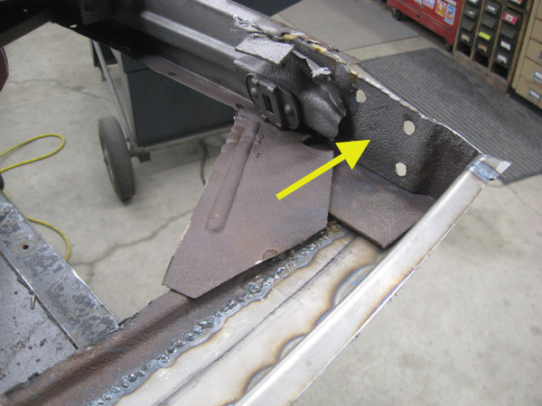

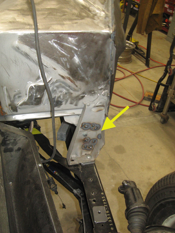

    This yellow arrow shows the stock rocker panel . The floor fit up tight to the cowl. The
    bitchen floor and rocker kit is flat in this area.
    So Don made this piece to fill the gap.

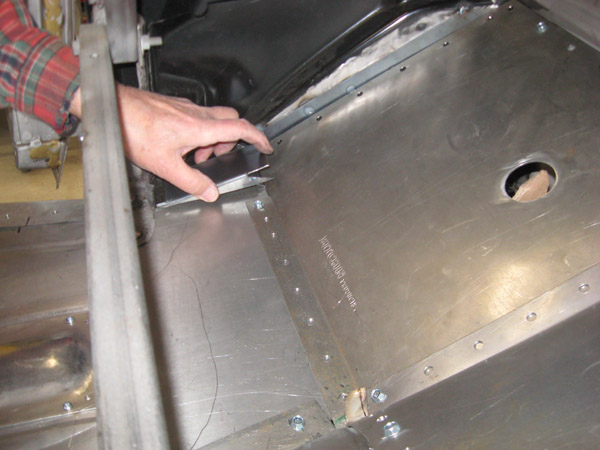

    The floor is now ready for welding. You can't see all the plug weld holes in this
    picture but most of them were drilled on two inch centers. Hole sizes were around 5/16 inch.
    The sheet metal screws really work well for this temporary clamping. As Joel said earlier
    you should not weld any of this stuff down until you are sure every thing is lined up correctly.
    This is sage advice. I had to adjust the front flooring a few times before I was happy with
    the alignment. I don't remember if I mentioned this earlier but you need to drill the top
    panel holes a little larger than the screw diameter. To do that you have to drill the screw holes
    and plug weld holes before you put the panels together. If you do not do that the screws will
    force the panels apart instead of clamping them tightly together.
    A lot of plug welding later ... I also added some weld beads in between the plug welds.

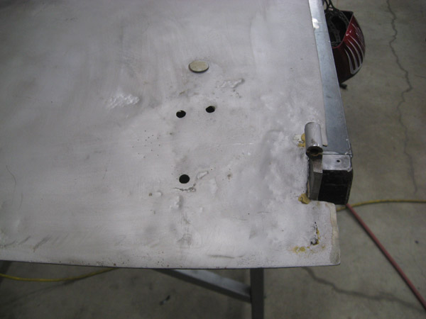

    Cowl sides:
    So as shown before I drilled a lot of holes for plug welds on the pinch flange.
    I used a lot of small clamps ( not shown) to hold the two panels tightly together while
    welding.
    Plug welding again. I will sand them down later on. The top arrow shows an area
    that will be behind the hood hinge so the priority was a solid weld ,as in didn't have to
    be pretty.
    The inside of the pinch flange should look pretty good without much metal finishing
    So this joint needs some special attention. I took a little too much metal off of this years
    ago.
    Finished
    The inside of this part of the pinch flange was challenging to weld. I ended up putting
    some weld metal in that black hole behind the bolt also. The hole with the bolt in it is
    used for the hood hinge.
    Eventually plug welded all of the holes in the firewall base.

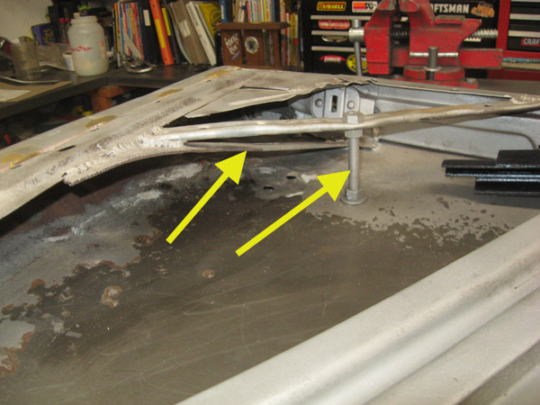

    Right front passenger door:
    Now that the body is pretty much welded into the shape we hope it will stay in with decent door function it is time to work on the doors again. This may seem a little repetitious to some of you but to me they are all a little different and I want to document the work we do on them.
    This one had a simple piece of tin braised to the bottom. We could of left it as it was
    and used it but that's not the way we do things here.
    I am not quite sure why they added all of this bracing but it has to go. I have never seen
    a carriage bolt installed in a door before.
    Top side of bottom corner Pretty lumpy . This area actually looked pretty good before
    the bondo was blasted away.
    Peeling away the tin cover.
    Yep pretty much like the back doors....
    The trick here is to maintain the shape of the door while replacing all of this stuff.
    Eventually there wasn't much left. we did manage to save the door skin pinch
    flange .

    Door Skin and door corner support :
    I have to admit I have been very nervous about this part of this project. Welding a
    new or donor skin onto this door won't be easy...... I have to master or at least gain
    enough skill to hammer weld the new patch in without too much warpage. The plan
    is to have me mig weld a spot weld and then have Don give the weld a few light
    smacks with hammer and dolly. Allowing for cooling between welds means this patch
    will probably take a whole afternoon. But there is plenty to do before we get to welding.
    It's kind of like painting, if you don't prep things right it will not turn out well. So let's
    get started.
    More brass to cut out.
    So we decided to make our cut with a large radius. Rounded corners are supposed to be
    better than 90 degree corners when welding patches. Less puckering of the metal I am
    told.
    Cut out with a Dremel tool.

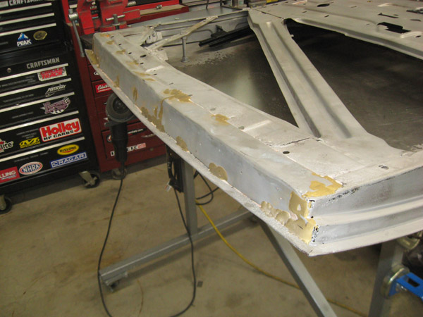

    This door stop and support had been worked over before and we decided to replace it.
    The whole bottom of the support was missing. This was also an area of the door that had
    been replaced many years ago by the PO.
    This corner of the door jamb had been replaced. We deemed it ugly but usable.
    We cut out a piece of 20 gauge and laid out a 2 inch grid to help with keeping on
    track with the english wheel. We were surprised at how easily the metal moved to the
    shape we needed to math the door. We haven't decided for sure but we think we are going
    to use the donor panel. So we may come back to this piece later if the donor does not work
    out.
    The donor door given to us by a good friend.
    After some clean up it looks pretty good. Except for this spot by the bottom hinge.
    It seems like a lot of Fords suffered this same fate.
    Ford didn't put very many welds along the edge but they must be carefully ground out.
    I laid the piece I cut off of the convertible door on top of the donor door and marked
    the donor door 3/8" larger and cut it out.
    We will get back to the skin later. This donor door had a better looking door stop support
    so we will try to salvage it.
    We cut the whole corner out sand blasted it and started the salvage work. Just 4 spot
    welds hold the top section in.
    Meanwhile I continued prepping the CS door for the new donor parts. The arrow points
    to another weld area that I needed to metal finish so the new corner would fit.
    Not much left of the old door stop brace.....
    This donor piece looks pretty good after clean up but it is missing it's bottom corner.
    I had to cut the some metal out here to make this piece fir the modified CS door.
    You will see this in photos below.
    We eventually removed this bottom piece from the donor but we could not use it.
    The bottom hinge is now a bolt on item. I had one threaded bracket for this left over
    from a Bob Drake hinge kit I bought for my coupe. The only problem was it was for the
    passenger door . Since the bracket has to span or bridge over the support I had to make
    some spacer bushings to make it work on the passenger door. The lower arrow points
    to the notches I had to cut out to fit the modified door.
    Of course I made a trip to the hardware store looking for a 3/8 spacer. That drawer was
    empty so I figured out a way to cut them from longer bushings. Just another time consuming
    challenge....
    I tacked the the bushings on to the bracket since they were hard to get in place and
    keep them there.
    The test fit on the car showed the door fit was still good.
    This is a project that just keeps breeding more sub projects. So we will have to spread it
    out over a few more posts.

    These simple panel clamps are great for that type of work provided you can access the rear of the worked area.
