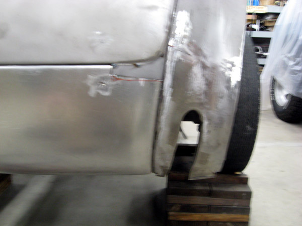

    It's time to gap the trunk lid. We spent considerable time deciding where the optimum location in the hole was for the lid before starting the gaping process .
    Well you might not be able to throw a cat through this gap but any mouse worth his
    cheese could have fit through it.
    My weapon of choice here was some 1/8" welding rod. It bent around the corner
    very easily. I just tacked it on about 1 inch apart and then started spot welding it
    on to the trunk filling in the gaps. plenty of time was allowed between welds to allow
    cool to the touch between passes.
    I kept welding until all of the spots were connected.
    This process went on until three pieces of rod ( in some places) were welded on. The
    trunk lid was then flipped over and the welding process repeated on the bottom side.
    Ready for finishing
    Metal finished welds
    I had to grind so much of the passenger side skin's edge to get a gap that matched the body
    that it separated from the from the skin.
    So I cut it off and cleaned up the the surface.

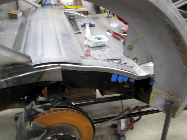

    It's time to work on the trunk and rear seat pan area now that the body is on it's new frame.
    This piece had to be cut off to accommodate the wheel tubs.
    This nice piece had to be reconfigured to accommodate the pan hard bar.
    You can see the pan hard bar in this photo. The frame has been C notched and we were
    concerned that the pan hard bar would be hitting the floor on occasion. After considerable
    measuring for max travel of the suspension we thought we needed about 4 inches of room
    for travel. I noticed well after making lots of room for travel that the shocks only have 2 1/2"
    of travel so I would say we now have plenty of room ( unless I change the coil overs out.
    We ended up cutting the left edge off and bending this piece a couple of times to make room
    for the pan hard bar. We tried in the stock rear seat bottom spring set to see if it would still
    fit after this modification. We think the spring set can be modified to fit. Worse case scenario
    is it may have to be replaced by a foam cushion.

    We had borrowed this fancy spot welder to weld these panels in. If it had worked correctly
    it would have been great. But try as we might we could not get enough weld penetration.
    I ended up having to go back and drill all of the spot welds out and plug weld them.... IMG_5662R.jpg
    Yes looked good but would not hold.
    Welded, could have left them like that but chose to finish them. You can see the rocker
    welded in here .I will cover that piece in the next post.
