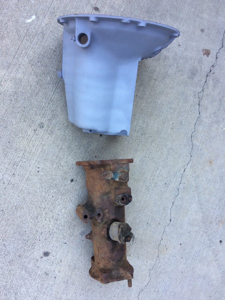

    Just seeing if anyone has ever adapted 32-51 ford 3 spd toploader to a zephyr overdrive? Thought it was a brilliant Idea till I saw that it would need and adapter....?!?!?

    Your picture is missing the OD adapter, which doesn't fit the early trans anyway.

    Yes also does anyone have the of adapter. I am going to have a guy make one out of aluminum.

  5. 1950mercsled
    Joined: Oct 10, 2013
    Posts: 89
    1950mercsled
    This if that wasn't clear

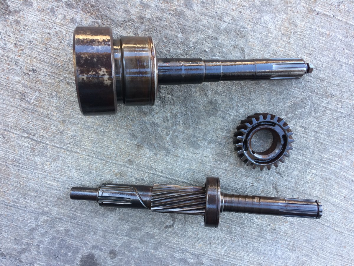

  13. 1950mercsled
    Posts: 89
    1950mercsled
    Are these the parts your talking about

  15. Fred A
    Joined: May 3, 2005
    Posts: 290
    Fred A
    from Encino, CA
    1. Upholstery
    "]Are these the parts your talking about"
    Yes, they're part of a basket full of parts that I was concerned about, especially since you seemed to want to borrow some major elements that would be associated with having the overdrive to attach. There is still the shift cover that kicks it out of OD when put into reverse. BWs just hate to go backward. Fred A
