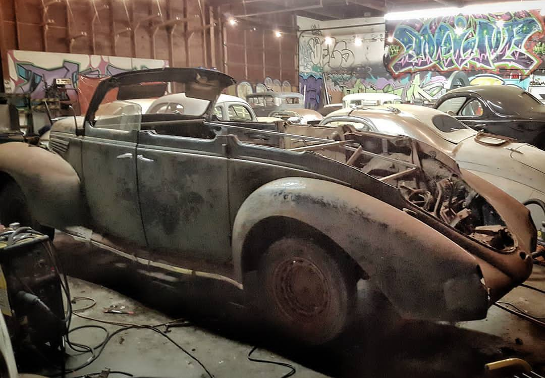

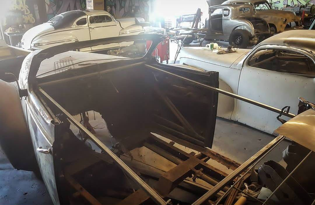

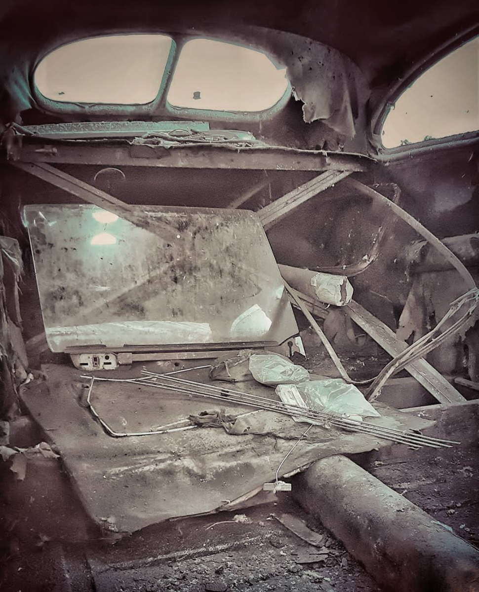

    Thought id share my newest project like i need another one but definetly enjoying all the metalshaping and hand made panel making.

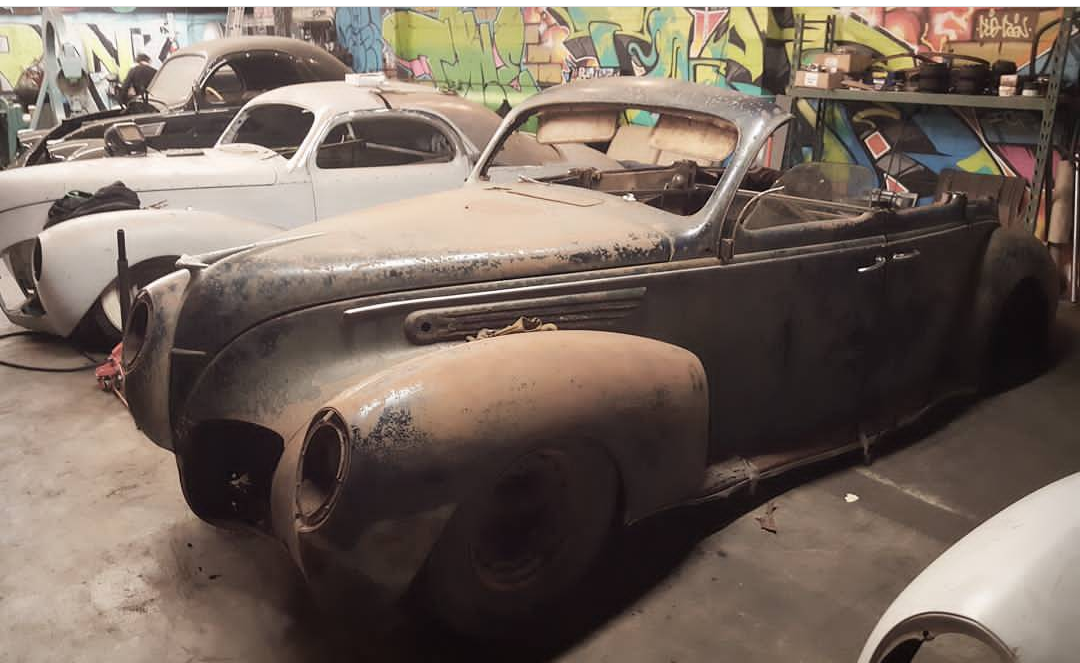

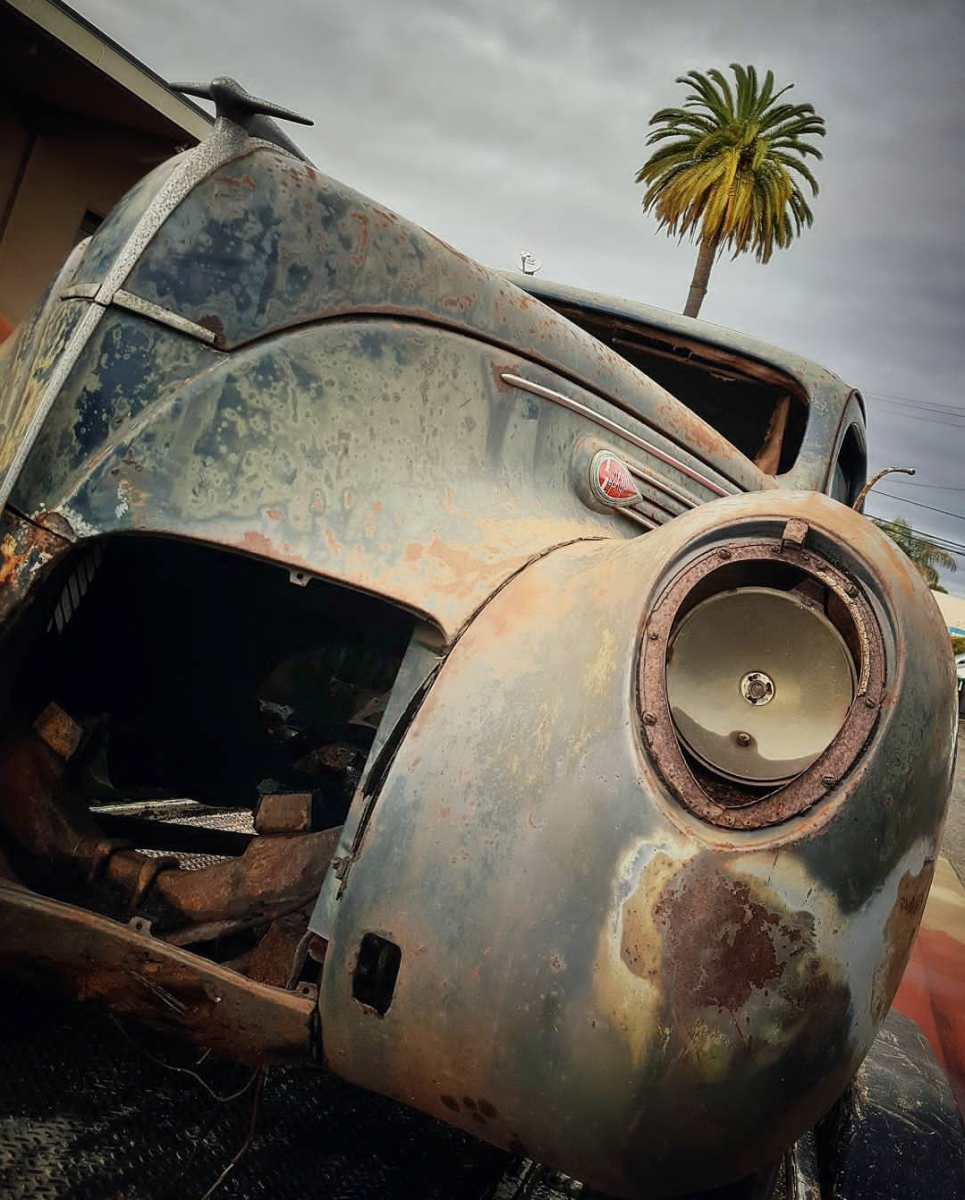

    I started out with a pretty crappy 1938 zephyr 4 door sedan that all the goodies where robbed from it so i was able to get it mega cheap. ive always wanted a convertible zephyr but they are way out of my price range so i figure ill just make my own. This is what i started out with 20180129_212654.png 20180129_212728.png 20170107_132149.jpg 20180129_212715.png
    after getting it into the shop i started taking measurements of some of the other zephyrs in the shop to figure out where i need to start trimming and get down to a good foundation to start making panels, i cut off everything i knew was not gonna be needed leaving some extra behind just incase

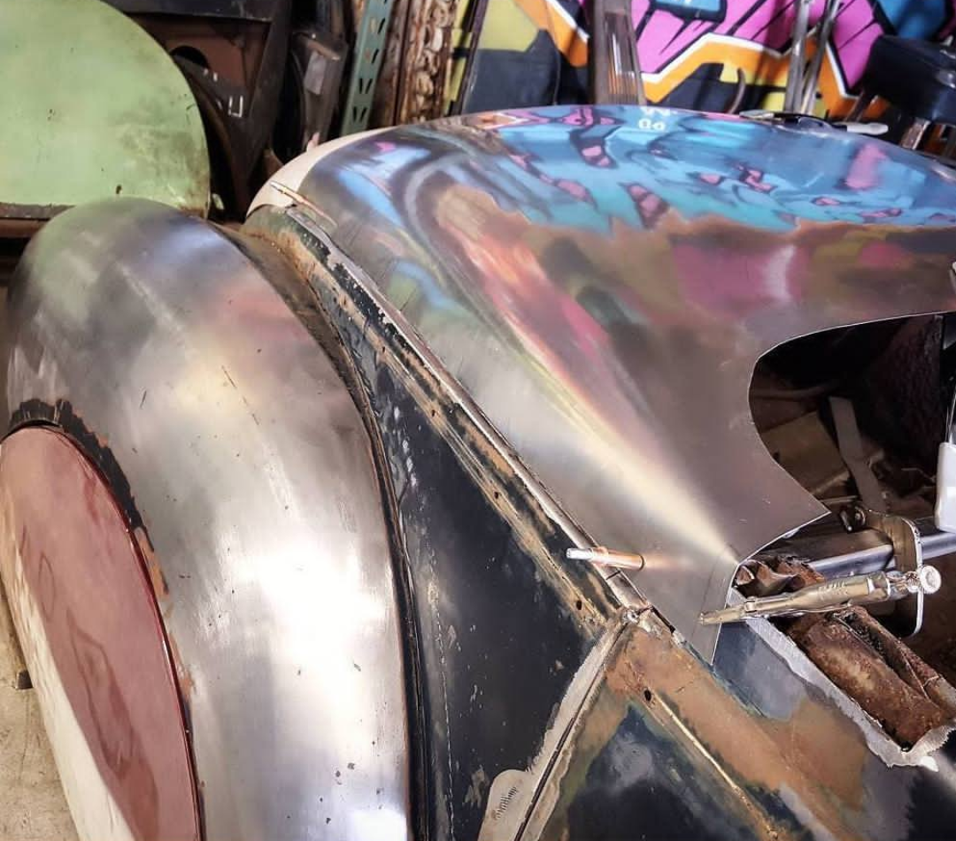

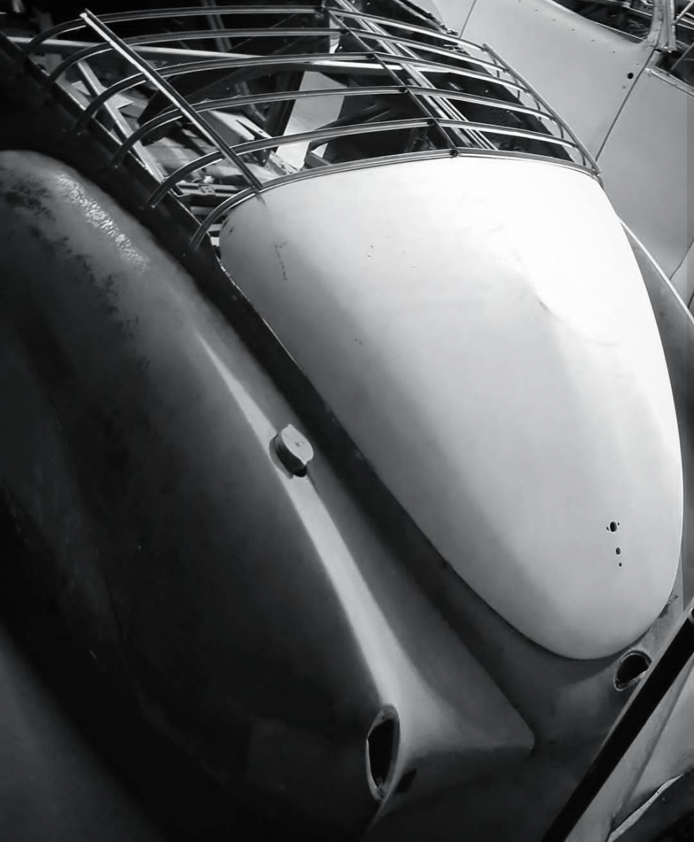

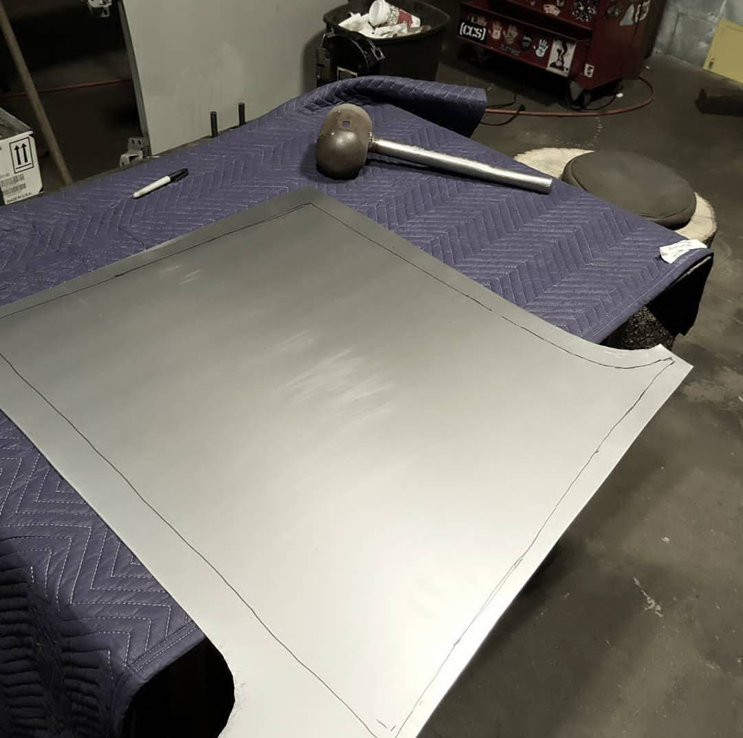

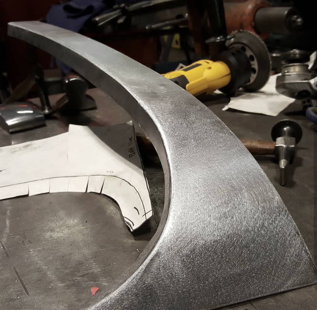

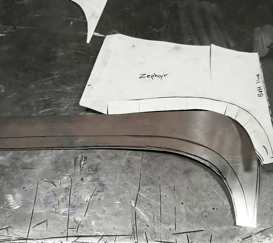

    after getting things trimmed down i have a 39 zephyr coupe in the shop i made patterns off of to transfer over to the panels i will making for this conversion. i made a exterior wire form buck of the catwalk off the 39 and check to see how it flows on the 38 zephyr sedan, i also borrowed the 39 decklid for this mock up. i will be making my own decklid aswell

  4. SKOTY CHOPS KUSTOMS

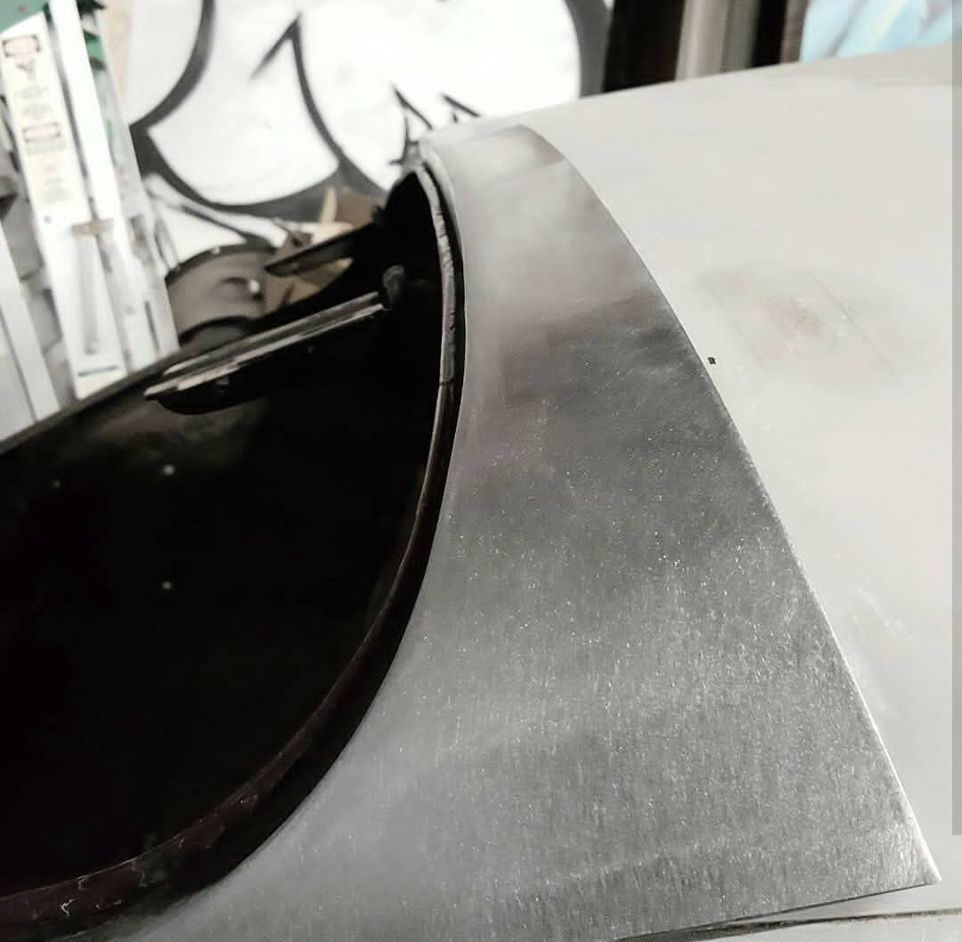

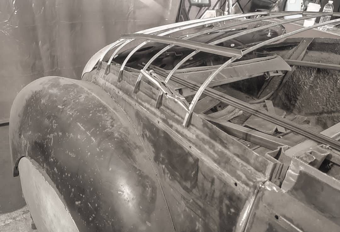

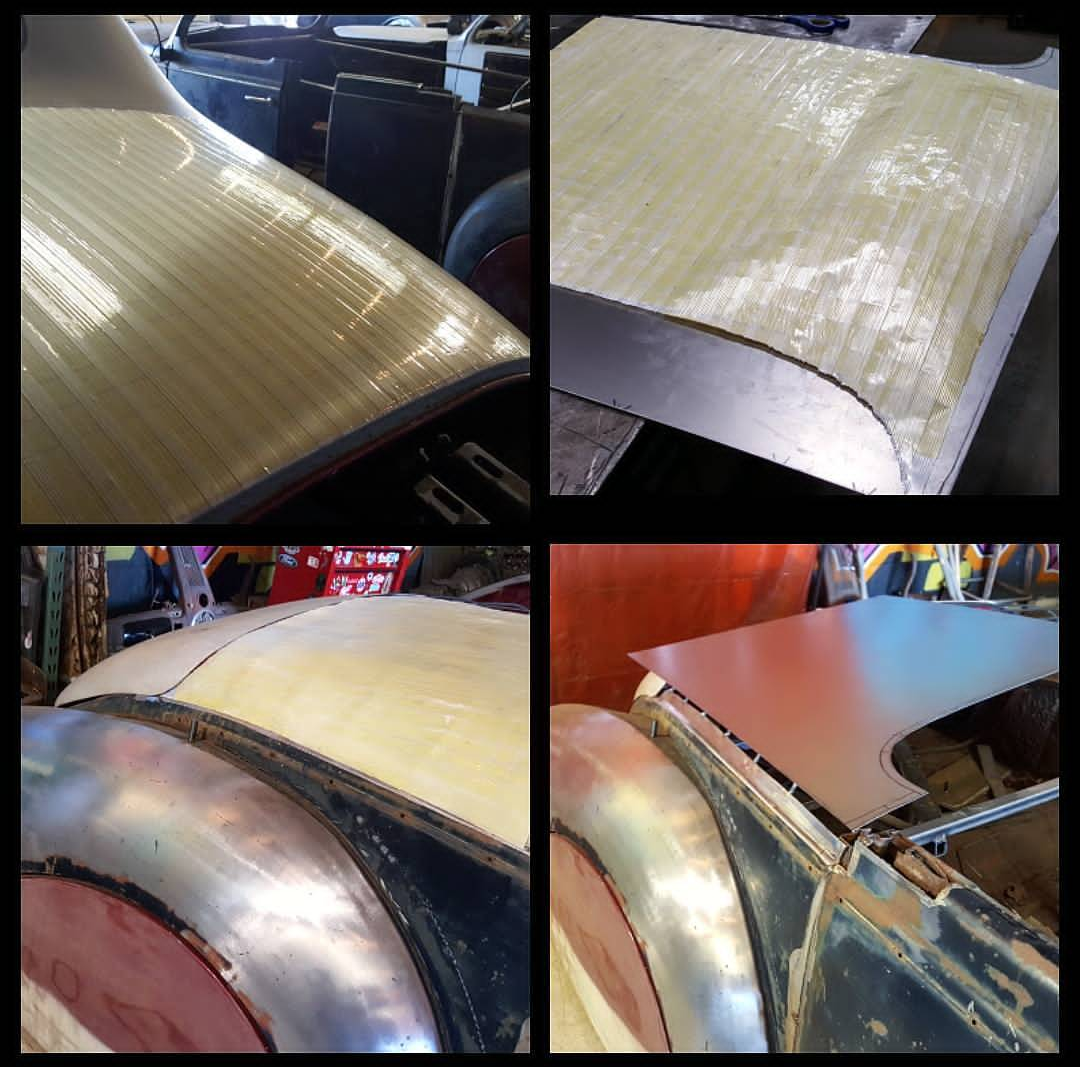

    A After getting a external pattern off the 39 i then was able to make a internal wire form that i can use on the car while i shape my panels, i also got a flexible shape pattern off the car for easy guidance while shaping. 20180129_213315.png

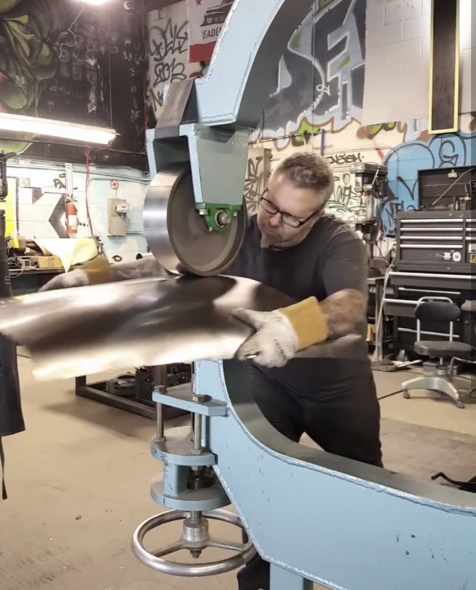

    Looks good so far! I love these kinds of builds. That is one beefy looking English wheel frame!
    Also, how are you making that flexible template? I assume it's made of some kind of tape, but if so, how do you get it off of the part you're templating without tearing it to shit? I could see how that would be a helpful thing to make.

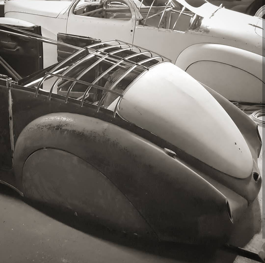

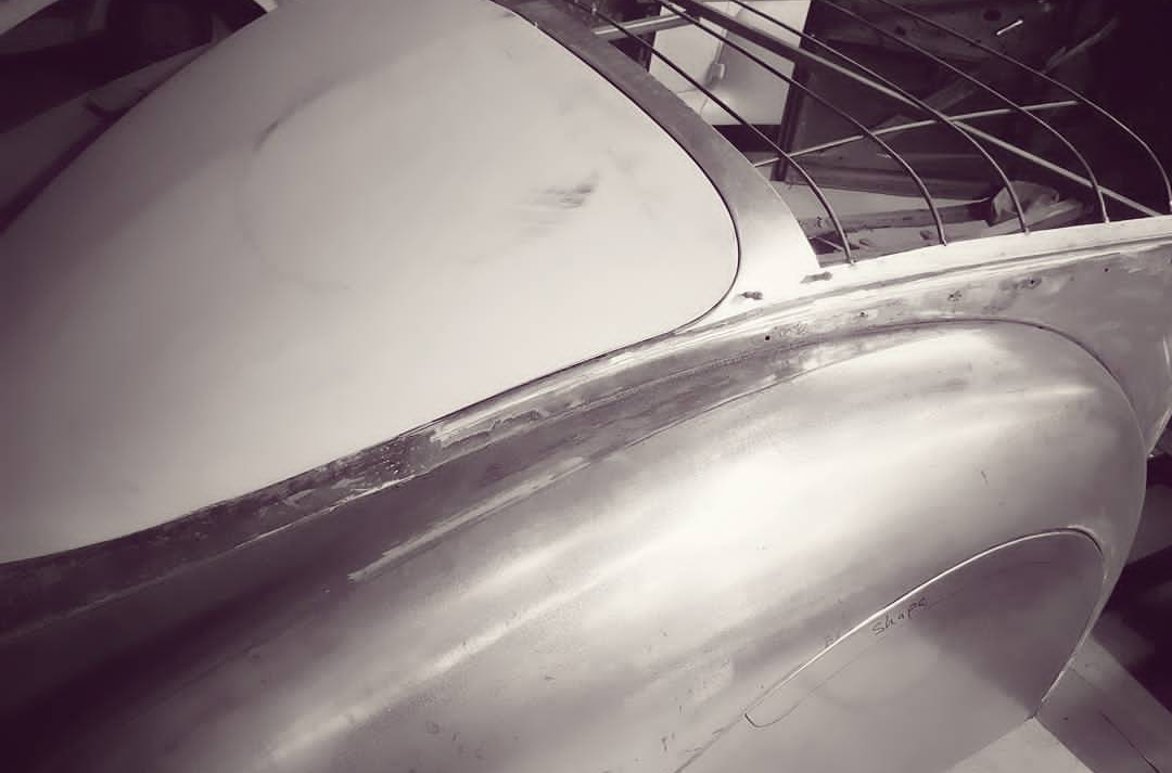

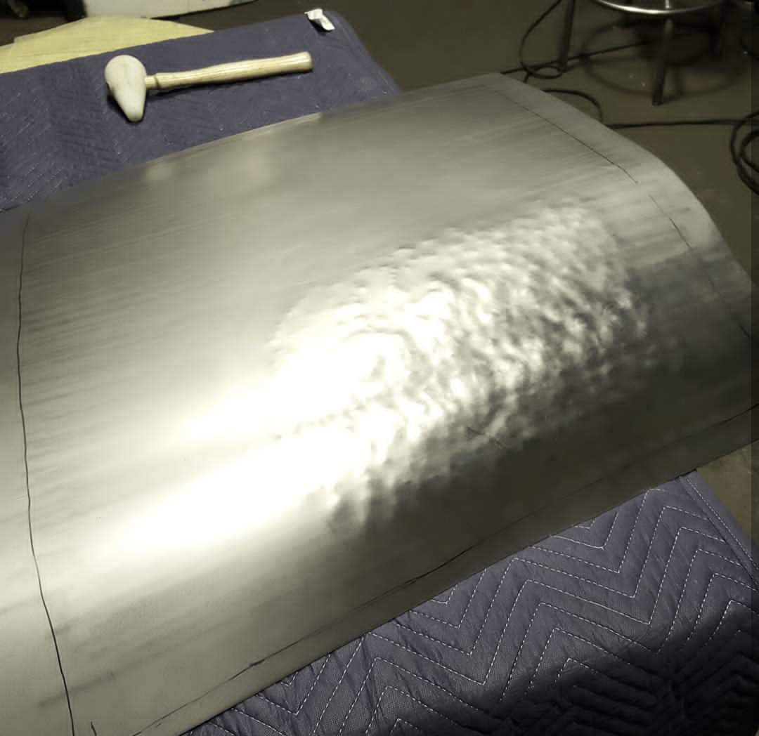

    after wheeling out my sail panels ill need to make the new upper zephyr convertible trunk lid opening being that its very different from the sedan. i made paper patterns off the 39 deck lid opening and made them in 2 pieces as you can see in the pics its a nice tight fit. this will also allow me to trim back my catwalk panels to correct length 20180129_213628.png 20180129_213643.png 20180129_213701.png .

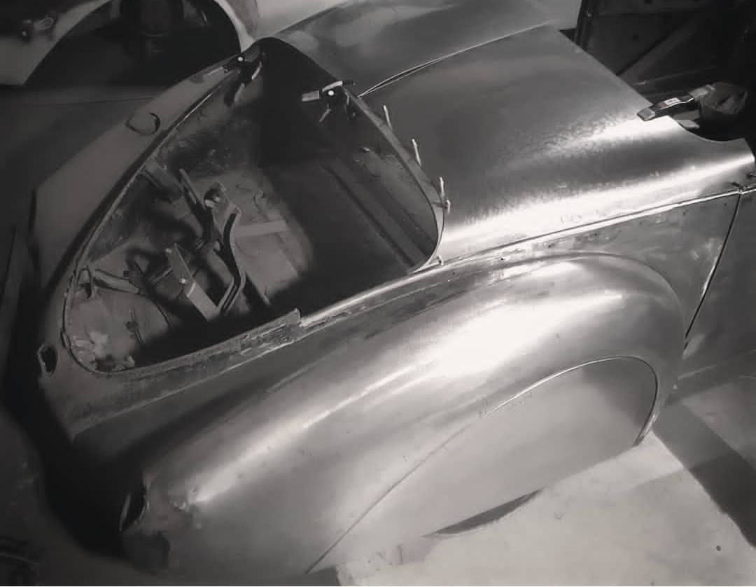

    upper trunk lid panel really gives the car the look in the correct direction and fits nice. the catwalk panel will be trimmed back a little more for welding and access hammer, dolly and planishing machines.
