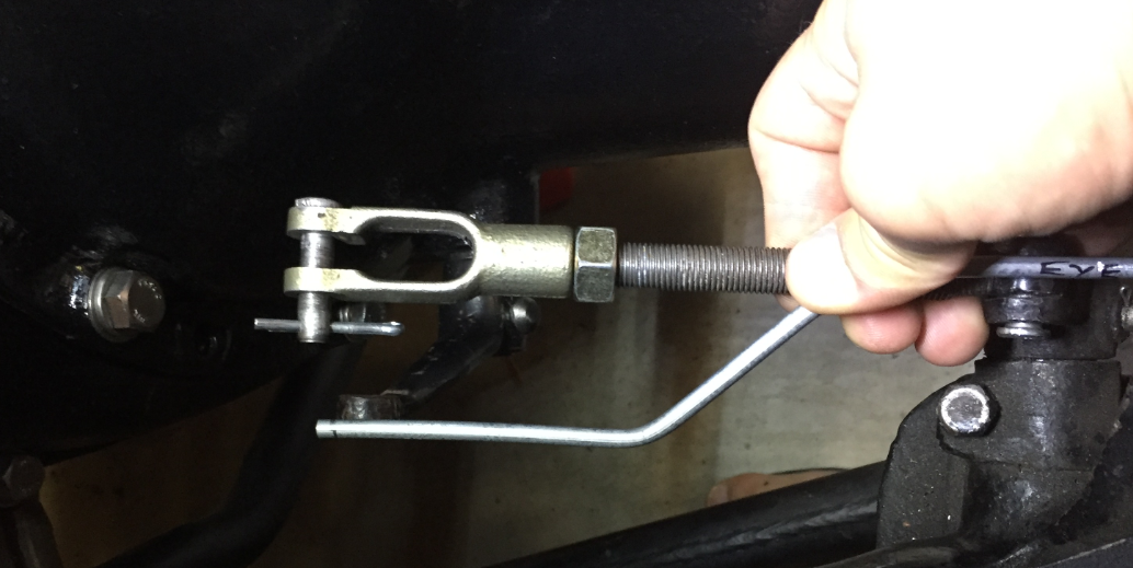

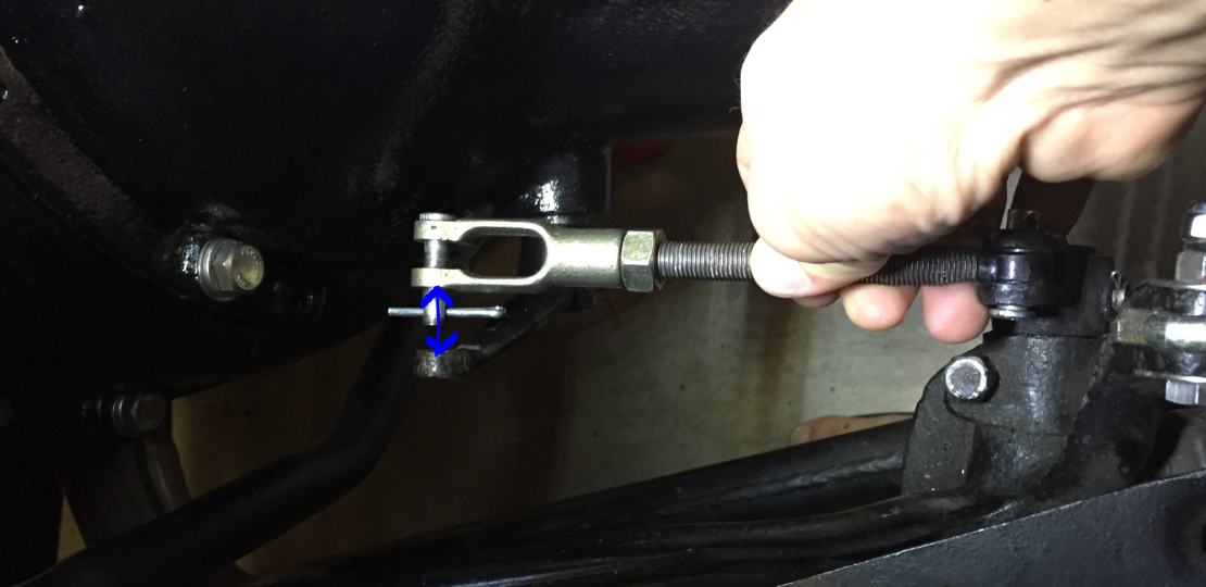

    I then tried the 1939 clutch lever (part # 91A-7511) which would clear the gearbox casing if it was pushed but it does not line up with my clutch push rod linkage. As per below photo.
    Below is a photo of the rough offset (40mm or 1.5inches) I would need which I mocked up by bending some wire.

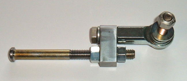

    Am I best to heat and bend a threaded linkage rod similar to my mock up above or should I fab something like the below which I found on the interweb?

    I've seen dogleg clutch rods before. As long as you have enough threaded adjustment for mild wear and initial set up I see no reason not to bend a straight one. That adapter gig pictured? I'd never trust it to stay put. Looks like it would cantilever out of whack easily.
