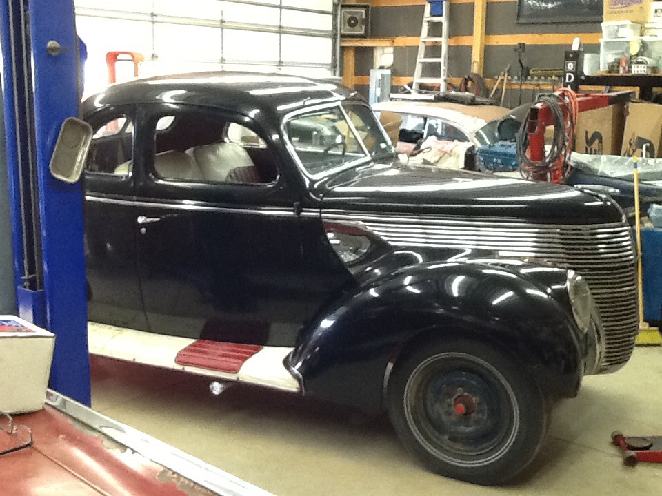

    Just starting a 1938 standard coupe has juice brakes and a 1939 tranny. Will an 8BA fit without radiator modifications or should I stay with an 59AB?would love to stay with a flathead but am not supposed to a SBC either but a flatheads hat fits would be faster. This car has had no modifications to the sheetmetal or frame and I like that. It has been in storage since 1964 and is pristine. Old hotrod and just want to keep it nastalgic. Just don't want the Babbitt bEarings of the stock motor. If there is room for for the 8BA it is just a little boost in HP. But I realize they are 2 inches longer any one done this swap? Any room issues?

  3. slick31
    Joined: Feb 12, 2012
    Posts: 15
    slick31

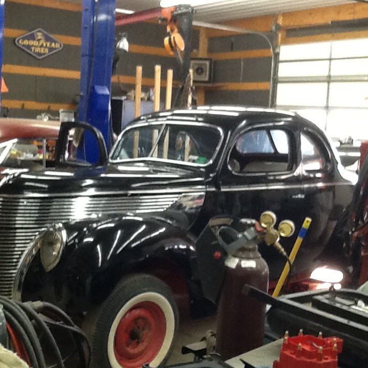

    image.jpg Thanks for the info. The interior us complete just have to figure out how to get the mouse pee Smell out. Got most of it but I will probably have to uncover everything clean and reinstall. As you can see the paint is not all that bad. Good enough to run as is I want too preserve the old hotrod look. The sheet metal is like new no real dents or dings. It even has a set of snap on running board covers to match the interior. I just need to put on some wheels and tires and an engine. image.jpg image.jpg

    If you have a 59 AB block in it, use it. 1946-48 - 59 AB motors have insert bearings not poured bearings. Great little motor.

    The stock motor did not have poured babbitt mains. Any flathead with block mounted water pumps has insert mains. The easiest to work on in the car is the 8BA. Just try removing the front mounted distributor from a 59 or older engine with that leaned back radiator...
    And don't think you will just pull the side panels to make working on the engine easier; putting the side panels back on is usually a pain.
    I pull the generator before going after the front mount distributor, but I like to keep my cars looking like Henry made them.
    Your car looks like it is in really nice shape. I would add a bumpers, I think they look odd without bumpers.

    yup. had a '53 Merc flatty in my '39 standard. bolts in easy enough. if you have the bell housing to bolt to the trans. but there was only about 1/4" between pulley & radiator. no room for mechanical fan. electrical pusher fan fits fine in front, but some people think you are blocking air from the radiator that way. use a 59a if you have one. or, change to an early cam, distributor & water pumps (hell, even heads if you want the look). i think that would work. mine has a bored, stroked, relieved, isky 400jr cammed, aluminum headed, three 94s fed 59a in it now.

    Bud Thanks for the info. It was Rich Swalde 's car you are exactly right. He passed away a few years ago and his wife this year in february. I just happened to go to an auction and they pulled this car out. I was there to buy farm equipment and went home with a new hot rod. A guy cant have too many. What I was told is that it had a flathead but not for sure. It has had no welding or cutting done in the engine compartment or else were for that matter. I have since purchased a 59ab that runs great and I am getting ready to install it. Hoping to drive it to the Road Nights Blue Light Special in Loveland Co. late August. It is starting to come together. I contacted the Sabers and they are looking to see if somebody remebers the car.
