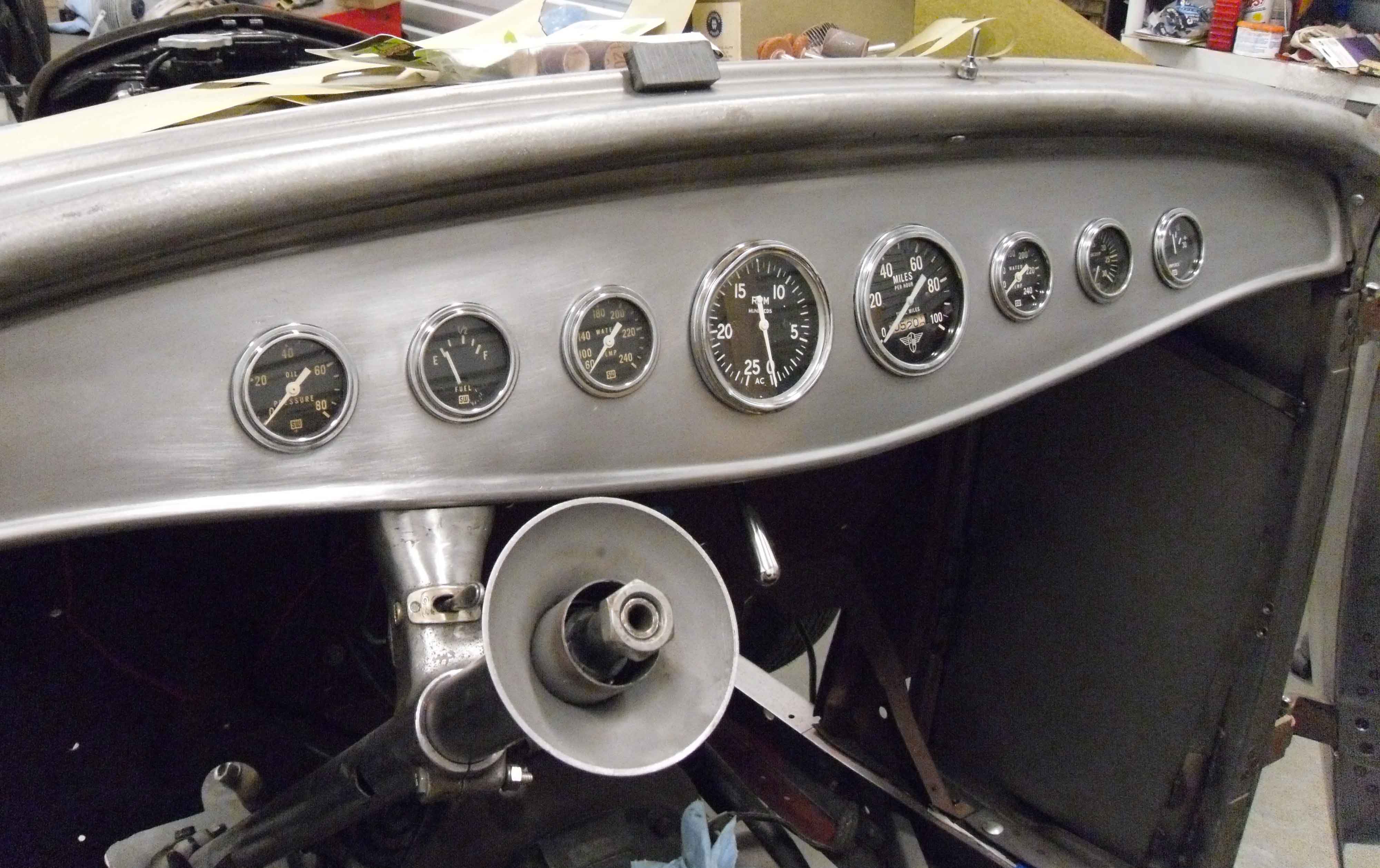

    I did something kinda similar with my '32 but it involved a lot more work. I had a '38/'39 truck drop and I had to narrow and shorten it and pie cut it, bent it and re welded it to fit the contour of the '32 dash. This is what it looks like.

    Above: I used a '38 column and drop in my deuce 3W. It's attached to an F1 steering box so I needed a 7/8" spacer.
    Above: Spacer is made from two pieces of rod and a top and front cover shaped to match the column drop.
