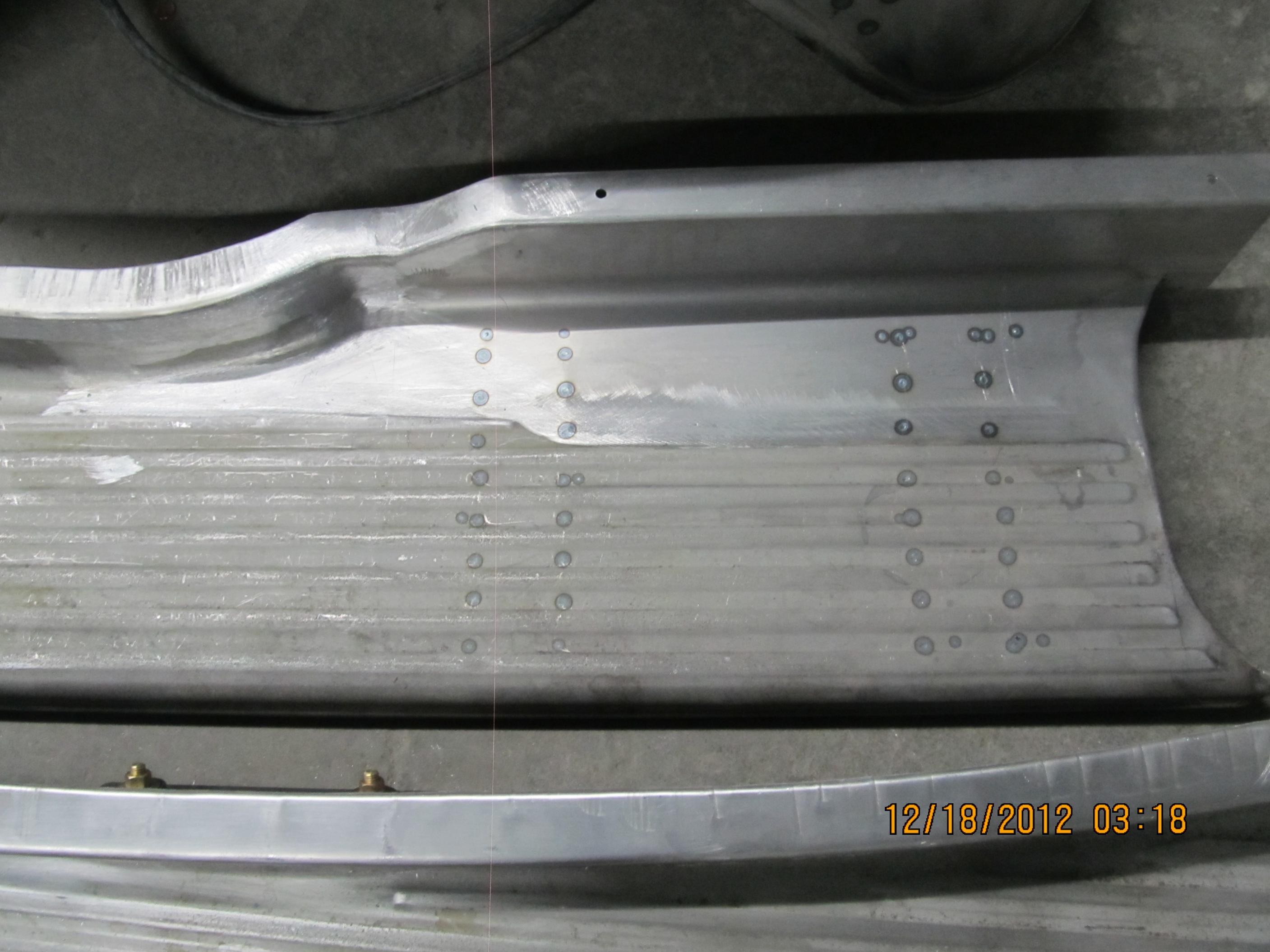

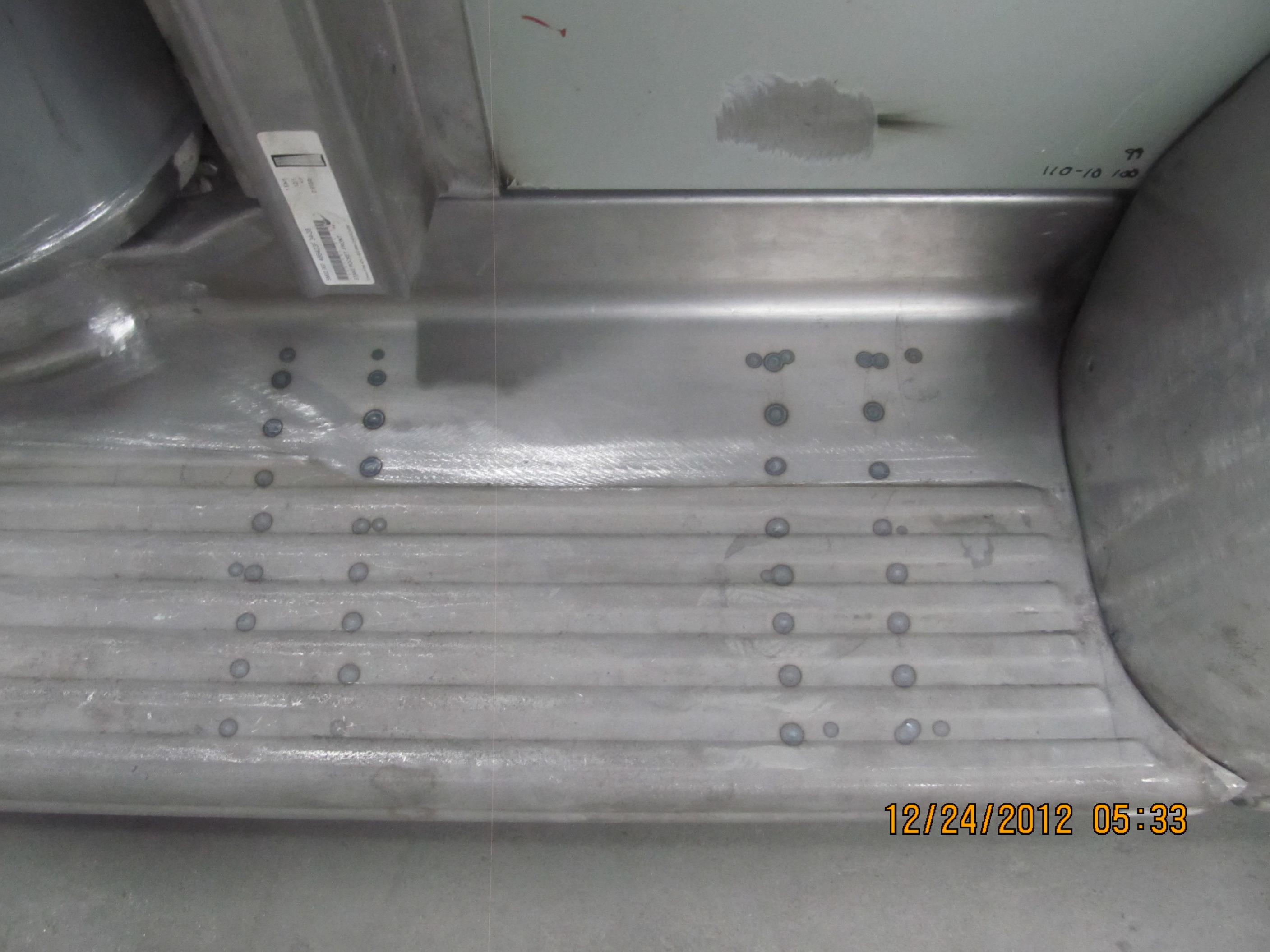

    Hi metal surgeon
    Would u be able to advise?
    What would you do to fix these little bumps? or what can i do in my garage to remedy?
    Also what do u do on the underneath sides?

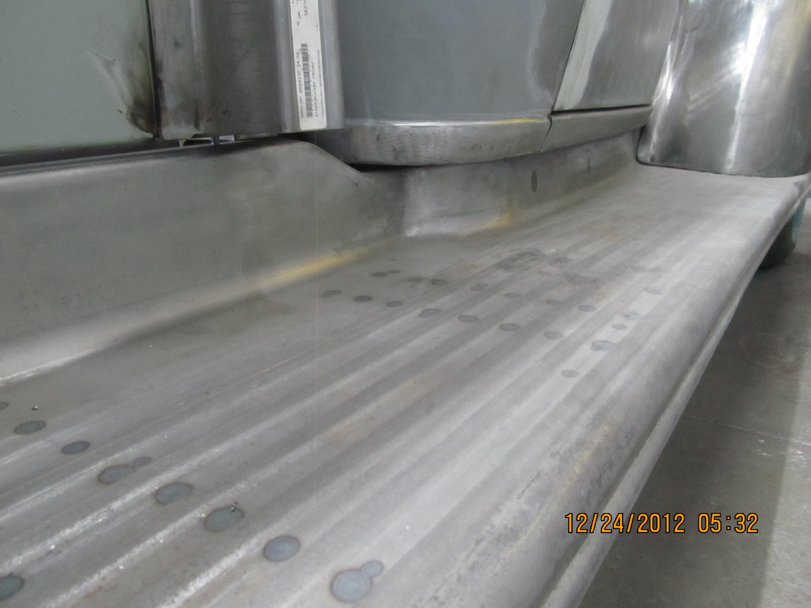

    We did that and got all these little bumps about the size of the ends of my fingers
    Really did not know what next? So we primered them
    Once again pondering what to do?
    cold hammer them out or heat?

    no heat. you need a spoon,dollies and a flat file

    What size would you recommend? It seems that the local supply shop has "small" sizes. I do not think it would work with 1936 steel maybe the newer years.
    I would like to learn this but no locals I know of? Anybody?

    i make my own spoons from old files.Not sure what you mean by 'small' sizes .Typically old panels are pressed out of 19 swg material thickness.New cars are 22 swg, thinner material.I use 18 swg pretty much for everything,doors ,roof skins etc

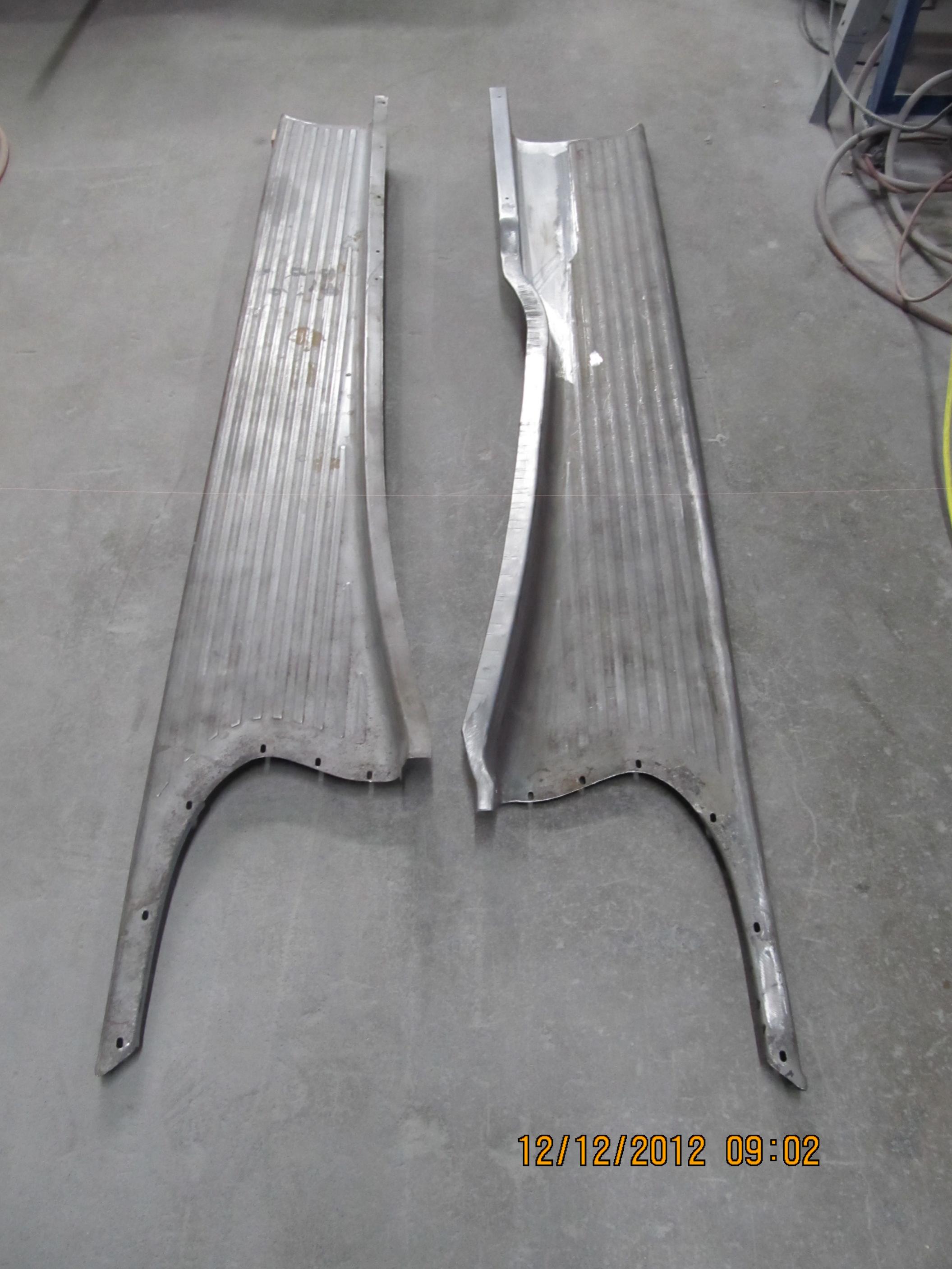

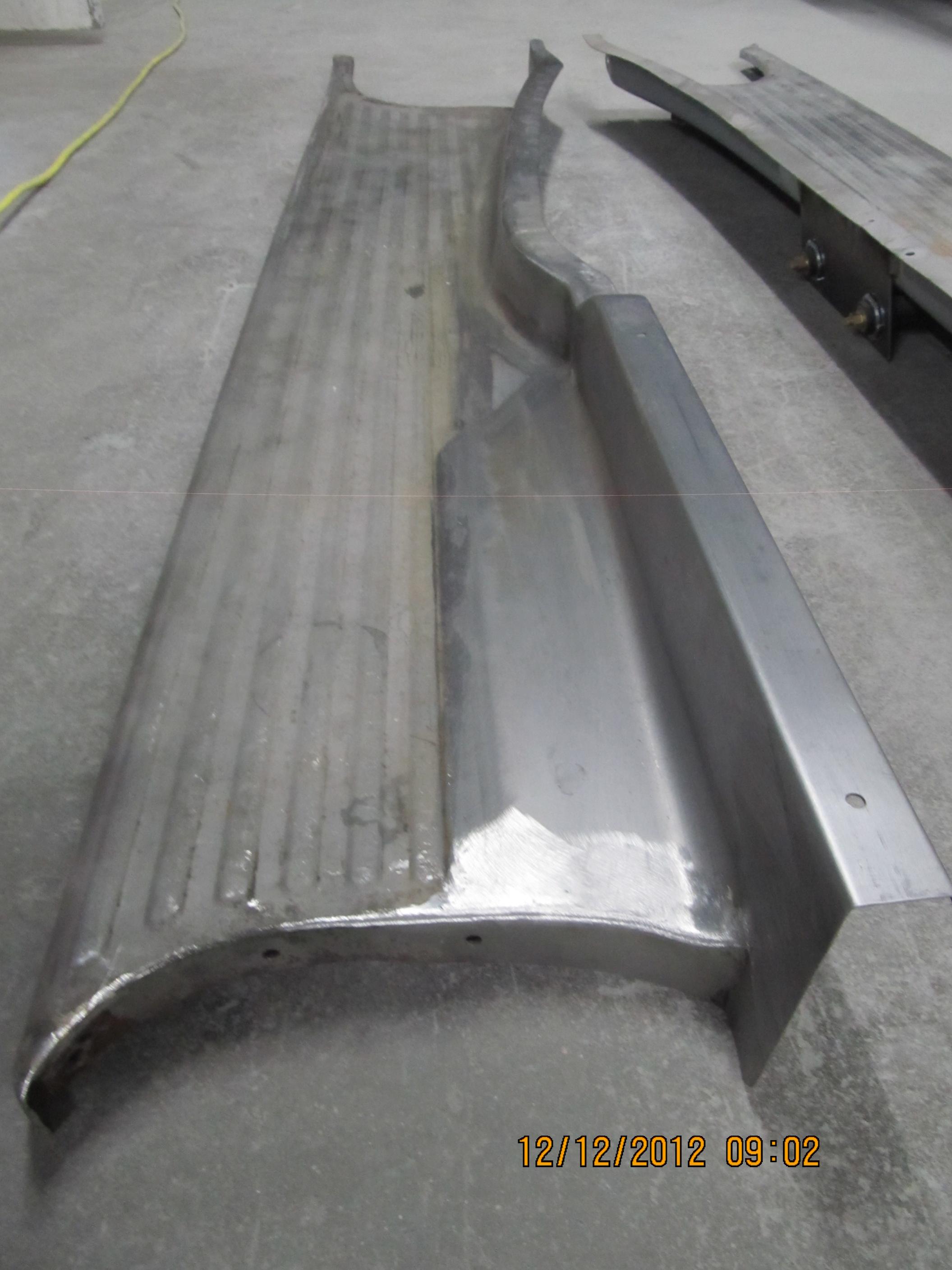

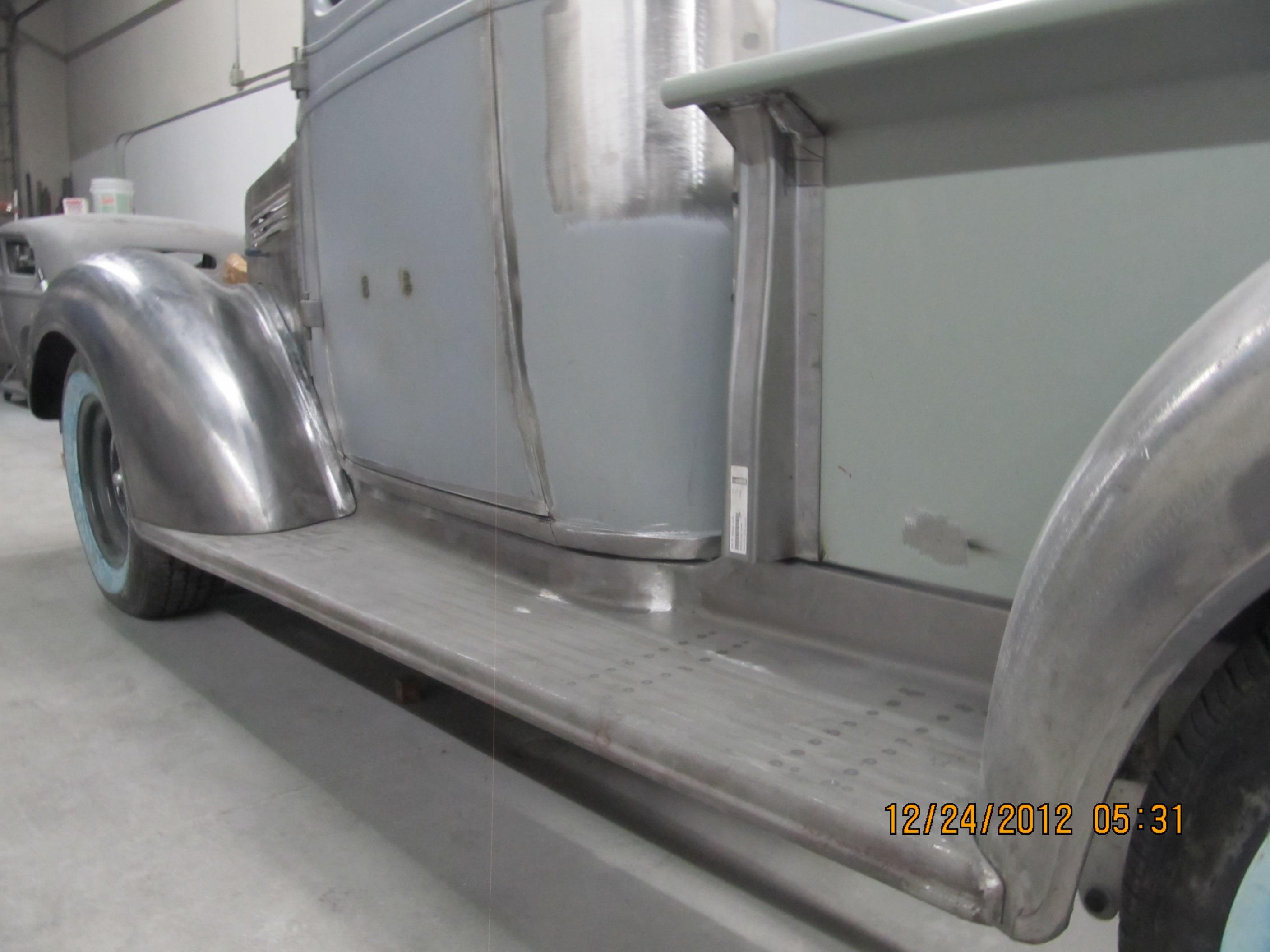

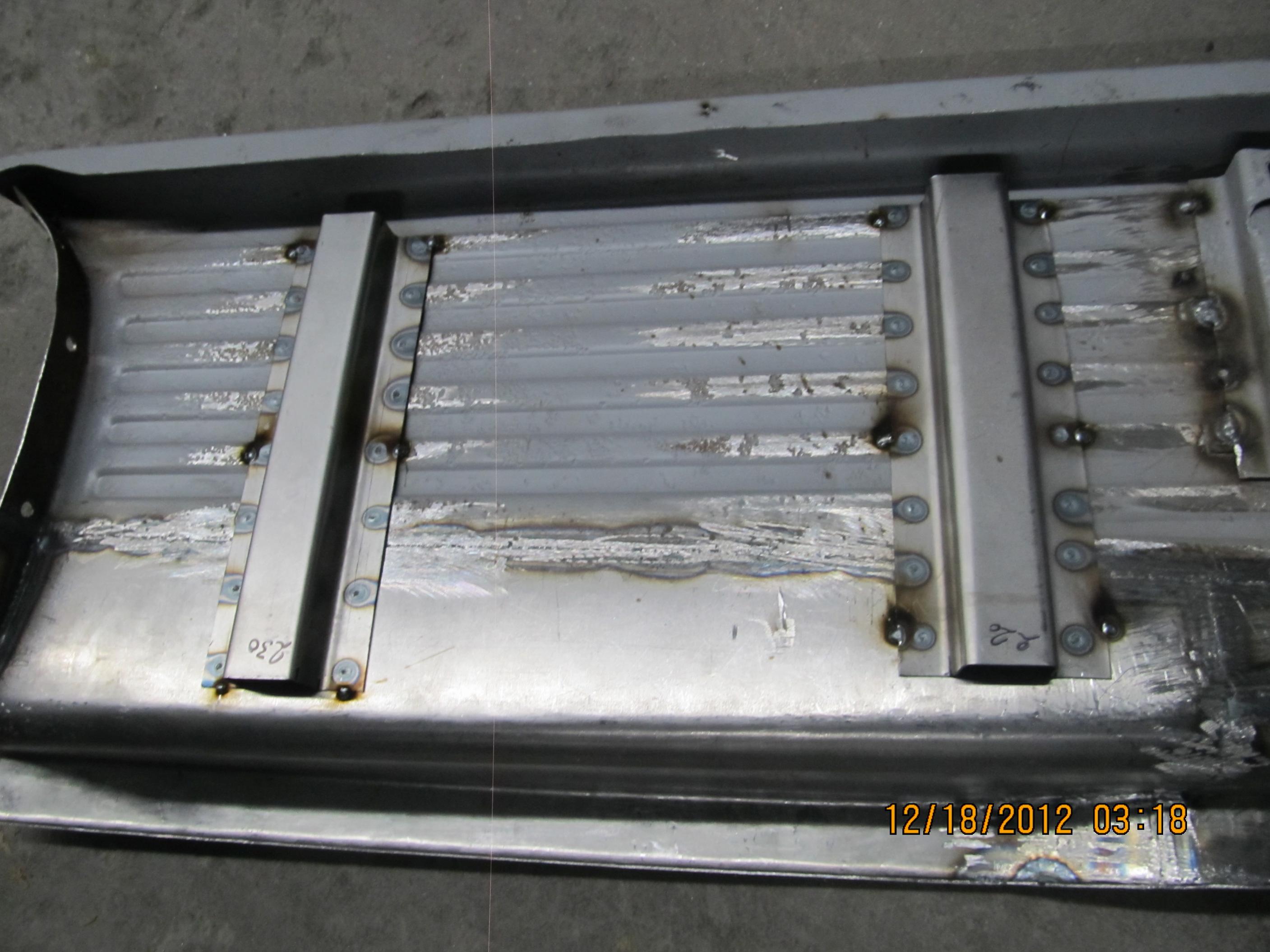

    Updates on truck.Running boards re designed and modified.Cab valance changed from bolt in to one piece with the cab.

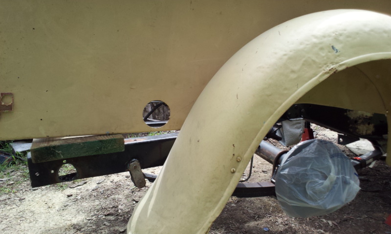

    Hi Metal Surgeon
    I need to fix/replace my lower cowls as well. Would you be able to give me the dims of the little detail (pointed arrow?) like you did.
    that seems to be on the lower cowl area. You can see in this pic someone patched over it.
    I can understand if your to busy. Can anyone else help?

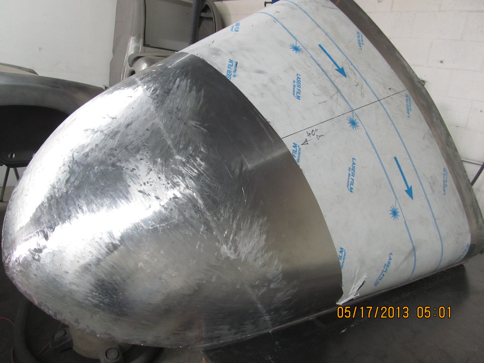

    Aluminum hood build.We decided to head in a different direction with hood as we felt the hood was a little on the weight side,so we made an aluminum one instead including inner structure panel.Same deal forward moving hood.Here's the work in progress...
