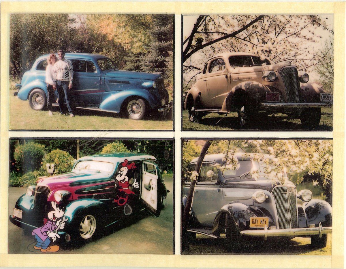

    Good find that should make a nice build.
    37 and 38 are great looking cars with style. I got hooked early on 37's and my Brother always had 38's. I have had coupes, several sedans, a sedan delivery, a pickup and a panel truck. Currently have a chopped sedan that I built 29 years ago.
    Be creative and enjoy your build.
  27. djtwigsta
    Joined: Sep 20, 2010
    Posts: 2,870
    djtwigsta
    Awesome pics!!!! I'm getting a 10 bolt posi in the rear... being modified for 6 lug pattern
