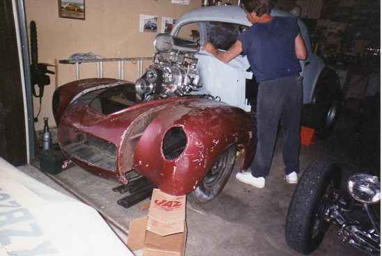

    New to the HAMB, would like to post build shots of my 38/41 coupe.
    Purchased it in 1995, it was pretty cut up.
    A former dirt track racer, spent a lot of time welding in patch panels.
    No motor, trans, glass nor interior but it was a start.
    2nd and 3rd shots, I had just replaced the rear fenders and that piece between the door and rear fender is merely a piece of sheet metal screwed into place by previous owner.
    I'll elaborate as I go along,
    Mick Purchase day.jpg replaced rear fenders348.jpg repaired one door349.jpg 38 front end.jpg

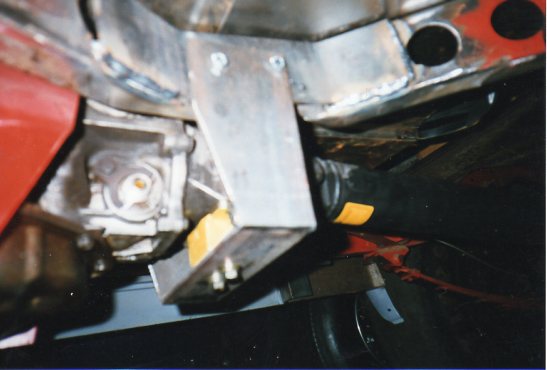

    3rd shot above, the passenger side door was replaced.
    The first engine I installed was a Blown small block Chevy with a T-400.
    Made some engine and tranny mounts.
    Cut up the firewall, bad idea, should have kept most of it. 1st trans moun.jpeg 1st motor mount.jpeg 1st tans mount 2.jpeg cut up482.jpg

    Had a driveshaft cut and balanced.
    I buddy of mine, Crew Chief Dan [Blown Injected Anglia] built the T-400 that I got
    out of the wreckers.
    Fired up the Blown SBC.
    Made a firewall template, made a 16 gauge firewall, welded it in. Turned out to be too thin
    too support the weight of the doors, later removed it and kept the sheet metal.
    I'm only 5'9 and 1/2", look how short the car is.
    Aside from being cut up, it was channeled BUT it came with a pink slip, foot in the door
    to a gasser. Coupe with SBC.jpg Coupe and SBC.jpg Fired up SB.jpg Firewall template.jpg firewall inside.jpeg Firewall Done 1st.jpg

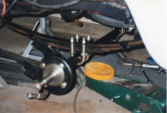

    Bought a new straight front axle and disc brakes, Mullins Vega steering box, cross arm steering.
    Headlights and grill from my wife!
    More welding in patch panels.
    First time driving it!!!
    That was exciting, drank lots of beer.
    First car gathering at Carl's Jr.
    Open headers, slicks, no working lights, no glass, the cops liked it believe it or not.
    Let me drive it home with no hassles. new straight axle.jpeg Vega steering box359.jpg headlights and grill357.jpg pipe bumper mock up358.jpg img764.jpg img775.jpg img776.jpg img778.jpg rear section welded in355.jpg First car gathering for coupe 1996.jpg

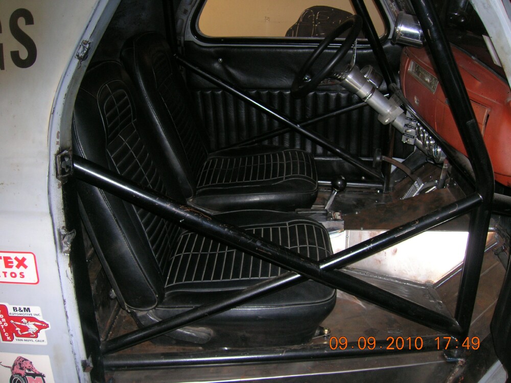

    Getting to a point where I needed a roll cage, I'm an old Navy stick welder and far from as talented
    as a good fabricator. I ran into an old friend Chris of mine at the track.
    He had installed a cage in my 30 pickup in the early 1980s and asked what I was building now
    and if I needed a cage, perfect timing.
    So, off it went to Chris's [aka: Choke] house/shop in Sebastopol,Ca.
    We trailered the car up there, then I drove it into his shop.
    He was just finishing up a Pro Mod Falcon, that came out beautiful, he also had the Pure Hell car up there so I knew it was in good hands. What a talented guy.
    I have no clue how these guys drive these altered, intimidating just sitting in it...
    Then it got stripped down for a lot more than just a cage... img601.jpg img805.jpg img995.jpg img006.jpg img580.jpg img581.jpg Stripped down379.jpg

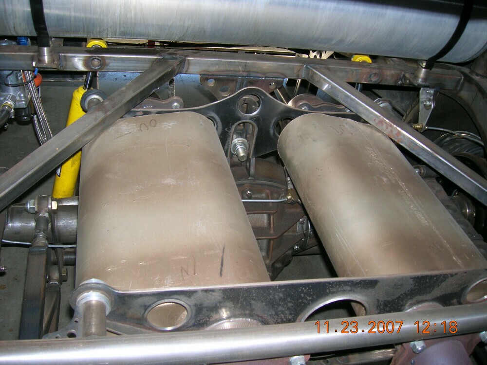

    Now for exhaust [made by Choke again].
    He made some muffler hangers [later powder coated], making it easy to drop mufflers down,
    square flanges, gaskets not necessary, here's a few shots,
    Mick Exhaust401.jpg Exhaust402.jpg Exhaust.jpg Coupe exhaust.jpg Collector caps.jpg
